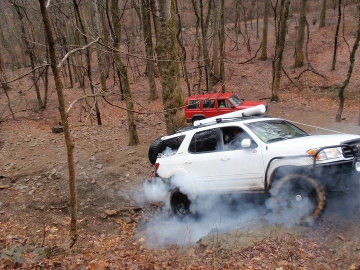

6k rpm pull up a rock face.

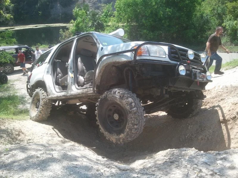

After getting the front axle dialed in, I promptly blew a 35 spline hub assembly on a rock garden (I am sure it was a defective unit) so this was taken in 3 wheel drive. But I also wanted to give some updated photos. Look on Youtube for the updated movies also.

Don't be too hard on the factory IFS, it holds its own pretty well i think.
Great QUestion. Here, goes. The Frame on the Suk is different than that of a F250. the rear hangs lower that the front, and the way that the frame rails intersect with the factory leaf srprings. Also, the location of the oil pan (you can swap out on oil pan from a cruiser but that added $1K to the job)to the axle was a factor in the dec. If I had the Shackle reversal, when the axle flexed (up of down) it would pull backwards and risk several factors under the truck. ie: steering, oil pan, tires hitting the rear well. With that said, I will be also adding a leaf pring to lift the front 2 more inches, then cutting off 2 inches on the front shackles.
Please note: this build is a budget build to see if it was even poss to hang an axle under this rig at an affordable $$ tag AND to see how well it will hold up with this set up. Right now I have less than $1.5k on swapping both the Ford axles under this rig with all the fab parts. then add the cost of gearing and the detroit lockers.
I plan on wheeling the hell out of this rig with this set up until it fails. THEN I will spend the money on linking this rig in the front, then in the rear.
It easily stuffs 37" tires (rough measurment) I plan on going to 39" tires when I wear out these tires that are on it. I have been very happy with the results so far, but I do know that links are in its future. I have just been keeping myself entertained in this project with a budget. So I figure, by next year, she will start the linking proccess. I just wanted to see what she could do on leaf springs first, and to keep it affordable, yet strong...
