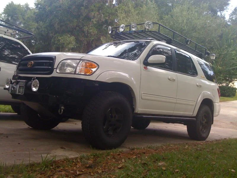

Just to keep you updated. Instead of trading it in, I decided to keep it and use it for misc. duties. So I dec. to keep myself busy and see what I could do. It is a 02 Sequoia with the A-Trac system 4x4. 2UZFE engine V8
Mods Completed:
Rear Aussie (lunch box) locker

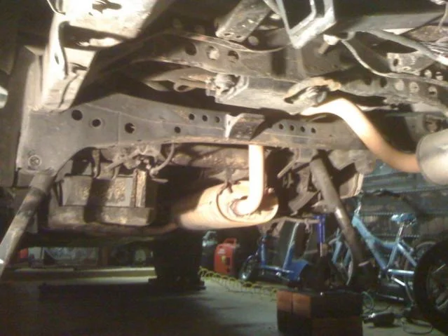

Full undercarriage (custom 1/4" steel skid plates from Front to rear including the T-case)

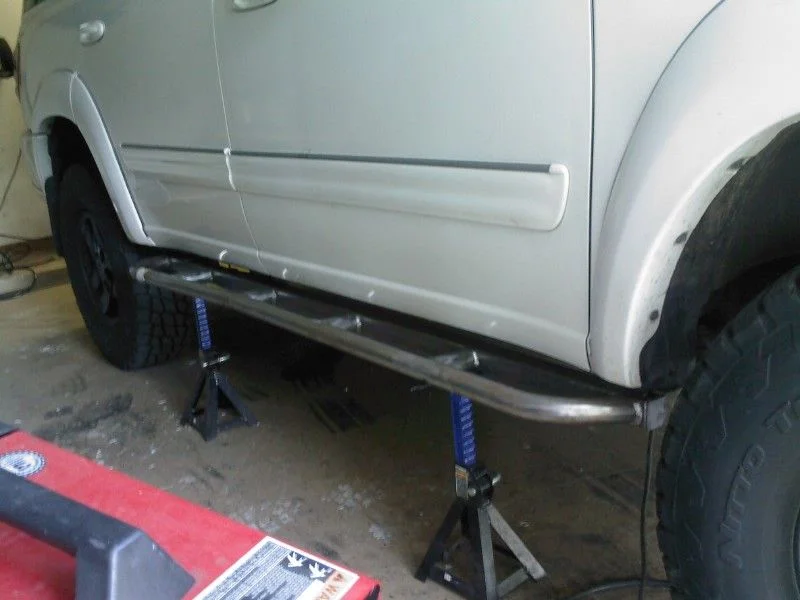

Full Sliders 1 3/4" OD DOM rock sliders, custom built
Toy Tec Lift with the front and Rear sway bars removed. Flexes awesome in the rear, and well in the front for a worthless IFS.
CUsomt front bumper for a 10k winch with the Hella FF1000 lights (tied into the factor switch) The winch bumper is the "base" build of the "begining" of the front bumper. I plan on wrapping the front with some sick 1 3/4 OD tube. This is the begining
Running some 295/75/16 Nitto Terra Grapplers (No RUb Whatsoever)
enjoy. Pics will be updated as the build progresses
She just got back from Choccolocco ORV park in Bama with the NFCH crew, and REALLY did well on the trails. for an POS IFS rig

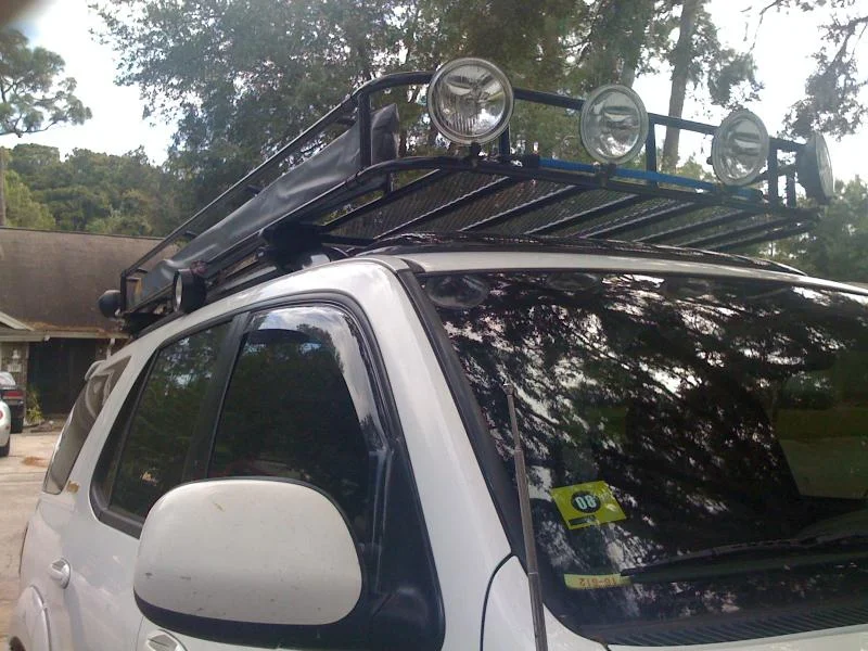

Hey sorry., I have not had much time lately, but I did build the custom roof rack. I built it from scratch and integrated a CAMPINGLAB awening system built into the rack (instead of mounting on the outside to hang a tree) the lights are on, 4 in the front 2 on the sides and 2 facing the rear. They have not been wired yet. The custom front bumper will be started next week, and I think you all will be impressed with the outcome.. I have the design in my head, and it is going to be AWESOME. I am also going to remove the facotry rear bumper and build a custom rear bumper swing away rear bumper with a ladder to access the roof rack.
I like the ToyTec lift (for the money) Obviously I have been debating the SAS conversion with a 80 series axle, but I think I am going to hang with the IFS until it starts to fail, and it will buy me time to save the funds needed for the swap.
Stock gears for now, and it DOES NOT need re-gearing (yet) with the lift, 295 tires, roof rack, added weight from the winch and skid plates AND towing a expedition trailer. I can do 85+mph all day long in overdrive. (the 2UZFE engine is VERY potent) If I cruise at 75mph with the trailer and loaded with kids and dogs, I get about 14.5 mpg at 75mpg with the cruise control on (and it doesnt search for gears even at decent hill climbs. When I was in Bama on the trail ride climbing the "real" mountains, I did reach over and turn the OD off so it would not continuously up/down shift. but with the OD off at 70mph it was revving at an easy 2775rpm +- pulling the trailer like it wasnt even back there. I agree, this truck is a great base to build off of, and certainly one of the first builds of its type. That is why I am taking it on as a project.

oh, and you will notice in the first picture that I finished the front skid plate. So I am officially DONE with the undercarriage 1/4 thick skid plates from the front to rear THANK GOD!!!!!!!! It was a pain in the ars!!!!

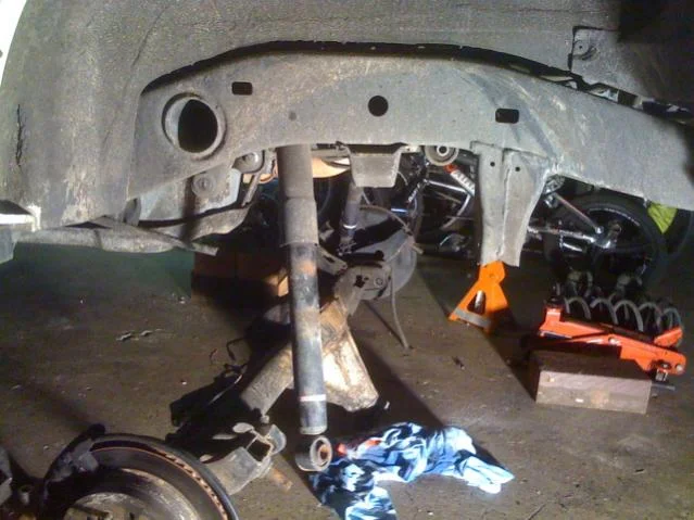

Just picked up a set of 05 F350 axles for the swap. Just tore down the front IFS for the conversion. Will post pics soon.

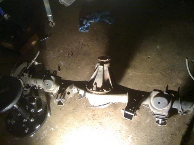

OK Just started the rear. I am installing a Corp 14 bolt Full Float with 4.56 gears SHAVED PUMPKIN and a detroit. After tearing down the rear of the truck I was originally going to go with leaf springs, but decided to go with a 3 link design since the Suk is PERFECTLy set up to handle this set up. Here are some pics, I will post more as the build progresses. ENJOY!!!!!!!!!!

oops... just realized that a friend of mine was over at my house and logged in on MY computer and forgot to log out... Sorry. More pics.
