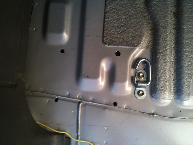

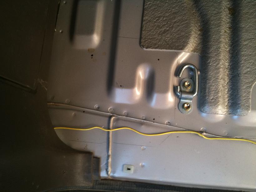

So I carefully marked off the location for the bracket so that I could still put in the third row seat and still use the stock tie down.

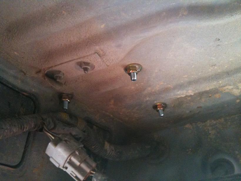

Then I drilled the holes for the bolts. Little did I know I had just screwed up twice.

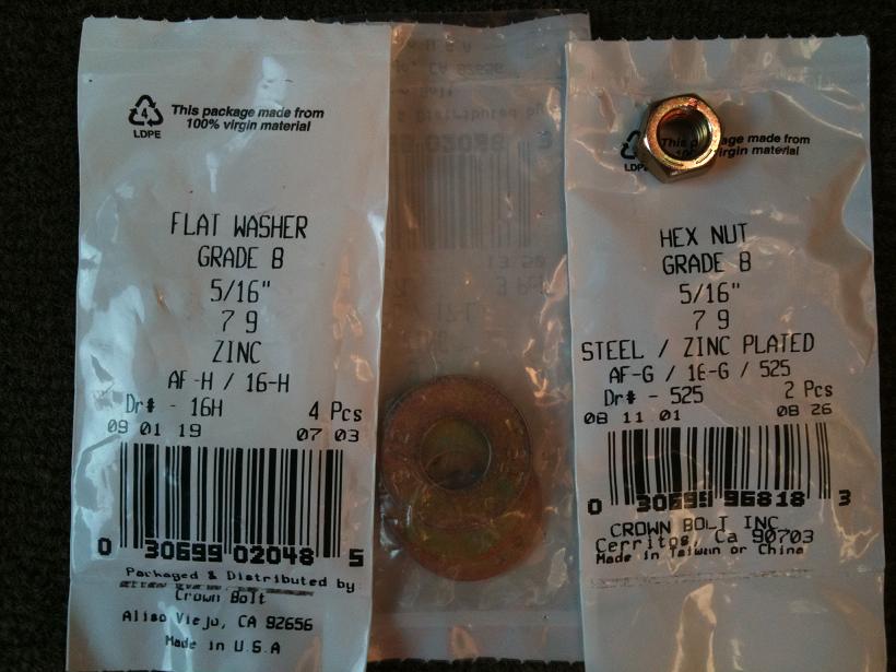

I decided to use some Grade 8 washer & nuts that were going to be exposed to the elements on the underside.
Since the flooring was un-even I just grabbed a back of plane old washers to put under the mounting plate to keep it level.
So once under the truck I immediately notice that one of the bolts isn't showing up. Well if you refer back to the first two pics you will see I went just South of the seam and it is behind the sheet metal cross member. So I was so fixated on this issue I didn't notice how close the other rear bolt was to the wire harness.
So the one bolt I was fixated on I left the hole for the bolt tight and didn't wiggle the drill bit around like I did for the other so the bolt would drop right in. So I went and picked up a new bolt with an allen wrench hole in the top so I could screw it in tight since I couldn't put a washer & nut on the bottom side.

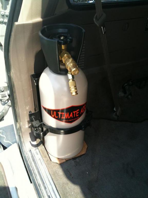

I added some cork to the bottom to help reduce some rattle and I thought I was done.

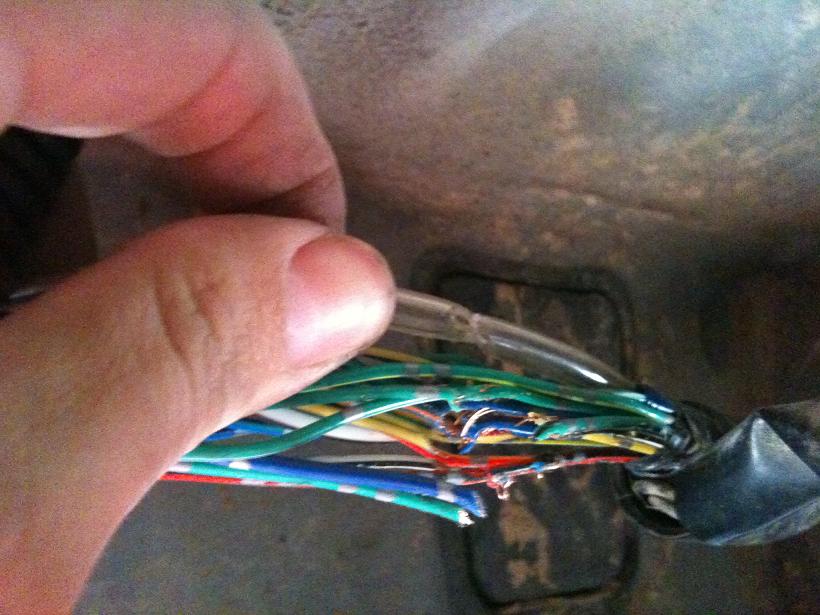

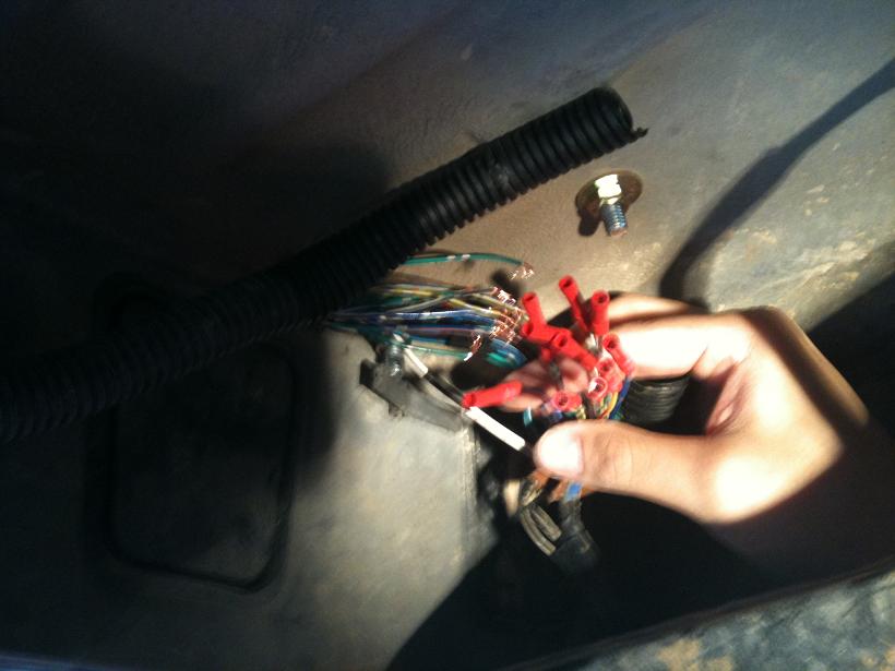

I get into the truck and I push the brake to start it up and the ring around the revers 'R' lights up on the dash as well as two of the AC controls. Huh that was weird. :meh: I get to the end of the alley way to bring the truck around front and I push the brake again and the 'R' lights up again. I immediately pop the picture up in my head of the bolt just above the wire harness. :o
So I park the truck crawl under and fell the top of the harness with my finger and sure enough I got it. The sun had just set so I figured I would tape up a couple wires in the morning.

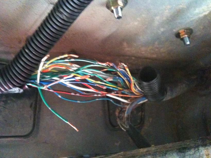

Until I uncover this in the morning!
Out of twenty of the wires I mangled 10 of them.
So 3 hours later I got this
And now I found a guy parting out a 96 on here and he is going to give me his harness for $40 so I will have a nice stock one. :cheers: I LUV IH8MUD

When you told me this on the phone I had a picture of a few knicked wires. It looks like the drill bit really mangled those.:doh:

Hey Noah, remember those 3rd row seat brackets I picked up from you? Here's what I used them for and just another option for your CO2 bottle.
I got this idea from a magazine article called "The Comfy Cruiser" that someone posted on here.

Hows this work for you, you don't freeze over your reg with the bottle laying down?
