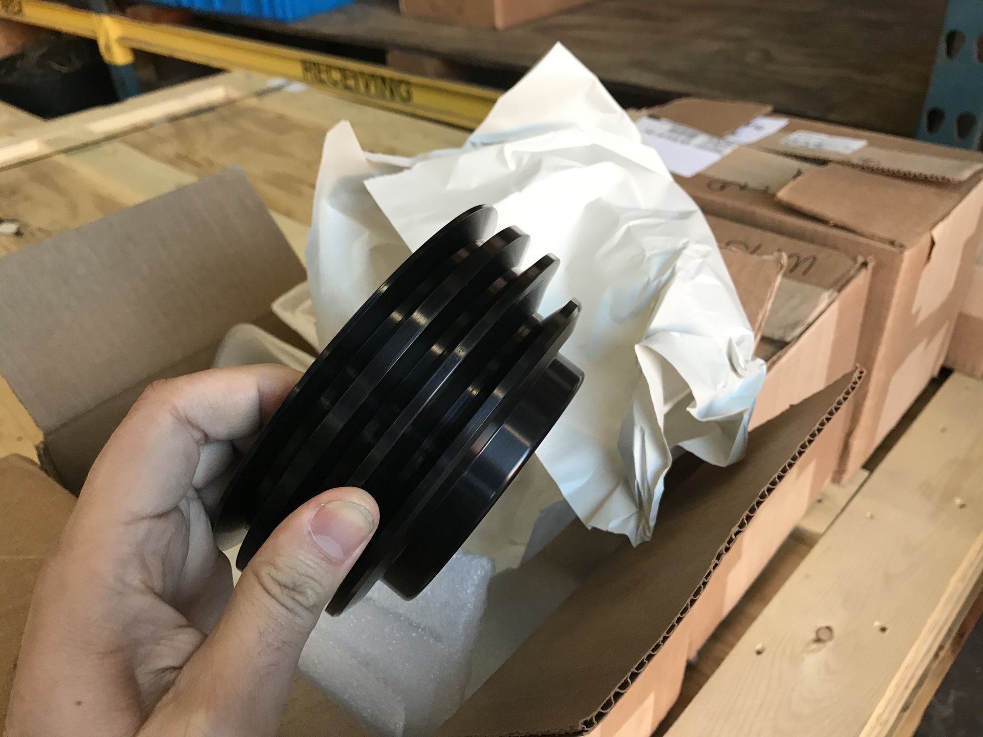

Got my parts back from the Cerakote guy. I had it done in Cerakote Glacier black. High temp 2000+ degree coating on my Wits End Turbo Kit.
