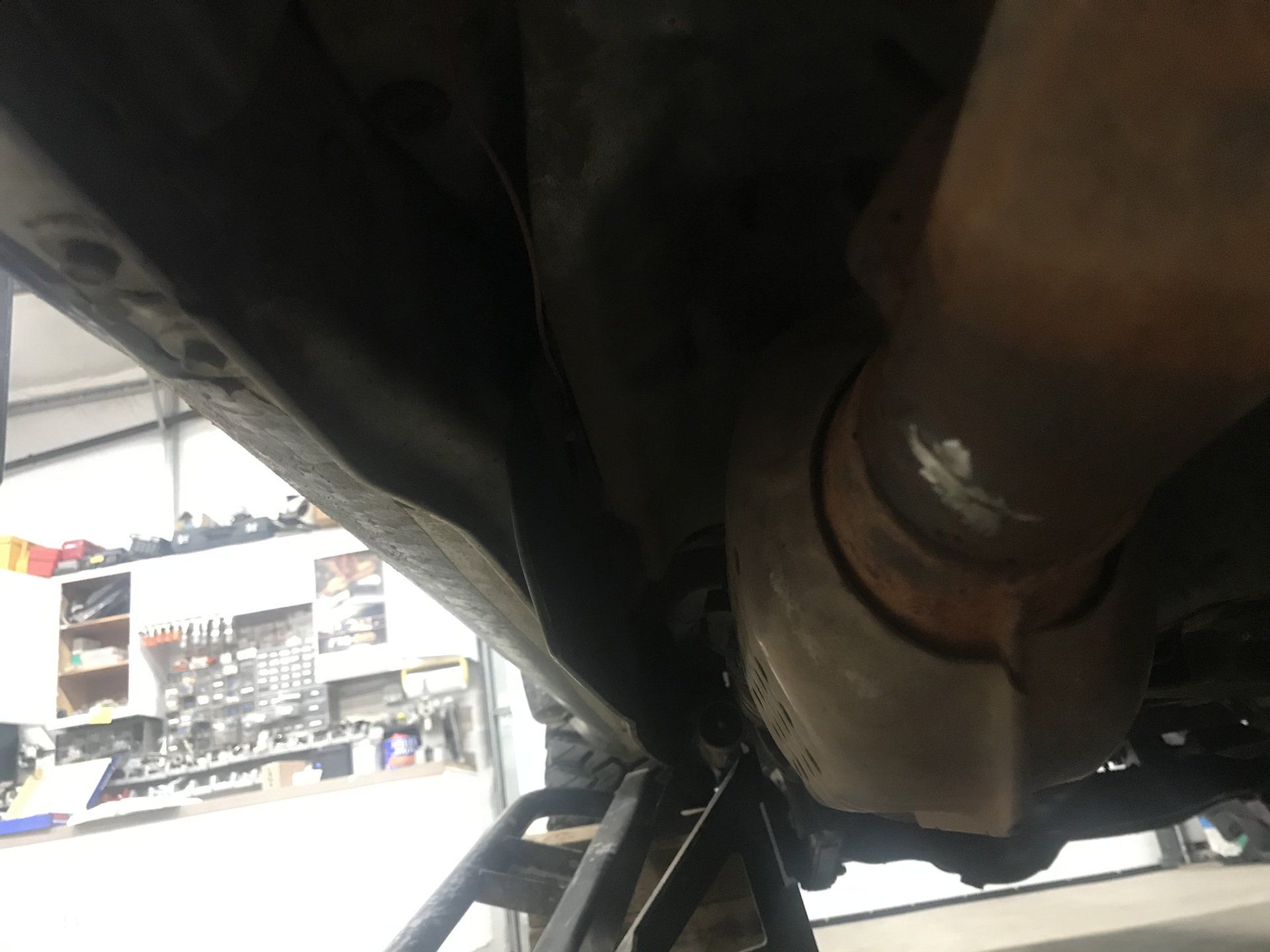

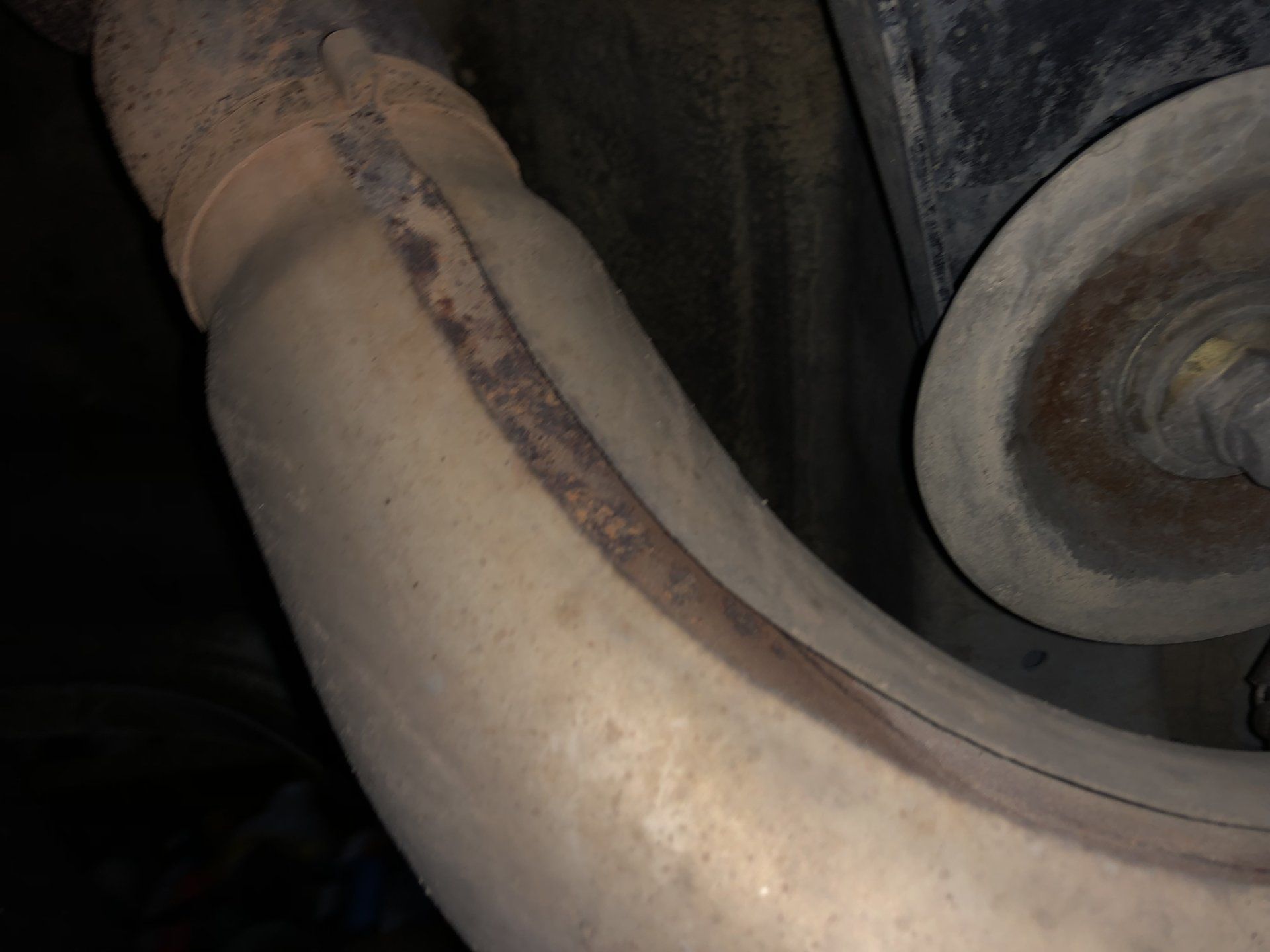

Need some measurements:
Can I get a few of you folks two get me two measurements?
I am locating the cat and cut Y-pipe for the downpipe but we would all benefit by making sure all of us have the same placement.
Where the front cat is now, I need a measurement from the inside of the edge of the pinch weld to the edge of the pipe.
Then I need the measurement from the bottom of the body mount disc to the top of the pipe.
Thanks in advance.

View attachment 1890180 View attachment 1890183
Pinch weld to pipe on mine is 4-1/8"
Disk to top of pipe is 1-5/8"
I got the same measurements, but my pipe in front of the cats has a heat shield.
On my 97, I've got right at 4" between inside edge of pinch weld and pipe.
From bottom of disk to top of heat shield around pipe I come up with 1 15/16" (could be off a 1/16 or so).
