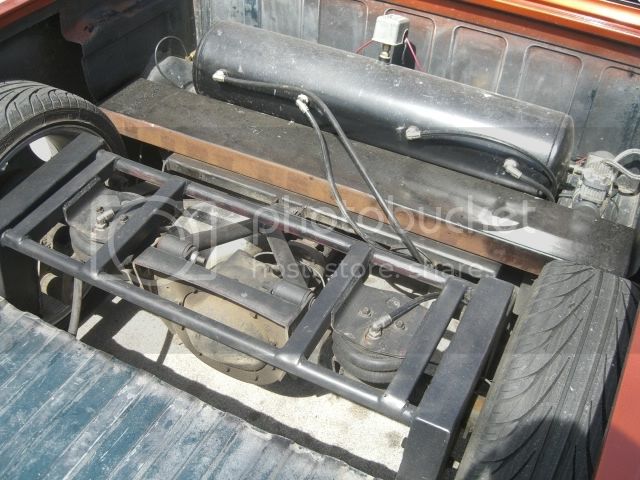

here is a bagged truck i used to own for a short little while.
here it is laid fully out and bags compressed on top of one another in the rear, no more additional drop is available 1.) cause it is laying on the ground 2.) cause the bags have now become the stopping point
this one shows full lift out back and as you can see there isnt much travel at all, this is with the rear bags aired all the way up at 150psi which is intolerable for driving. (which why in this application a cantilever setup is amazing)
shot of rear bags fully inflated
now i know these pics arnt of a 60 and the bags are being used as the only springs on the truck and not as helpers, but the bag over axle this truck had is the same and shows how little travel is available from these things from 0psi to 150psi. and looking at the above pics there is only maybe an inch MAYBE 2 but prolly less of droop before it starts pullin on that bag because it looks to be at or near max height already, now they will usually handle a good bit of stress and can support the weight of an axle (well in an s-10 anyways) for a little bit, but it is hard on them and is not recommended as i have seen many rip from just that, much less a much heavier land cruiser axle doin it over and over again wih a much heavier truck forcing it to articulate and pull on the bag.

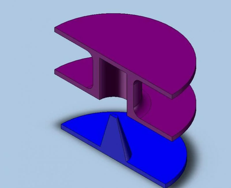

Easy to solve the over-extension concern, make one mount work like the picture and leave the other mount fixed to the frame or the axle housing. They can be oriented any way that works the best. Ideally the cone would never completely leave the tube, but with careful set-up that may not be important.
Having a detachable suspension component is never a good idea IMHO.
