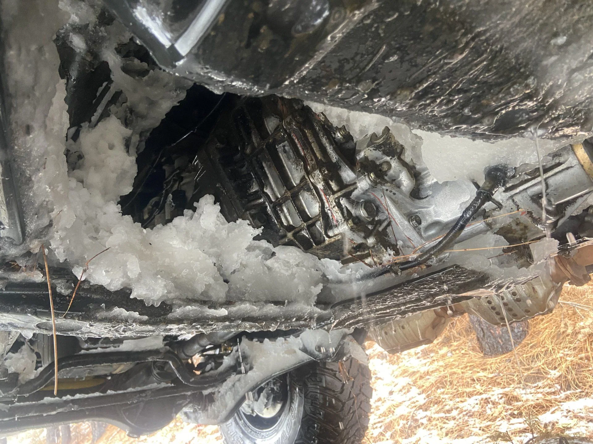

This is a 1997 FJ80 with 191k and maintenance being up to date, with no known issues with the engine or transmission. This was really weird. I went on a pretty long and rough fire trail for about 5 miles, nothing that was too extreme. I’ve probably averaged around 10mph. It was raining/light snow and outside temperature was around 45 degrees F. I’ve kept my eyes close to the ScanGauge for engine temp and my Bosch transmission pan fluid temp gauge. Both were within normal conditions but the transmission was colder then usual, probably due to the weather. Last 10 minutes of the drive I’ve got on a paved road which lead to the main road, and it was snowy. The snow was extremely tacky, it was sticking to anything and my car was starting to get covered up with ice.
That road was pretty steel uphill garage at about 5k altitude. The wind was heading towards me as well. This is where the problems started, I couldn’t get the car above 35mph with foot all the way down. I assumed it was due to the conditions I was driving thru and the steel slope.
After turning on the main road, I started to go downhill but I’ve noticed my car was hesitating. It did not want to get above 1500rpm and was severely bogging down. If I was to accelerate it would get to couple hundred rpm and that start to bog down to a crawl. Only way I could get momentum is to floor it after which I would kick in high gear and accelerate until it switches to the lower gear and start to bog down. It would do this in L,2nd,D and R gears. Since the first symptom, I’ve checked my transmission fluid [which was full but cold], and I’ve had my eyes on the trans gauge which was now reading below 100F. I could rev the engine up in neutral no problem. I’ve stopped and tried to put the car in park it didn’t want to go until I made multiple attempts [i suspect the reason is due to being packed with snow/ice]. I’ve hopped out to inspect for physical damage [none that I could find], and check fluid [full]. The fluid was cold to the touch. I’ve noticed the underbody of my truck was stuffed with snow, literally snow and ice blocks everywhere, on top and under transmission, on the side, in the axle springs, packed on top of axles, everywhere.
The only thing I could think of is that the transmission was literally too cold? Ive sat for 15min to try and let the truck warm up (it’s still very cold and raining/snowing) outside, but it did not fix the problem. After limping it to the closest parking lot (primarily downhill, which it could speed up past 30mph), the issues remained and I had to keep flooring it periodically for it to kick into a different gear and accelerate before it would bog down. Once we reached the parking lot the snow was still there but slowly melting, all the fluids were still ok and I didn’t see any physical damage. After letting the car warm up for 30min the symptoms didn’t appear to improve at first. I was able to get it home by flooring it to get up to 50mph and then I was able to coast home. After the drive ( 2 hours), my transmission seem to act better but it 100%.

45 degrees is not cold. Slushy snow under your rig will not cool a tranny to any degree worth mentioning. A 5 mile fire road is not a long way to run in low range, in one gear, at low speed. I operate my '80s at significantly subzero (-20 and below) routinely every winter. I run them in deep snow for dozens of miles sometimes, in low range for lots more than that. Lots of people do. Nothing unusual or out of tasking parameters for the rig in that. The snow and ice packed under your rig looks unremarkable. None of the conditions you mention would have any effect on your transmission. The symptoms do not sound like tranny problems either.

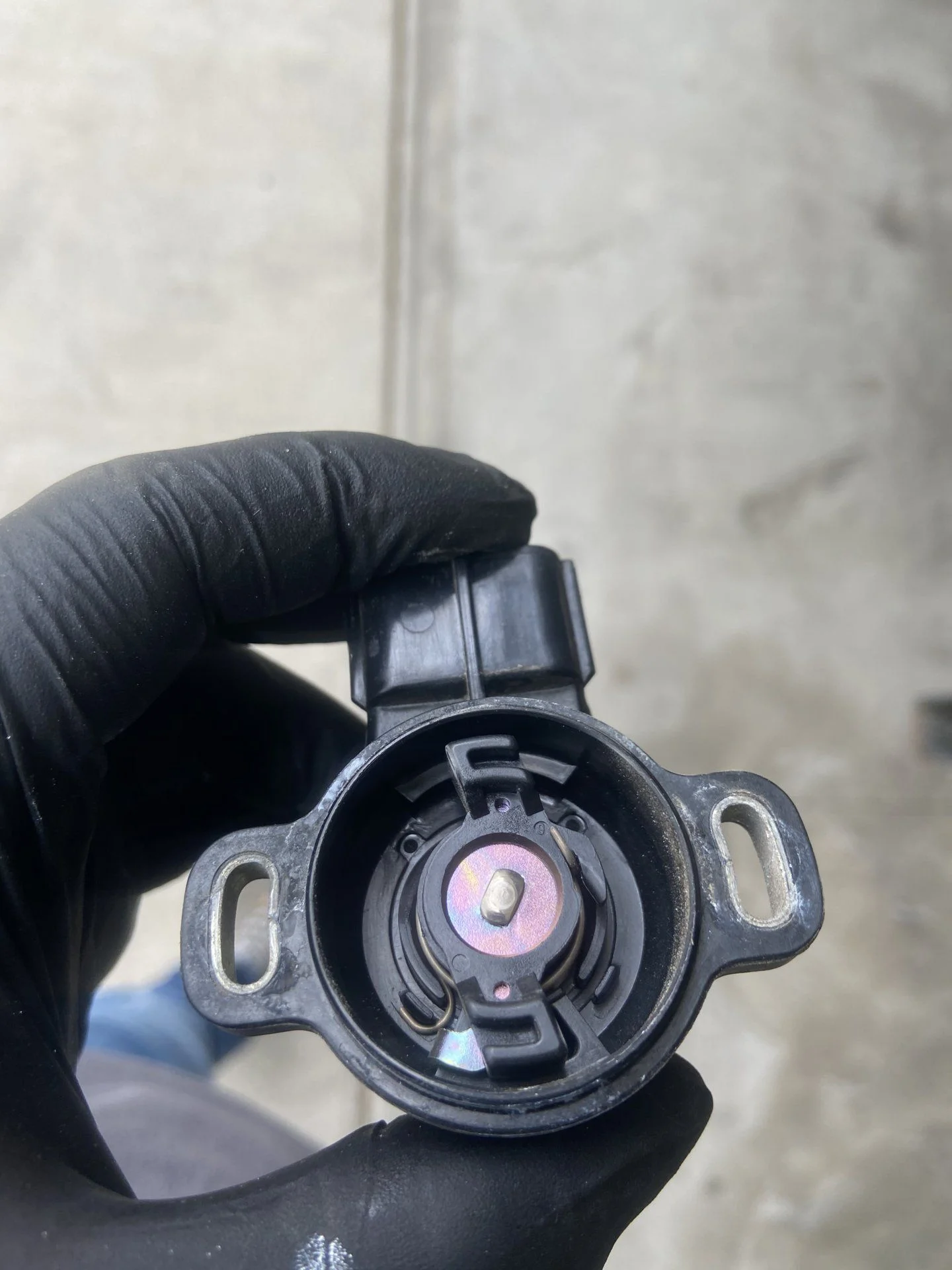

I have cleaned the MAF and inspected the TPS. The TPS looked to be in a good shape. With the Scan gauge, my TPS Is 8 idling and around 80% wot. There was no water or dirt under distributor cap(was replaced recently).

I tried testing the TPS by measuring resistances, but I do not have a vacuum pump. However my ohm reading without vacuum was an open circuit in any throttle position. I can still read TPS # on my ScanGauge so I think the vacuum is necessary to check the resistances.
IF the TPS is highly suspected...then it might be worth just replacing it (and adjusting new one). That way you confirm or eliminate that part as being the issue. It doesn't hurt to have a 'spare' TPS if that isn't the problem, though we don't want to just 'throw' parts at it.

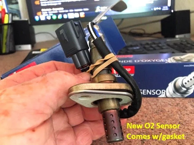

Hopefully this is going to try the final update. I’ve installed the new 02 sensors and (so far) I have not experienced the problem. I’ve only taken it on a short cold and warm drive. The downstream 02 sensor with the lower resistance value was also a Bosch unit, replaced at some point by the PO. I would suggest putting copper plates nuts and maybe a tad of antiseize on the exhaust studs, but we careful not to get any on the 02 sensor.
'Bosch' O2 sensors are known to have caused poor readings for some folks when used in the 80 series. Denso will be your better choice when replacing.

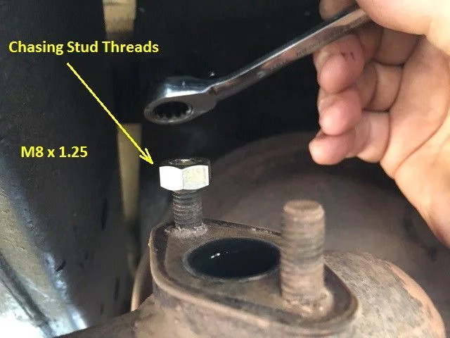

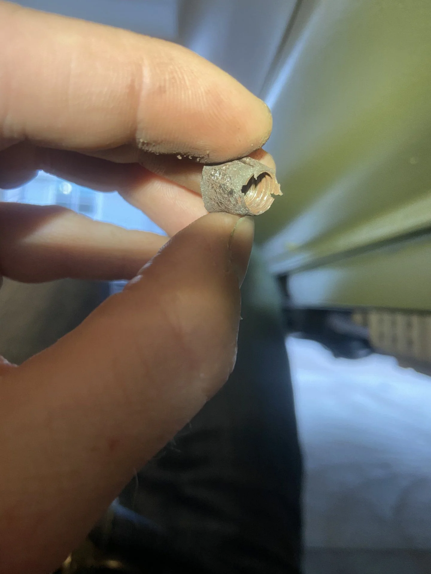

I had no trouble with either the nuts or studs when removing my O2 sensors...but I don't live in the 'rust belt'. I can imagine it might be an ordeal for some. Good time to chase the threads and install new exhaust nuts if you have time to 'plan' for the repair.
Be sure to remove the old gasket and install a new one
