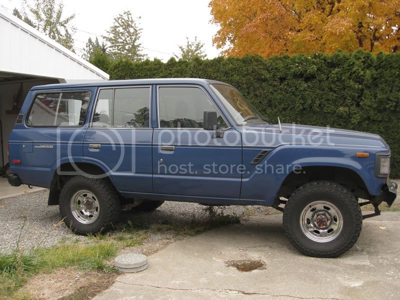

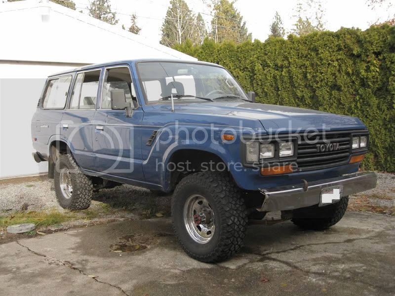

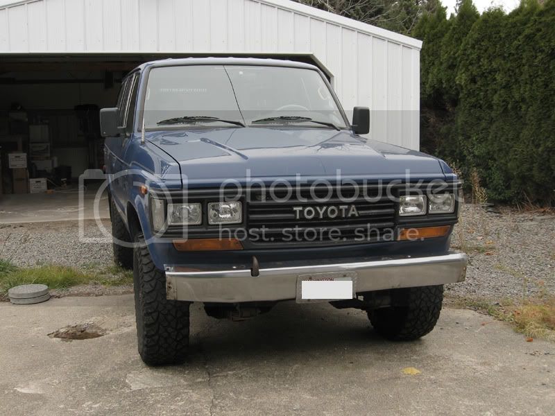

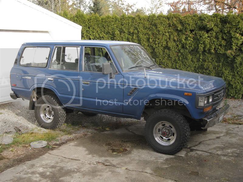

First, a few "before" pics:

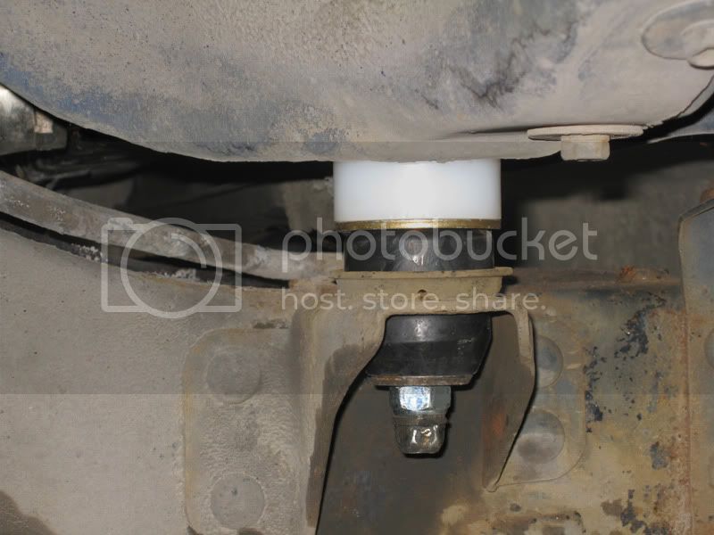

Here's a sample of the hardware that comes with the 4Crawler (Roger's business) kit. The white piece is the UHMW 1" lift puck. I ordered the "Ultimate" (larger diameter) lift pucks. The washer shown actually goes on the head of the bolt, and the original OEM lower mount washer goes between the lower bushing and the nut. Also, the upper and lower bushings have a zinc coated steel sleeve in the middle, and separate for easy installation. No having to ram anything through the mount holes on the frame.

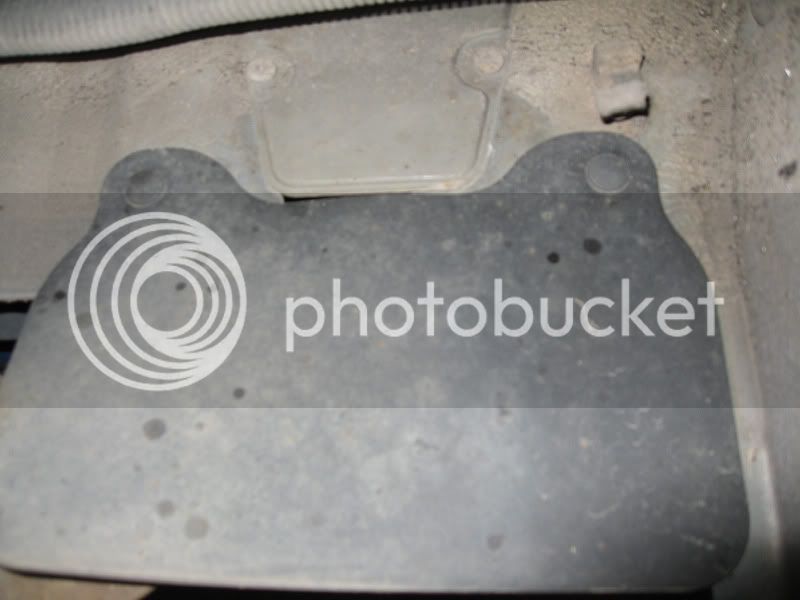

There are 12 total mount points on a 60/62; six on each side. They're all easy to find/access (you will have to pull carpet up though), save for the #6 mounts (the farthest back). With those, you have to access the bolt heads from underneath the truck via access panels on the body.

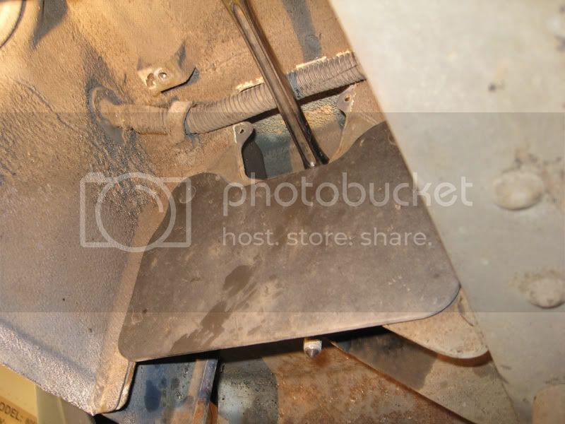

Passenger side (with a breaker bar on the bolt head):

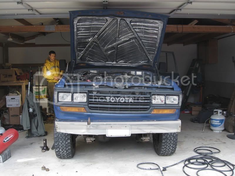

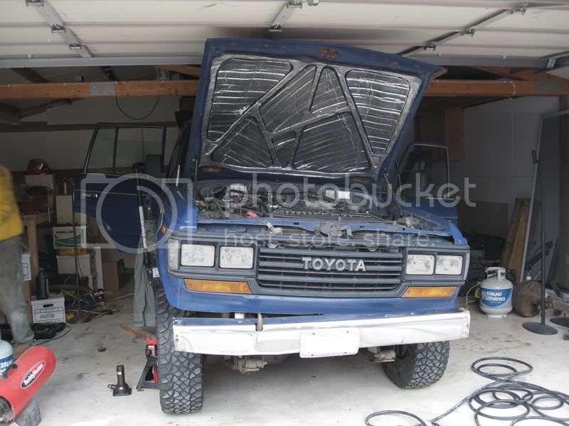

To do the swap, we removed the nuts (there's a primary nut and a lock nut, both 14mm, on the factory bolts) from all 12 mounts, then used my buddy's (climber8483 on here) Hilift to lift up one side of the body, install the new mounts with lift blocks, set the new bolts in place, then slowly lowered the body back down, all the while making sure all the new hardware stayed in place evenly. Also important, we used a piece of 2x2 lumber with a notch cut along it (for the sheet metal seam) to distribute the pressure of the jack along the edge of the body without distorting the sheet metal. We used a couple of C clamps on the wood to keep it from splitting under the weight of the body. Worked like a champ.

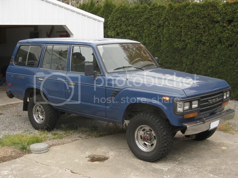

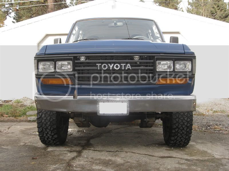

Here are some "after" shots to show the difference in how the body sits over the frame.
Overall, the 1" of body lift should be just right for allowing 33" tires to tuck nicely into the wheel wells when flexing at full turn. Keep in mind I also have about 1.5-2" of spring lift thanks to full length Add-A-Leafs. I wouldn't recommend a body lift as the primary lift for a vehicle, but as a bit of fine-tuning the height of the body when it comes to tires fitting in wheel wells, I'd say it's a good option.
