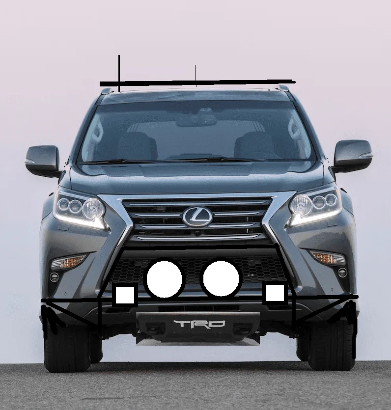

Front Bumper - Might consider that GXOR concept style lower grill from CBI at some point, but might just put a bumper guard/light bar similar to the Avid offroad version on for now and then doing a vinyl wrap on some of the chrome grill and door handles

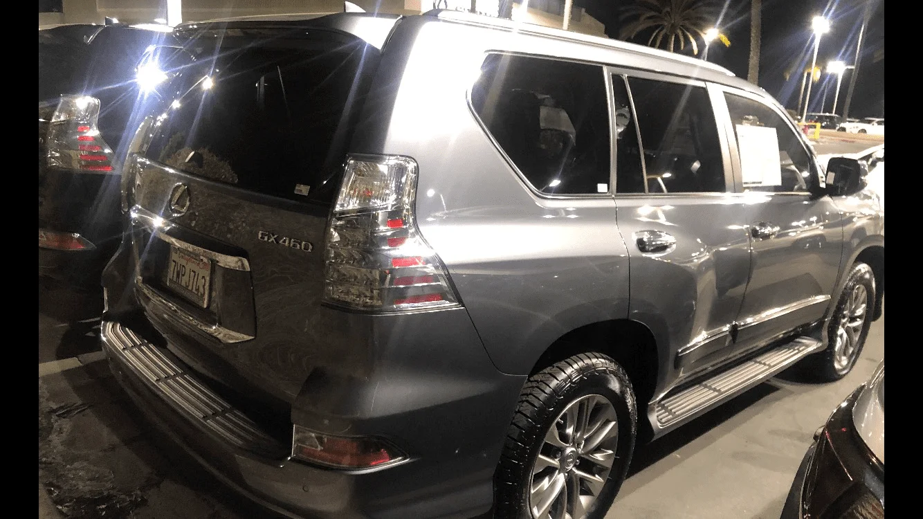

Here are a couple of initial pics of the new one...

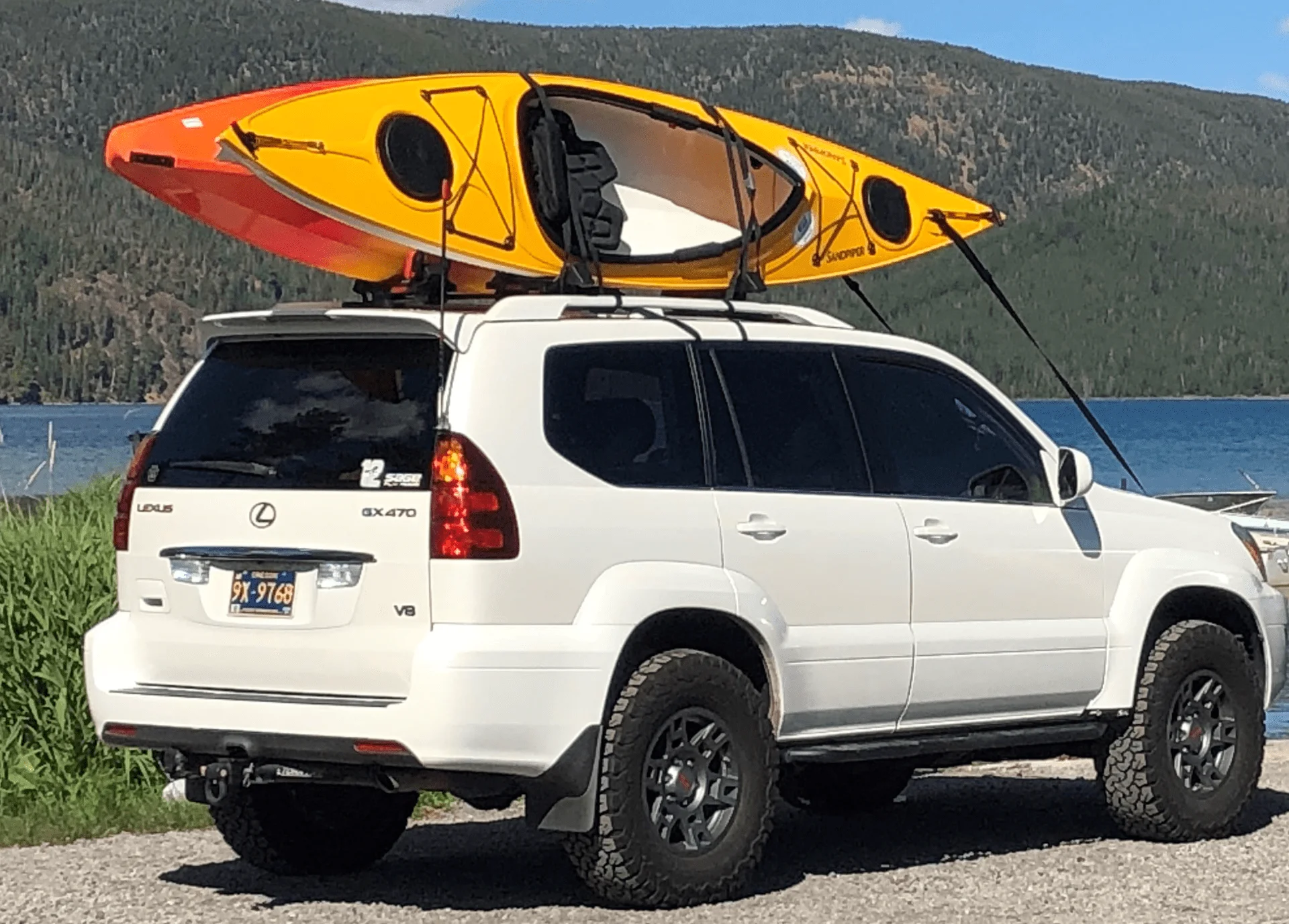

and the old one...

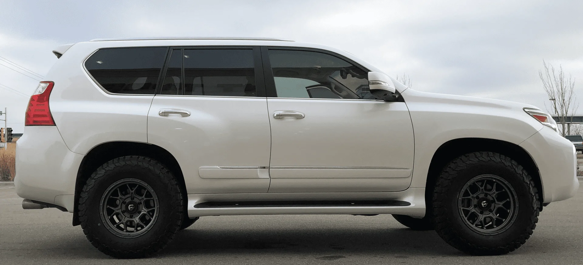

I would suggest going a different route with the wheels simply to try something new and change up the look this time around. The factory wheels on the 460 don't look bad with a lift and 33's but you really do need to run them with wheel spacers to get a better stance. Here is a pic of a 2017 with a 3" lift and 285/65/18's on the stock wheels with wheel spacers, I think it looks great but I am not keen on running wheel spacers when there are better options with an aftermarket wheel. KO2's are a solid choice, no complaints there from me.

while I am waiting for the suspension... I am now focused on looking at wheels for the new gray GX460. I really like the 285/70/17 KO2s on the TRD gunmetal wheels I have (had) on my 470 (kayak pic below), but interested in what looks best (I know it is subjective) and what offset will work with the lift. Just going for something that looks strong but understated. I wish there was a thread just about wheels with pictures of various wheels on a 460, showing sizes and brands

those stock wheels do look pretty good, but I agree on the spacers (even though I ran them when I had my stock wheels on the 470) ...anyone have a picture of the gunmetal trd pro wheelss on a gray 460?

while I am thinking about it...I am planning to upgrade the lighting so any input there is appreciated too. Looking at adding a fog/driving pod (I had the Rigid Dually D2s with a snap on amber lens that worked great) and a set of offroad trail lights (thinking of the LP6 or the Rigid 360s). And of course will look at upgrading the bulbs in my lows, high beams and stock fogs if there are any better options. Thinking something on a custom light bar like this crude sketch...

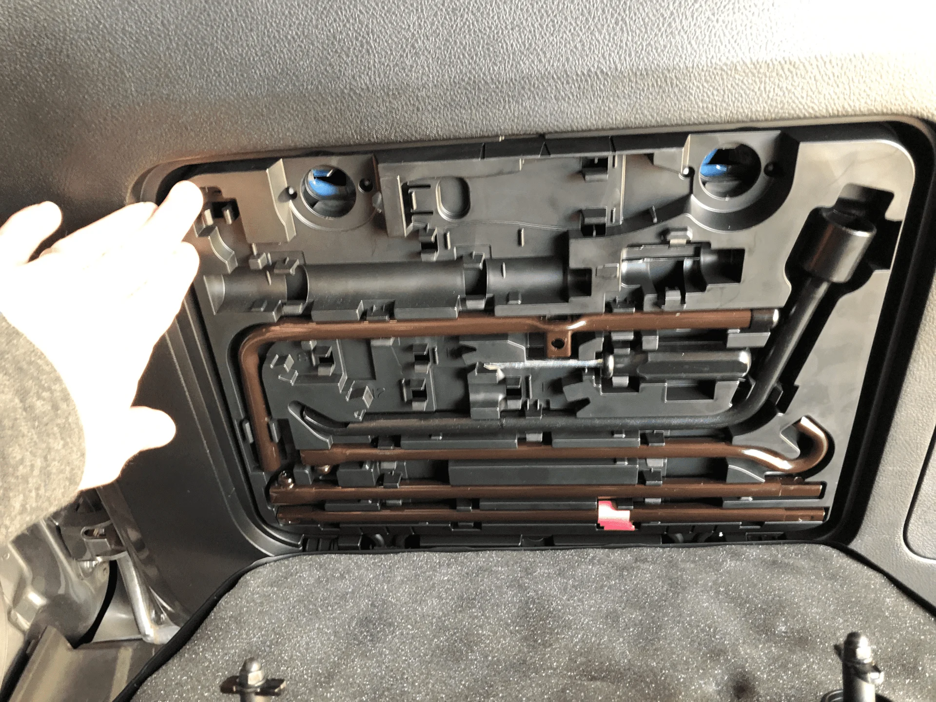

...little problem, found out the tool kit seems to be missing some items (along with the socket for the anti theft lugs). I called the dealership in Mission Viejo where I purchased it and they are disputing these tools are missing and say that is how the kit comes (even though it appears there are places for pliers and several other items missing. Also I am not sure if the first aid kit was the only item in the other storage area. However, I could be wrong (have been many times in my life), so maybe someone can help me to know what is supposed to be in the kit or where to order the missing tools...?
Kind of disappointed in the level of customer service through the whole process and expected at least a little of the Lexus customer experience to at least help me order them. Other than that, I still love the rig and it will all work out.
