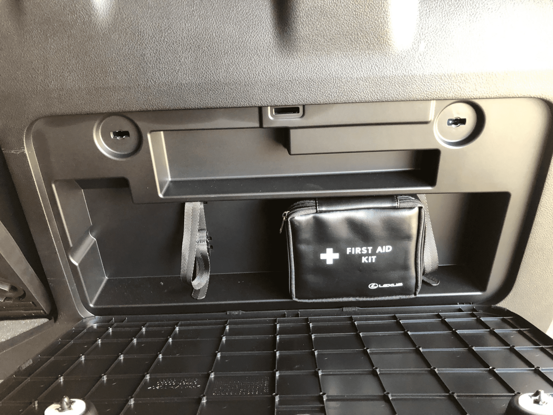

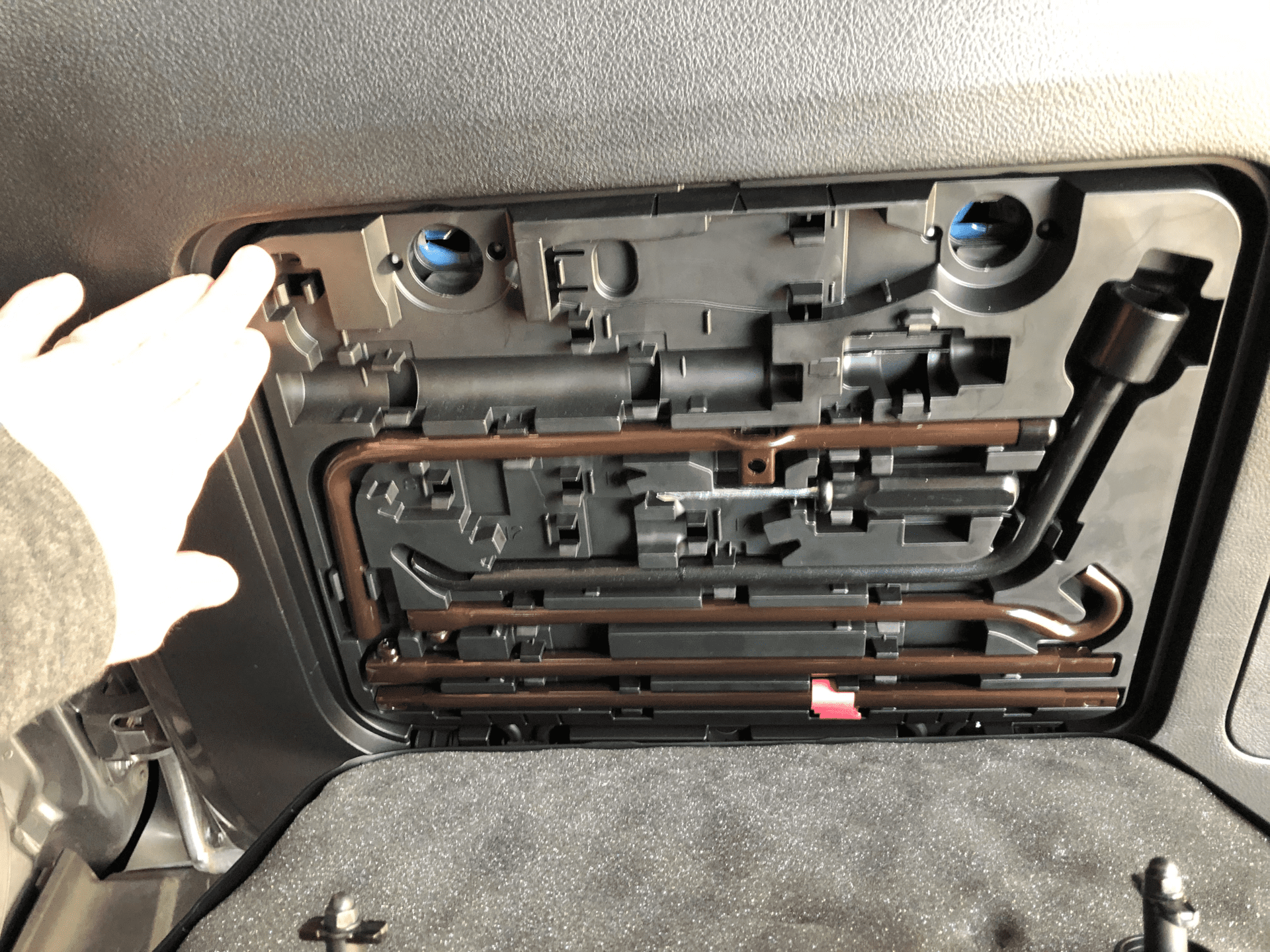

...little problem, found out the tool kit seems to be missing some items (along with the socket for the anti theft lugs). I called the dealership in Mission Viejo where I purchased it and they are disputing these tools are missing and say that is how the kit comes (even though it appears there are places for pliers and several other items missing. Also I am not sure if the first aid kit was the only item in the other storage area. However, I could be wrong (have been many times in my life), so maybe someone can help me to know what is supposed to be in the kit or where to order the missing tools...?
Kind of disappointed in the level of customer service through the whole process and expected at least a little of the Lexus customer experience to at least help me order them. Other than that, I still love the rig and it will all work out.

Also, when I purchased my GX, from a different dealer, I too was missing the same tools. The dealer may be correct that they may not come with them??
22Eyunu35VO, Thanks for the part numbers!! 👍
None of our GX460's (four in total from three different dealerships over 8 years) have ever come with those items in the tool kit. It's simple stuff, not a big deal.
Yep, I had one gx with all of the tools and this one without. No worries. At this point I have ordered the dobinsons mrr lift and trying to decide on wheels next
