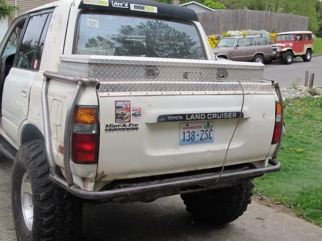

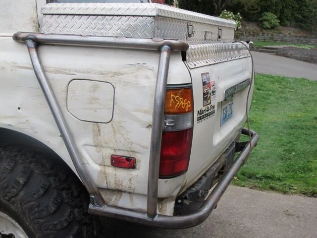

okay, so the hoop is built, and tied in to the side protection. I don't have a tubing bender so I hired someone to build that section for me.
Now I have to tie in to a 2" receiver hitch for my off-road trailer, and the winch line. I won't have any time until some customer rigs are out of the shop, so hopefully end of the week.

Here are some snaps of the tube, don't mind the dents :p I've been wheeling it like crazy for the past year, and taken some pretty tight trails here in the NW
Things to come: I have to build a 2" receiver hitch, and slot for the winch line. The top needs to be filled in with some flat steel.
