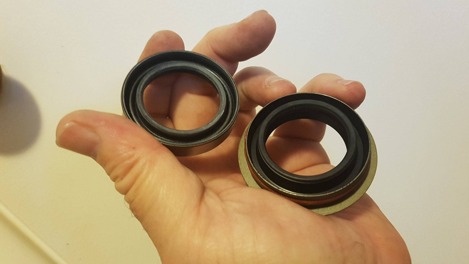

One other maybe controversial option is to install an aftermarket seal (Marlin, Trail-gear, Terrain Tamer) that is designed to place the seal lips in a different location.

Been big debates in the past on the Marlin HD seals but FWIW I installed a set of their "EcoSeals" on my 96 model over 10 years ago on grooved front axle shafts, still working.
IDK which is "best" :
Marlin link:
Trail Gear link:
