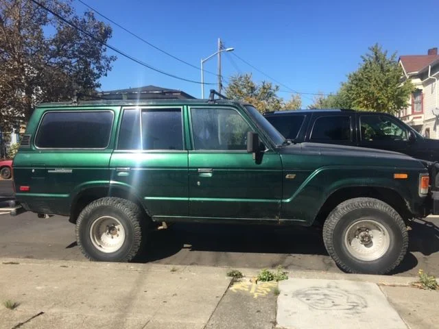

My HJ60 has been my daily driver for 8 years, now it needs a rebuild, (Blue smoke machine out the back). my problem is I am largely priced out of the diesel land cruiser platform, Breaks my heart to say it but doing all the things a have planned over the years now seems unlikely. (12HT) Evan a rebuild is out of reach at the moment (laid off), bay area prices appear to be around 4-5k or more for a full rebuild My options appear to be an attempt to fix on my own, not a rebuild but just a head gasket fix and keep rolling as is, Or sell as is. Obviously selling with a blown head is nonideal but I am interested in the forum opinion.
