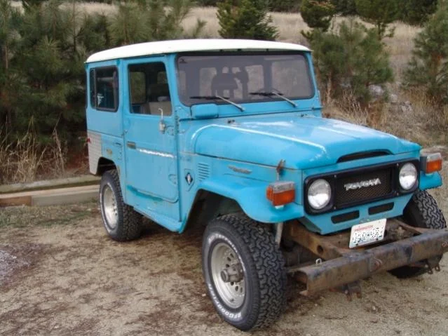

Blitz build 79 FJ 40. Rust, engine work,seats
Sep 6, 2009
1,046
Spokane,Wa

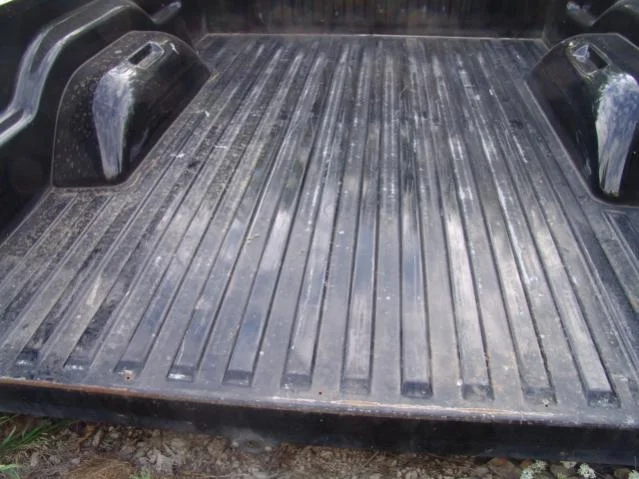

Busy schedule and not getting the FJ driveable so I will try a blitz build to get this 40 on the road. 7 days, that's all I have. I will shoot pics as I go. Haven't got the exact start date but it will be soon. Here are pics of my two best finds so far.

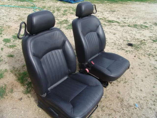

1) Seats from a 2002 Monte carlo $127 from a wrecking yard
2) Truck bed from a 90's Dodge to replace rear bed and maybe probably more. $75 off craigs.

Seats, a little history. I went to 4 or 5 places looking for seat covers and none of them fit well. One set of covers(leather) was almost $100 and still a bad fit. Finally went to the wrecking yard and found the pictured leather seats. They have a bunch of really nice seats. Brand new looking fabric seats for $67/pair. For $127 real nice leather seats are a no-brainer. It will cost me a day to install them of coarse.

Hey good looking seats! A steal at that price!! What do you plan doing in your build? Besides your super cool new gauge cluster...

Wow. Monte Carlo?!? Really?? Those look like some nice seats. Not too far off from the OEM look. I hope they're short from the mounting points to the seat surface. Looking forward to updates. Thanks for sharing.
I was wondering the same thing, They look old school, but how much work to make it fit? Since he is running a 79, might be easier to mount, but harder to drop down. I am looking froward to seeing what he can come up with.

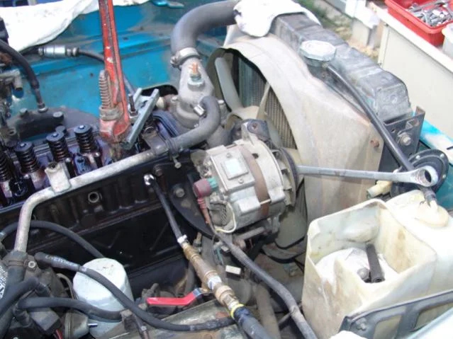

A short update, more to come when I get some other pics. This pic shows the valve seals being changed. Air 100 PSI into cylinder and a small piece of uni-strut for the lever. Got that from another post. One thing that really helped was the alternator right there, it allowed me to turn the engine over without using the crank. Once I got to rockers off, emergency brake on and all plugs removed. Here is the procedure:
1) put in neutrel, view in hole, put piston at top of travel
2) put in gear
3) attach air and turn on
4) compress spring, remove keepers, remove spring assy.
5) remove old seal, slide on protective plastic sleeve, install new seal
6) remove plastic sleeve, reinstall valve spring and keepers
7) do the other spring on that cylinder
The initial problem was this thing smoking like a tire fire so I found that the seals were loose. Well, the PO just slide the seals on and did not seat them with a hammer. They were just sitting there. So I fixed that, put it all back together and ......:mad:.... it still smokes, not as bad but bad enough. So I have pulled it back down and the next pics will be with the head off. While getting ready to pull the head the intake/exhaust manifold came off and I noticed that #4 exhaust is oily wet. That is my smoker. I also noticed that #4 is also right next to the oil feed to the rockers...Hmmm

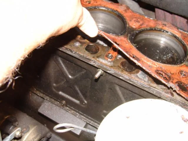

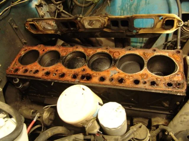

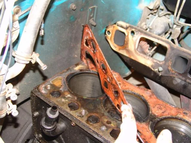

Oh man! it's a fully coated high temp silicone head gasket( both sides). The good side of this story is that I can have both sides clean in 20 minutes. I'm surprised water even got to the head, looks like some of the passages are closed up.
OK. The ridge is pretty good, I can just catch a fingernail. I am open for comments. Think I should pop on a new head gasket and put it back together? The PO said the head was just done, and the PO-PO had the crank replaced so I presume that they did the ring job. Hmm.

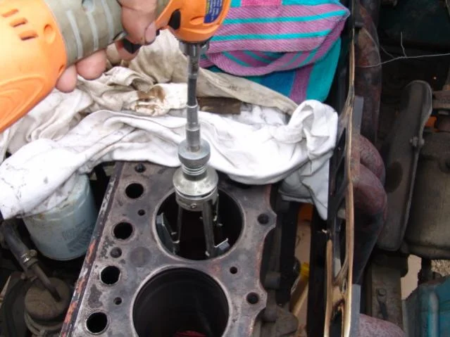

Got 1 piston cleaned up, 5 to go. Found 1 broken compression ring, 2 seized oil rings, 2 pistons with both compression rings lined up.
The good news is that I picked up some rod bearing (.010 over because the crank has been turned down) and I have all the stuff to put it back together.

Those are great looking seats, I would love to know how tall they are from the mounting point to the front edge of the seat. I am just starting the search for seats for my 40.

5 1/2 would be perfect for me. I had been running seats out of a Saab but they were almost 10 inches tall. I had to do some real mods to my custom seat bracket to make me able to fit under the steering wheel.

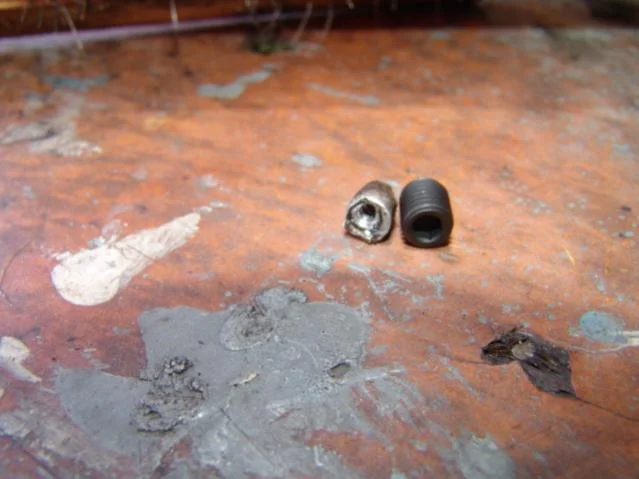

Got the engine put back together and started. Yes! It runs but I need to work on the carb.
Here is a shot of the plug that everone needs to replace in their heads. There are many threads about this. Since I had the head off it was time, I was amazed at how easy this pressed in plug came out. Confirmation on replacement procedure, drill the center, pull the plug out with make-shift slide hammer, tap 5/16-24, screw in a set screw. Piece a cake. Thanks forum.
