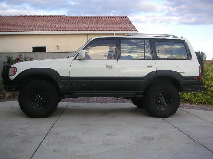

are those 15" wheels? how did you get them to fit?
what size tires are you running.
the all black looks cool.

I'm thinking about going this route. How much did it cost you guys to get five rims powder coated ? Any chiping ? what should I look out for ? I have a chance to pick up a set of Lx450 rims anyone had these powder coated ? thanks in advance

Yup. In my case, I bought the Eastwood Hotcoat system for about $100. 2lbs of semi-gloss black powder was plenty to do five rims and dozens of little parts for about $25. I got a side-of-the-road oven for free and I already had a sandblaster cabinet. The center caps are painted with Plasticoat semi-gloss black paint made for plastic.
Ali's are LX rims.
I have had some chipping from wheel weights. Easy to fix. Ali has had some issues with the lug nuts rubbing off the powdercoat. I'm not sure that's a bad thing.

Had mine powder coated and rattle canned the caps to cover the bling. No chipping as of yet.
