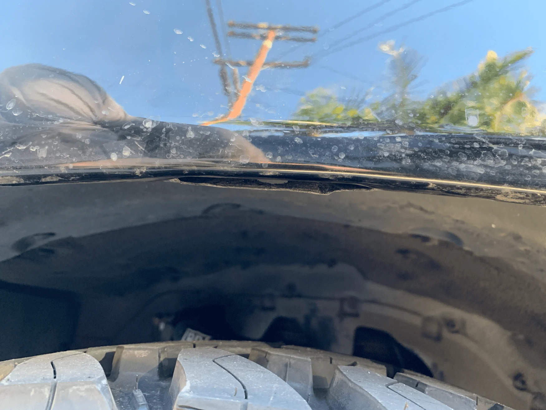

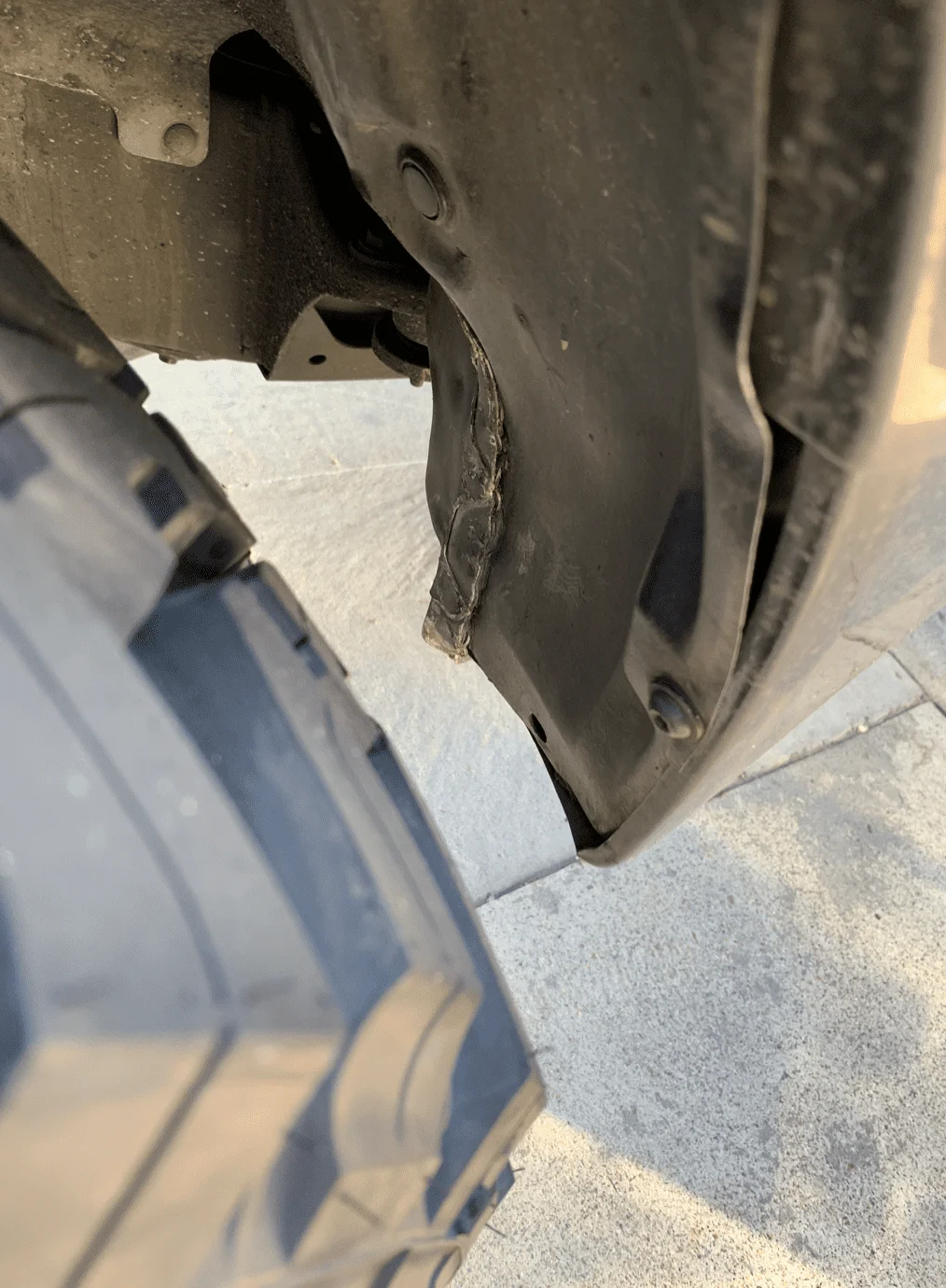

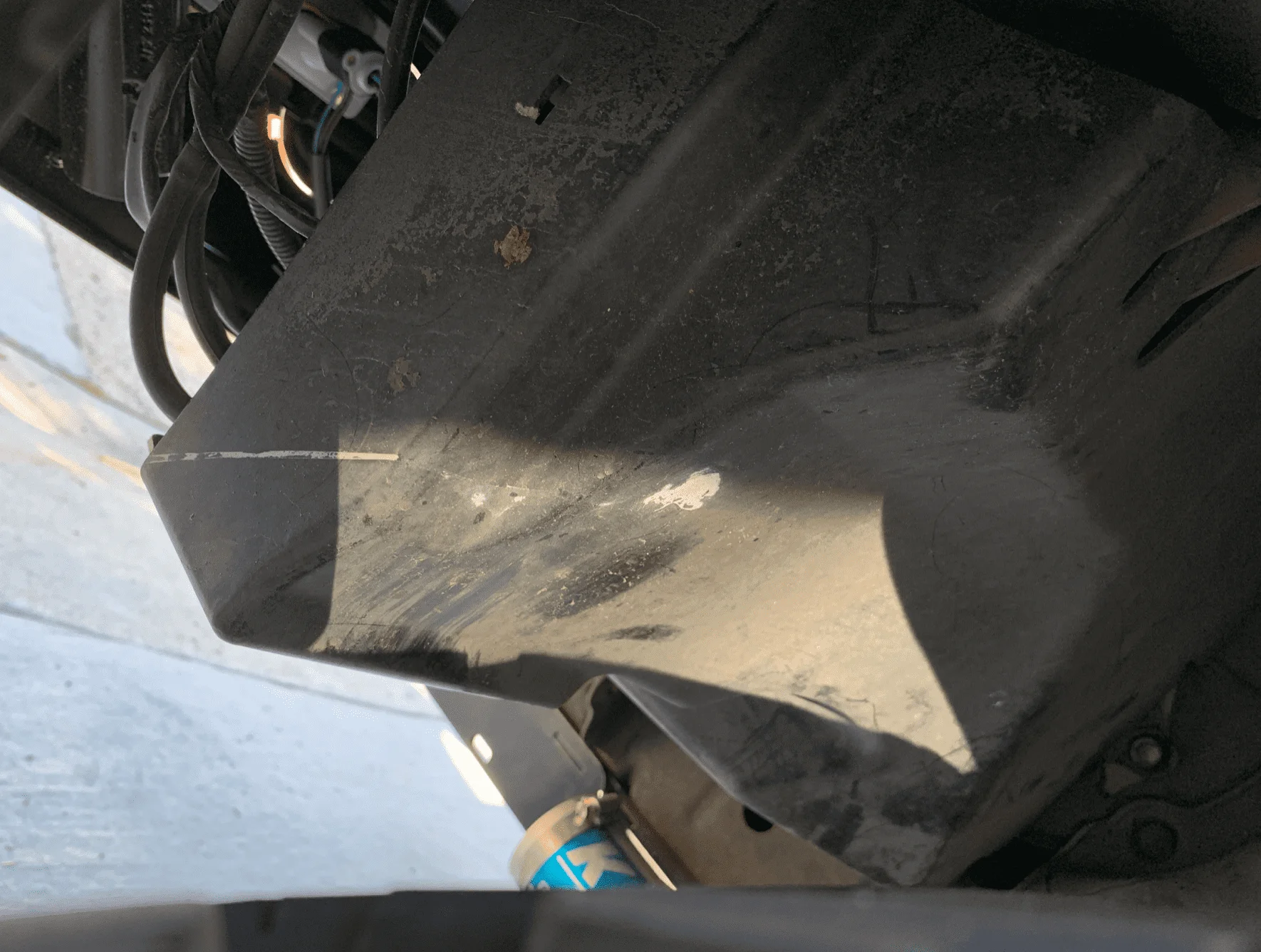

Ok here are some pics –
Looks like it's hitting the washer fluid reservoir and maybe the pinch weld mods. Probably need to push those back more or cut more out.

Front of driver side tire:

Pinch weld mods

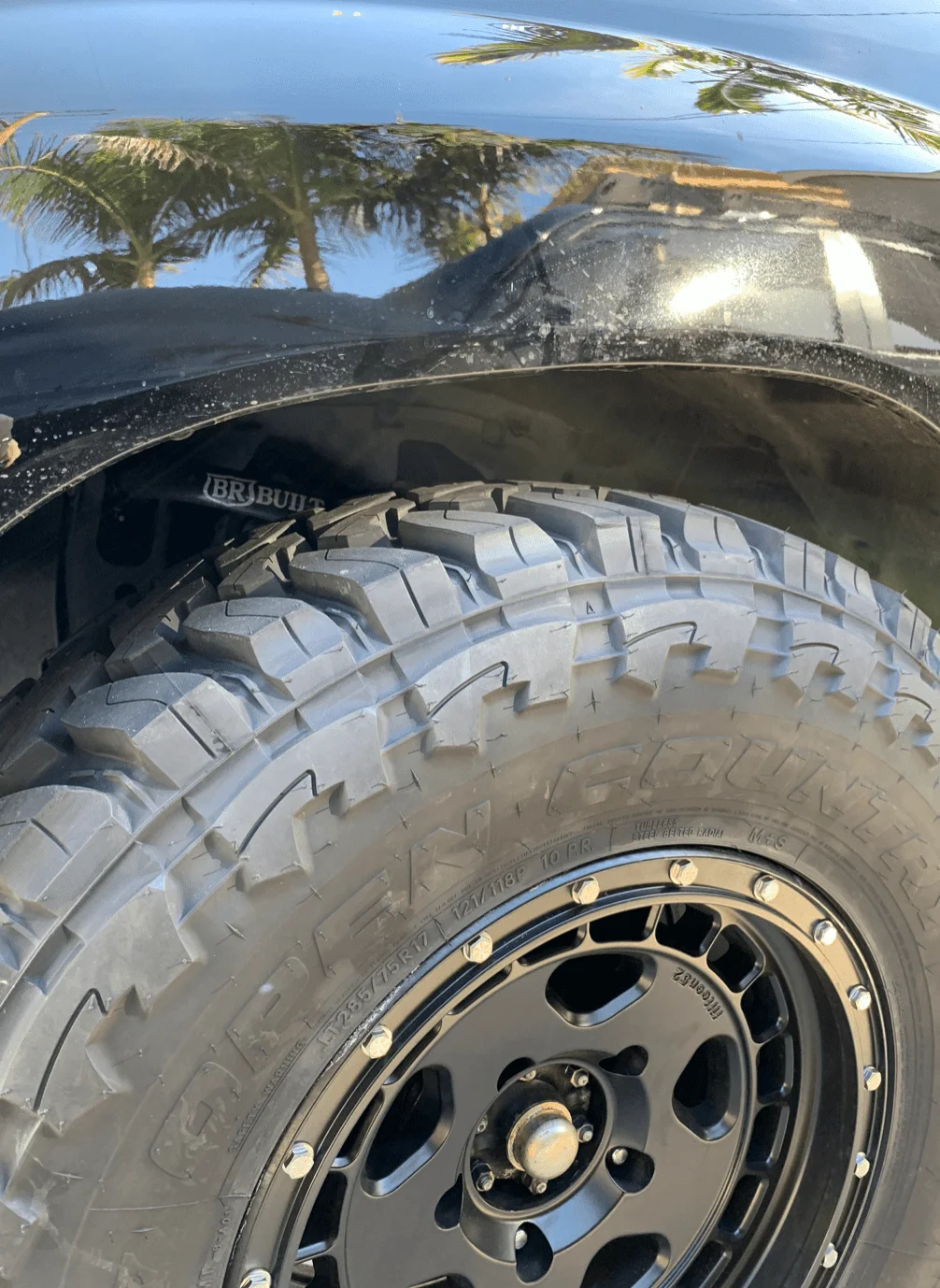

Current distance in front.

You should be closer to 21.5-22" front hub to fender.
My guess would be your torsion bars need to be reindexed.
Pinch weld mods
