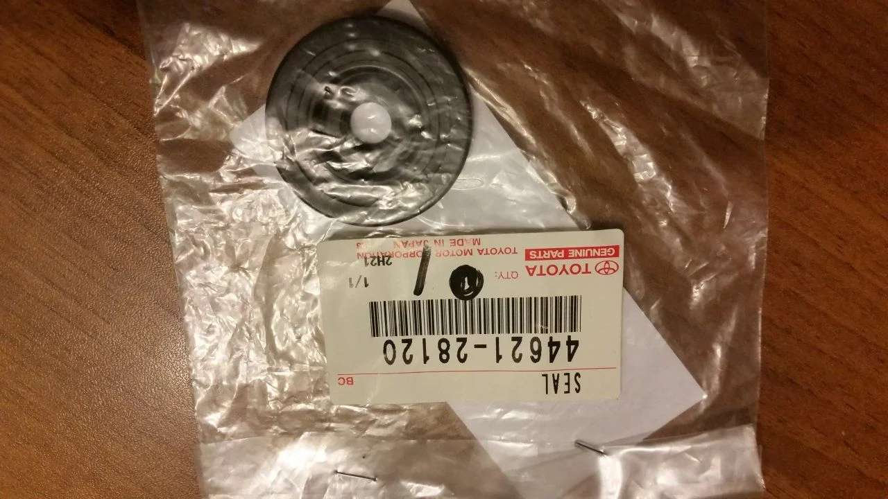

x2, just had to do a new clutch booster output seal (resolved my engine failure to shut down issue :cool:
Booster R&R was under an hour.
Looks like my booster is not holding full vacum now after replacing master and adjusting pedal height etc, worked fine until yesterday, clutch engagement is not heavy and works great, although donk won't shut off, The shutter valve only half closes, when ignition off
I took off the hose from canister to booster, and thumbed over canister pipe, engine shut down immediately, thus indicating booster leak and from what I'm reading above, hopefully it's just the seal?? Anyone got the part number for this seal ..
44621-28120

Thanks Malahki, I will keep that handy, I took ot out master again and corrected the booster push rod to the piston within master, and once I put it back together, it seemed vacum returned to booster, time will though,
