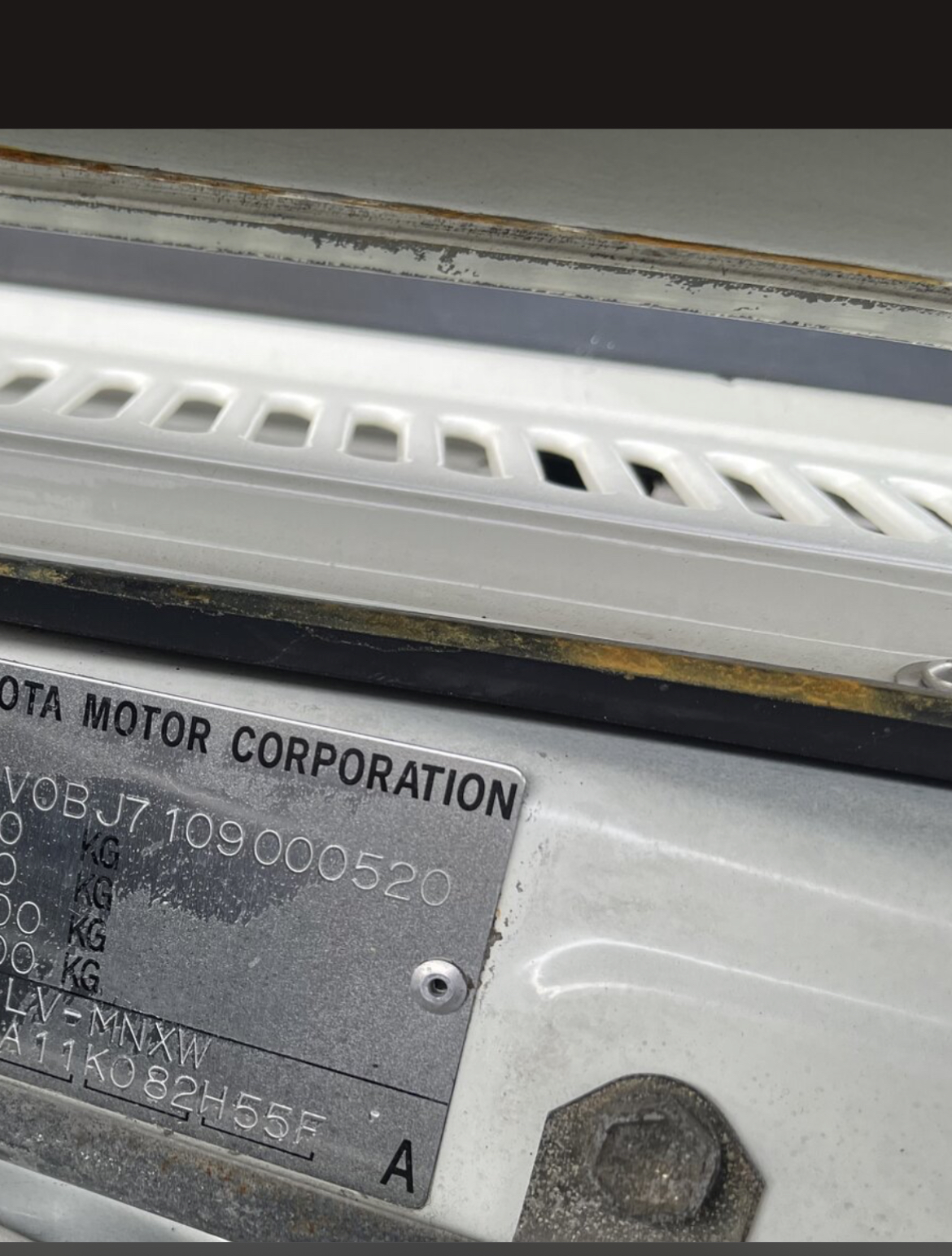

The vehicle has been pimped up and repainted to primarily look nice. Optical parts (e.g. door catches, shift lever boots) have been replaced. Paintjob looks OK.
It has been looking much worse before, I guess. The carpet (holes in it and stain that I suspect to be rust), seat consoles (rust where paint is gone, fully rusted springs), rear light frames, hub dials (all badly scratched), inner wheel wells, drive-shafts (rust, rusted nuts, obviously hasn't been out for a long time), steering linkage (scratches from pipe wrench, so obviously was seized up): All that are telltale of a rather hard life.
I don't think the odo teller shows a ligit figure. I guess at least 100k km, maybe 200k km are 'missing'.
Not much was done in technical terms:
Some hoses replaced with what appeares to had been at hand. Gaffatape, really? Too big non-automotive hoseclamps all over the place. (The originals usually can be cleaned and reused, though; even worked on my 320k km BJ73 from 1985. Not done. Obviously no love invested, or they where really badly rusted.)
Battery clamps are mangled, wiring not original, I do not see fusible links?
It was made sure it runs for some time, but I doubt any thorough basic maintenance was done.
Underbody was cleaned, but nothing was done to it. Suspension and axles painted, steering gear was overhauled.
The pic with the wheel well and the exhaust pipe, left bottom corner: Is that even rust?
The underbody coating in the wheel wells is all brittle and partially gone. My 320k km BJ73 from 1985 looked better there.
Bonus: Interior complete and nice. Exterior nice. No evidence on the quality of the bodywork underneath, though, but at least the door edges and drain holes look ligit.
Mechanical acceptable base, but I'd expect extra investment to be required, as I suspect a much higher milage.
For that ask price, I won't buy it blind / based on pics only.
Bodywork to be checked with magnet and paint thickness gauge. Some covers to be removed to take a glimpse into cavities. A closer look into the frame rails and crossmember tubes.
Engine pressure test, engine 'soundcheck', testdrive, brake inspection & -test, closer look on the harness (no pics and battery connections don't look promising) and on brakelines and fuellines, tank.

The truck looks good on the surface. As it is mentioned above, perhaps it is too clean to be true.
There are corrosion spots here and there, despite the paint job.
Three details make me wonder about what lurks below the paint job, namely
  1. The suspension seat mechanism has rust on it.
  2. The rear gutter looks too clean.
  3. Wheel wells look suspicious.
  4. The shafts have corrosion, whereas the rest of the drive train looks resprayed.
I would take the mat out to have a look. I would have a detailed look at all the sprayed parts. And I would negotiate the price.
Juan
And the gutters, rust spot outside on the top and inside along doors.
Will only get worst
A small body part missing at the back bellow right side door (arch shape gusset) I think it been repainted too. At that price, should come with an historic of what have been done. Now it is clear work done was to increase value.
