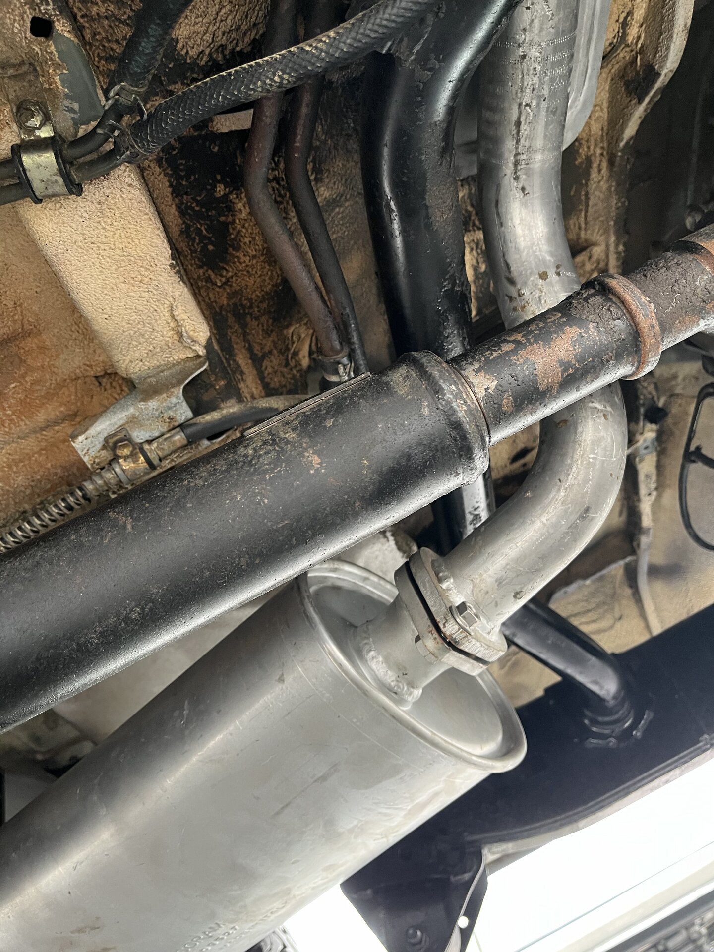

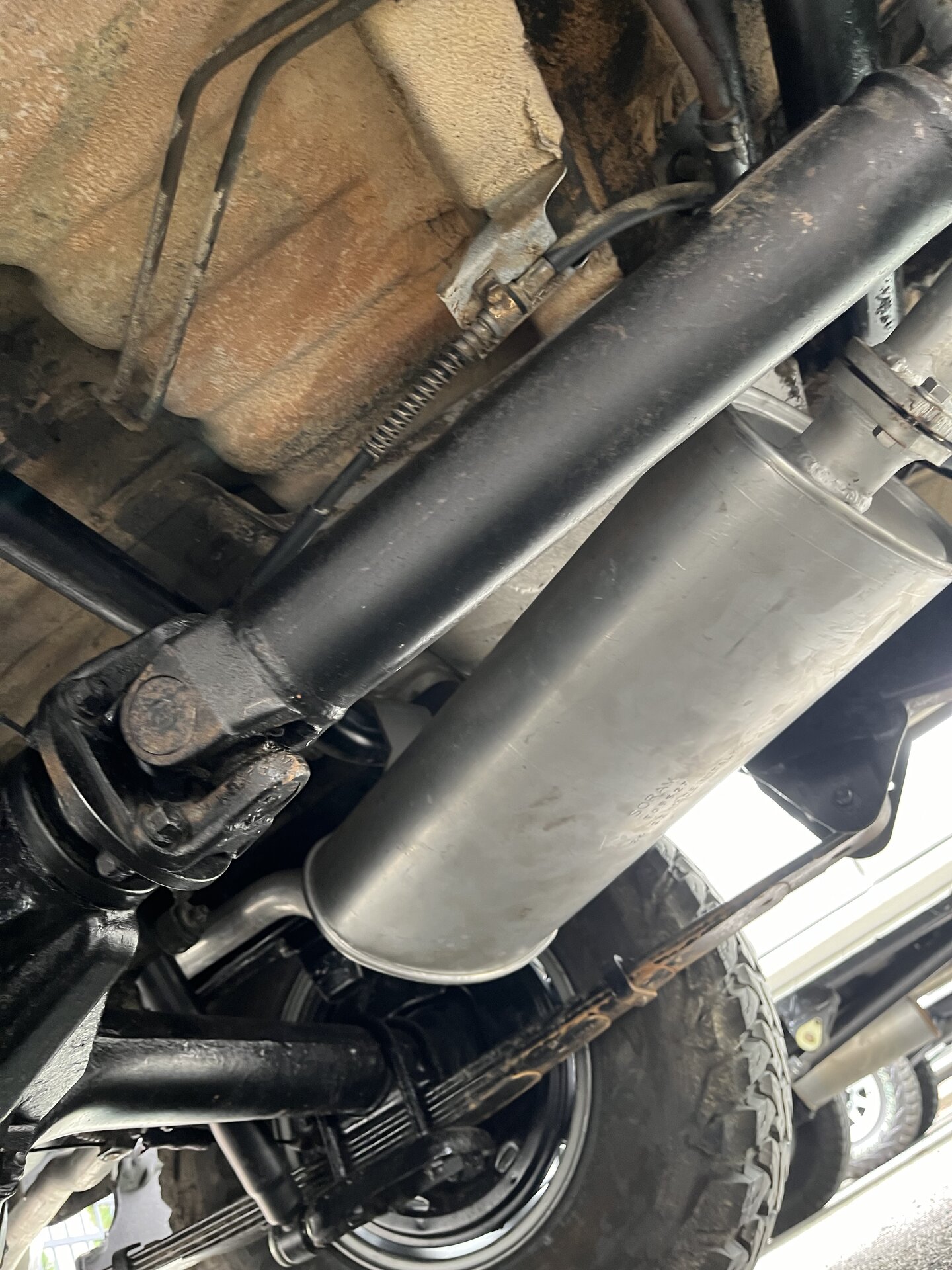

Of course, we need pictures, especially the underside.

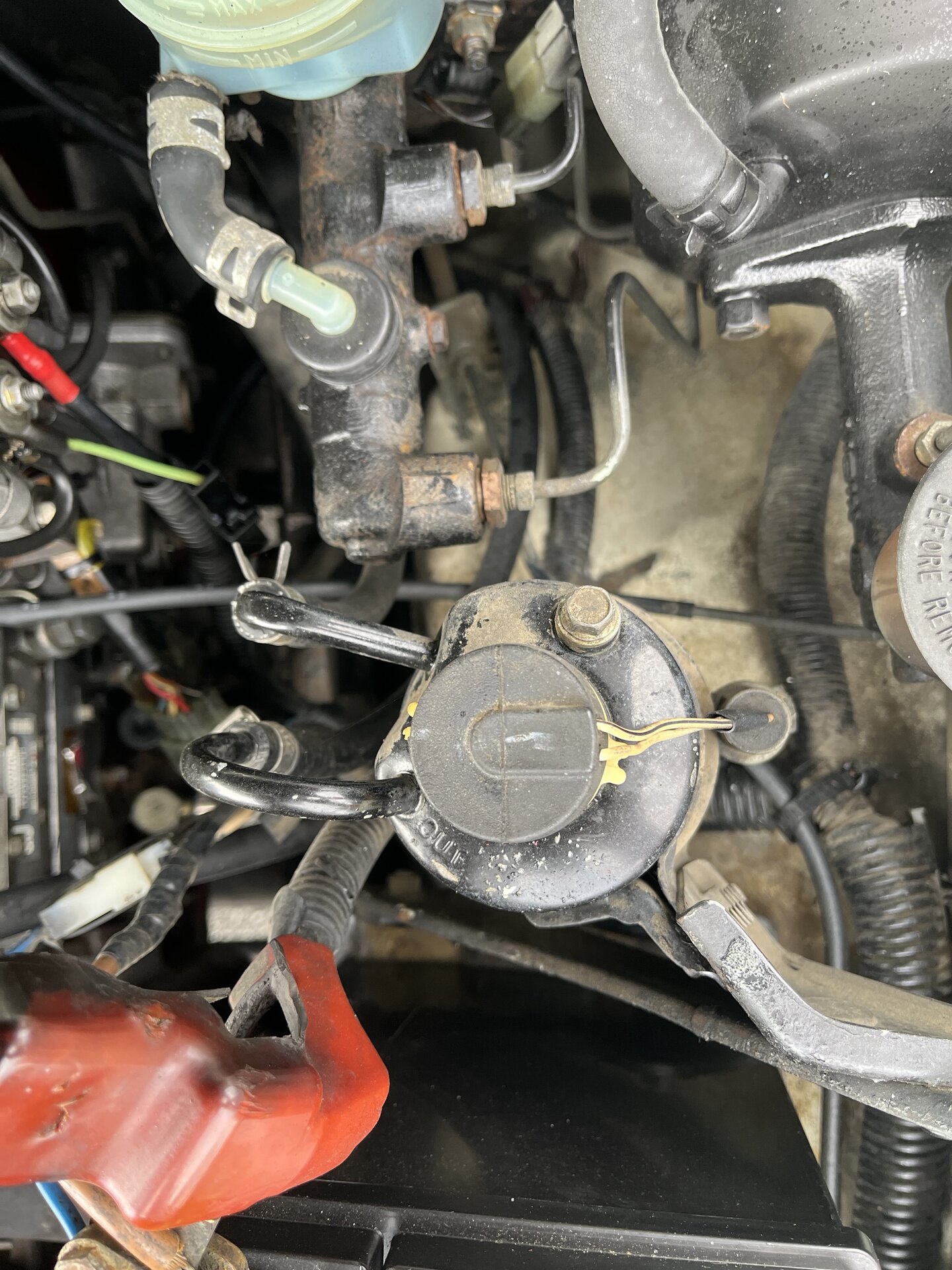

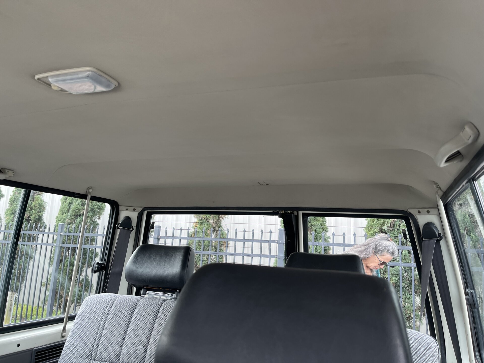

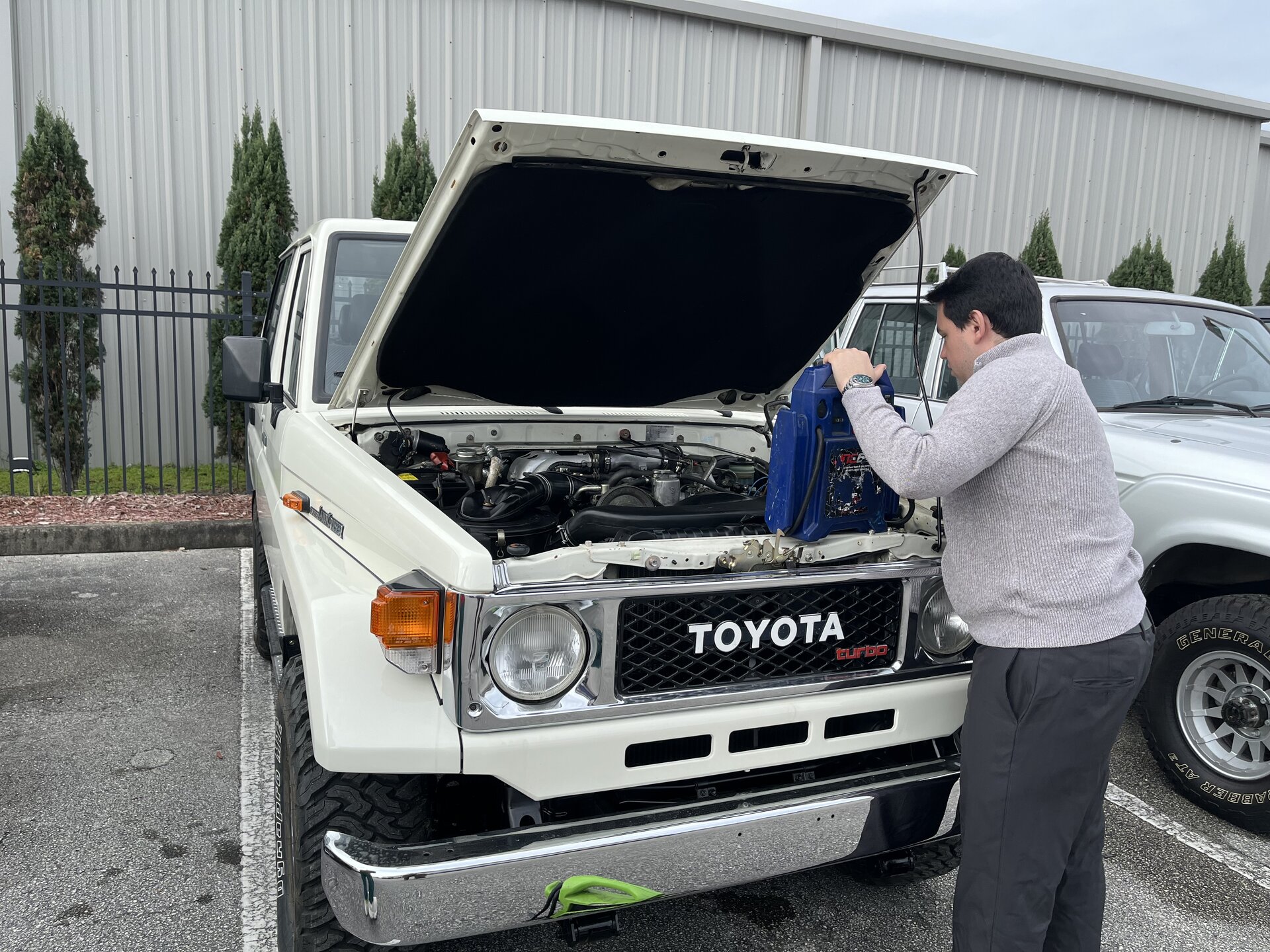

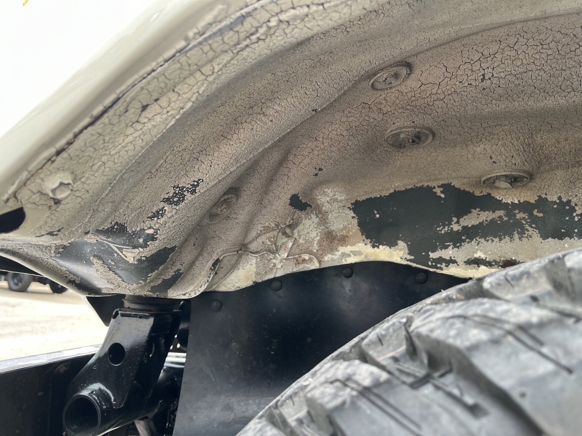

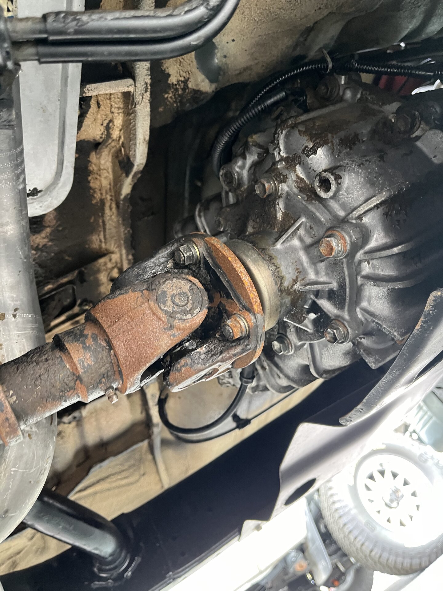

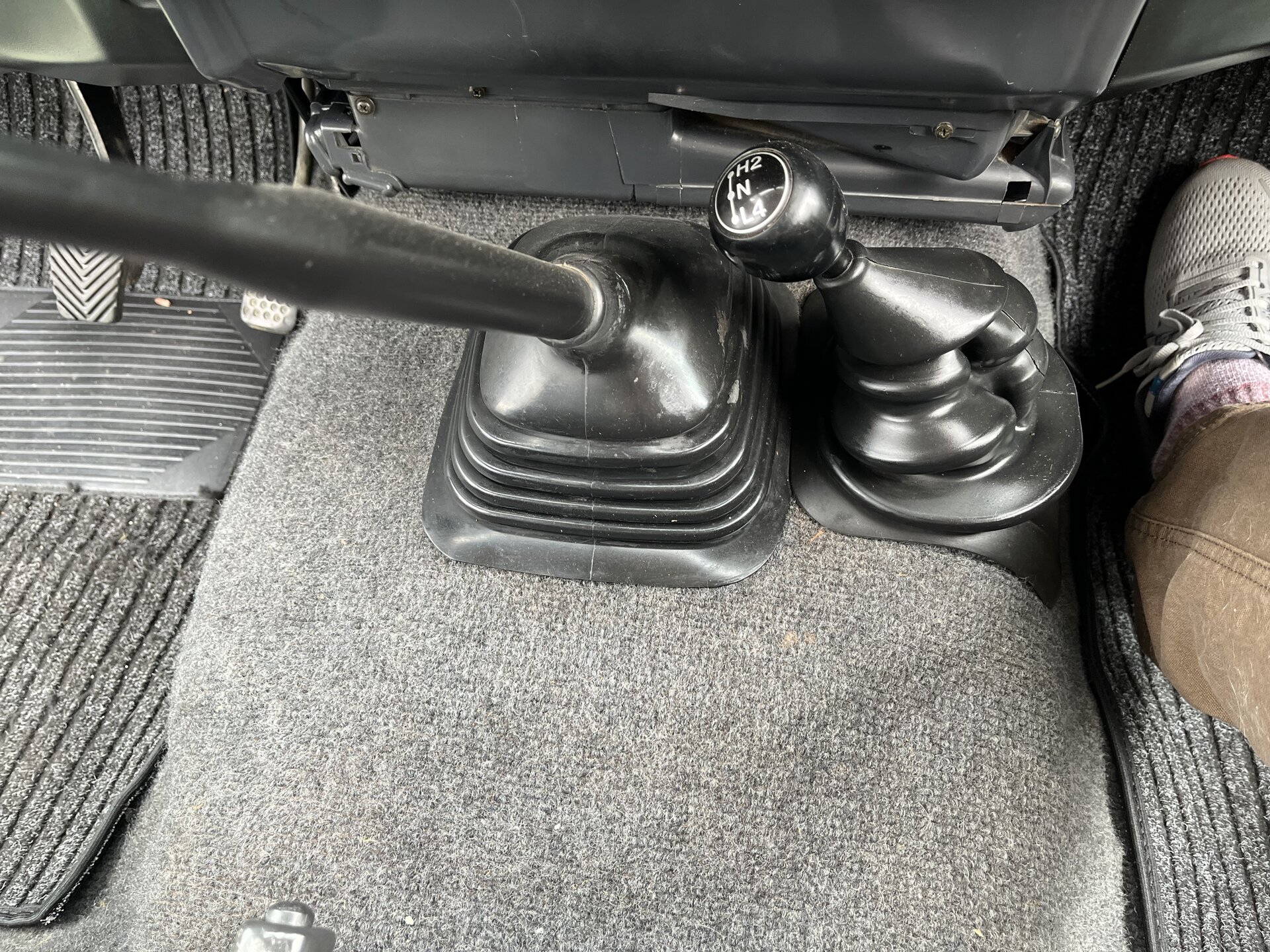

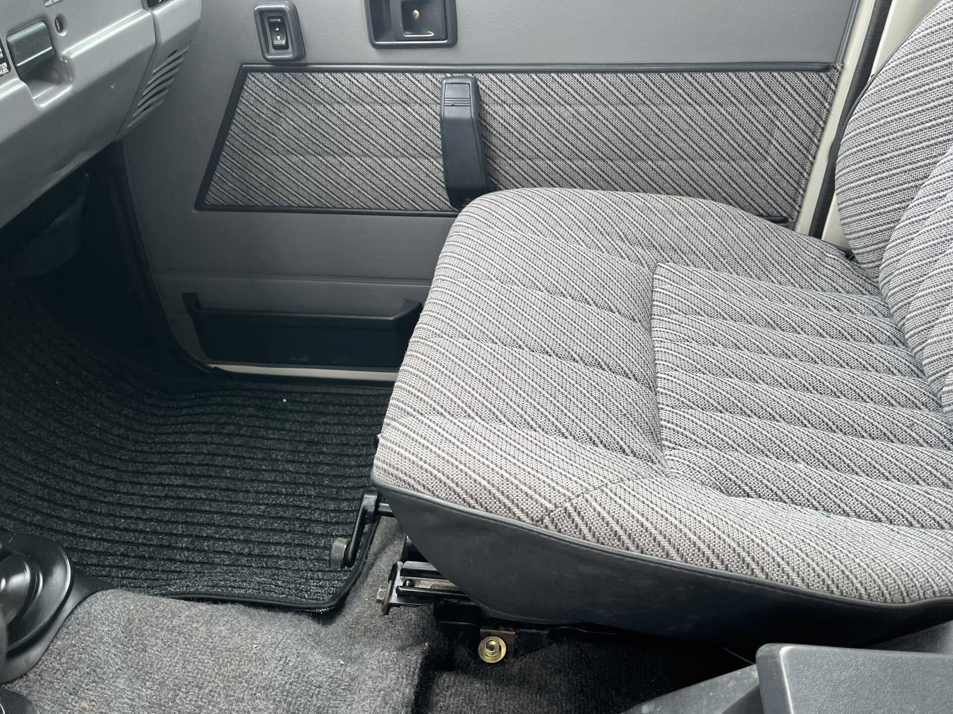

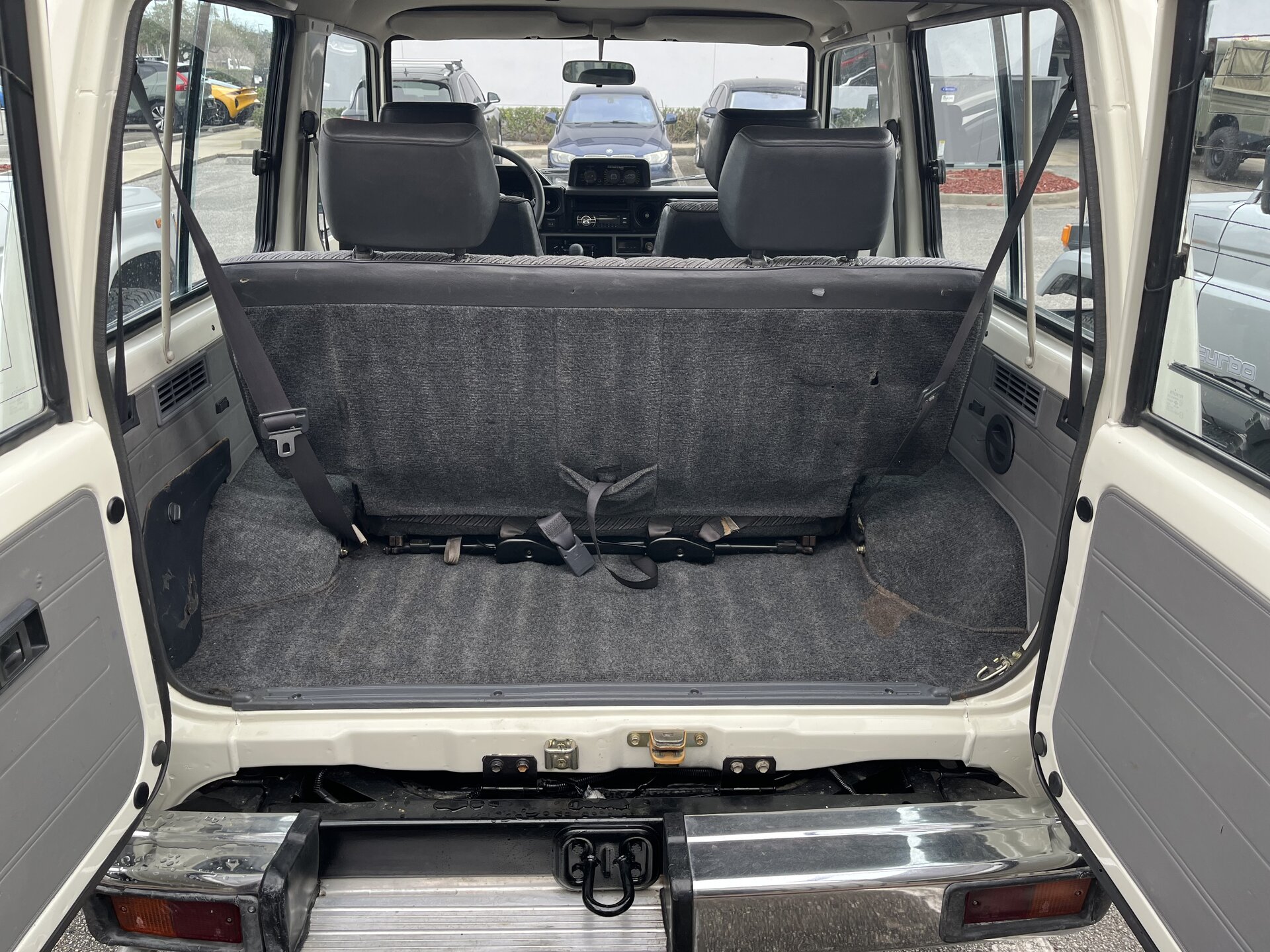

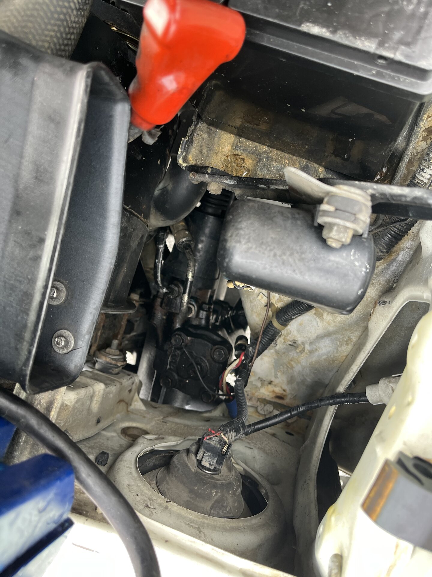

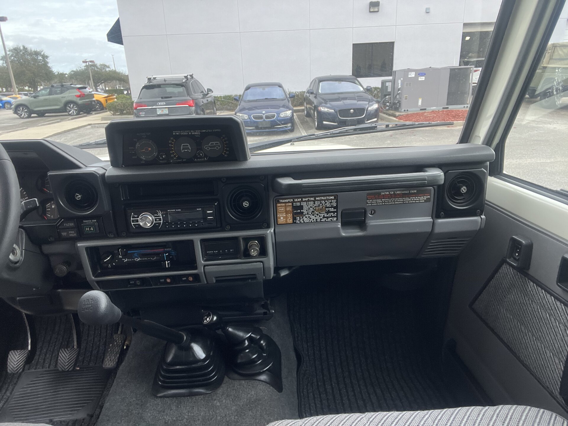

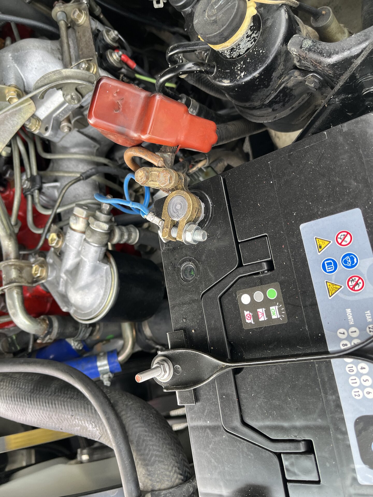

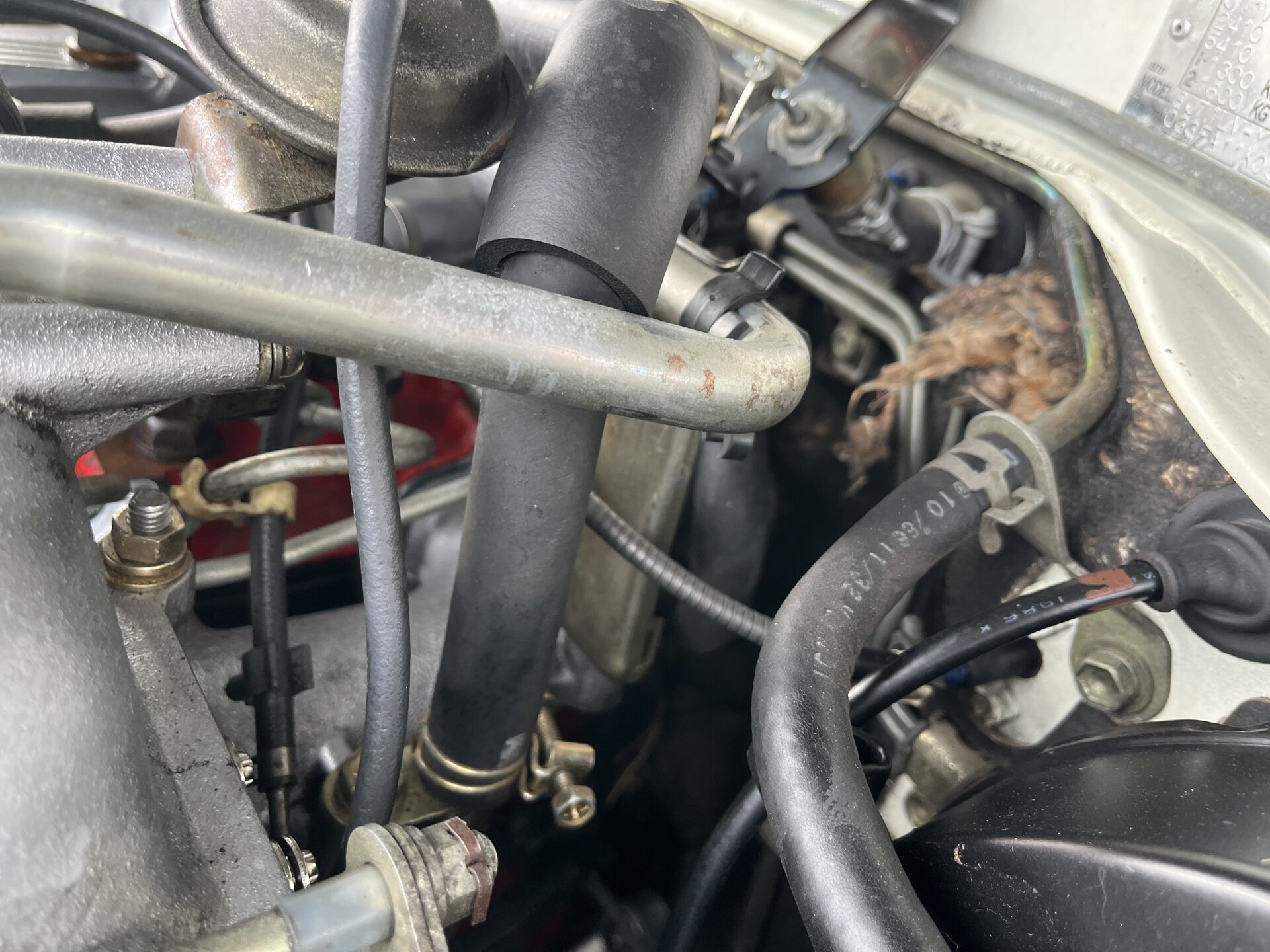

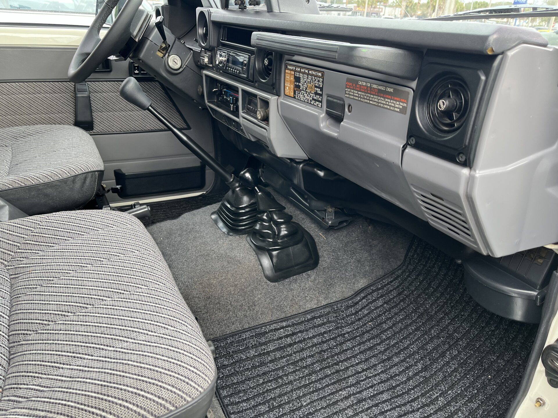

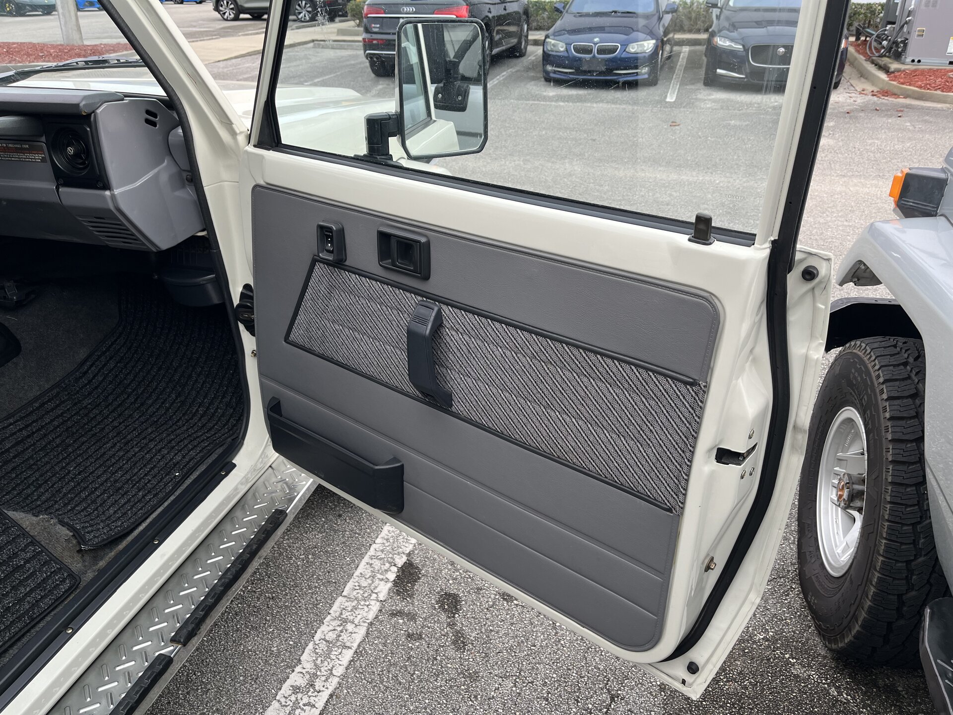

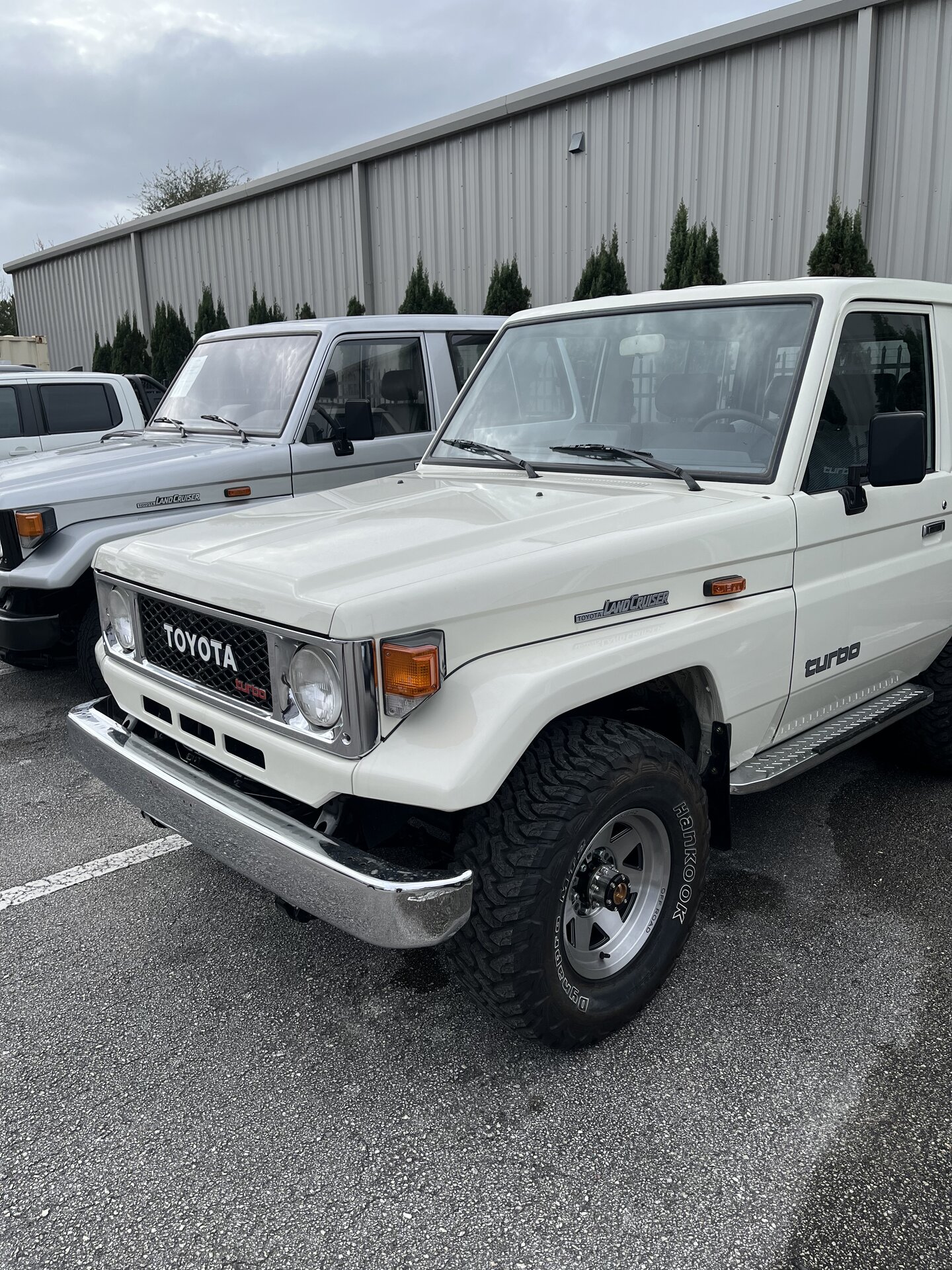

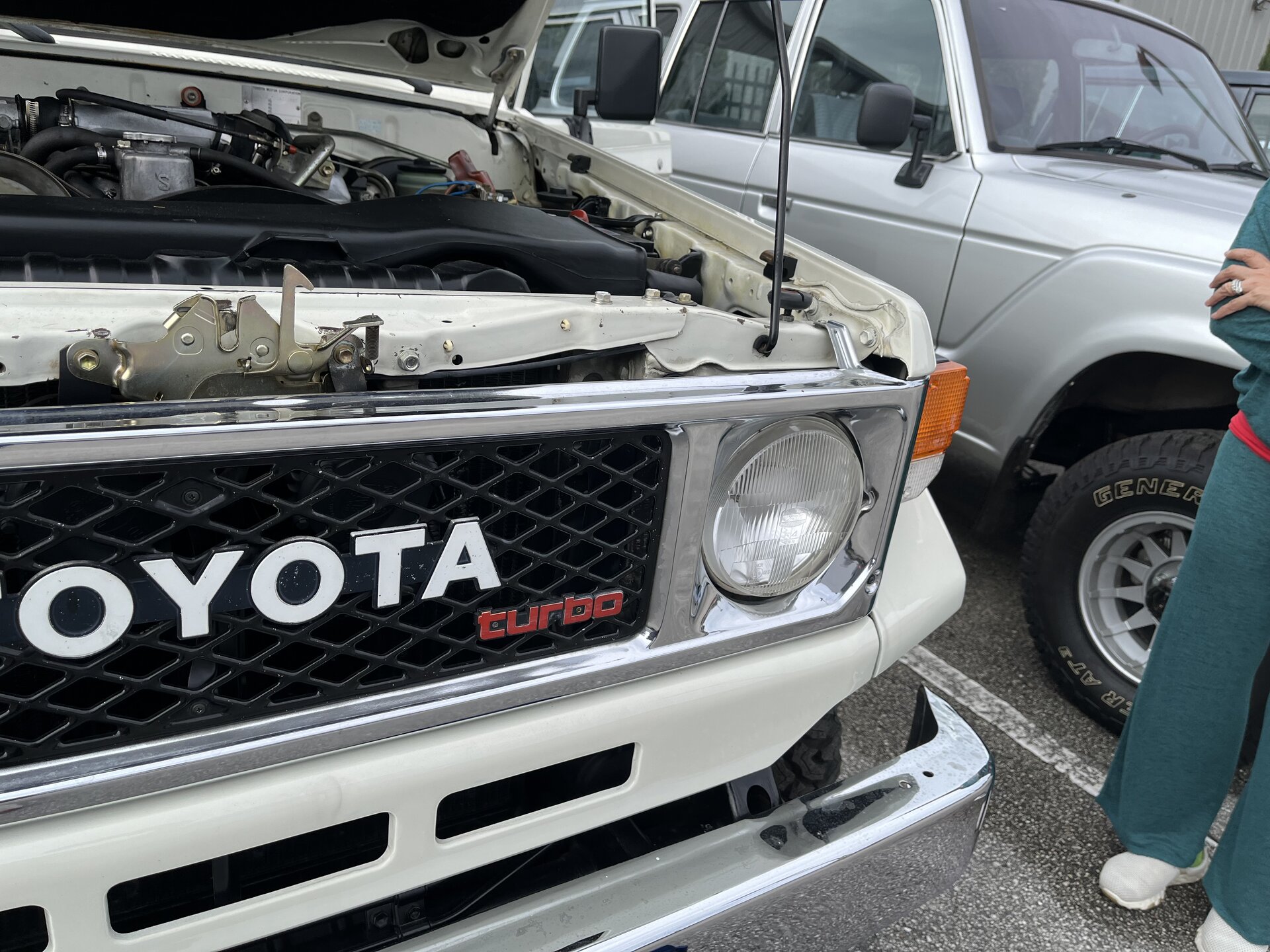

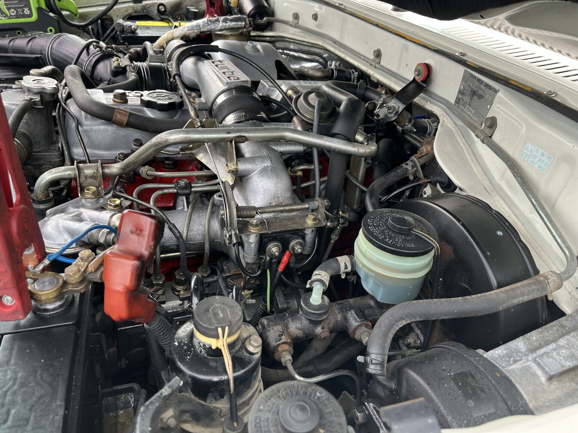

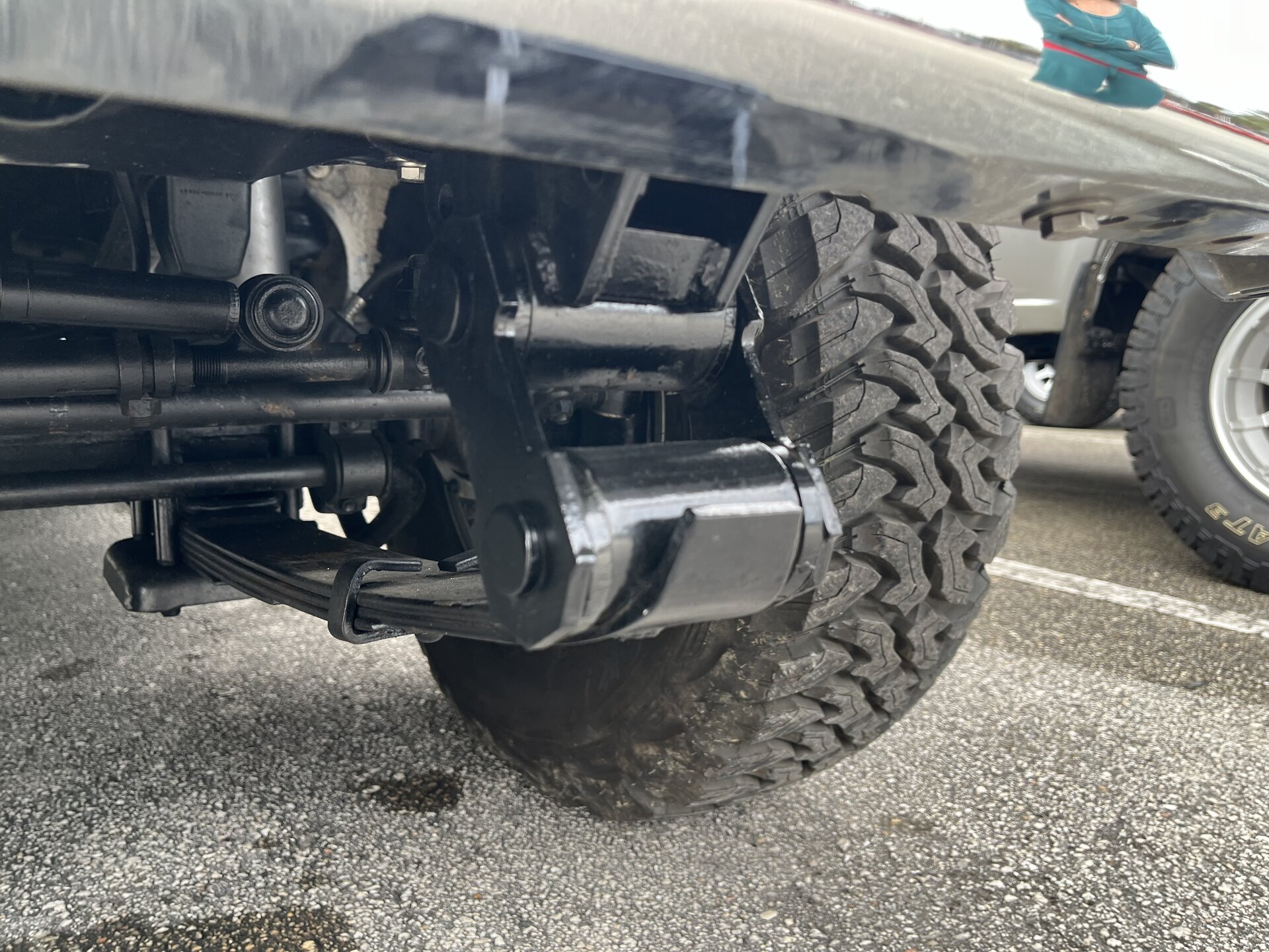

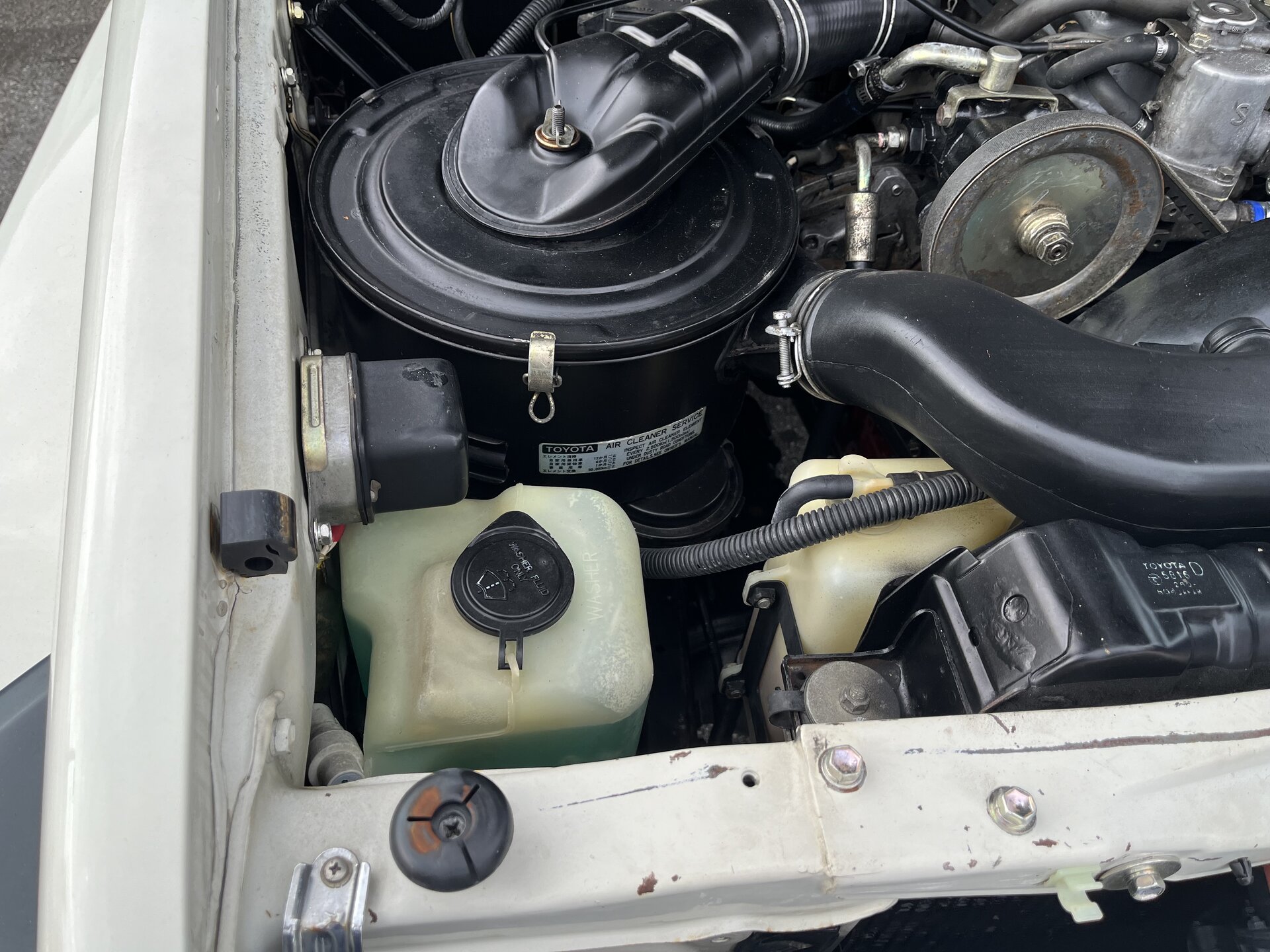

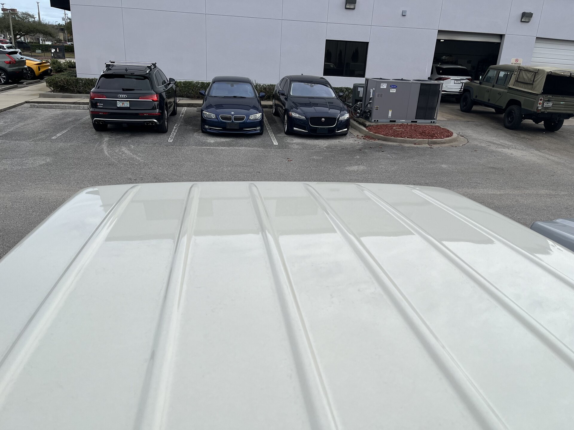

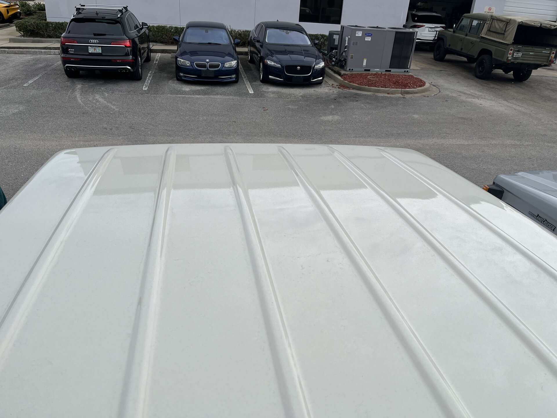

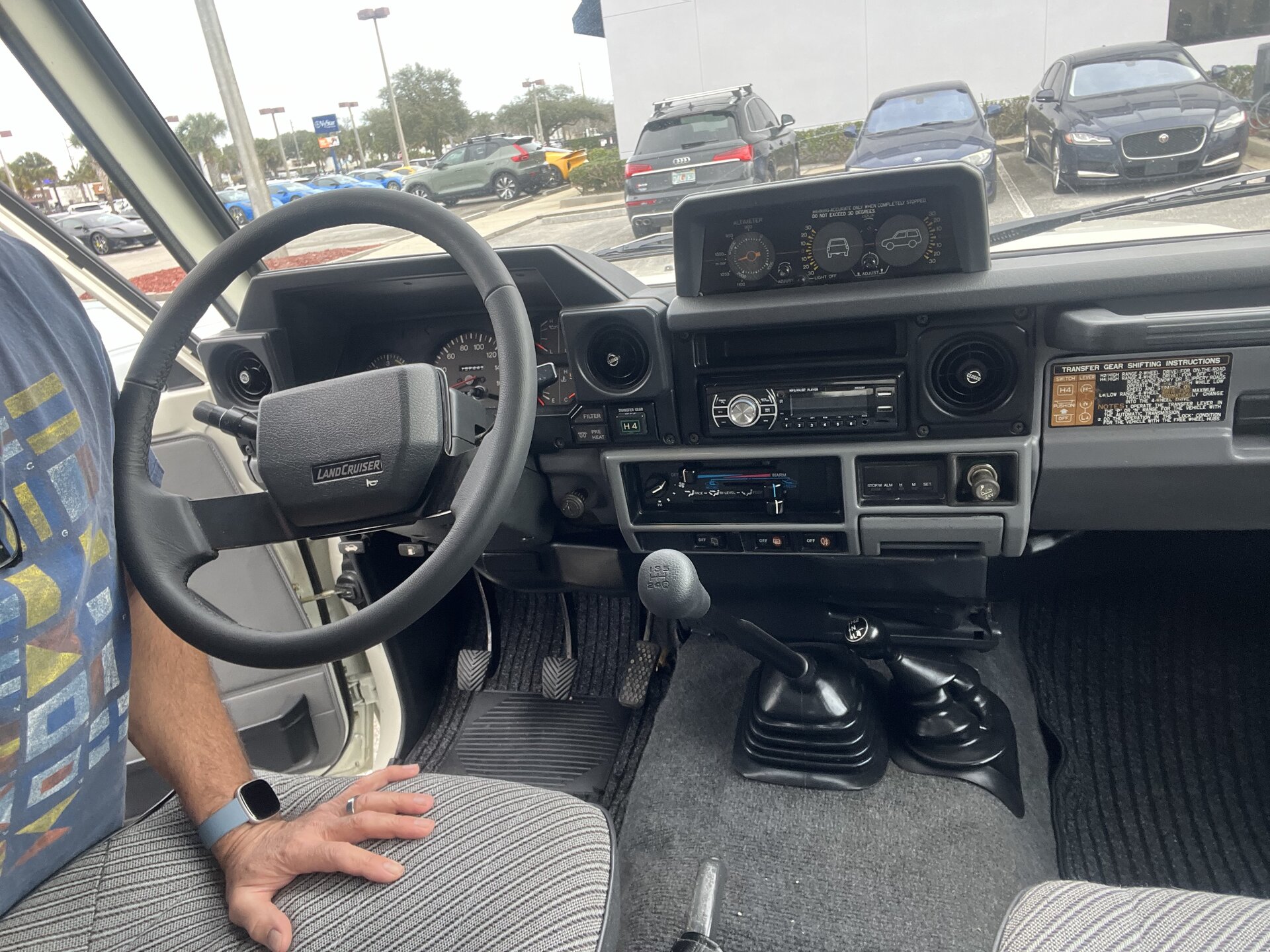

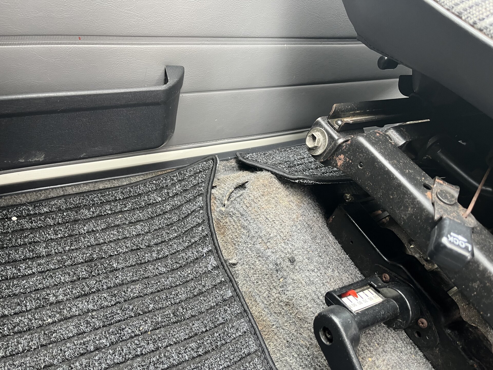

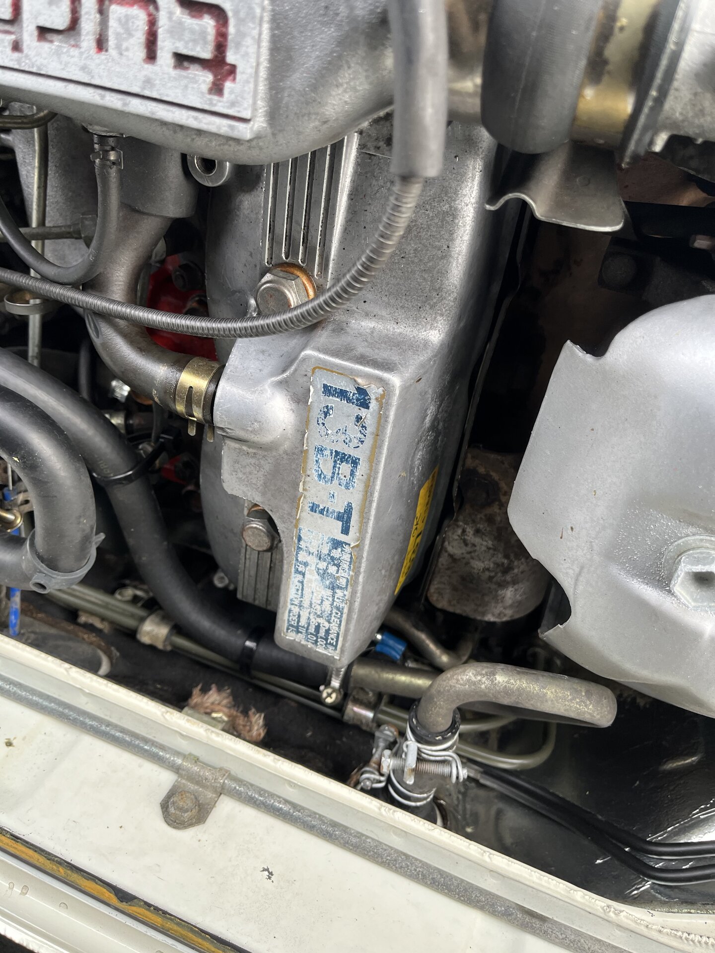

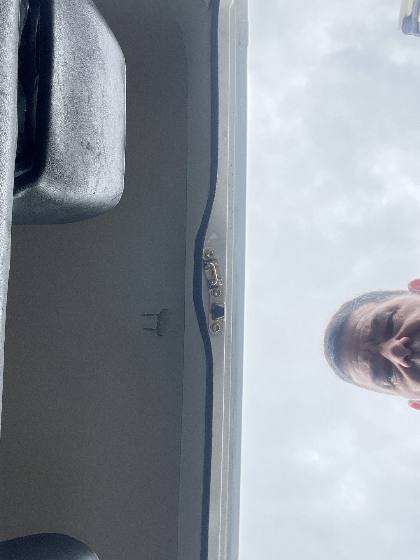

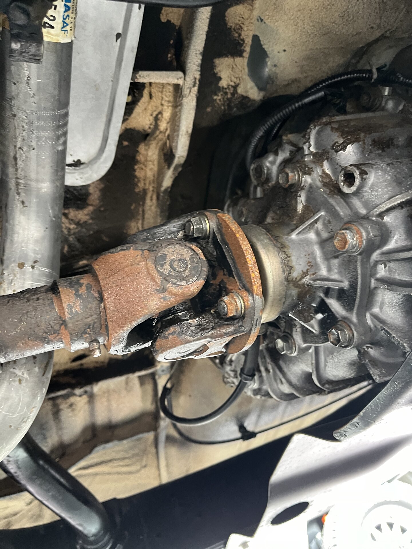

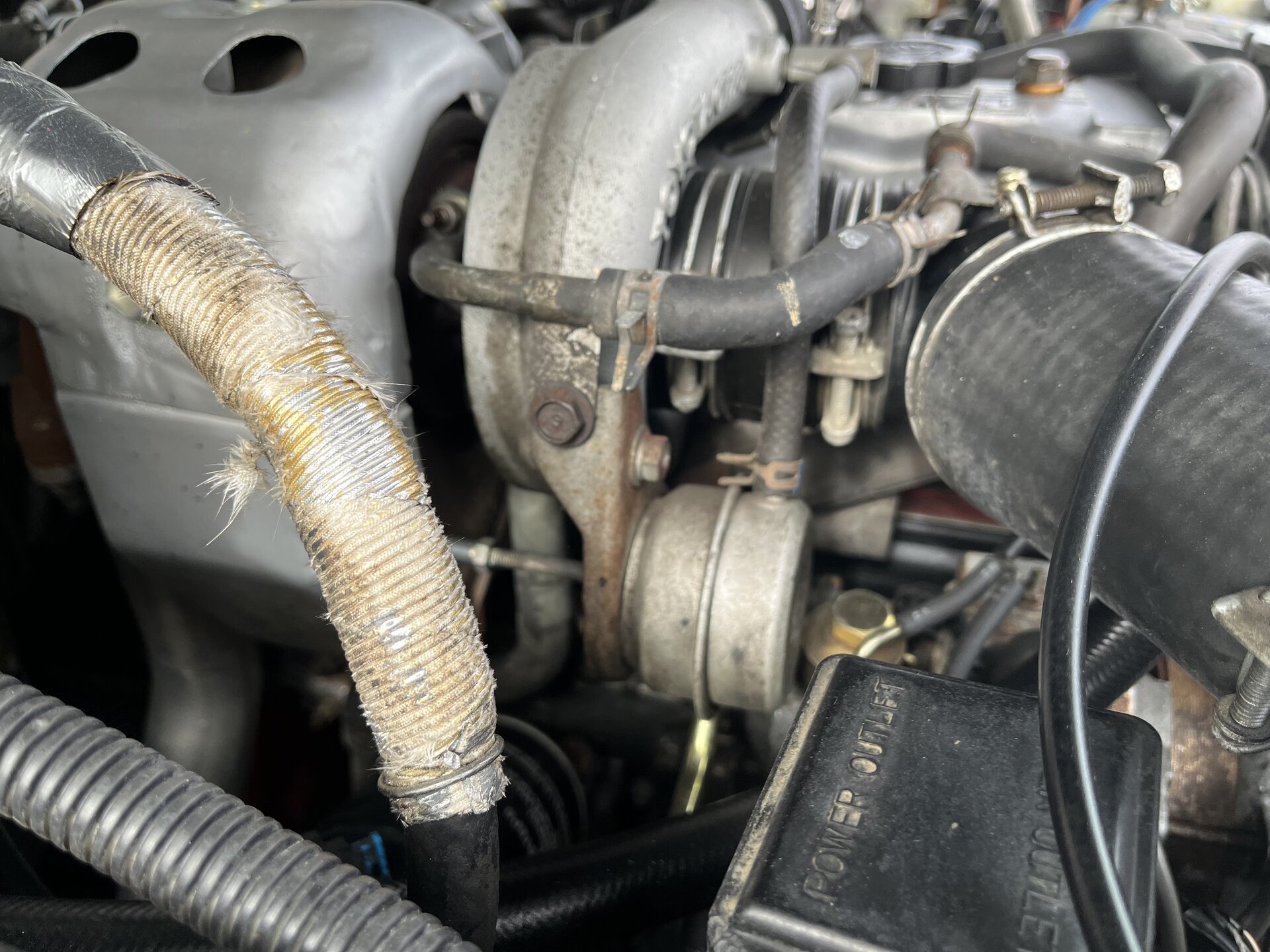

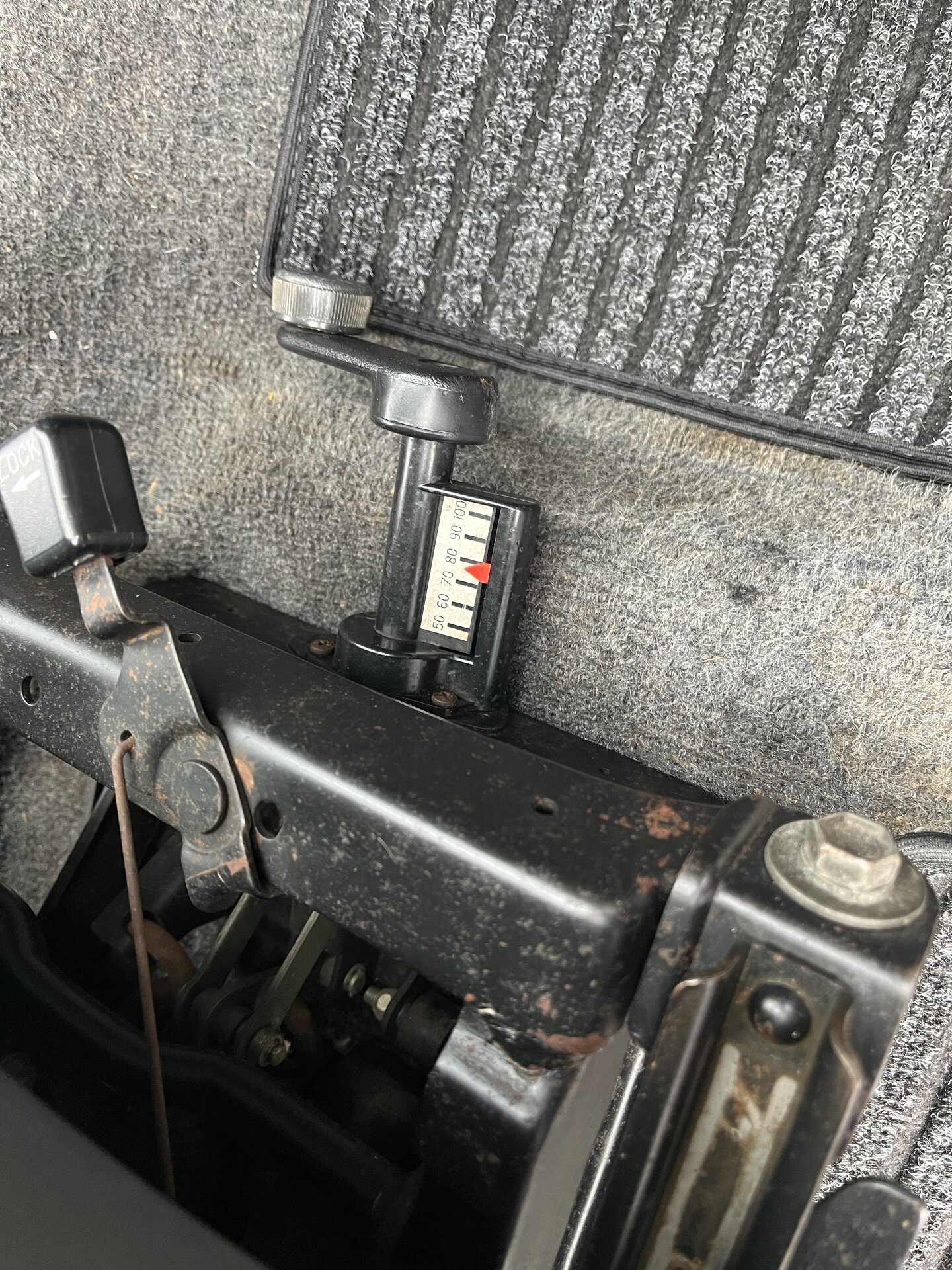

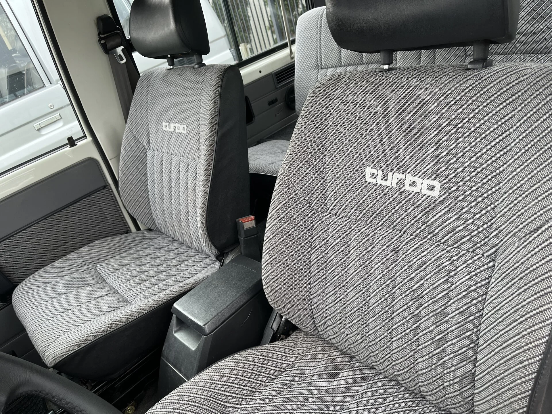

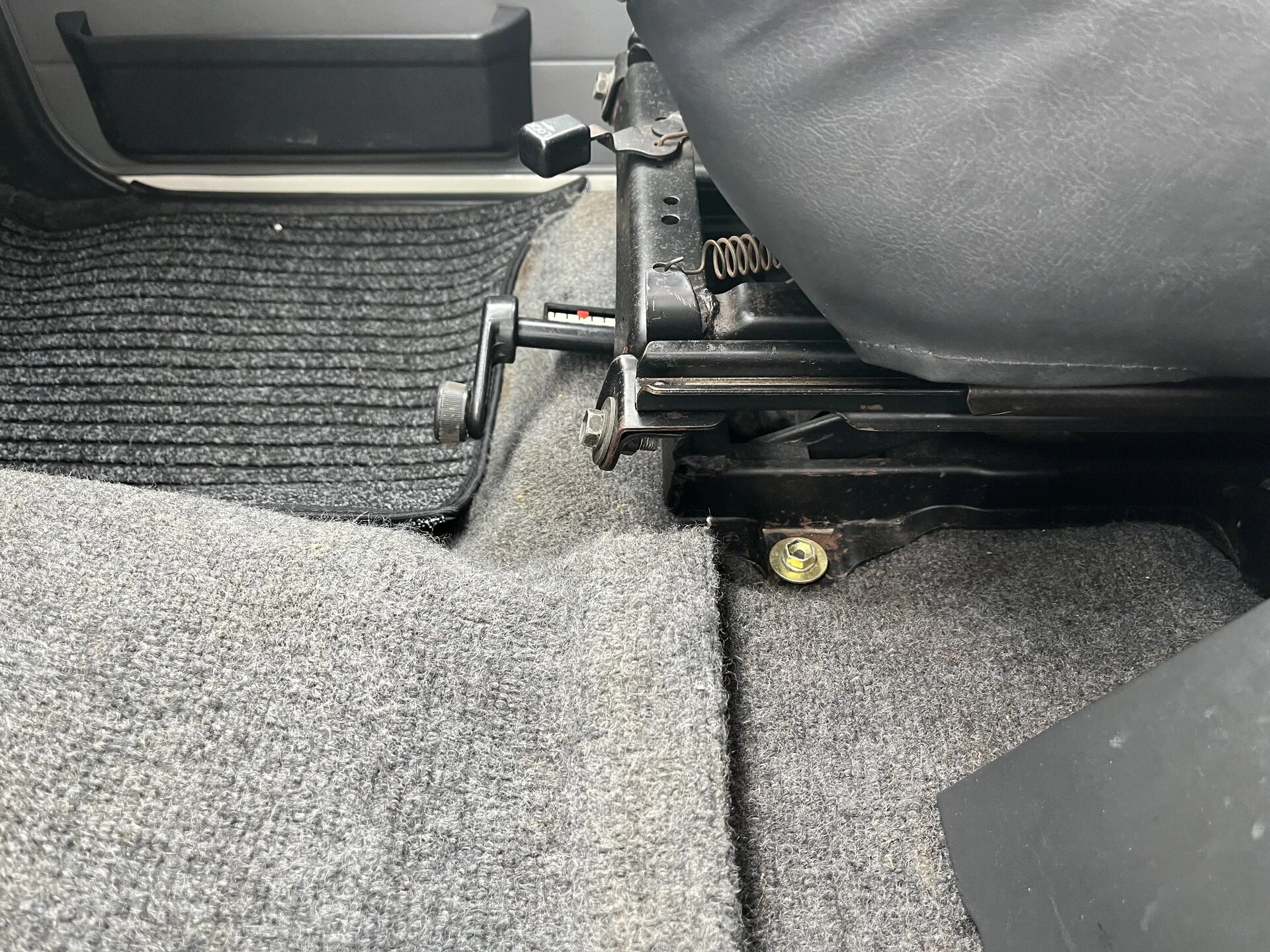

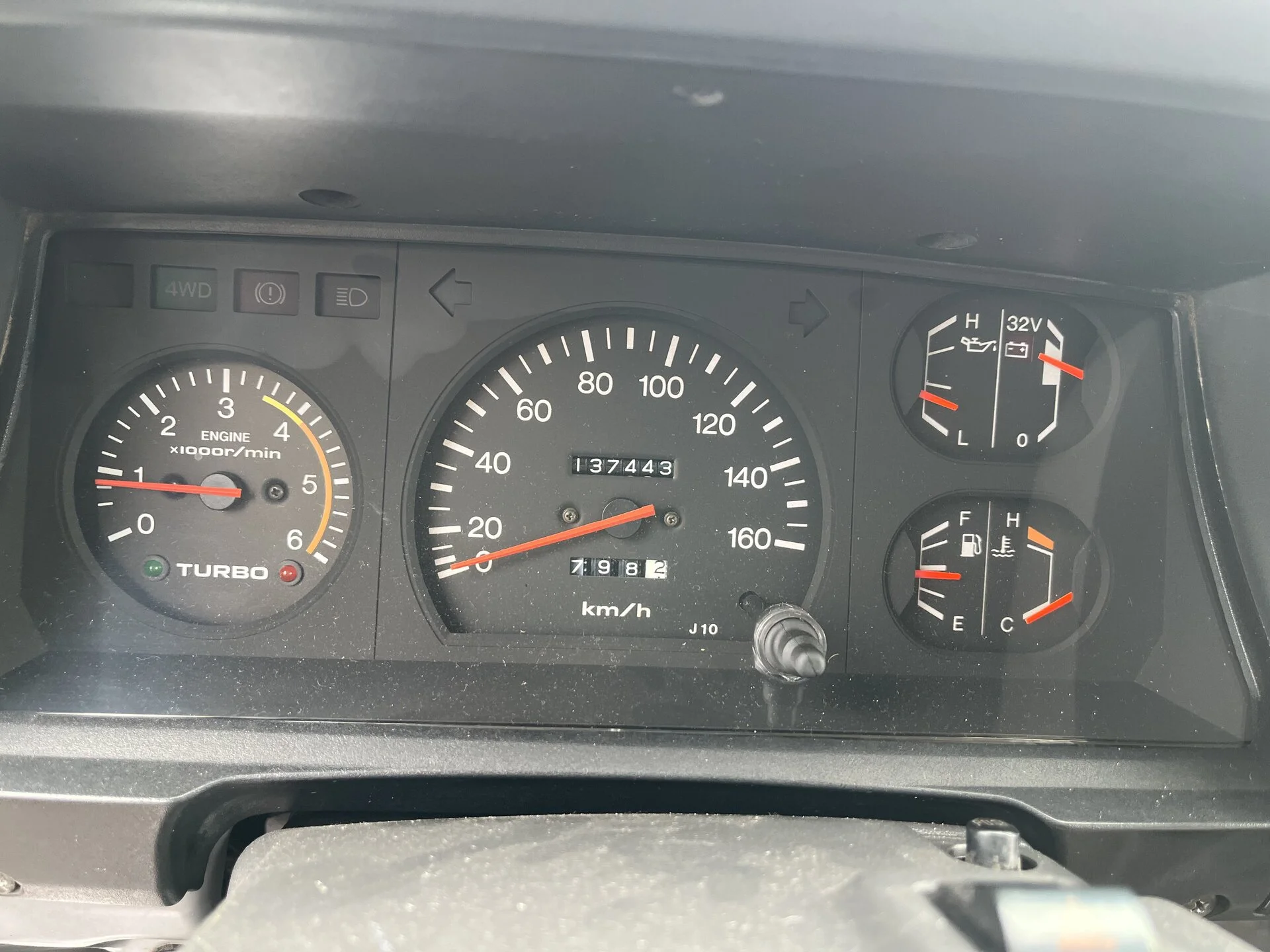

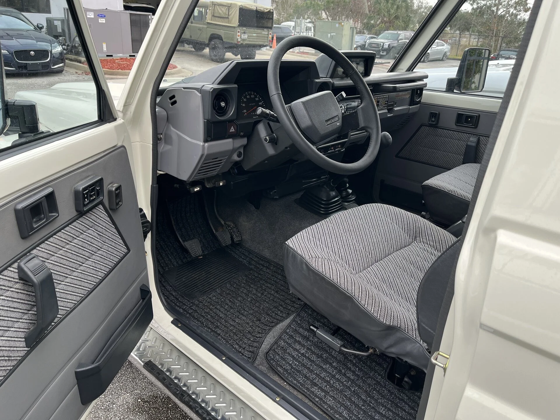

Pics
Pics
Add
More
Here you go
Pics
Vehicle(s) are located at world imports in Jax Fl
