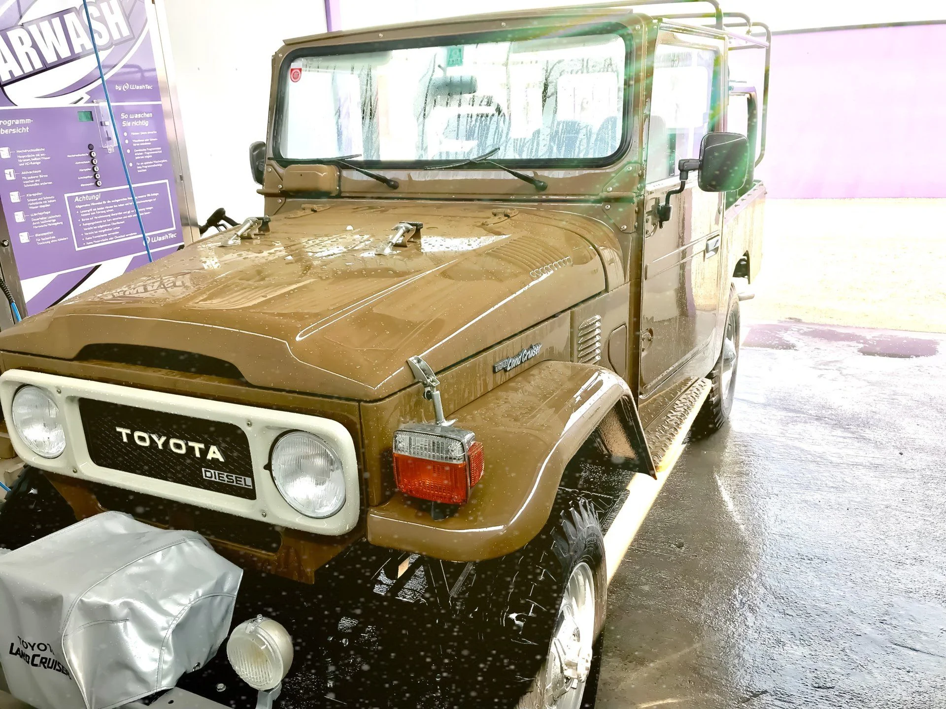

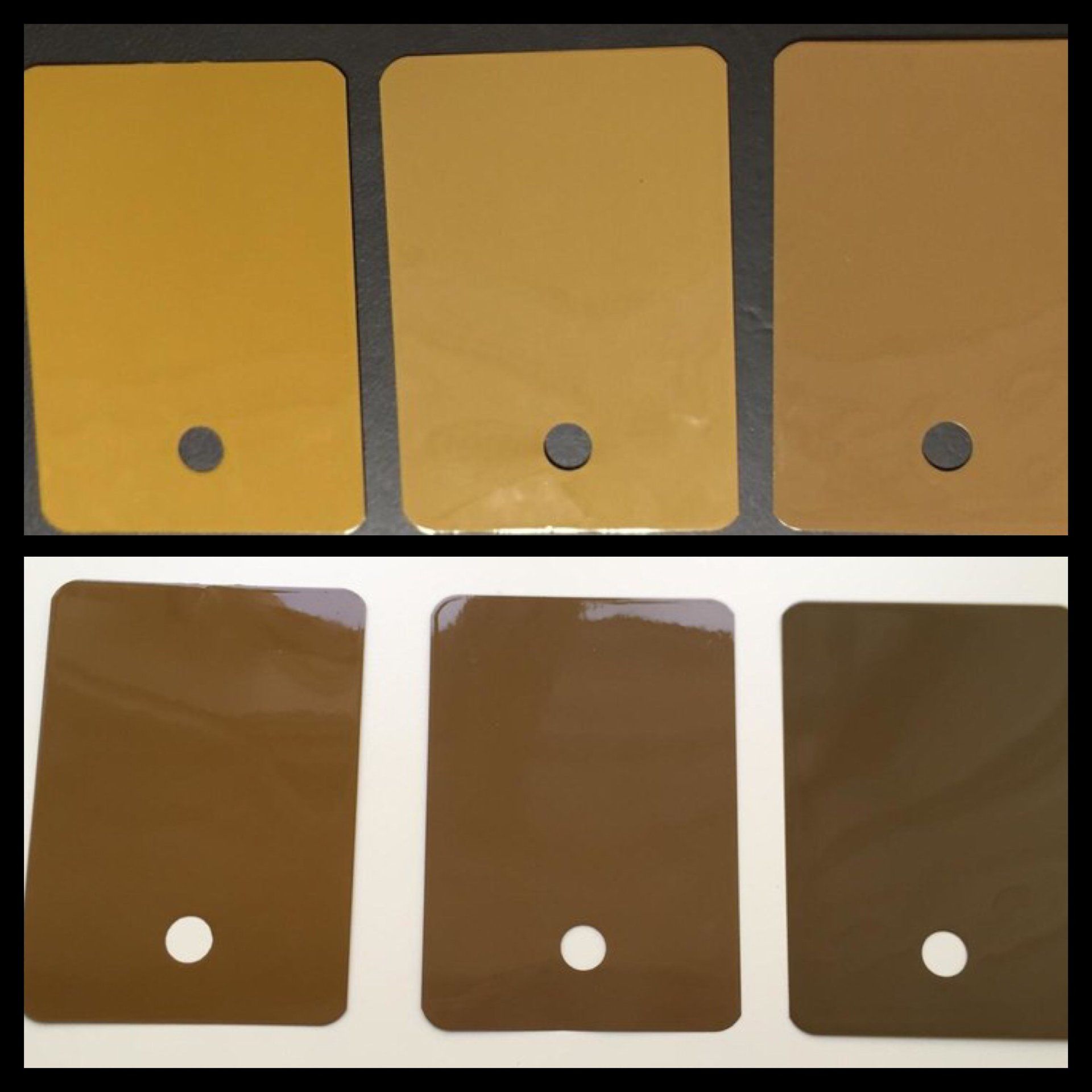

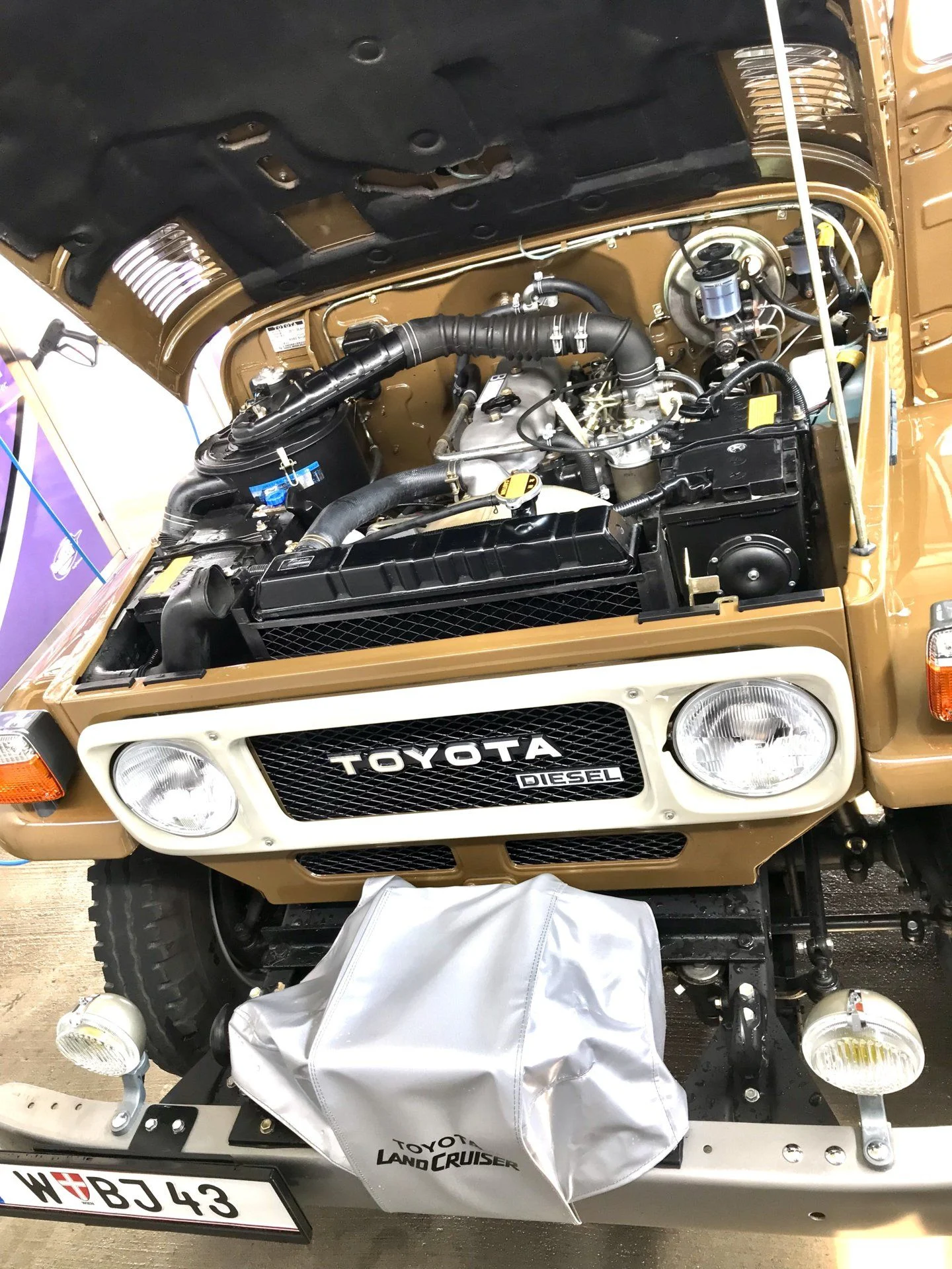

Absolutely stunning. I really like the diesel MWB. And I love the color... what is that exactly?

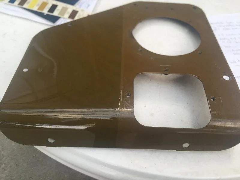

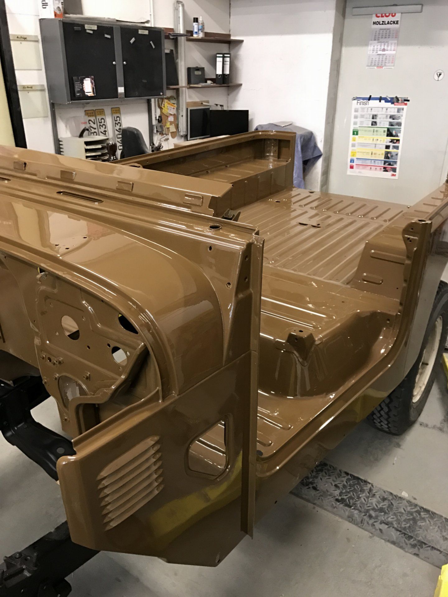

Thanks!
This is a 653 olive 1978-1984 (olive brown).
Original brochure
If you try to buy the standard paint from the producer it will be too green (Original is on the right side)
I spent one month in scanning of originally painted body parts and painting the samples. The color is dependable from the light.
For example 3 early samples inside and outside my house.
Finally I made my „master“ sample that satisfied me and all people involved (from my family to the restoration team).
If you find the German paint producer Sikkens, than you can exactly reproduce the color based on this picture

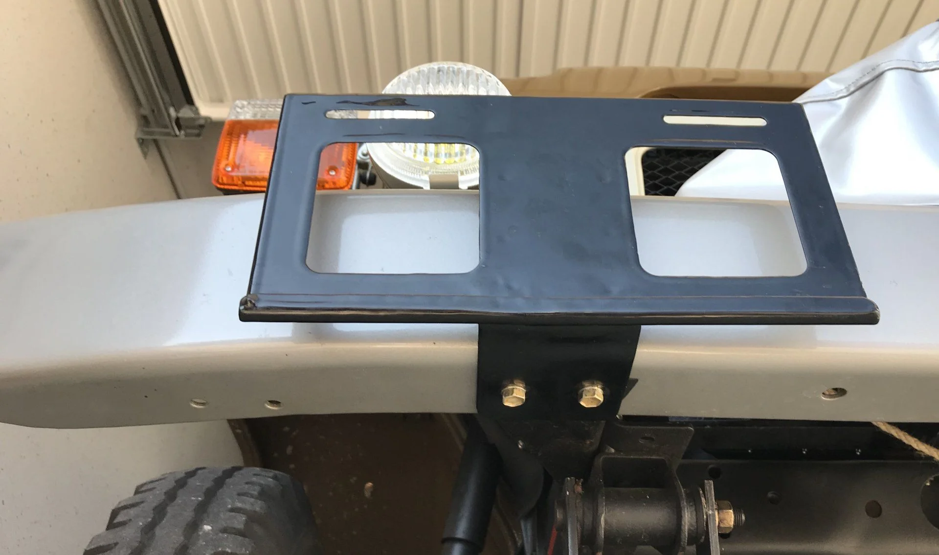

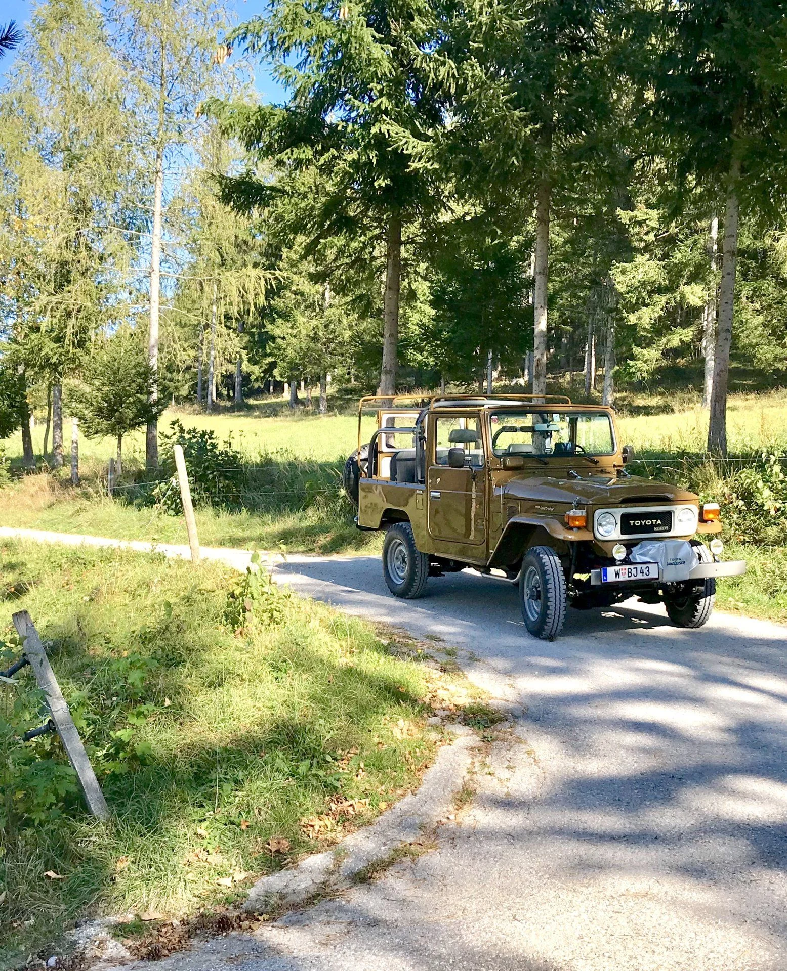

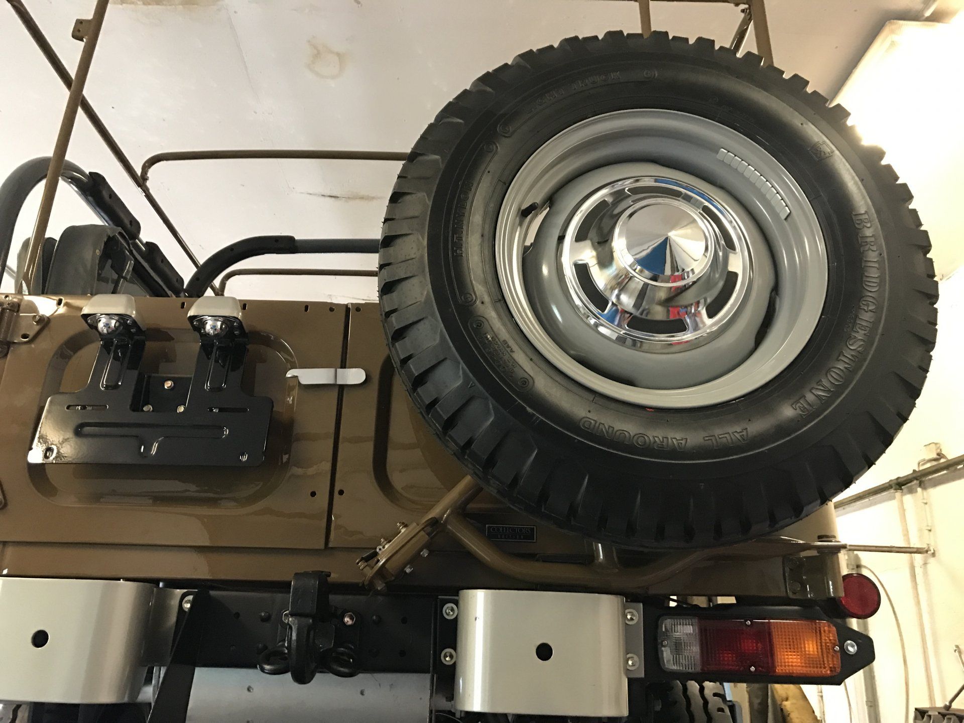

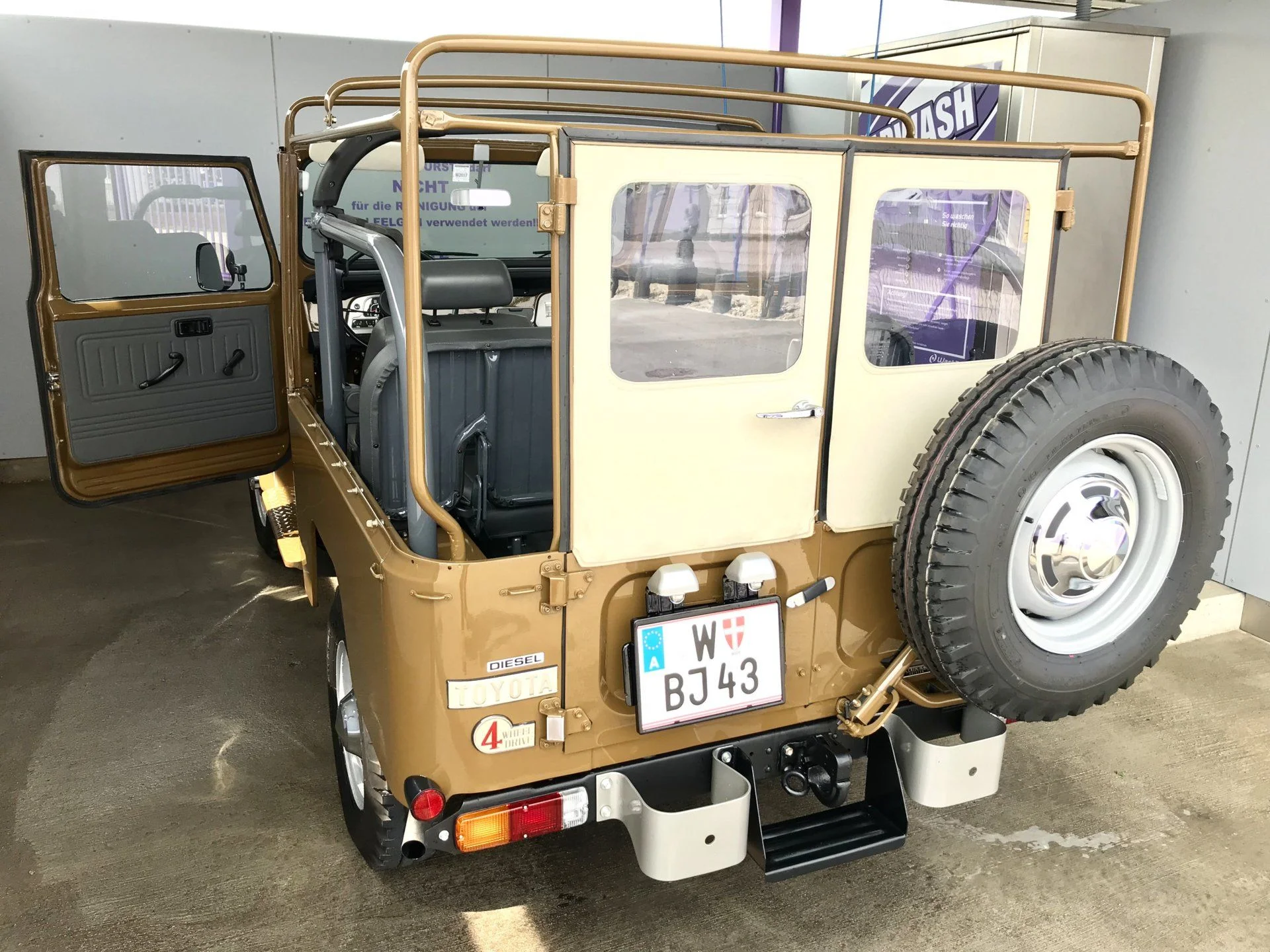

I can’t believe you actually found the license plate holder ... they are pretty rare for sure
Every time I see yours and @peteinjp i think of the great peter w’s ... it’s like they all came from the same mother lol
Beautiful cruiser for sure
I guess it wasn’t a thing in your area to have the rubber metal guards everywhere on your cruiser

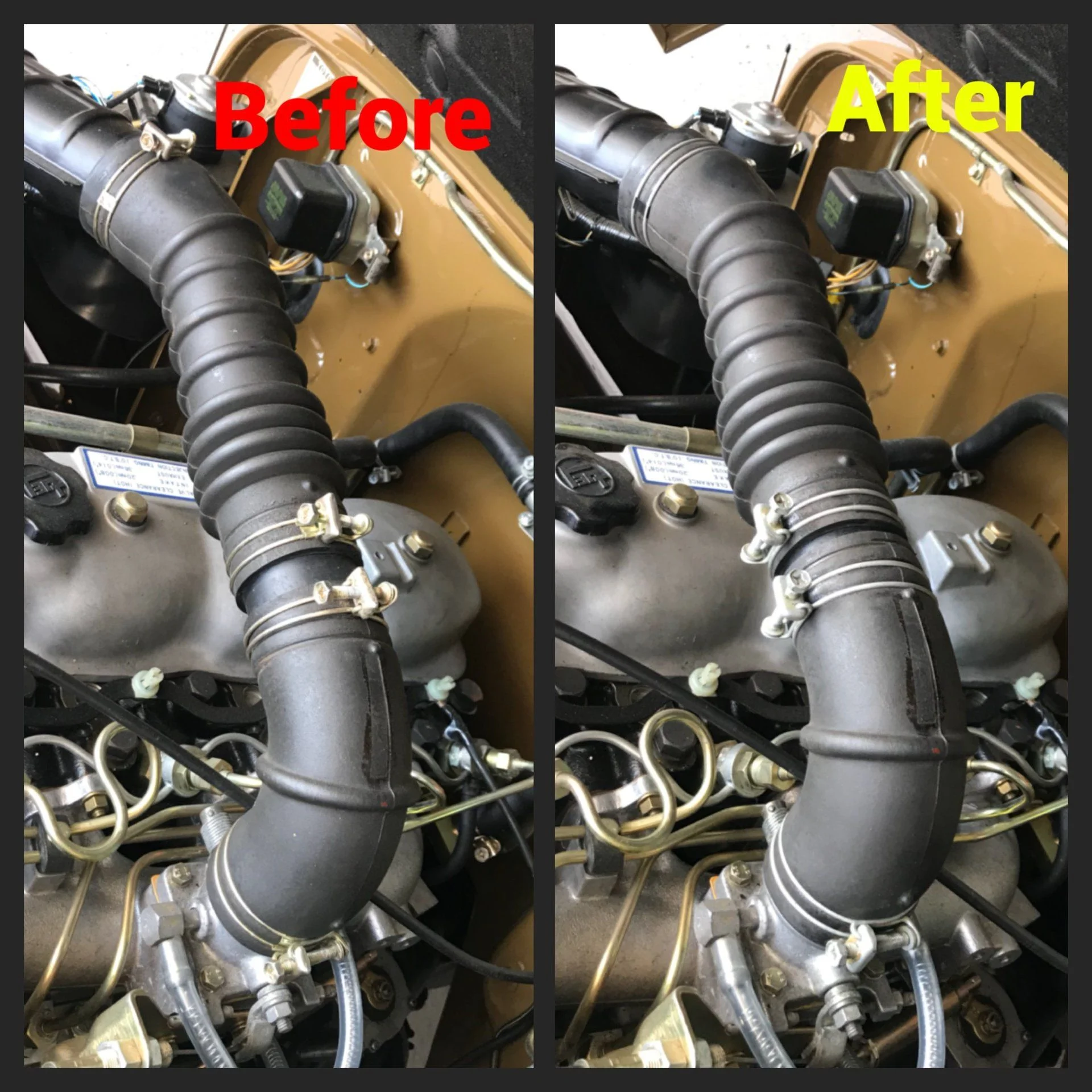

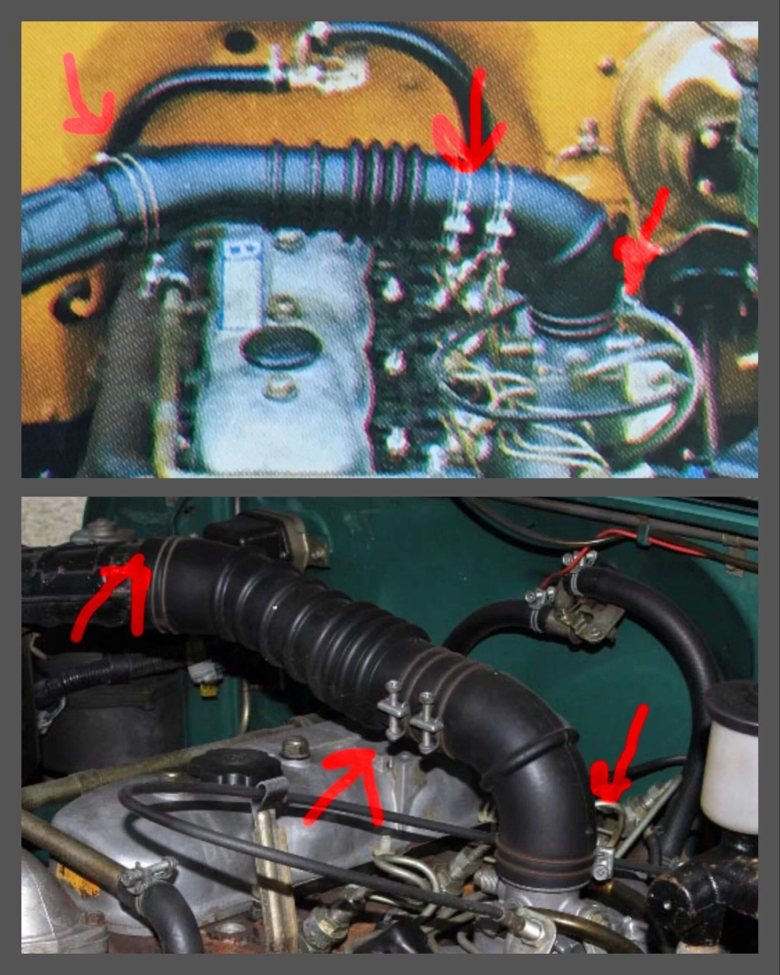

The hose clamps are the clear signs of the restoration. Toyota clamps are must.
But position of the clamps are also important. For example the BJ40 engine has a special position for the air filter hose clamps
I’ve noticed it a bit late. Now it’s adjusted to the factory standard
on the thirst picture
this special position of the top clamps is important because they can make one hole (with the screw in high position) inside the insulation of the front hood ( no enought free space)

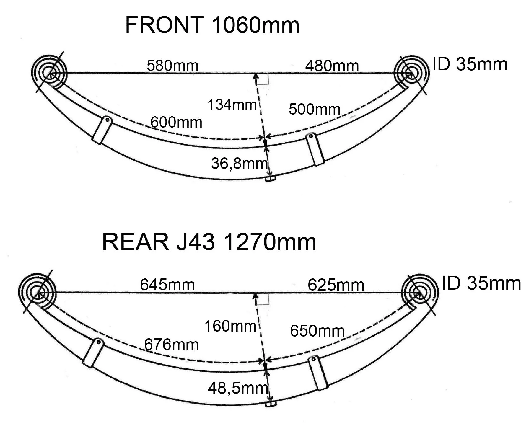

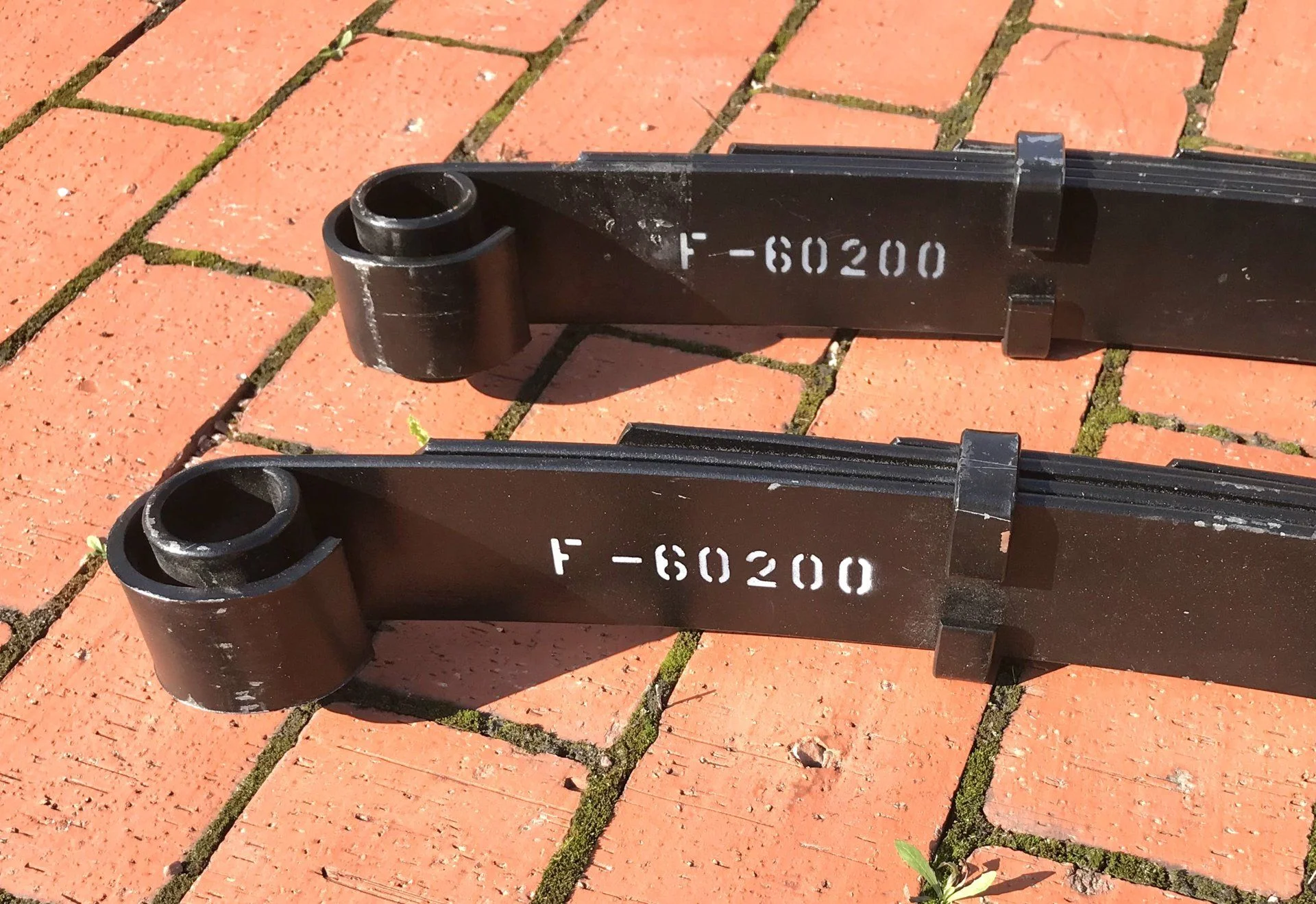

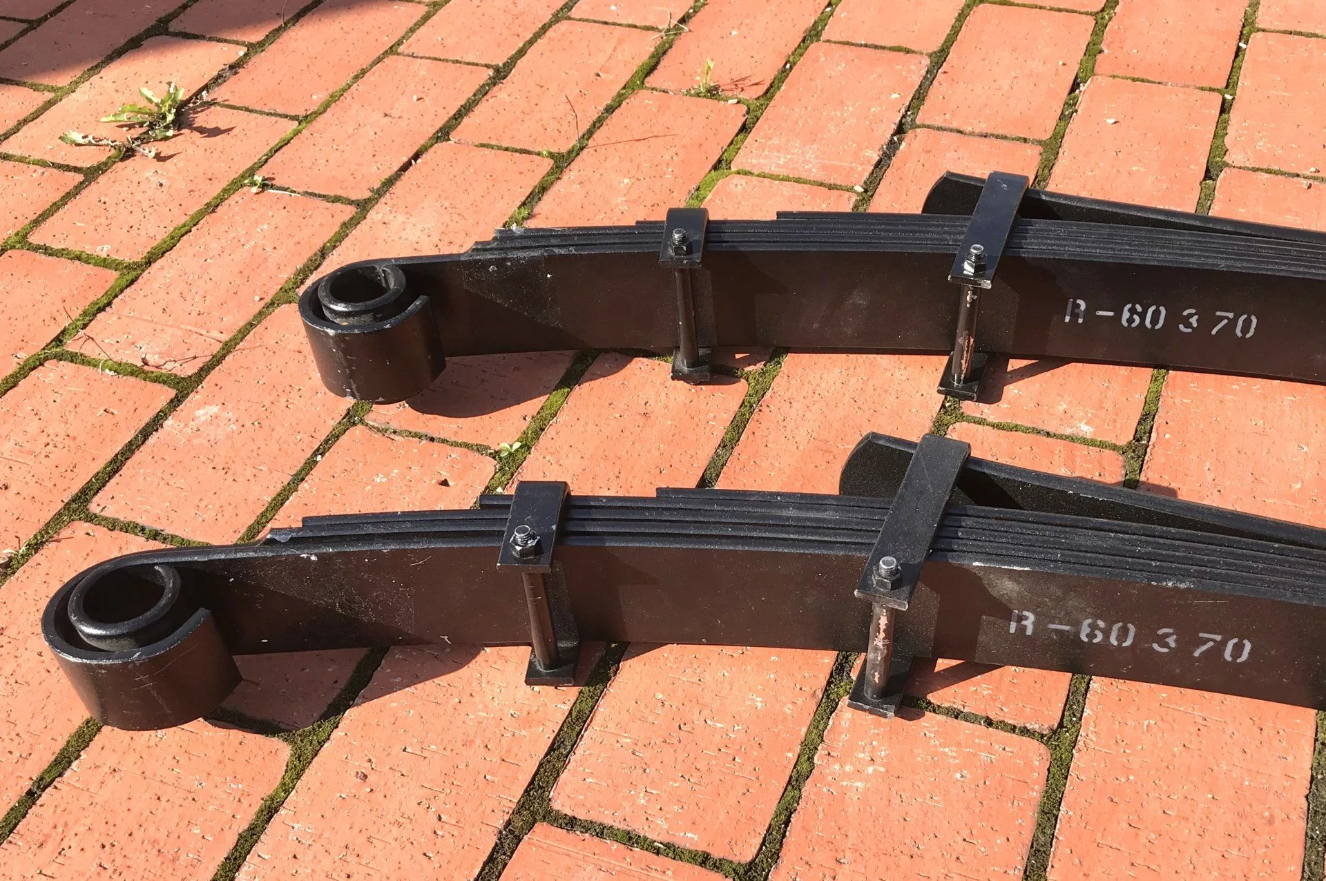

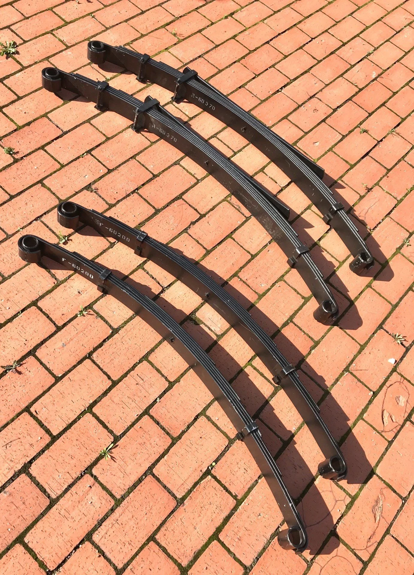

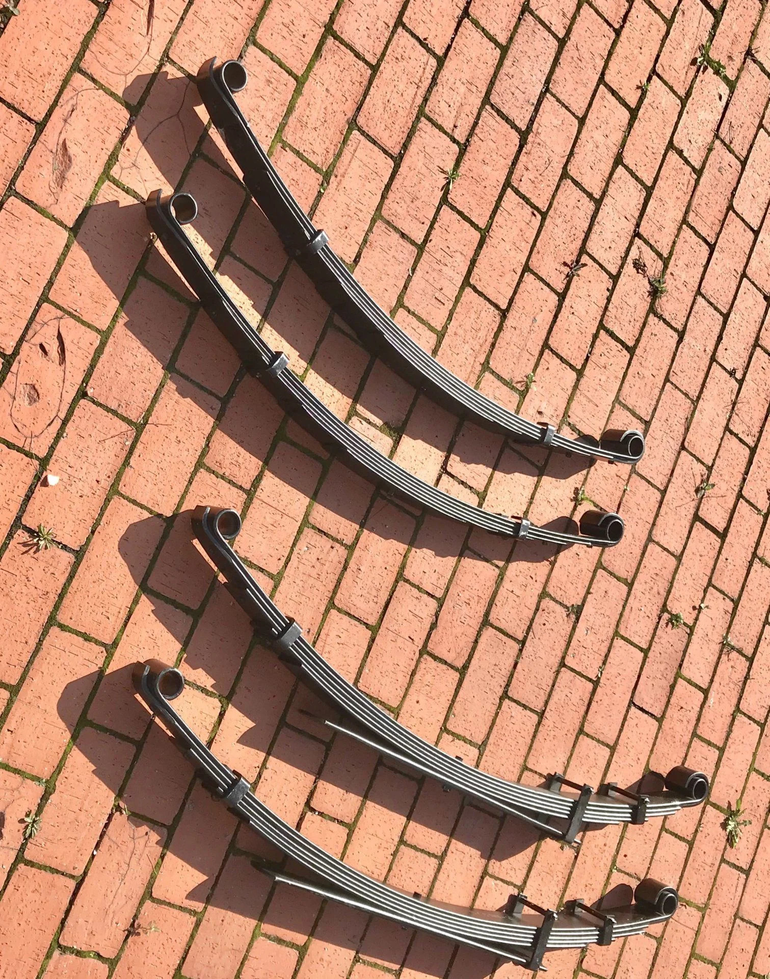

It looks like the new old leaf springs will be installed only in September. I have to move it from one country to the other one...
I hope to get the stock look.

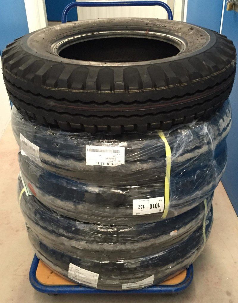

Still fight with the 7.50 R16 tires for 16 split rims.
I found only two options that are original and available new: Firestone Jeep Service (South Africa) or Bridgestone Mighty Rib (Japan)
I have already the vintage set 7.00 R16 with nonsplit rims (possible with the hub caps). Such tires were used until 1977 in Europe
But from 1978 up to 1984 it was 7.50 R16 on the split rims
So hardly can make a decision. Jeep Service or Mighty Rib. I think Firestone looks cool and close to off road nature, but may will be noisy (braking might be an issue also). Out of two sets I believe 7.50 R16 I will use more often - so Bridgestone might be more practical... stuck a bit
