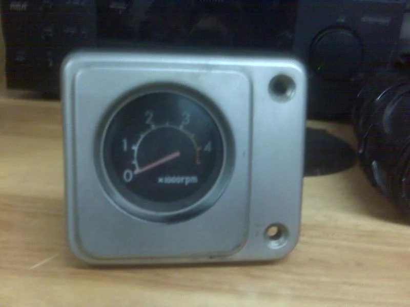

Some kind mudder lent me one of these to take a mold of once upon a time - ultimately I decided not to produce them because the parts that came out of the mold required too much finishing to be saleable.

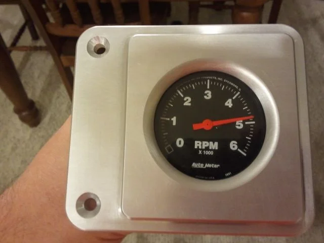

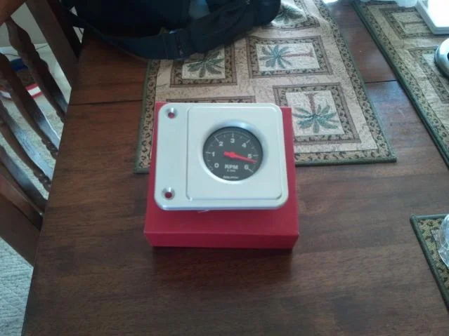

First prototype is in, couldn't resist giving you guys a little sneak peek. It needs an adjustment or two, a little paint, and some hardware. I have been reading up on the closest match for the silver paint, doesn't look like anybody has a dead on match. I guess i will order up a few different types and try them out.

I want one. One thing...is it just me or is your version just a little taller on the step up/down? It doesn't look so tall on the original. Nice work though...good enough without paint ;)
Thanks for the comments, this has been a little more of a project than I had anticipated. (I think they are all like that.)
The step size is the same, the radius on it is slightly different. Some of it may be the light or angle of the picture as well, here is another one. I used a different radius to try and keep the flat part of the face as close to the original as possible. The new guage is a little larger and in my original drawings looked "crammed in" with the other radius on it. Most of the dimentions are the same as the original with a couple exceptions. The rounded edge radius is slightly different on the outside edge and on the step, the gauge opening is slightly larger, has a different profile for the new gauge, and is centered for mounting on either side of the cluster. The outside dimentions, step size and height, mounting holes, coutersinks, and overall thickness are all the same as the original.
