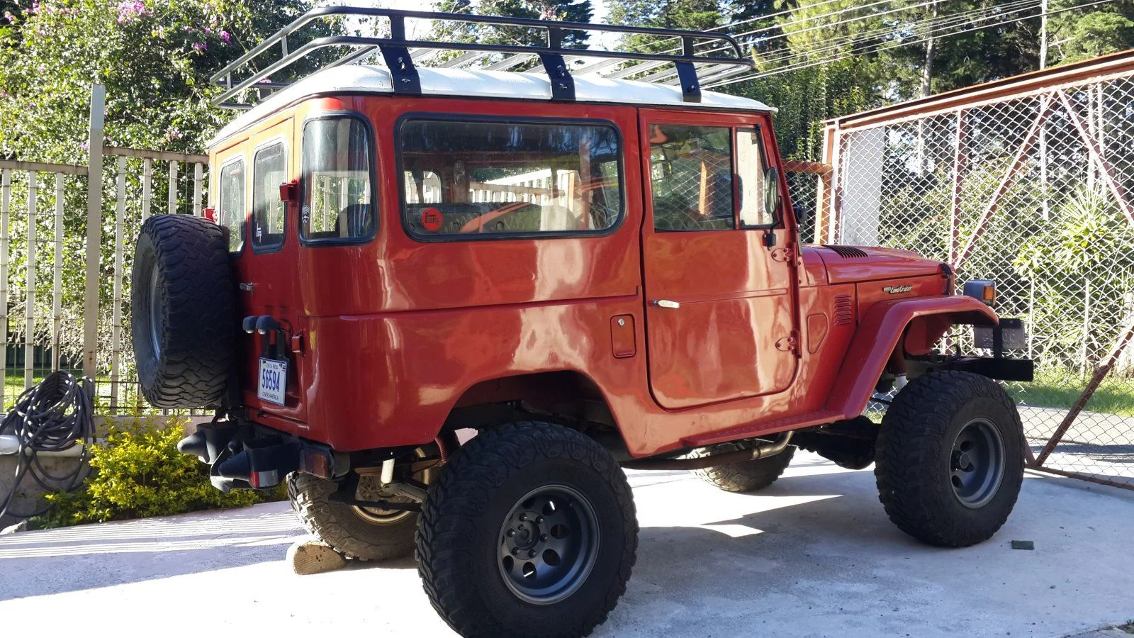

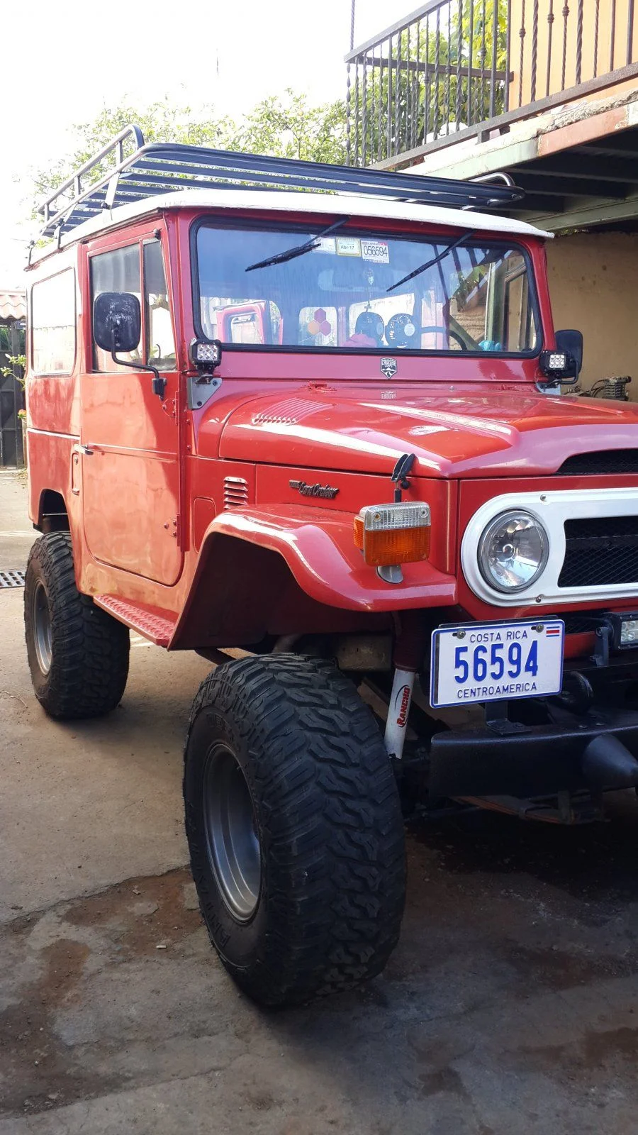

A friend works soldering and I told him if he can build a Roof basket for me. He told me yes for sure and I gave him some ideas from a Land Rover Defender model that I saw on the internet. 2 days after he had the roof basket ready and full custome made for my 40.
Can your friend make me one exactly like that for my 40? Looks great!
