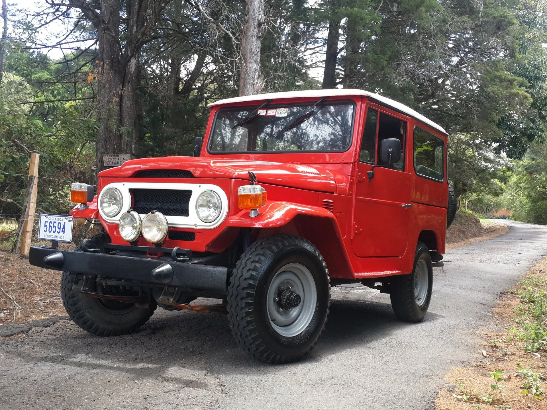

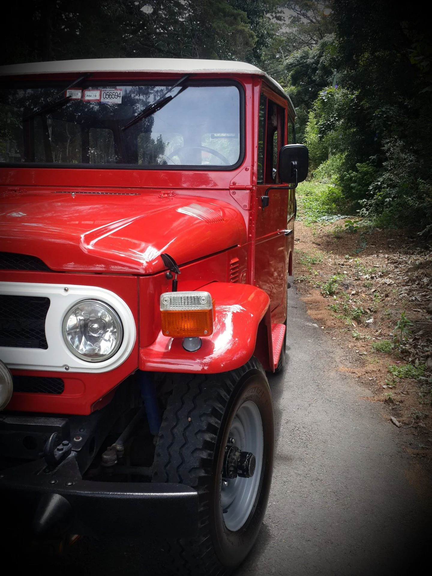

I have a small company for Car polishing named PAINTDETAILER (you can find pictures on facebook for all the cars I've worked on) and as a car detailer I can not see imperfections on my paint.
Fists thing I did was to wash it with Full Meguiars Kit and add some extra wax. Hope this weekend to fully work all my paint but this is the first result with no effort.

"El Jefe" that's how I named him do not have any emblem, I'm planning to buy all of them next month. I was wanting to make the full Paint polish first and after put them all.
I just bought a nice 15x10 Mickey Thompson Classic II Rims, they are all dirty but sooner they have some paint on it with 33 inch tires.
