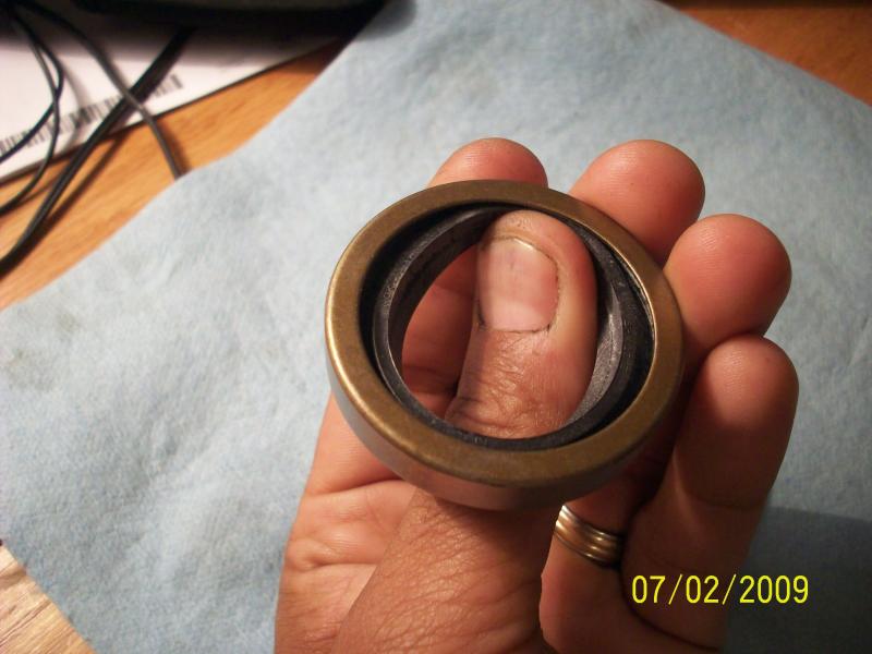

Good points. However the face is good in this case. The thin orange seal that goes on the outside of the flange did move. Another words, when you tap in the seal into the axle housing, this super thin raised sealant (for lack of a better word) lifts off and moves to the back. I'll try to take a pic to help illustrate.
However, there is no way that gear oil escaped from the interface of the metal flange and the axle housing. This is simply too good of a fit IMO to allow leakage.
I like the Marlin type for the earlier rigs, but prefer the flexibility of the stock one on the '80. My thoughts in this post:
IH8MUD Forum - View Single Post - Marlin Crawler inner oil seals and installation tool
I have had a few apart and have put stock type back in, so haven't run the Marlin seals in an '80, have in earlier type axles.
Your assessment seems accurate, as always. This is a beefy seal but less flexible and for a full time rig *may* not be the perfect thing.:crybaby:
That notch you see on the rim (first pic) is from my seal puller tool.

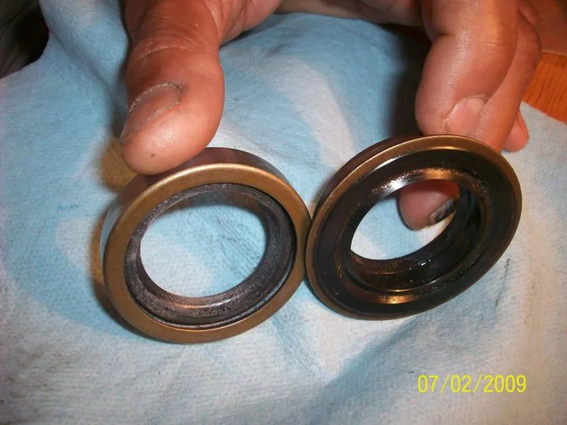

More pis for your amusement....

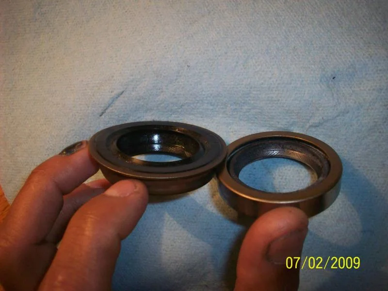

Further testing in my U.L. approved lab revealed the following:
flexing the OEM seal is super easy as has been mentioned already. Flexing the Marlin is difficult. However, if you remove the round spring out of this seal, then it became more flexible.
Yes, I did pinch my finger tip in a pinch point :mad:
More testing....
The OEM unit uses a coil spring that can stretch whereas the Marlin uses a simple wire loop that is open and can also stretch to a point. However, the oem spring is more sexy flexy by far.
At least that's according to my super calibrated fingers anyway...

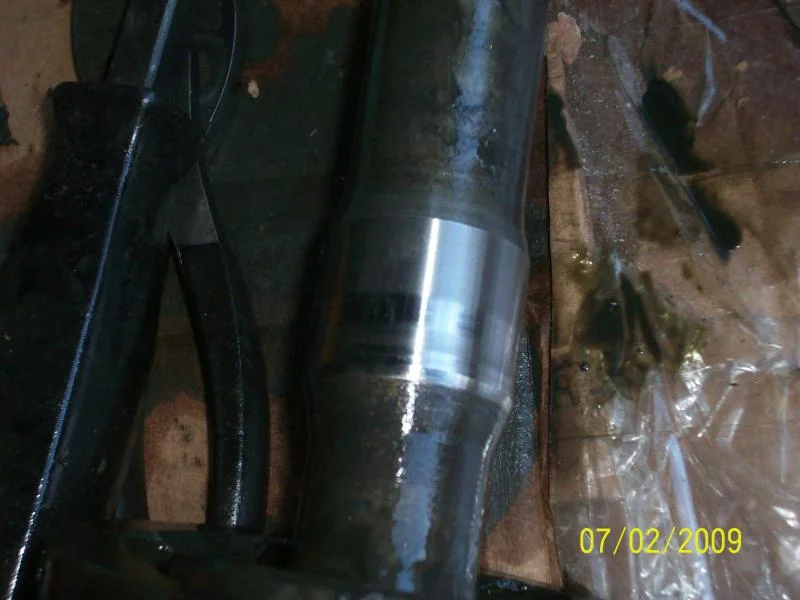

Ali-you don't have groves in the axle seal surface do you? I think once those grooves develop, the Marlin will likely seal better, since the lips of the seal ride in a different place.
No grooves on my axle that i can tell.
Edit: the area where the seal rides is *slightly* lower than the rest of the material. Is this a groove? Yeah, I guess you could call it that.
The seal isn’t a bushing, it’s job isn’t to support the axle, so should be as soft as necessary to seal. The axle doesn’t run concentric, has play in it’s mounting, steering, etc, allows it to move slightly. Try putting them on the axle, push on the side of the seal to simulate axle deflection. My guess is the stock seal will maintain better contact with the axle, seal better?
From what I can see in the pic, that axle looks good, I would run it. If you have access to a lathe, you can spin it up and clean up/polish with some emery cloth, but IMHO not necessary.

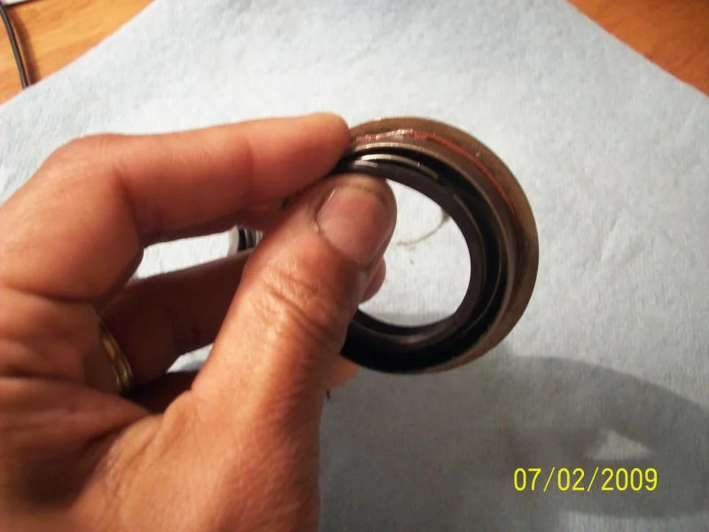

Given the info learned from this thread, I put back in a new OEM seal and will need to get another one for the other side.
Interestingly enough, the Marlin seal installer tool is perfect for installing an OEM seal! As you see from the pics, I use lots of grease on the spring side of the seal to prevent the spring from popping out during insertion (hammer tapping). Be sure to lube up the seal installer with gear oil or light grease before sliding on the OEM seal. And as always, lube your shaft before insertion :D
