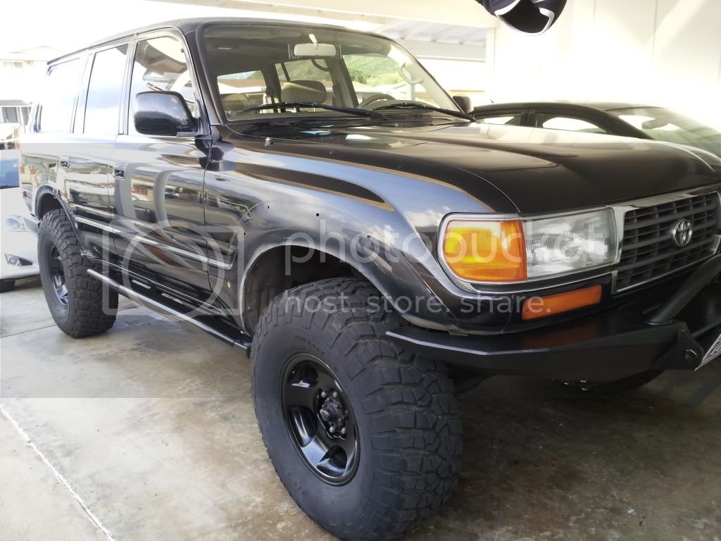

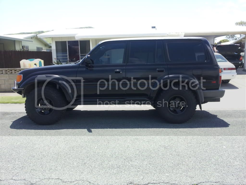

Had to share cause I love it so much! Sorry about the dark pic, hasn't been too bright here...
Build time was only a couple weeks and quality is TOP notch!! I think he build them in batches. Easy to mount up, comes with a template of the little angle that needs to be cut off the frame to get it as close as possible to the body; the only PITA was moving the a/c dryer as the bumper sits so high and tight. I flipped the bracket, slid the dryer up and inwards and re-drilled and tapped the bracket mounting holes all while manipulating the lines to contour properly.

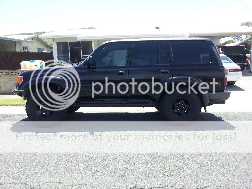

1st pic- is the color that I painted the front bumper, it matches my Mojave Teflons and the body moulding... as soon as I do the exhaust I will build some sliders and finish my roof rack which will be painted the same color. Once I decide on a rear bumper (Binks or 4x4Labs) it'll be painted to match also...

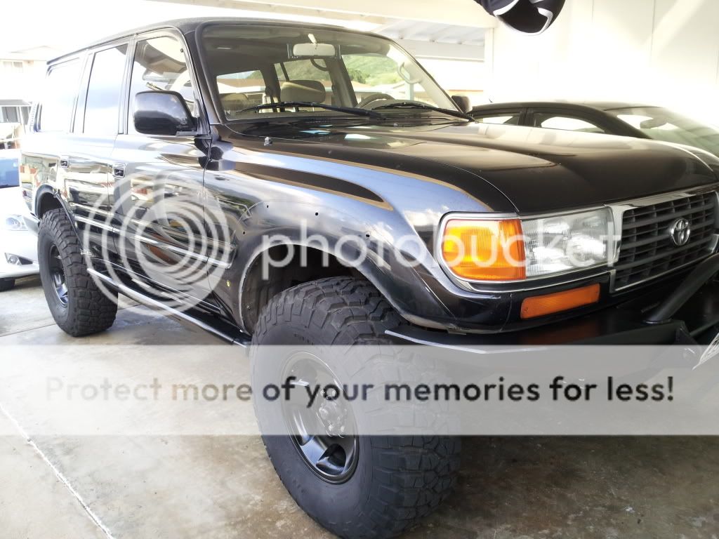

2nd pic- is the template, top of template even with frame as well as the front... mark and cut. You will remove the front bottom section in a triangle shape. Not a big deal really and you would still be able to mount the factory bumper if removed.
