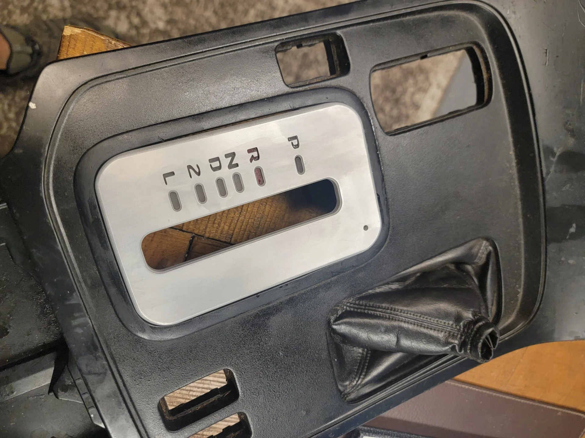

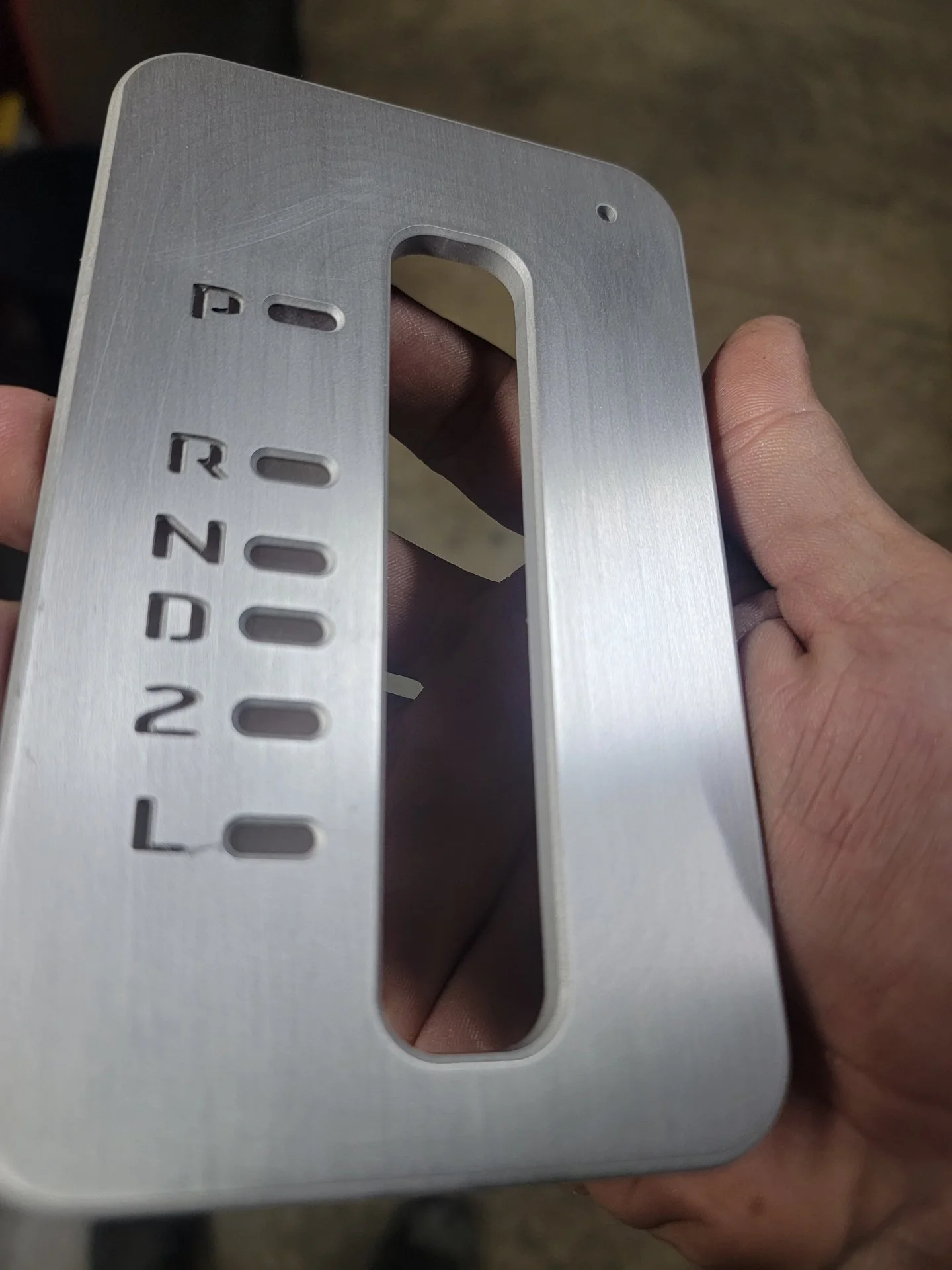

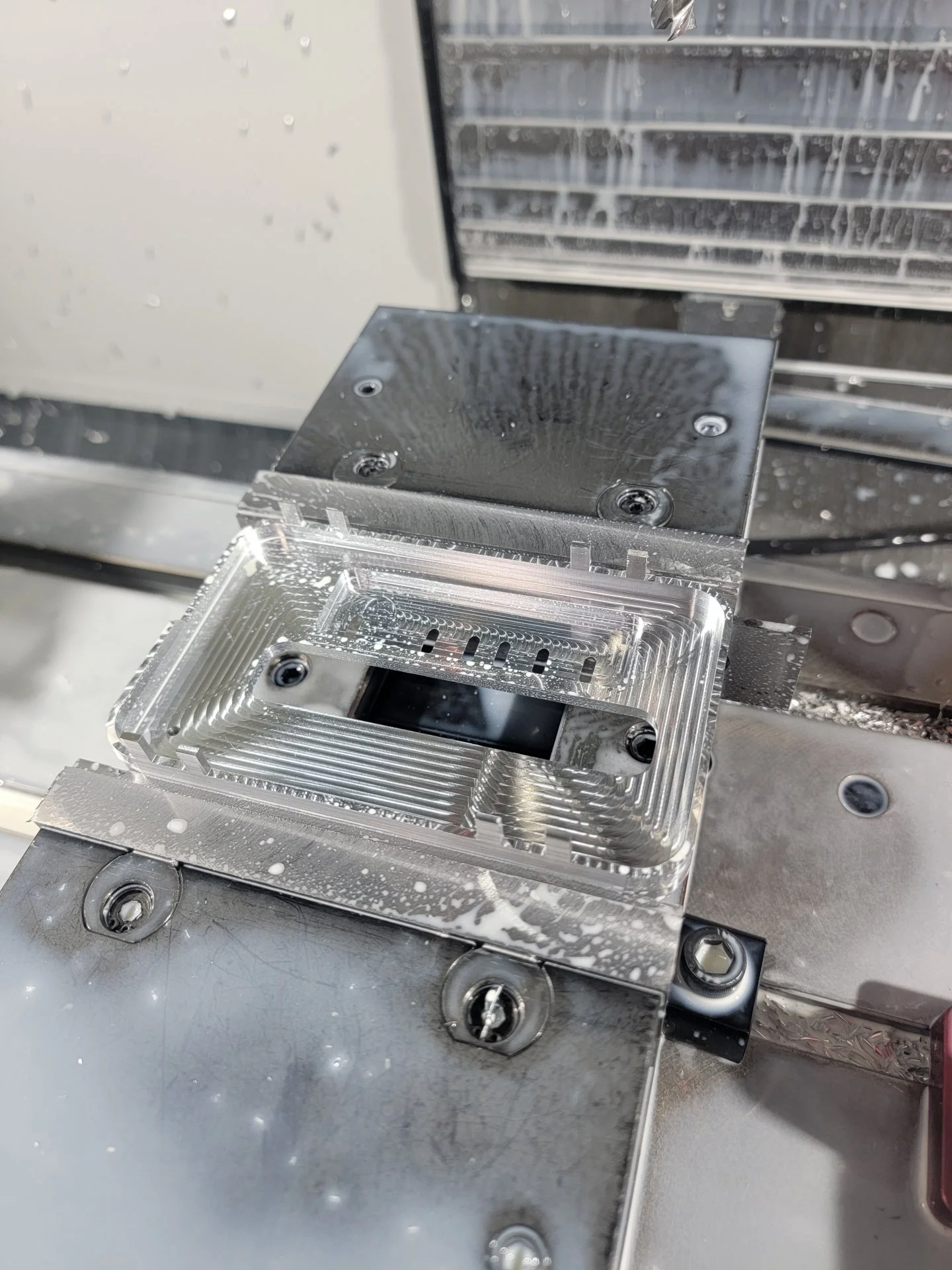

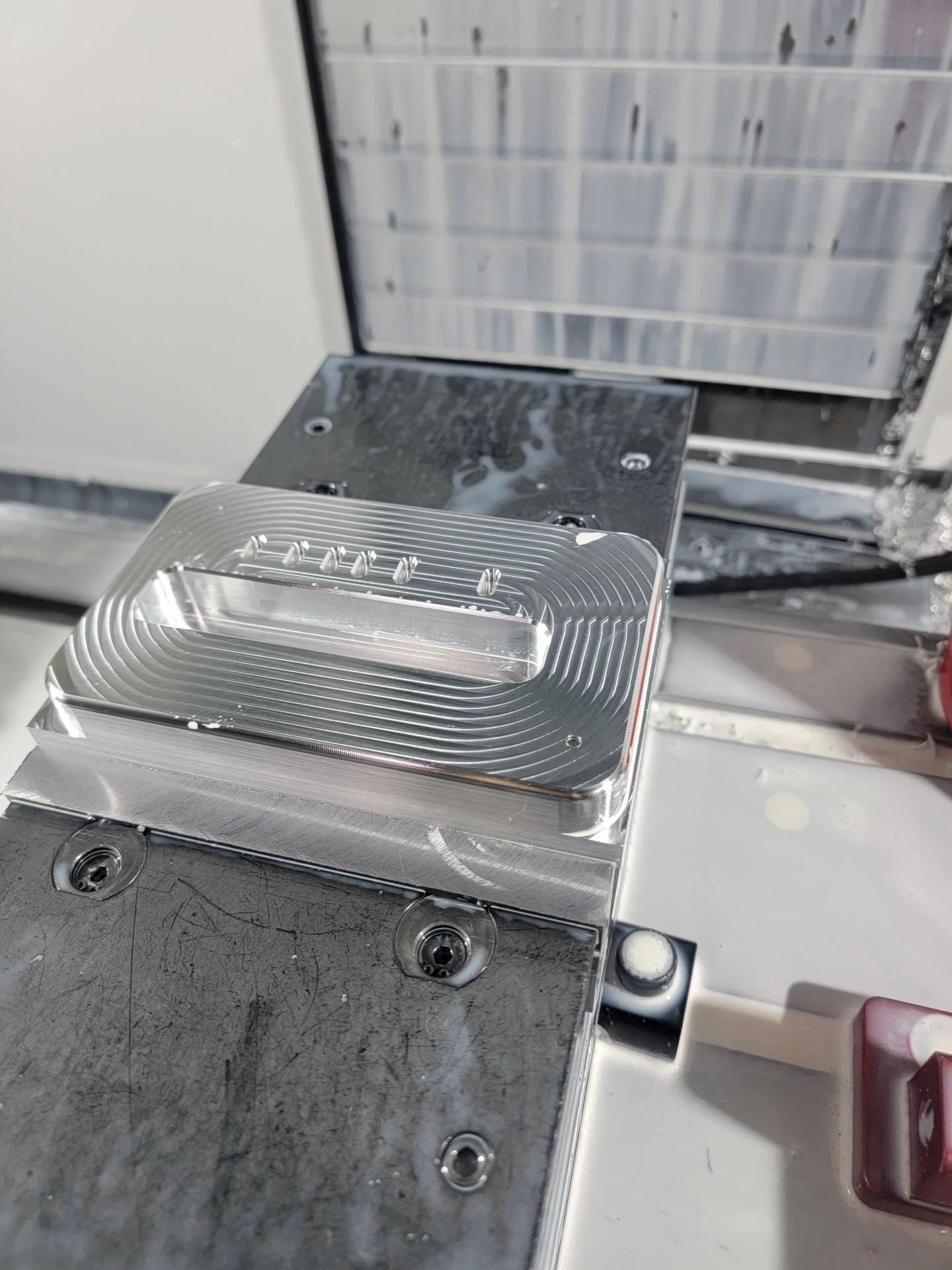

Since I bought my 100 series, I've been hunting for a new shift plate since mine, like all, has a bubbled sticker. After scouring and calling a ton of places, I decided to make my own billet one.
I pocketed the back out behind the letters and affixed a frosted piece of plexiglass to keep out dirt/dust. Need to get time to install and determine whether to andoize.

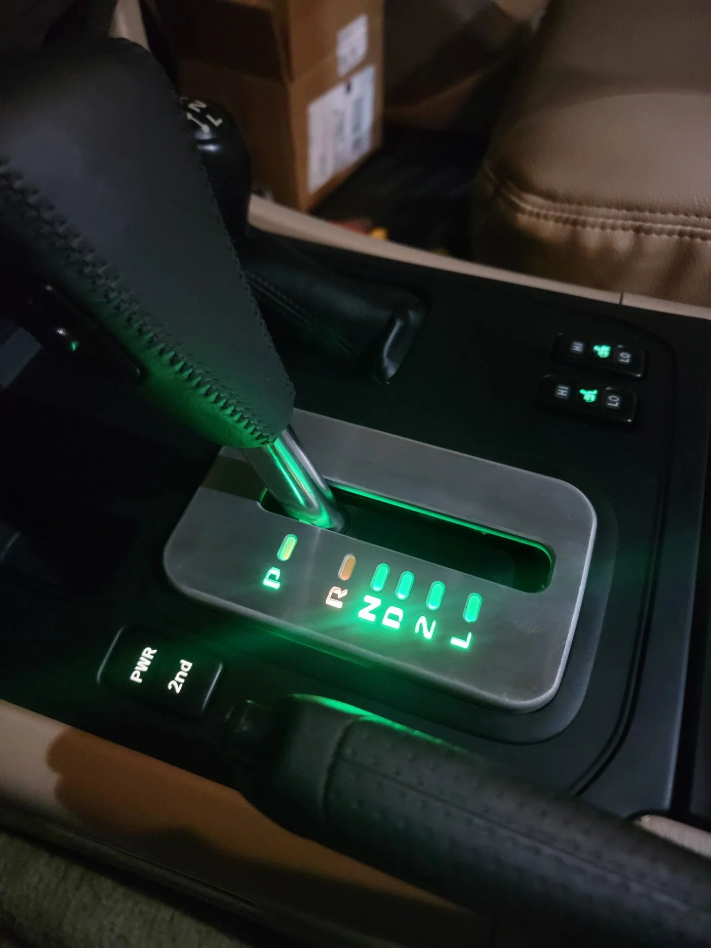

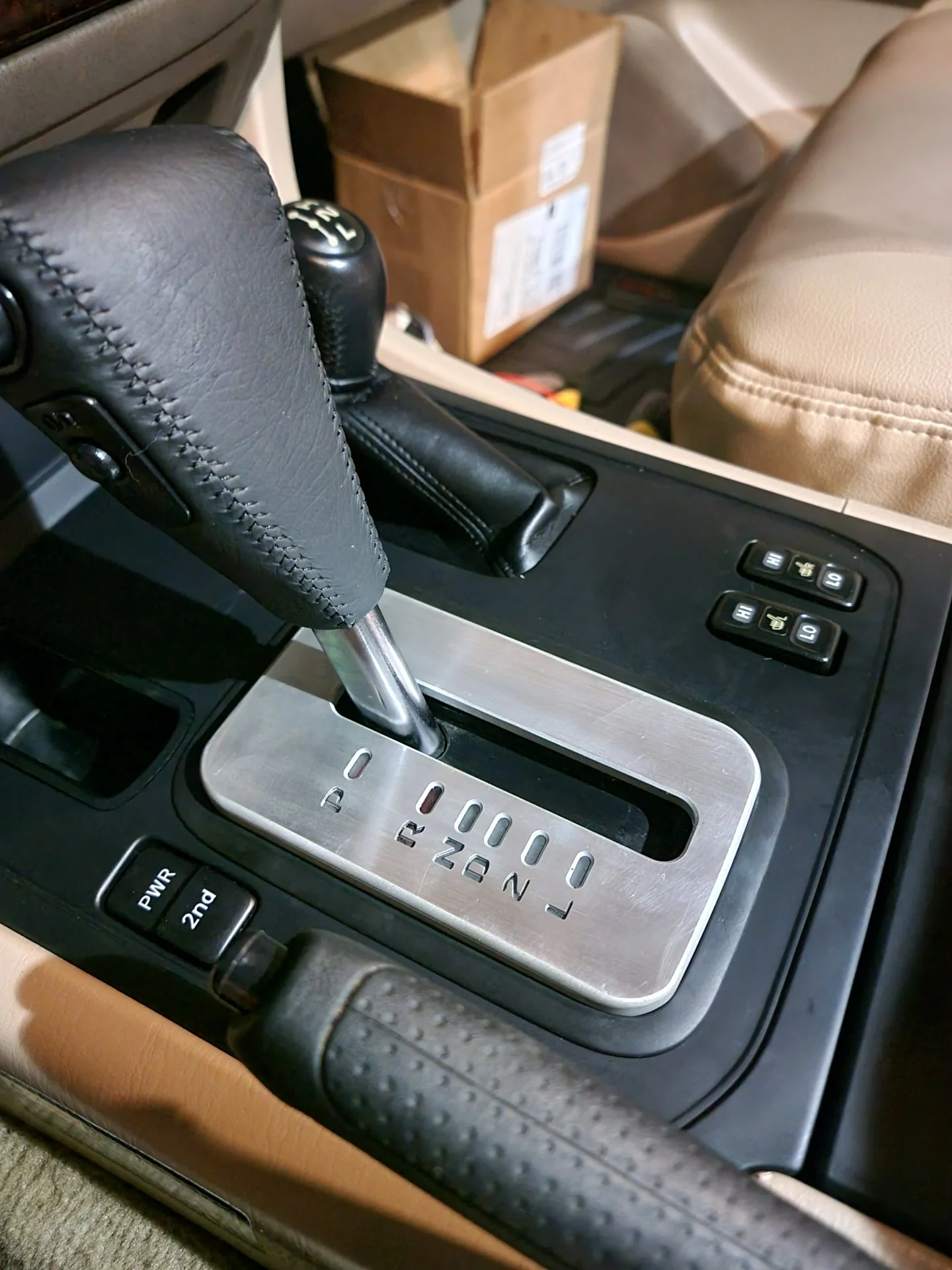

Interested as well. Looking forward to installation photos.
I may do a run if we can get enough people wanting them. Going to try to install today. Just takes a while given the snaking of the OD button wires.
