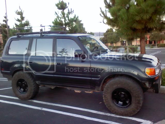

Here is my 80 a week after i got it, 315's and removal of flares. They didn't rub on the flares, i just didn't like them and realized i'd break the flares on rocks soon enough anyways!
