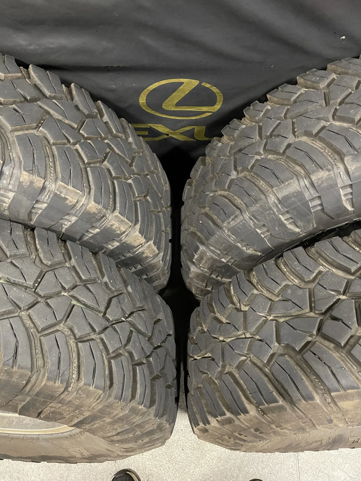

Making the big jump to 40Ds, watching to see what you do to make them work. ;) :clap:
37s for sale!!!!!!
SLICK.
40s on 2" of lift.

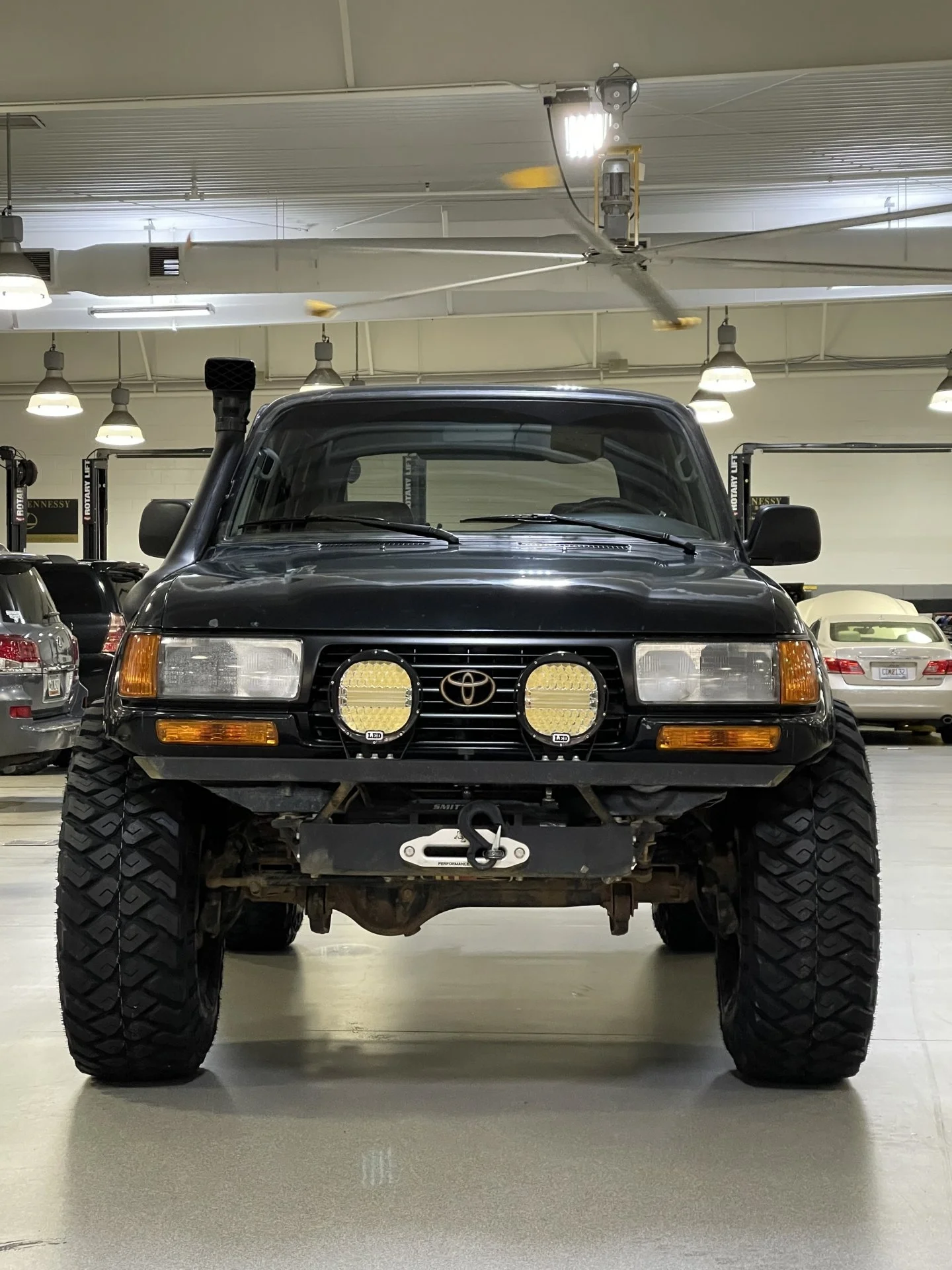

Does the Slee belly plate replace the cross member? It looks to be.

Yes it replaces the stock crossmember.

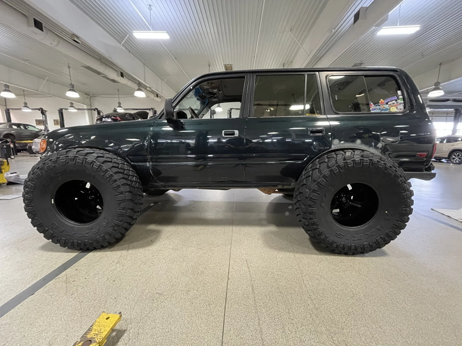

I had to install a 2.5” spring spacer upfront and do a bit more trimming and hammering just to get it driving around town normally.
i have plans for a proper lift but i have a few things lined up first.
Looks good so low... but unless you go Clifford the red 80 style & raise the inner fenders up there is no room for any decent amount of up travel.
ADDED later... I have looked at raising the inner fenders up like the Clifford red 80 & it seems the fender can be cut & lifted 1.25" without hitting the hood or loosing the airbox cleaner & with shorter 24R/34R batteries I have a 1" spacer under them to make them fit that can be remove. With a 1" to 1.25" body lift one can lift the inner front fenders 2.5" without any major huge modification to the engine compartment.
Im definitely gonna cut some more, but im going to lift it first. Theres no point to start cutting right now, id have to do a full clifford, then to lift it anyway. I guess what im saying is, im off trails for a while, its project time once again. ;)

You’re ganna love the maxxis. Best tire I’ve ever run. They’re surprisingly quiet and grip HARD.
Im fundamentally against body lifts. Im in the process of choosing lift parts right now. Once all that is here and installed, ill commence necessary trimming and moving body parts. No doubt ill lose the low stance, but ill ultimately end up with more overall suspension travel and ground clearance, sacrifices…
