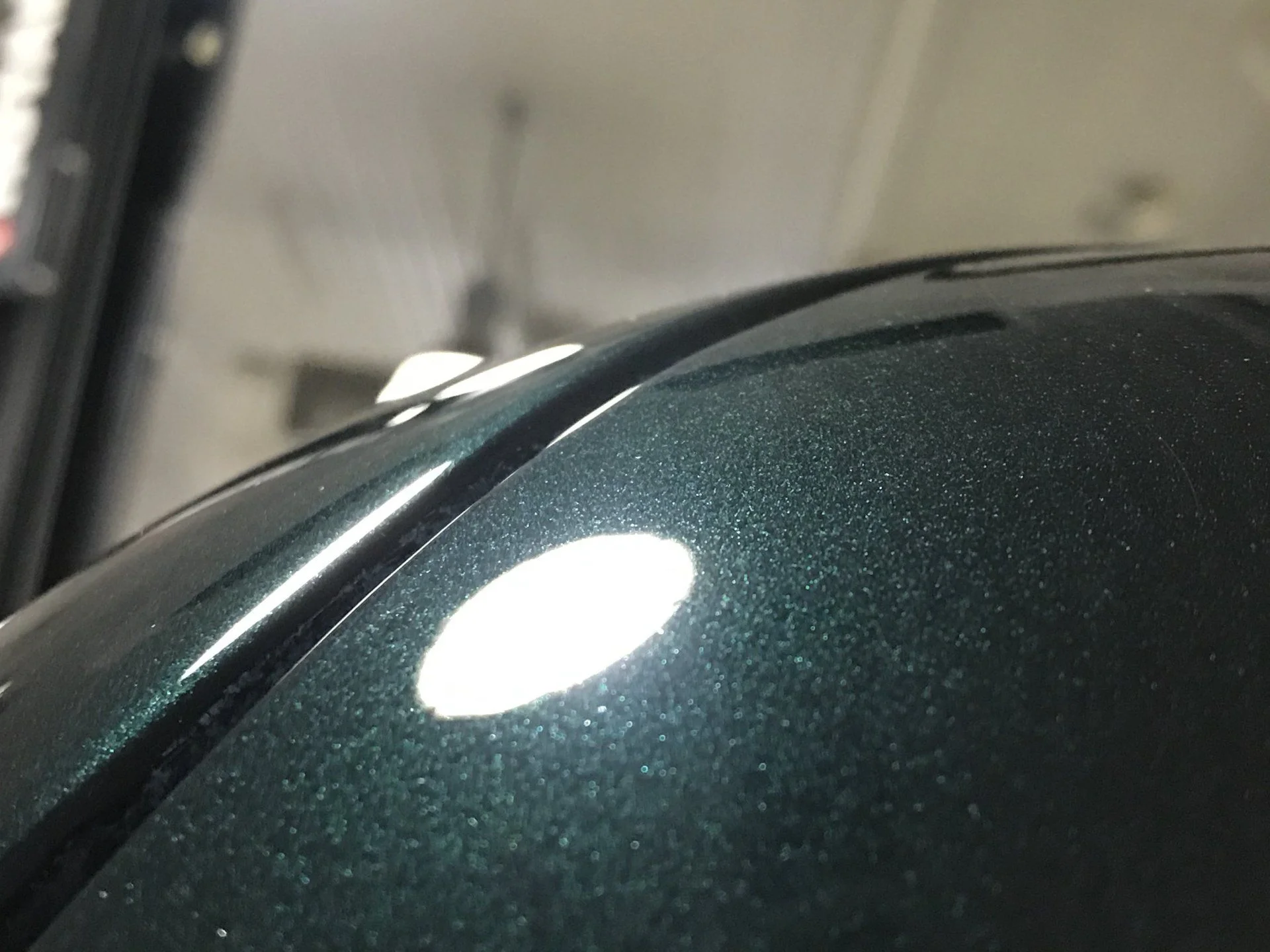

I did not paint the truck. As much as i wanted to, i just couldnt spend that kind of money on a trail truck. I kept looking at monstaliner, as cool as that is, its just not paint.. So, i decided to buff the paint first, I figured I couldnt make the paint look any worse than it was, yolo and such. I HAVE NEVER USED A BUFFER IN MY LIFE, before this, now im a pro. The results were mind blowing. This turned into a big beautification project, you can tell by looking through this thread that i dont really half ass things, at least i try real hard not to. Beyond shiny paint was the desire for a long lasting protectant, like a ceramic or something of that nature. What i was aiming for was keeping some of the mud from sticking to the paint in the first place and to make what did stick easier to remove, Georgia clay is a MF. After a couple heavy washes and clay barring, I buffed with heavy cut compound on a firm pad, polished with with a fine polish on a softish pad, and coated everything in 303 graphene nanotech spray. The shine is deep and the green really pops for the first time since ive owned the truck. The 303 beads beautify and is a really nice product, super easy to apply, we'll see how it lasts over time(they say re-apply every 6 months or so).
All that said, the paint is 26 years old but still looks okay all things considered. Id say it wins an award for most improved at the very least..
Here comes a pic dump of semi chronological photos.. btw thats @bencallaway white 80 while i was putting 4.88s in it
