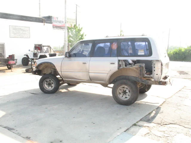

Big Gay 80 build

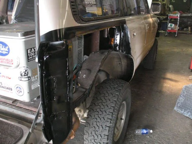

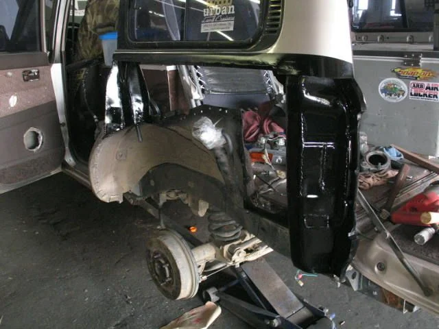

just about finished just need to install the inner panel. other side is close as well

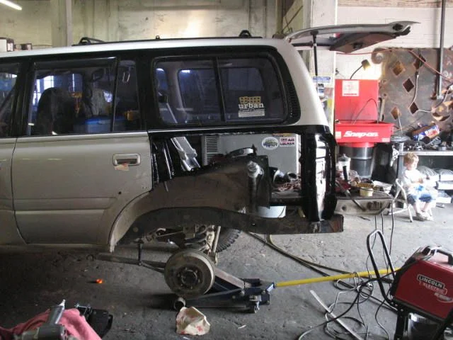

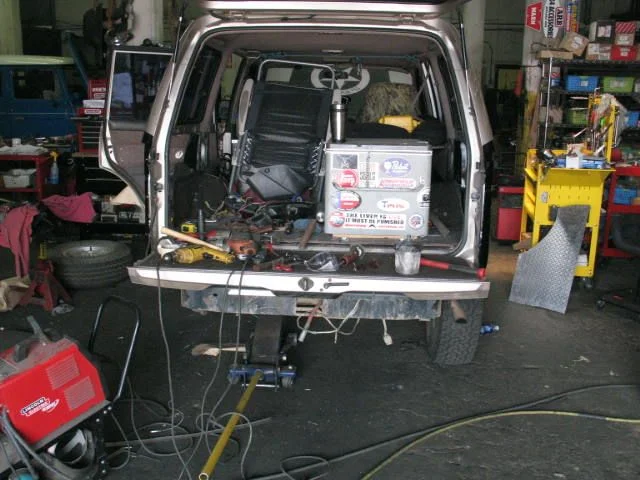

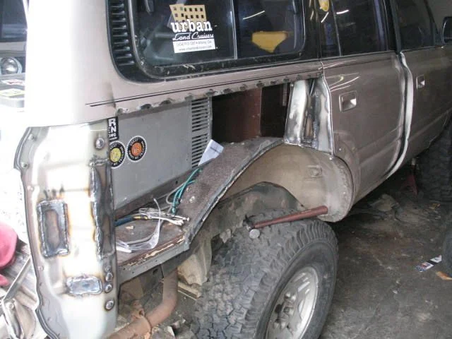

so we (mike) removed the fenders and got to cutting. The inside was cut into strips then a 1/4" rod was welded over it to give it some strenght. We then used aluminum tape to fill the "pie" slices. This will get herculined and sealed later
David,
Looking good man. I recognize the front fender mods!
I dig the rear clearanceing, cut sheet metal! Shock hoops are on the way. Look forward to what she looks like in the end!
Mark
We decided not to do it that nice. Not much work done of late. Mike is missing a finger from GSMTR so we are a bit backed up. Got the 5" comp coils in. Fronts are 4" over Js so 7"s or so over stock. Rears are a full 7"s over stock. Really big and really gay and really ugly.
