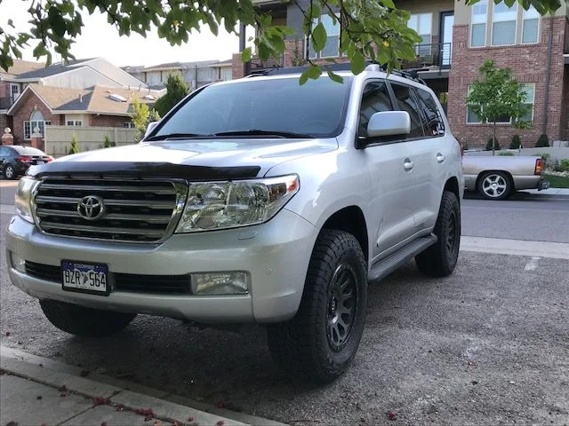

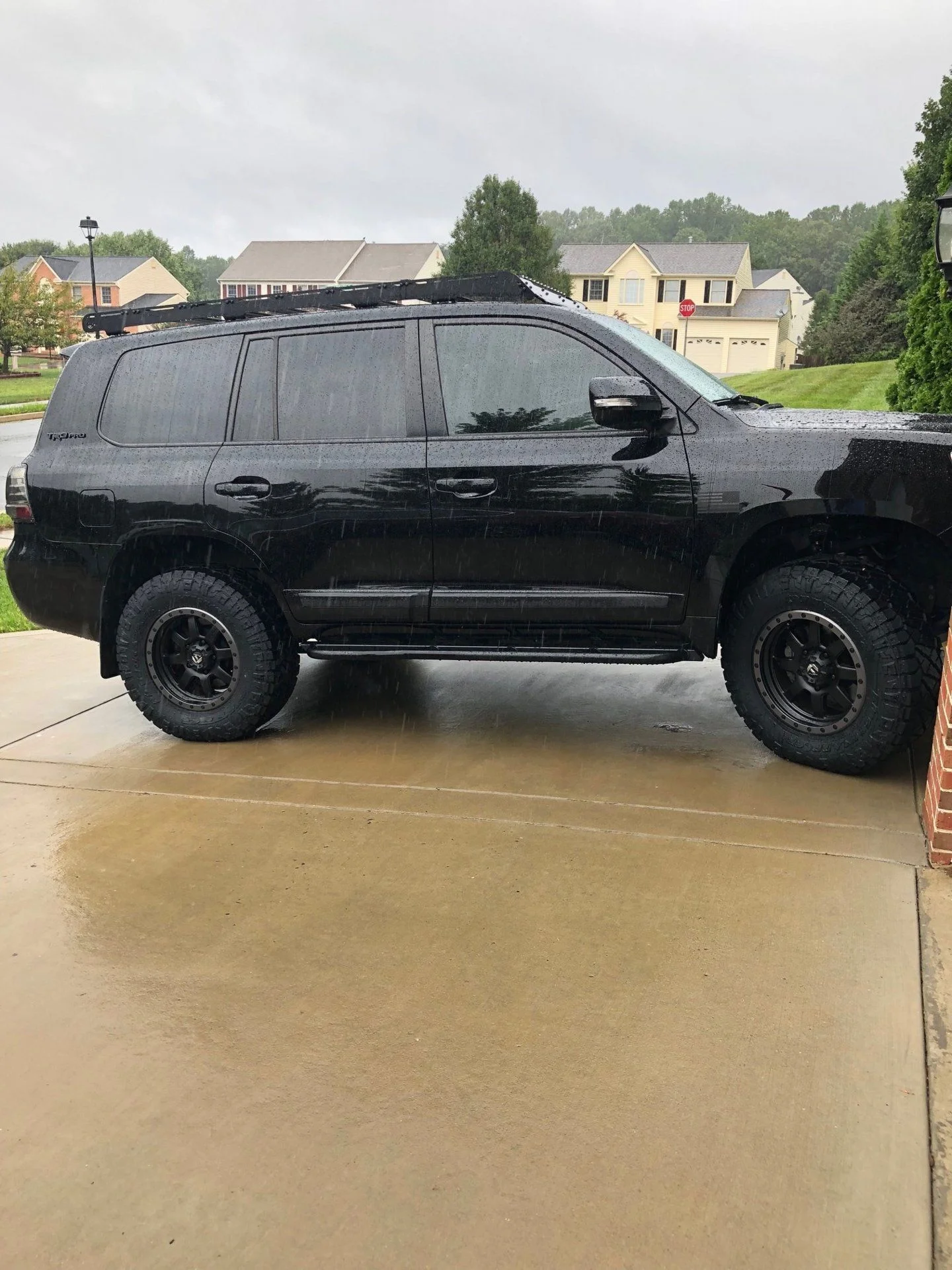

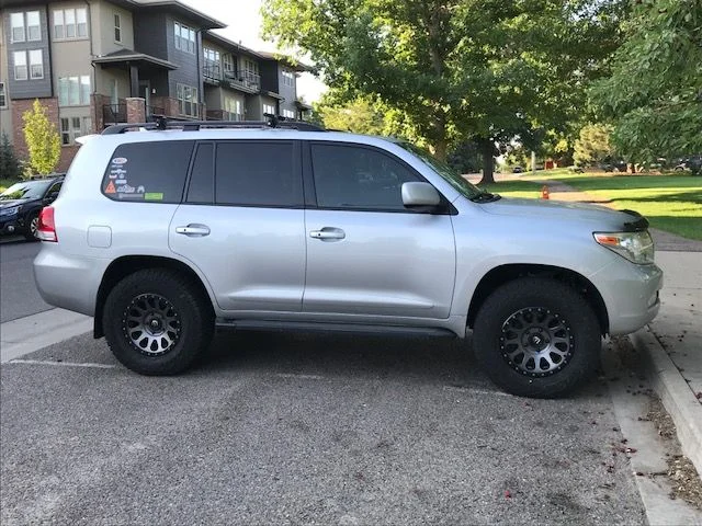

I have received a number of PMs asking about my tires, so I thought it beneficial to post a non-buried account of my findings.

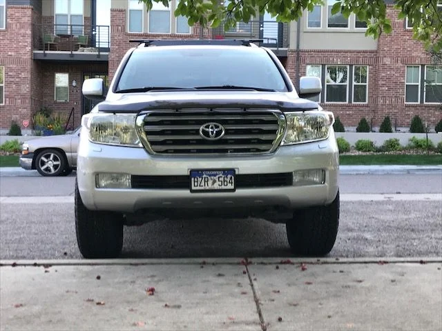

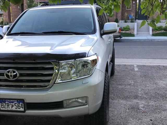

I am not the first to run this size tire, but there has been much debate if a +20mm wheel would work without a lot of modification. Well I am happy to announce that I recently put 305/65r18s WildPeak AT3Ws on my 2010 LC w Fuel Vector +20mm wheels. Prior to this, I had 275/70r18 KO2s on the same wheels. I love KO2s, but I never loved the look of my overweight lady on skinny legs, so I made the change.

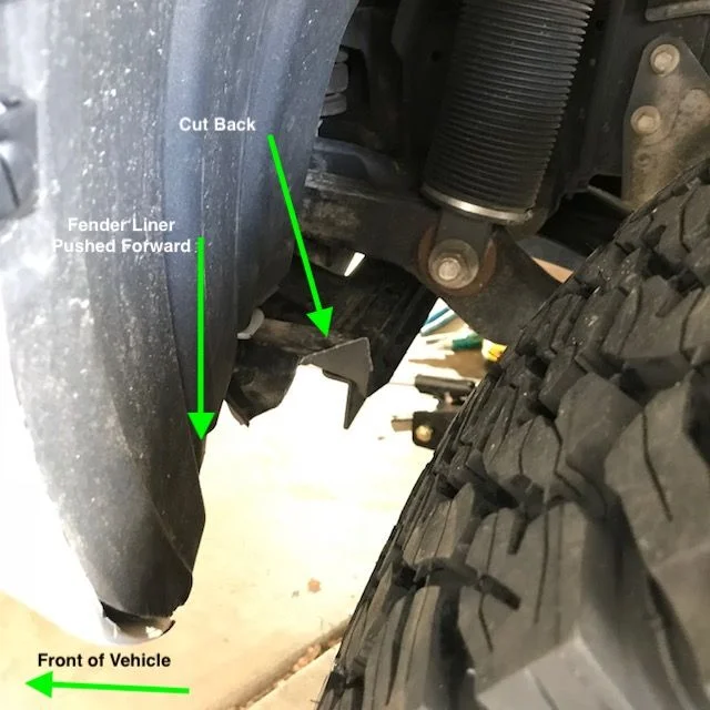

I have just under 2" of lift, removed the front mud flaps and pushed the front of the wheel liner forward about 1.5" (trick I learned on T4R). I promised a couple people I would post more on the mods and give details on the exactly clearances, so stay tuned.

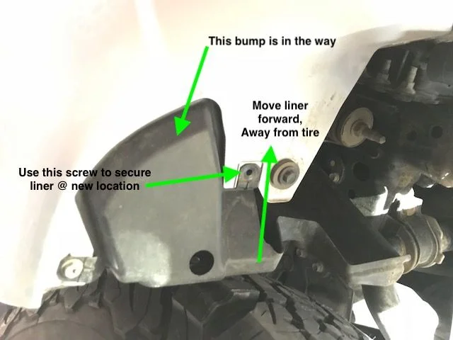

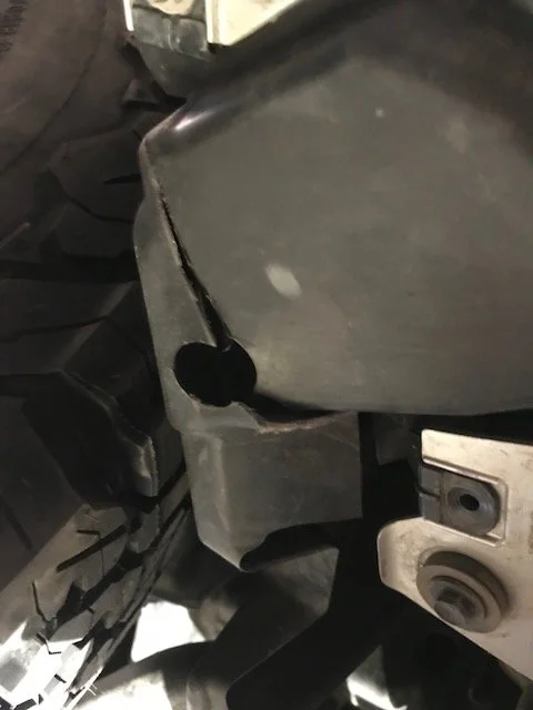

I took off the front mud flaps and pushed the front of the front-fender liner forward about 1.5"-2". I did this same modification on a '17 4Runner I had and it was much easier. Here is a link to someone else's writeup on T4R.
285’s on a 2016 4Runner Trail - Fender Liner Mod - Toyota 4Runner Forum - Largest 4Runner Forum

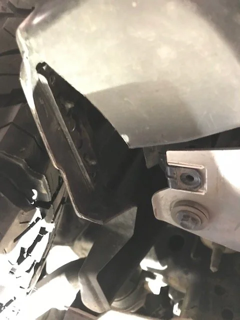

The idea is to remove 1 or 2 of the existing coarse-thread screws, push the liner forward and then use the same screws to hold the liner in a more forward location. The 4Runner is definitely easier because the plastic on the LC is thicker, and the shape is not as conducive to simply sliding forward. Here are some pics of my fender lining mods:
For orientation, the front of the bumper is up in the picture (above)
For next 2, front of bumper is to the right (below)
Post Mod (below)
All the critical components (body mounts and sway bars) are clearing without issue, but I did end up smacking the rear inner corner of the back side of the front wheel well with a hammer. I did this for my prior tires (275/70r18) before my lift, so this might not be been needed with the new UCAs (bringing the wheels forward slightly in the wheel well).

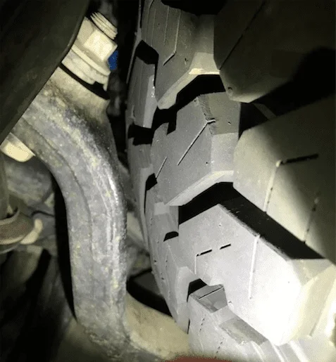

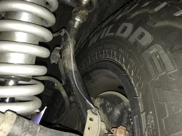

Yesterday morning I spent some time under my vehicle, watching the full arc of the wheels as my 11yo son slowly moved the steering wheel from left to right and back. I tried to visualize how the spacing would change as the suspension cycled up and down.

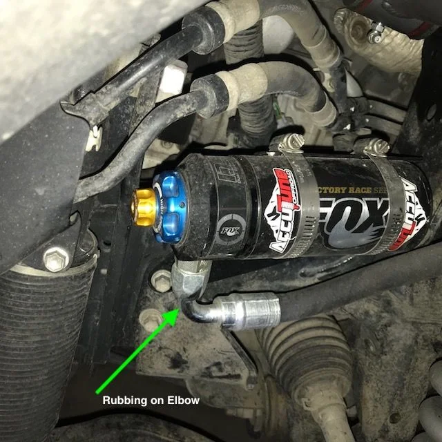

I wanted to get a better idea of clearances and also investigate a minor rubbing sound I experienced twice this week, while turning to the extreme right, going from reverse to forward. I discovered my right wheel was touching the remote shock reservoir.
I moved the reservoir body to the rear about 1/2" (to clear the KDSS bracket) and pushed the whole assembly inboard, toward the middle of the vehicle. I had it further out to clear the KDSS Piston mount and give easy access to the compression knobs. Now the knobs are a little more fiddly to adjust, but not terrible.

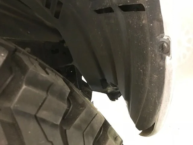

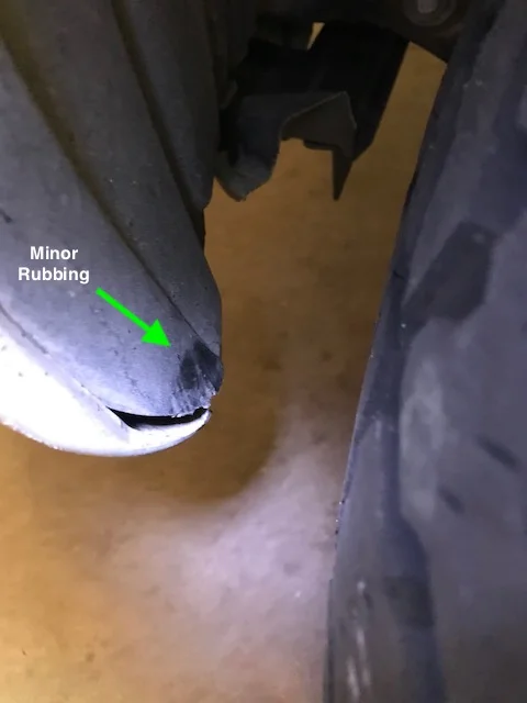

I also noticed evidence of very slight rubbing at the outside front corner of the front wheel wells. It is so minor that I have not done anything about this. It does not touch when I watch the tire arch, so it must happen as the suspension cycles up or down. This can also be handled with the wheel-well tuck mod I posted above.
The major areas of concern all seem to be fine: body mounts, KDSS linkage, upper control arm. When turned hard, all the way to the right, the tire is close to (~1/2") to the KDSS arm. However, it does clear it and the distance immediately increases (>1") as the wheel is moved slightly toward center. The pic (below) makes it seem closer than it really is and the bolt is further away and not a concern.

Front Wheel Wells (front edge) - slight rubbing at some point in the swing, likely when the suspension cycles (too slight to hear or feel)
Front Wheel Wells (back edge) - removal of mud flaps is obvious, but the inner corner needs to be trimmed and possibly pushed toward rear of vehicle
Shock remote reservoirs (mounts needed to be pushed inboard about an inch, but this was user error; I had bent the mounts out to give better access to the knobs)
Stuffing the Tires - The outside edge of the fender could be a concern, but I have not had issues yet. (I'll post an update if I have issues)

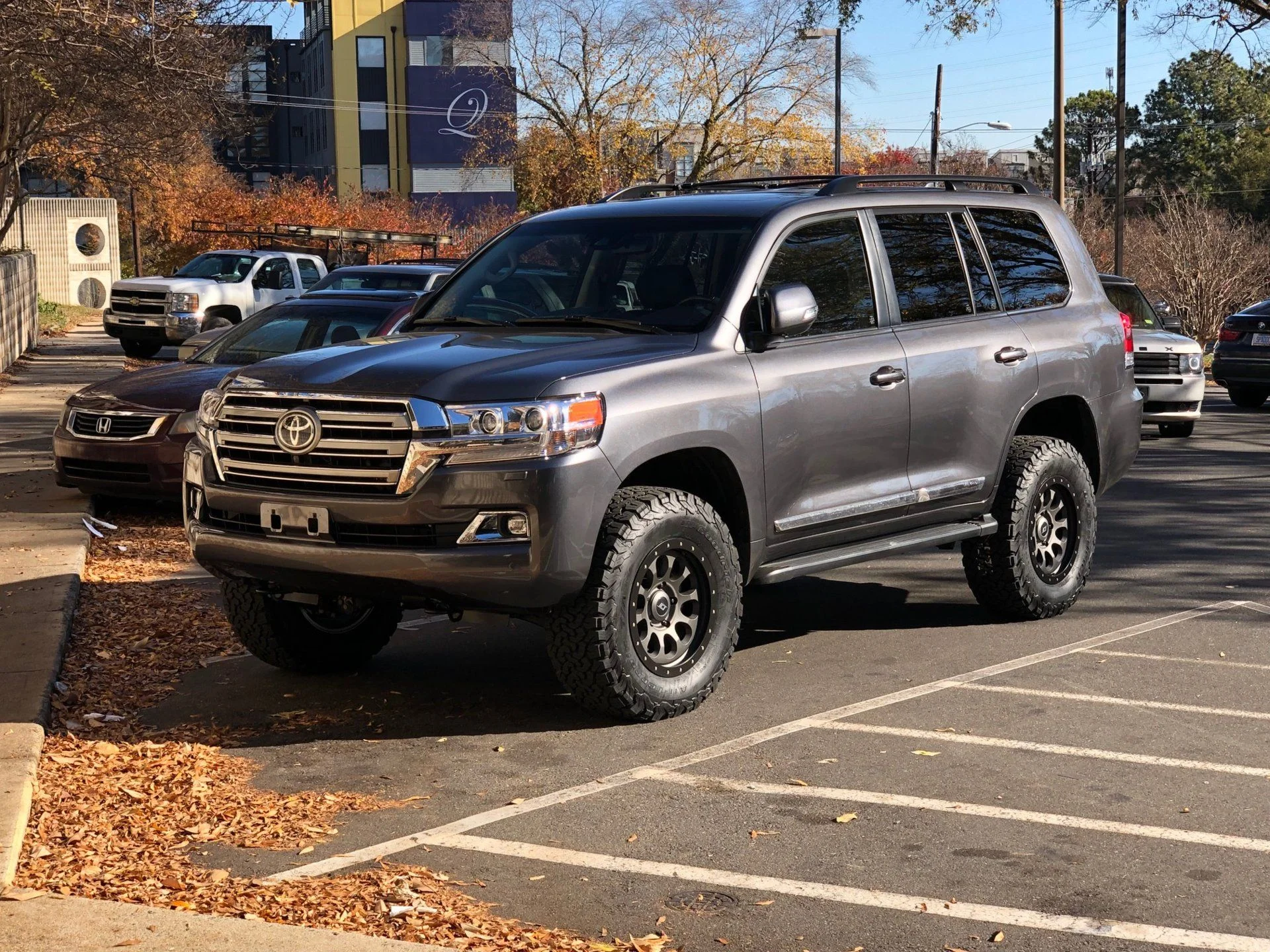

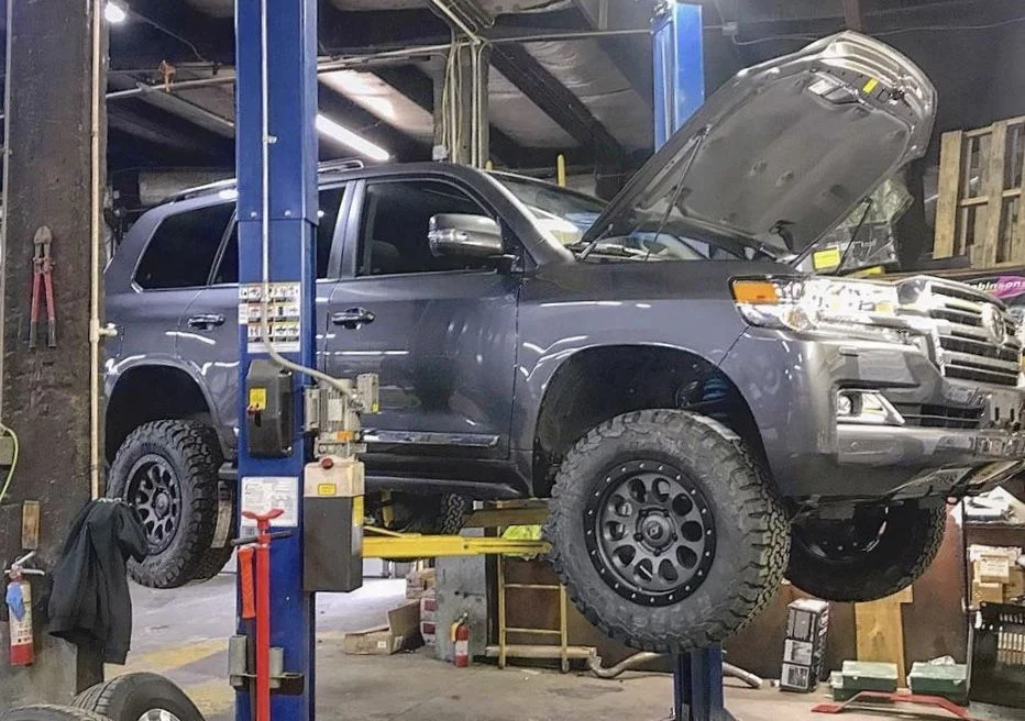

Here is my 2019 LC with 305/65/18 BFG's on Ray 10's to give you an idea of the look. You will have to adjust the front fender liner at a minimum. When going to that size a knowledgeable alignment tech is a MUST!

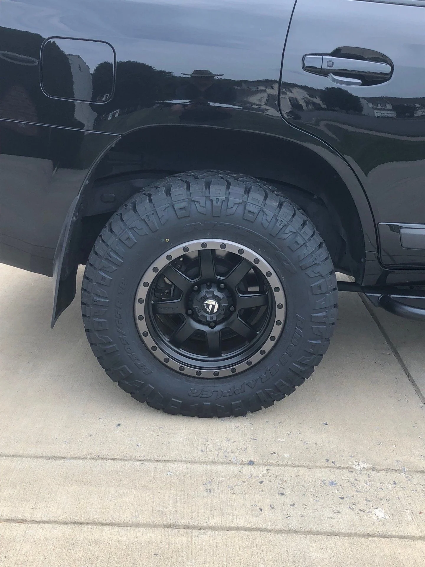

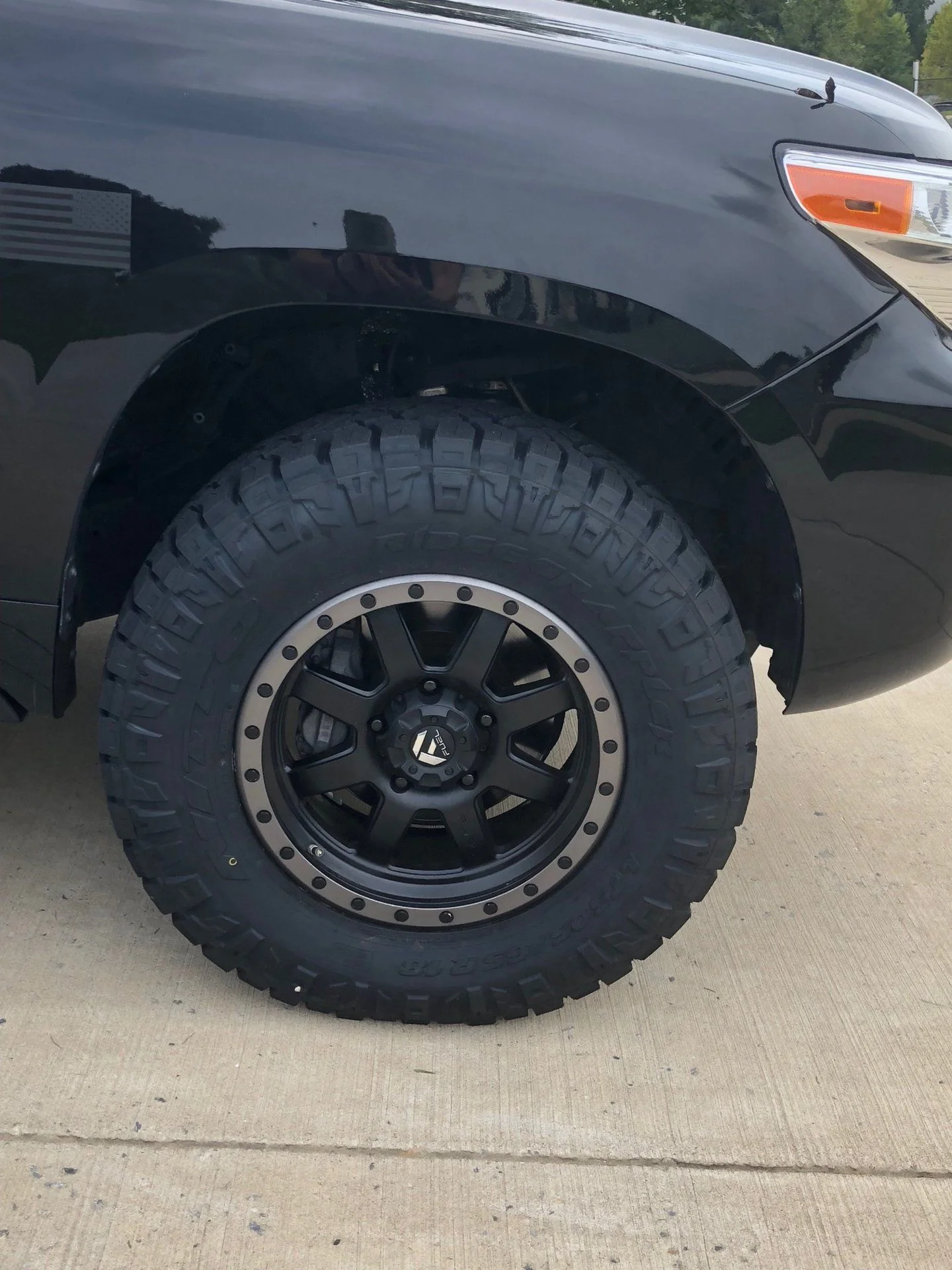

I did go with the Nitto RidgeGrappler 305 65 18's. Very smooth ride, and no problem balancing. I ran them in the light snow we have had this year in Virginia, and they were as good as, or better, than the KO2's I had on the 200 previously.
