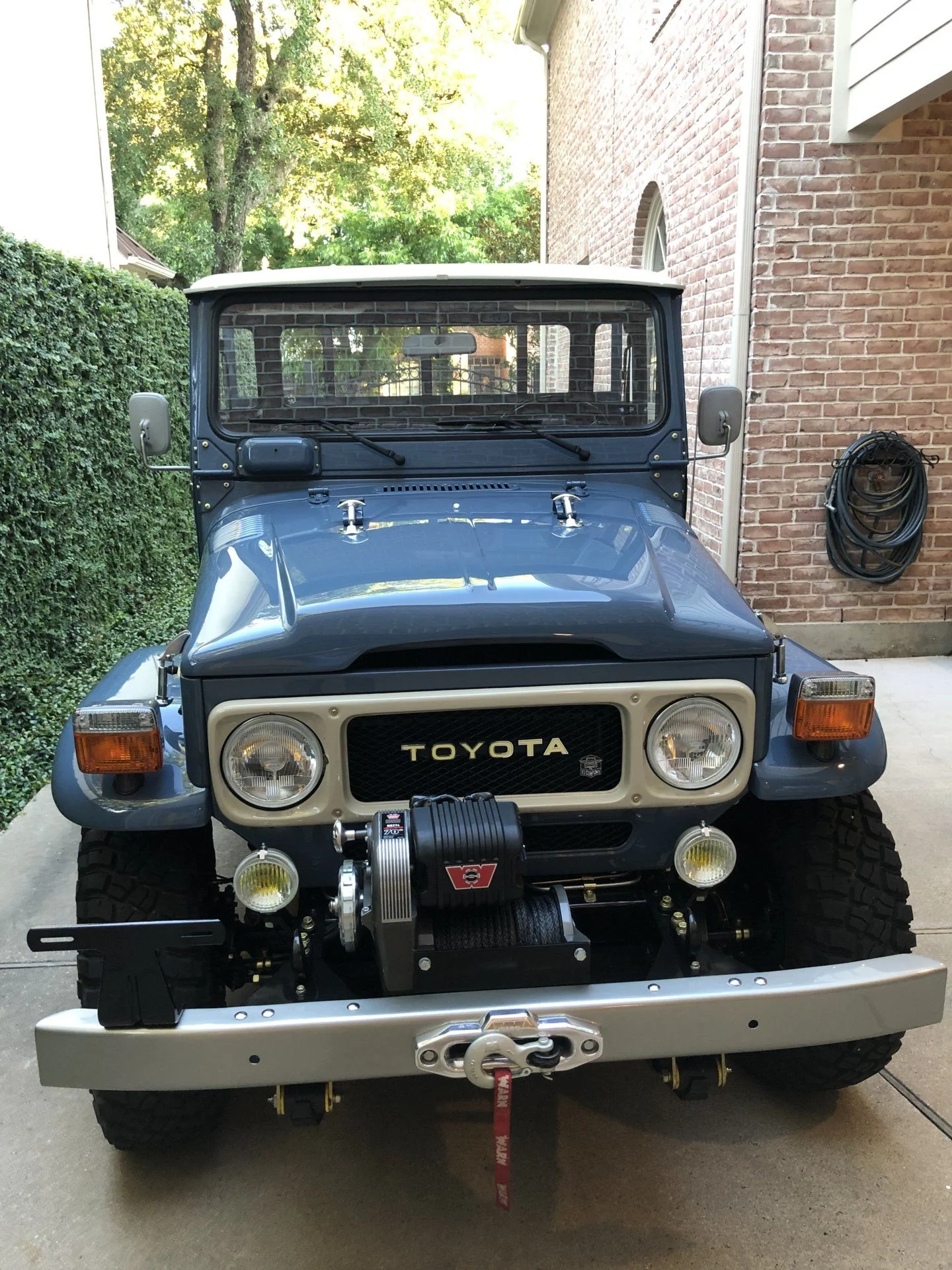

Well, now that baseball is over, time to let the adventures begin.
Big City after the Merle Haggard song, man I cant wait to let the city go and end up n the middle of Montana.
Yes, I had the truck built. Turned 50 this year and wanted a truck that wasn’t a project, one I could just enjoy. I have three others, only one real project, but wanted to stay as much original as possible. Spent a year looking at builders, did not see a couple of them, but choose FJCo and couldn’t be more pleased. Will explain the differences if asked. Here is what I have.
1981 FJ45 LPB, Cadet Blue (med blue originally), completely rebuilt 2F, H55 and TC, both new. 80 box with the 105 shaft upgrade. 33’s on an OME lift, 3.70’s for the road right now and Vintage Air. There is some really cool engineering on this truck to keep it as Toyota as possible.
It was built to drive and enjoy. Hope to keep this thread up to date with pictures and stories of the truck.

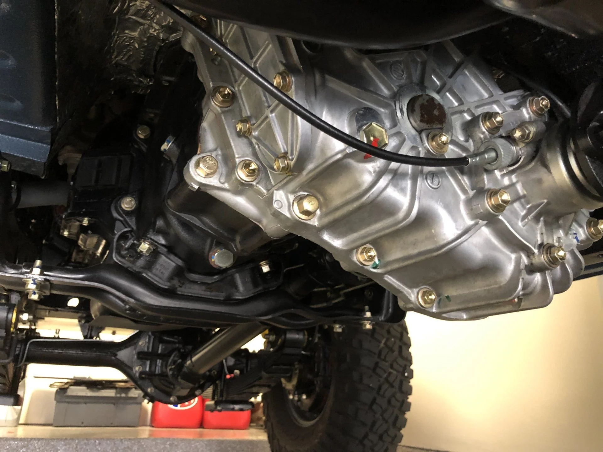

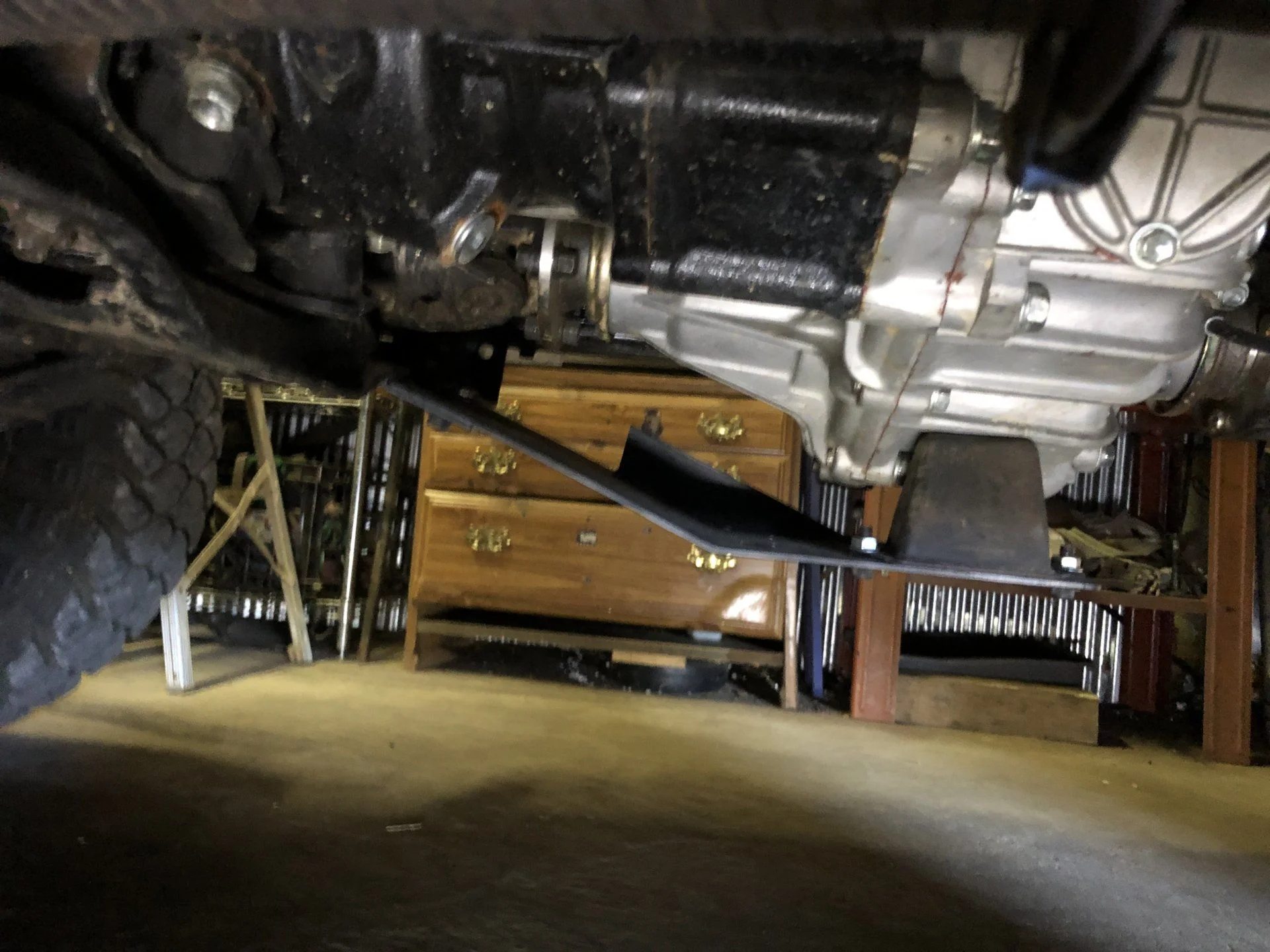

Few more pics. Next step is a skid plate for the 5 spd. Frame has production of late ‘79 as researched. Think I may start with a 82-84 5 spd plate if I can locate one. Can’t be that much difference between a 40 and 45 frame thru TC location.

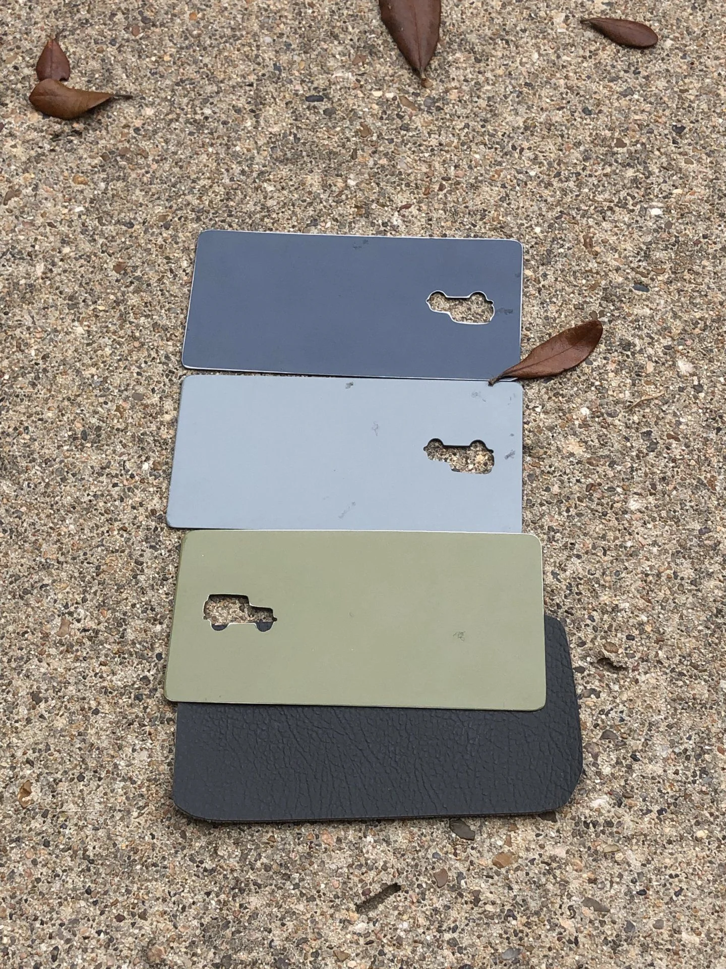

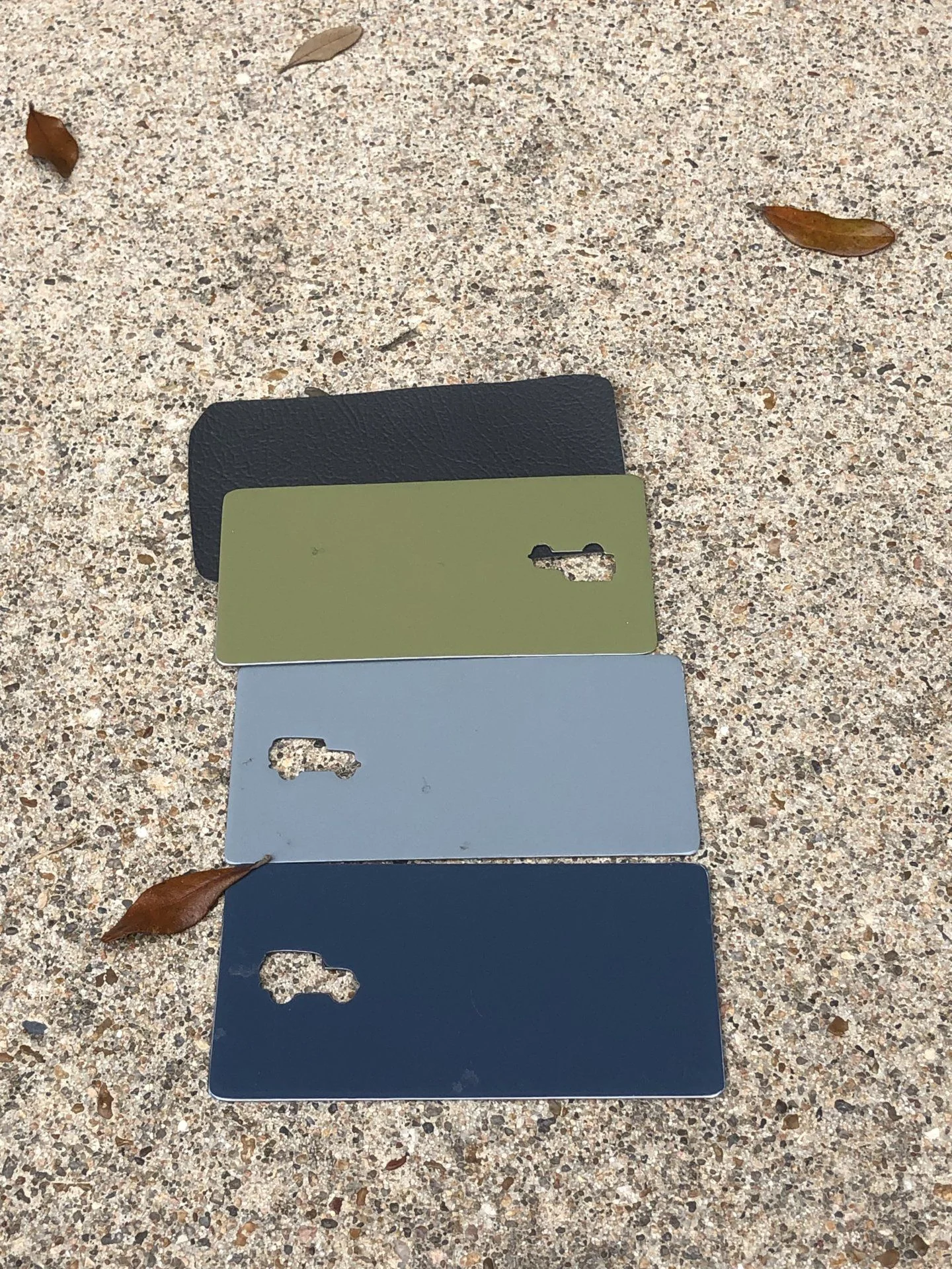

jfz80,
I really liked the Olive, it was one of the color chips I considered. Truck was originally Med Blue, to bright for me. Didn’t see a lot of blues, now I see it everywhere. I really like Ed’s 45 I see on Instagram. Think that is River Blue or something like that. Have a great weekend. Check out how the colors changed with light angle.

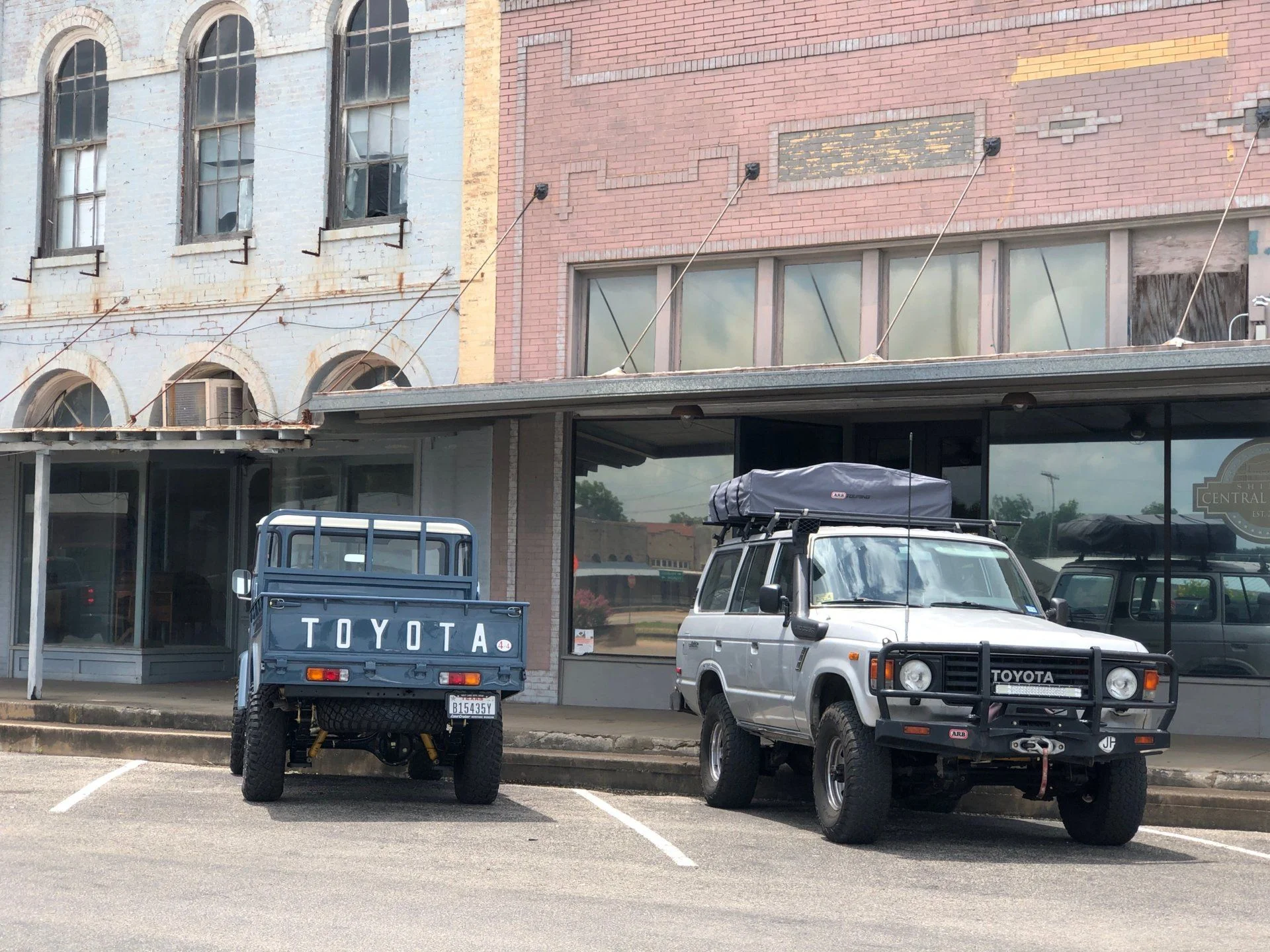

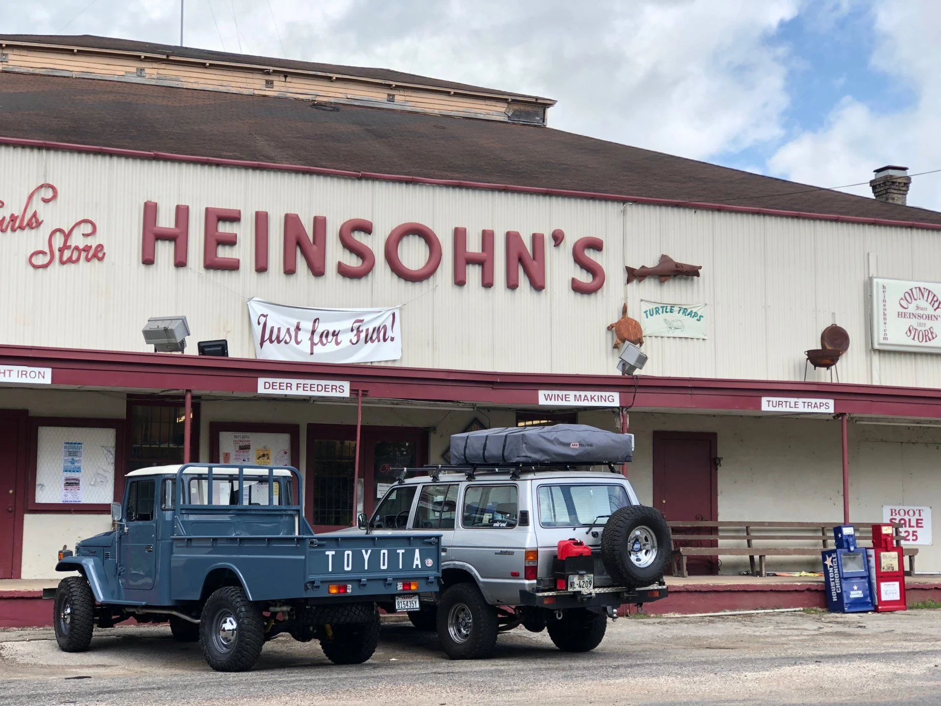

Had the chance to put a little over 300 miles on “Big City” yesterday. A good friend @HemiAlex went along also in his 60. Great day exploring TX backroads and stopping at the Shiner brewery for a tasting.

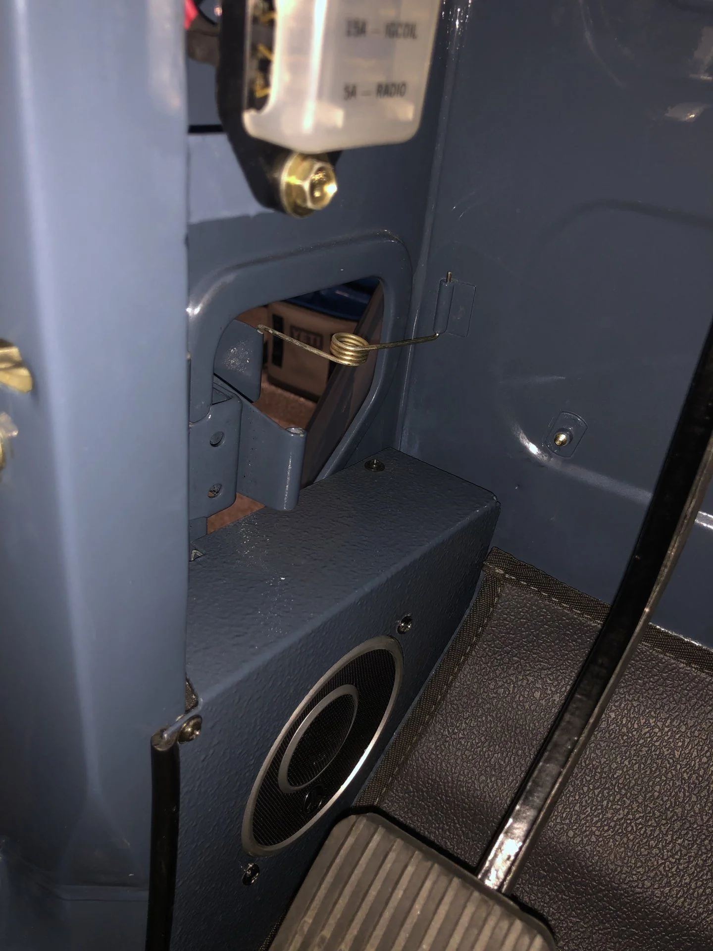

Lets see some interior photos. These tin cans are hard to get comfortable. Want to see what y’all did.

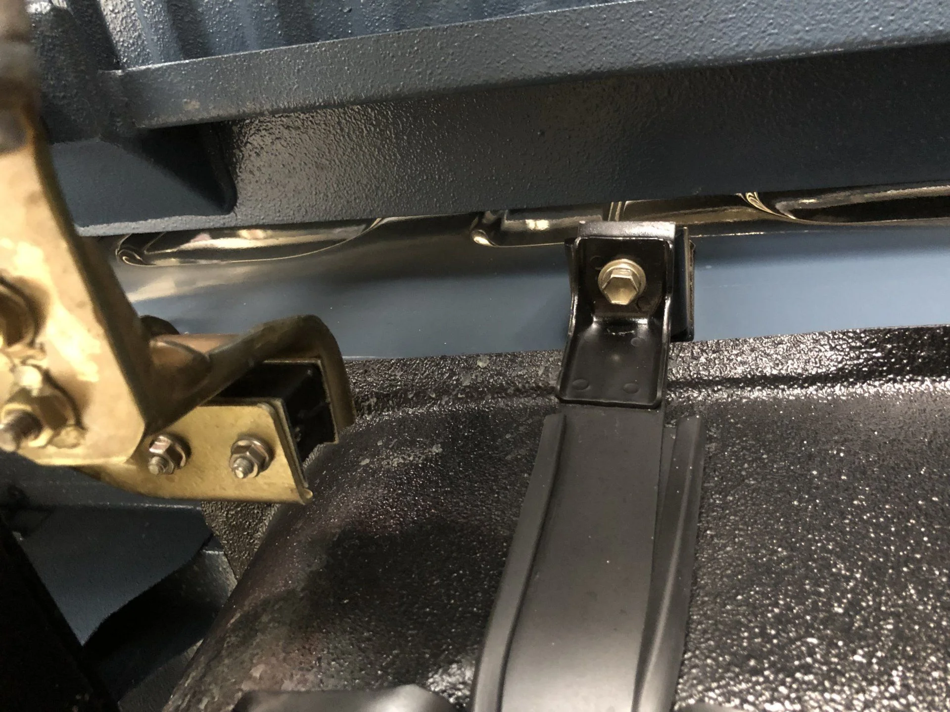

On the skid plate, I had @nvrlose54 make me a simple metal one like a 4Runner that comes off the transmission crossmember.
Im sure you don’t have plans to go rock whomping in that beauty but at the same time you don’t want a magic rock to smash that split case.
I would not expect you to make one like this with the repurposed bumpstop (my idea since it’s the Warthog) but with a bit more support this would be all you need.

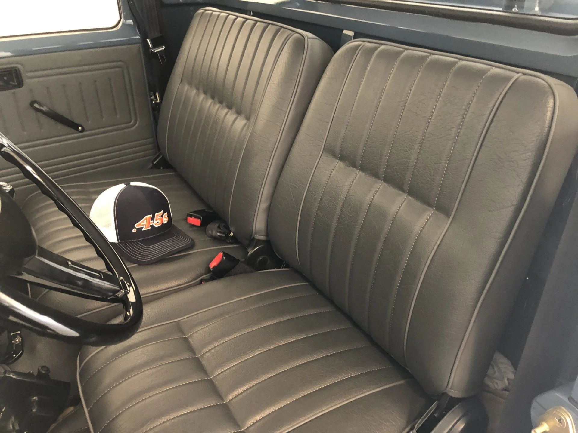

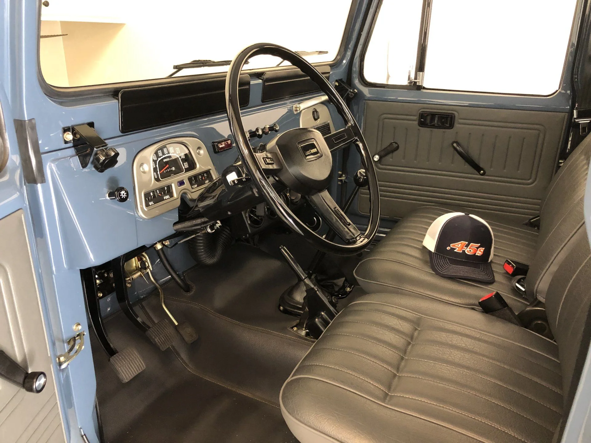

Interior is bone stock. I was waiting for a later model that has “better” seating. They kept the manual throttle control for me per request. I did mount kick panel type speakers but they kept the functionality of the kick vents. Just a grey vinyl, I think pretty stock looking. I did a vintage air in the “tin box”, kept it down below so what storage these have can still be used.

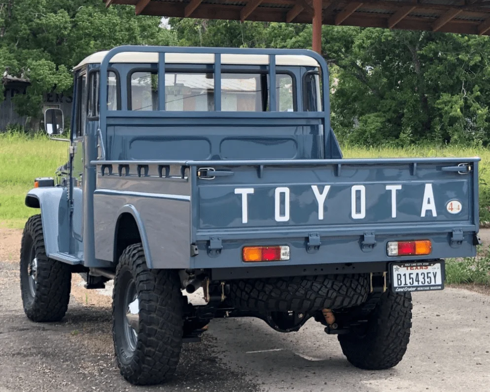

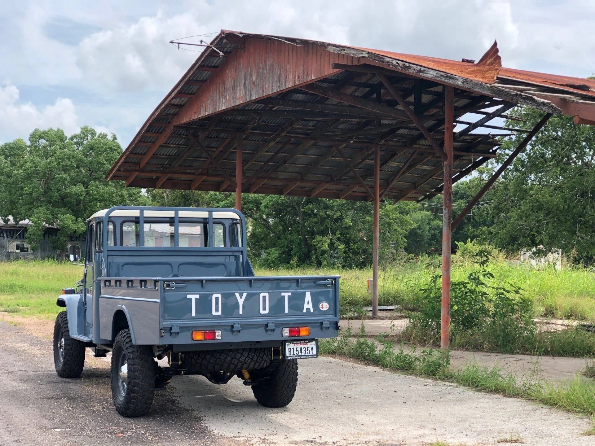

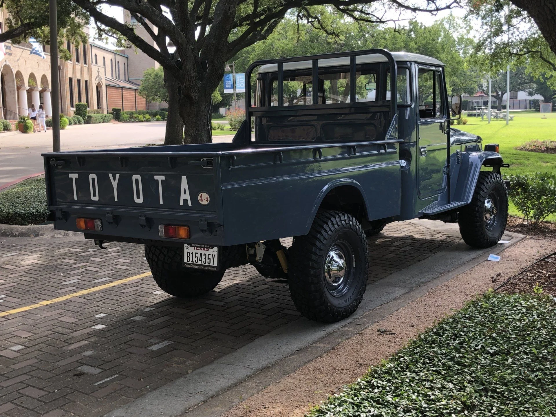

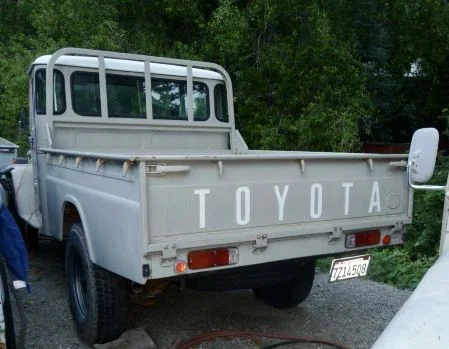

Certainly a beautiful rendition. Maybe not noticed by the general public, but I am wondering why the rear valence was modded to relocate hinges and tail lamps, since fabrication shouldn't have been a problem?
Bear,
Interesting. It looks like most of the later year LatAm 45’s I have seen. Yes, different from the early US Spec trucks. What do you see?

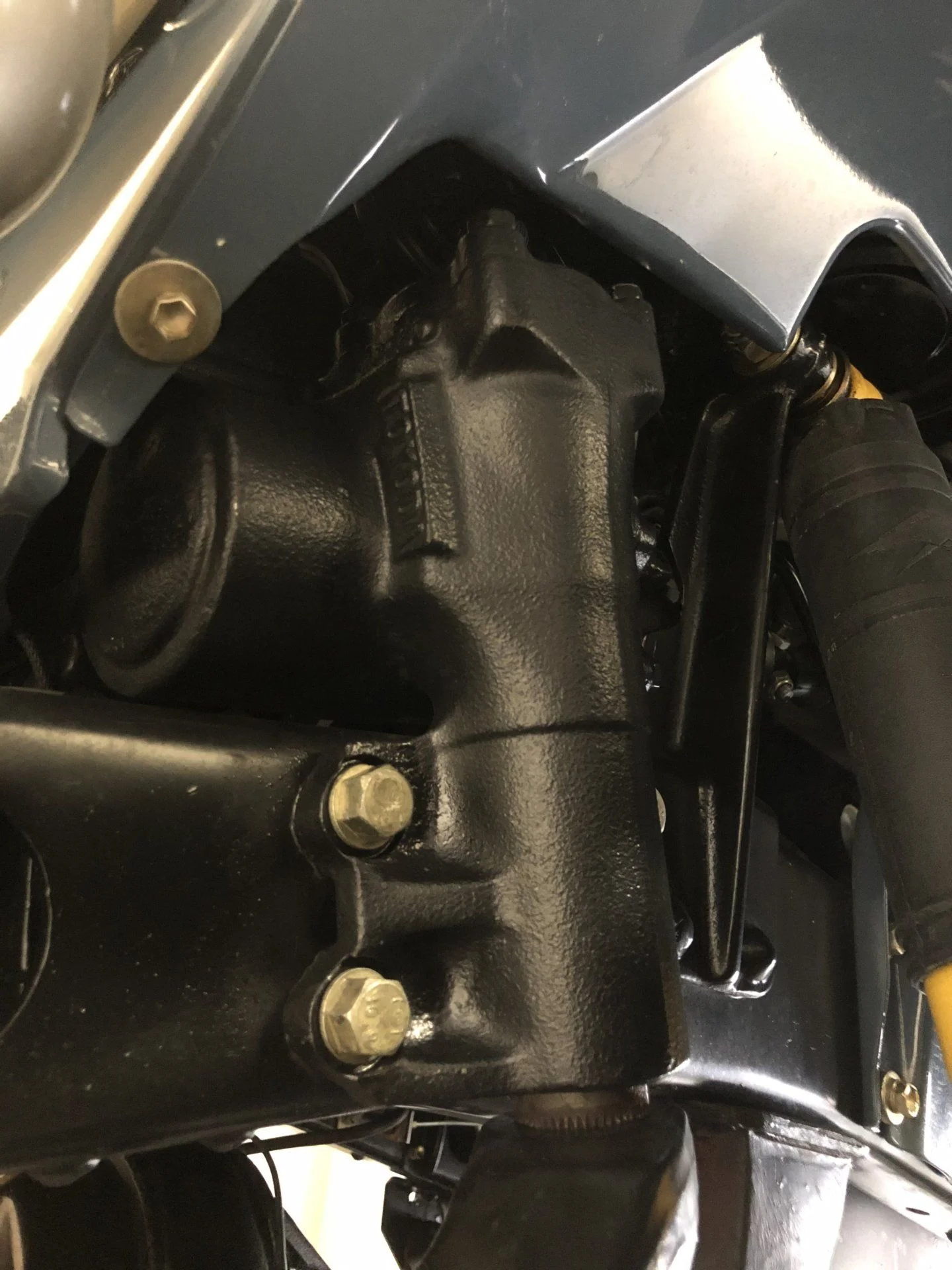

What's a 105 mod?

What's a 105 mod?

It’s steering shaft from a solid axle 100 series that can be added to a 80 series box. Complete overkill for this truck with 33” tires but smoking cool nonetheless

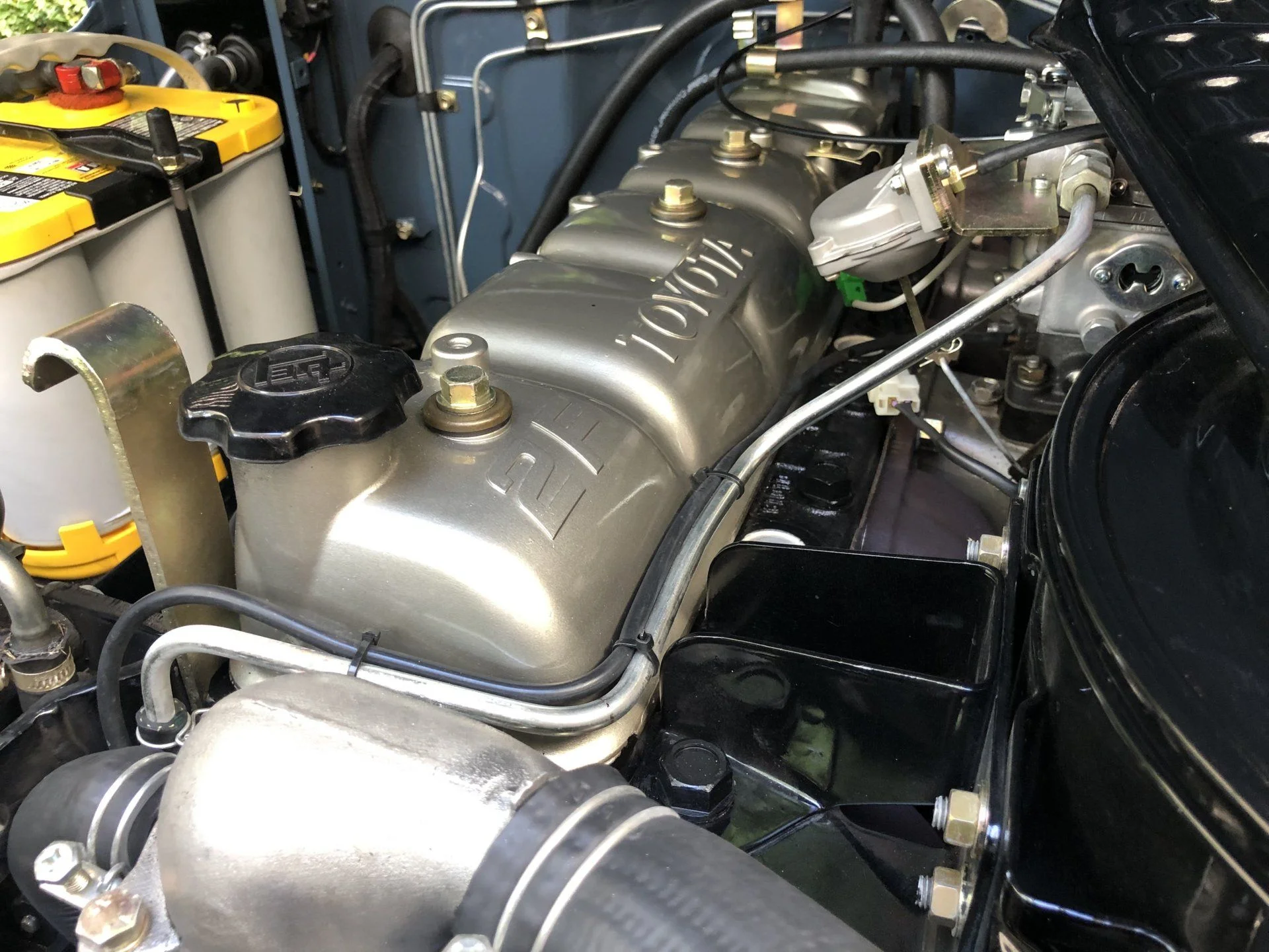

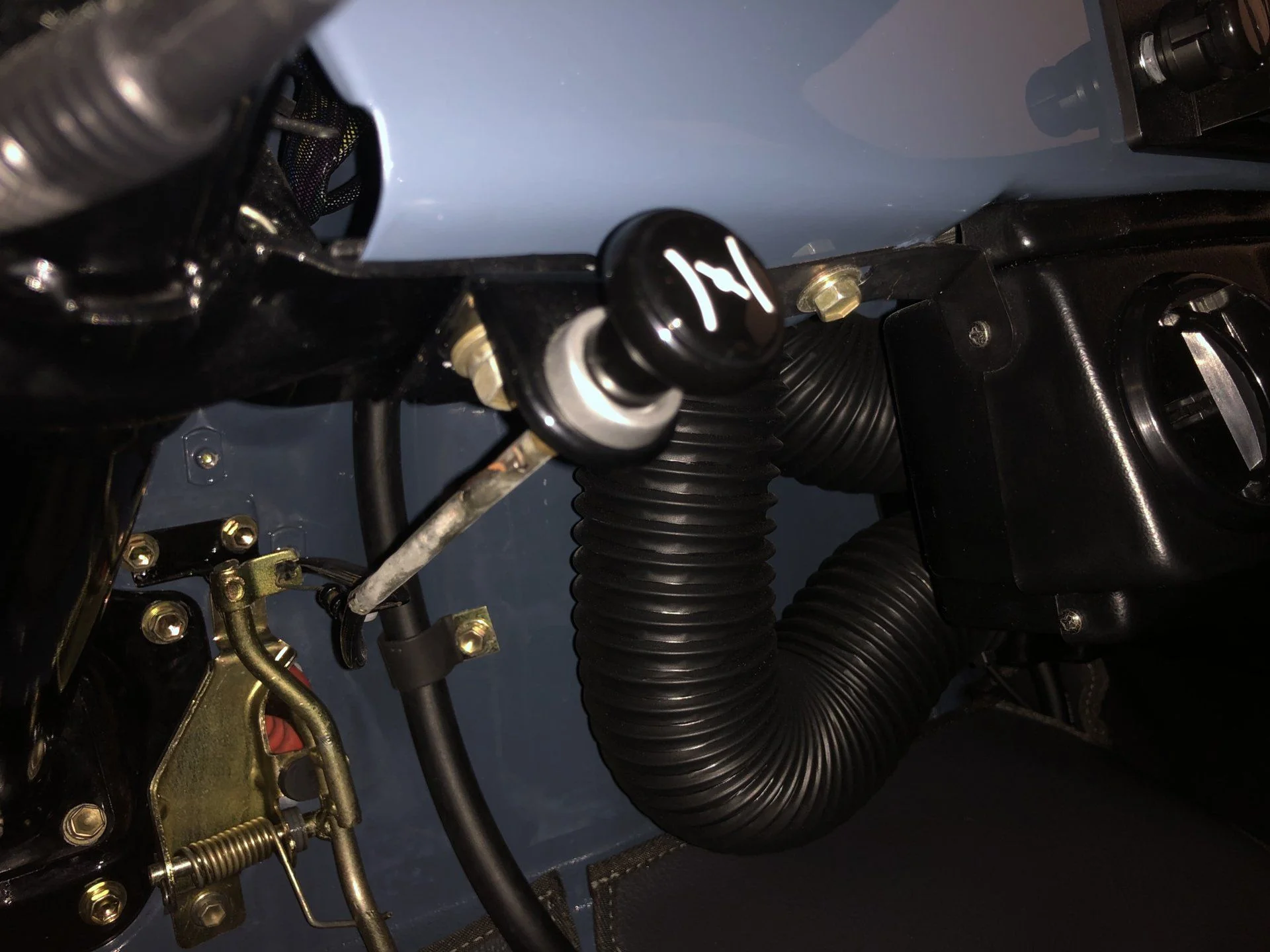

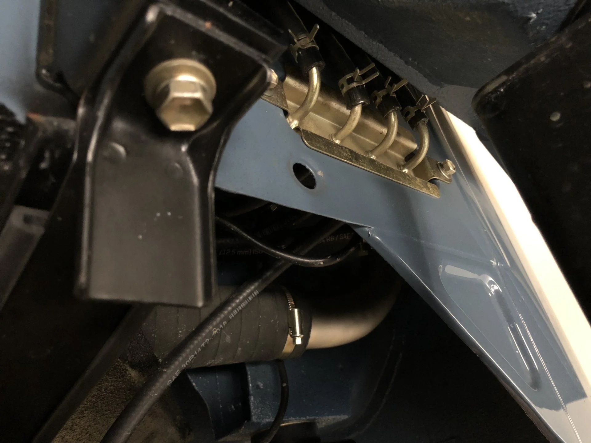

I assume this gizmo is vacuum actuated idle up for the AC? Appears to be a repurposed secondary actuator...
interesting to me that shop would custom fab this setup rather than just add stock actuator/linkage like fj60 (and I assume '82 fj4X with AC) carbs
erics
Good catch. Yes you are correct. Wish on the build was to use as much new, but keep it Toyota. I have a few carbs so yesterday I went back to a 60 idle up diaphragm. This worked well, I like the more period correct better, although it looks it’s age and a little out of place.
