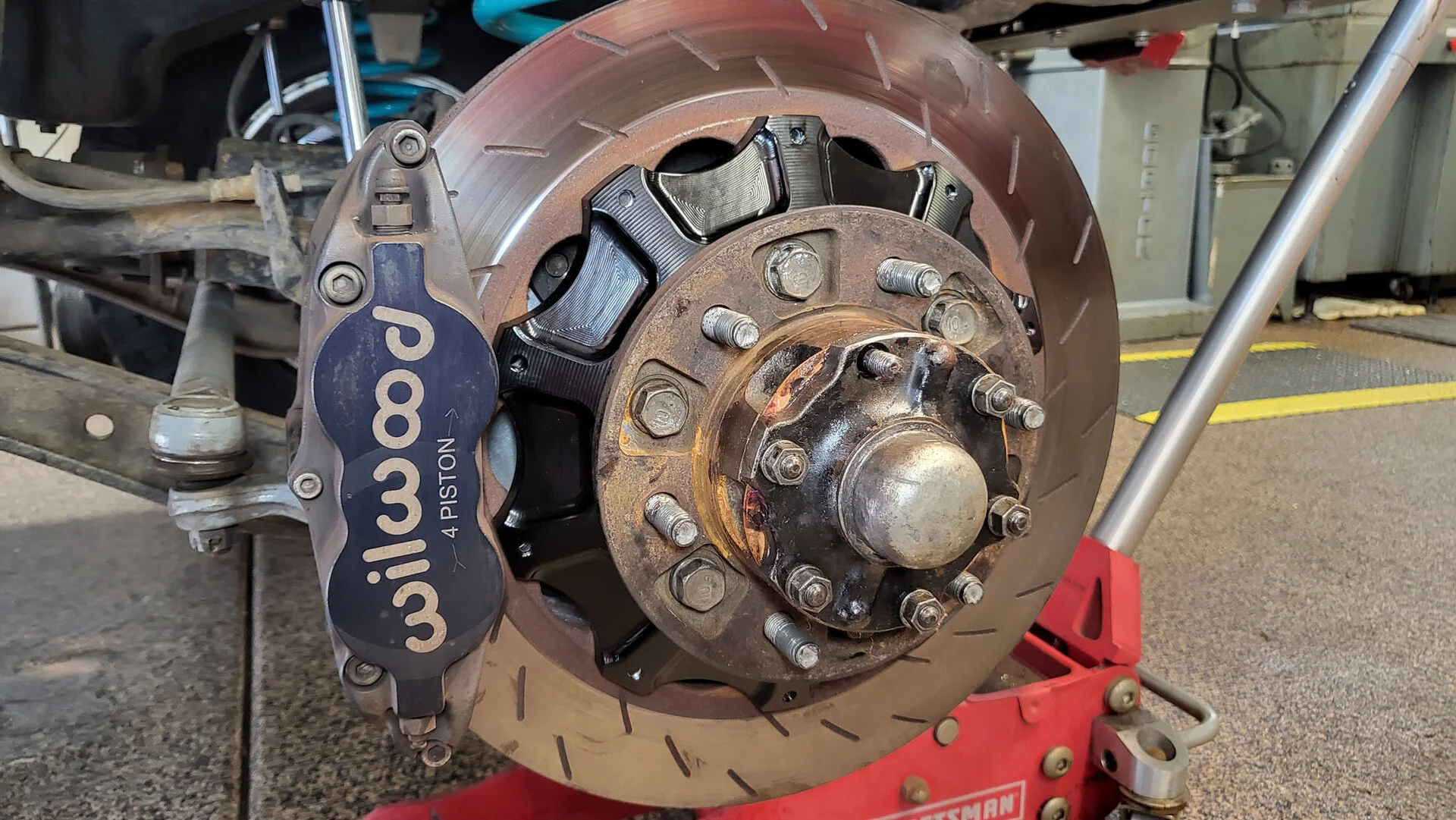

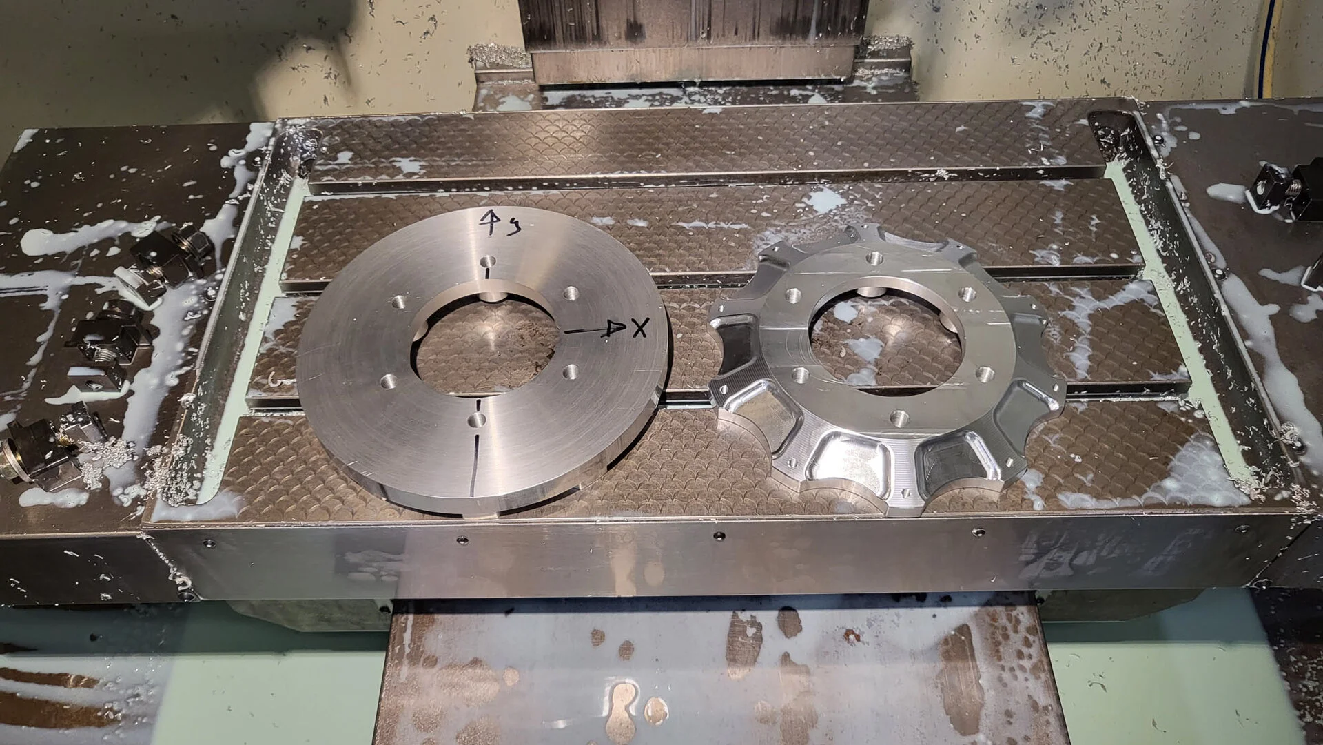

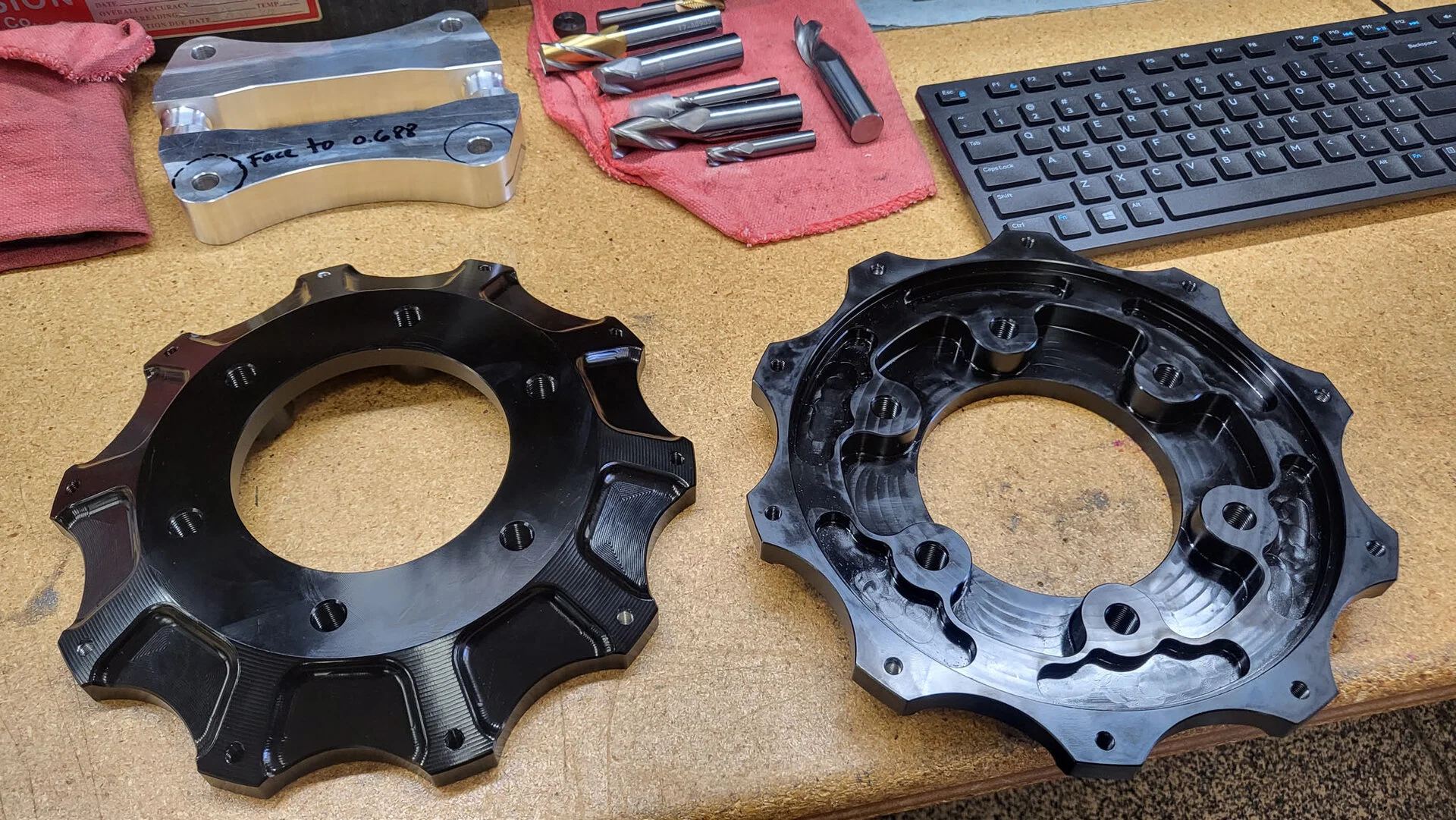

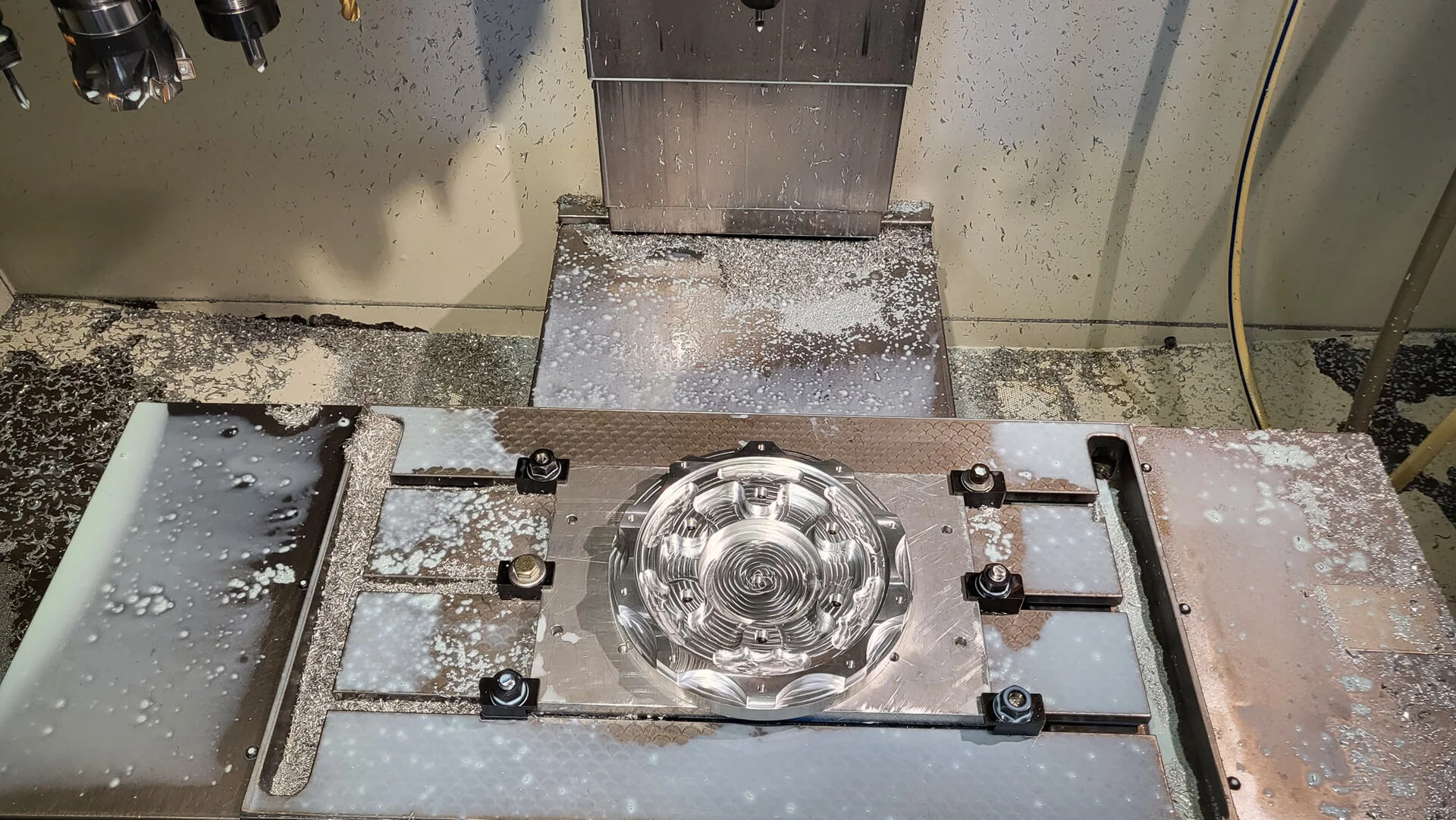

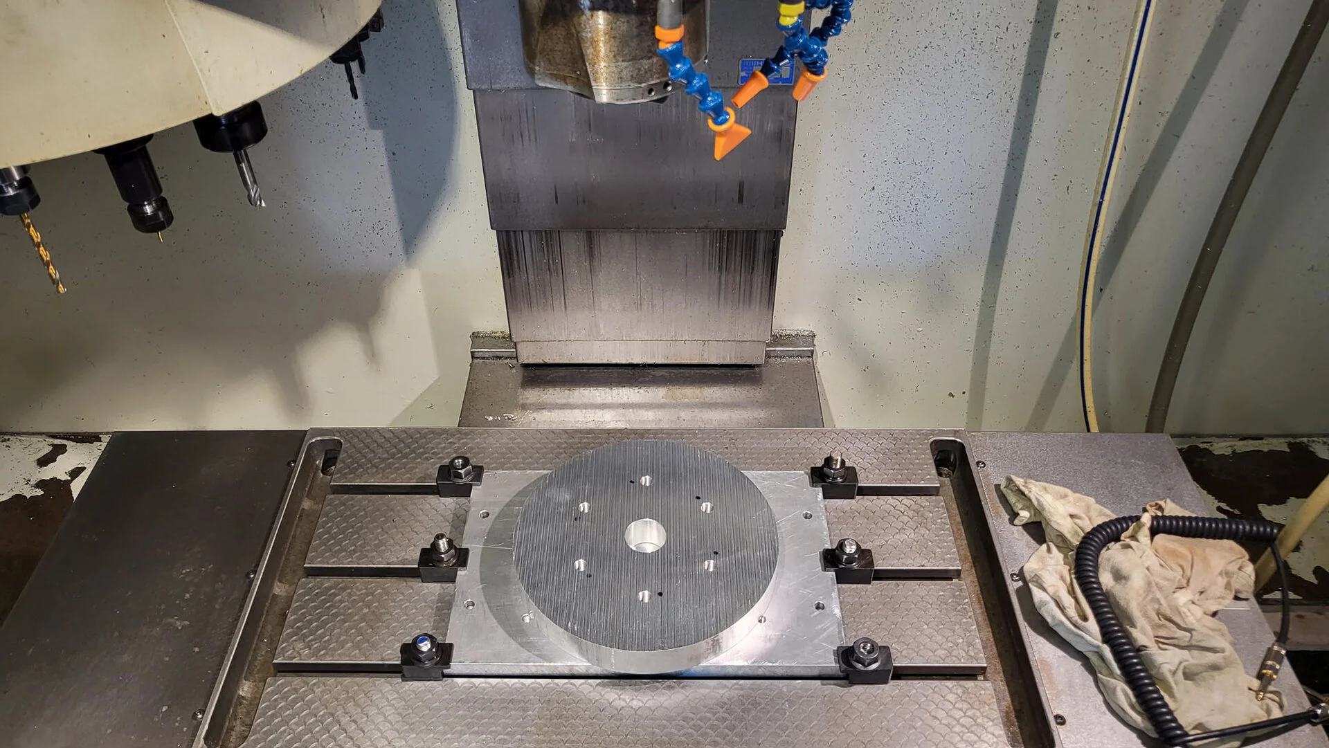

Are the rotors keyed in any way to the hat, or is the OP relying solely on those 12 or so bolts loaded in shear to keep the rotor attached to the hub? I didn't see any keys being placed in the original set of pictures.
The rotor is not floating. The bolts (10 of them) are torqued and produce a force between the hat and the rotor. The small tabs on the rotor have slightly knurled surface. The bolt torque and friction between the two surfaces is adequate to prevent movement. There is no need to key and this type of rotor is not designed to be installed with a key.

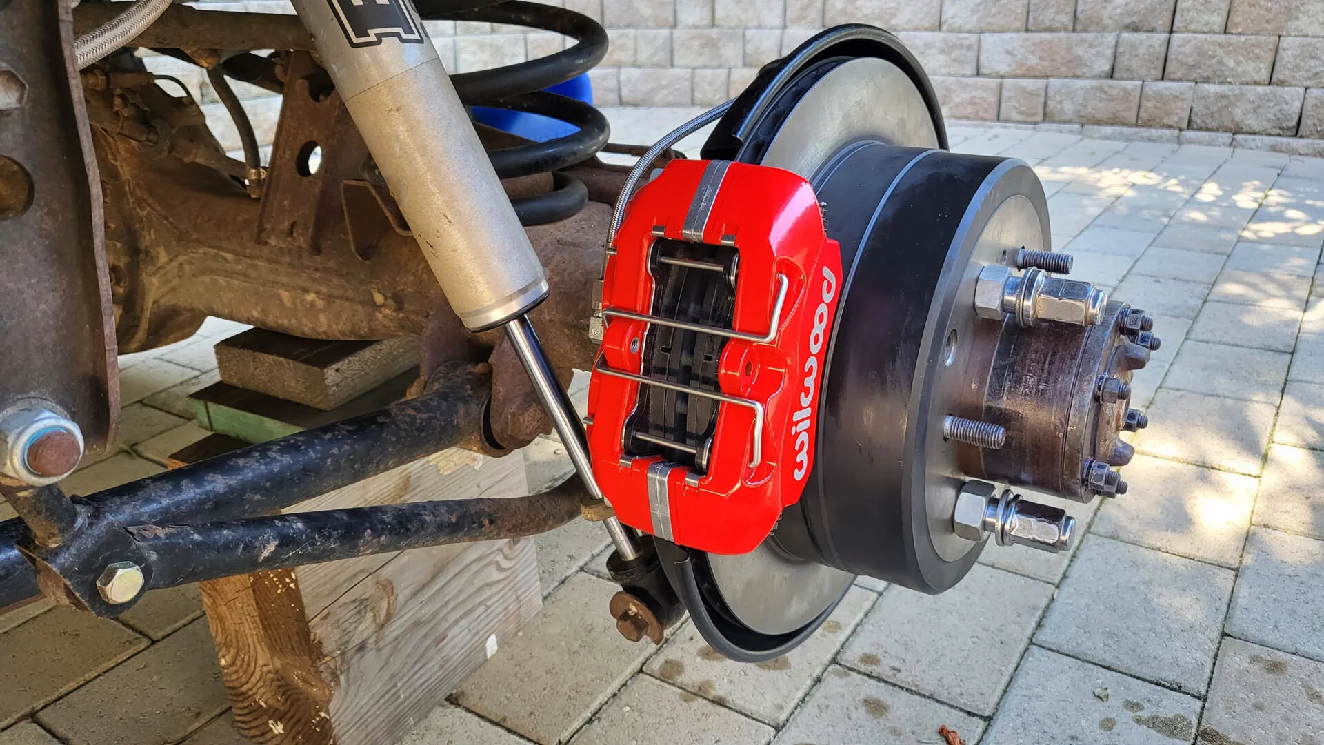

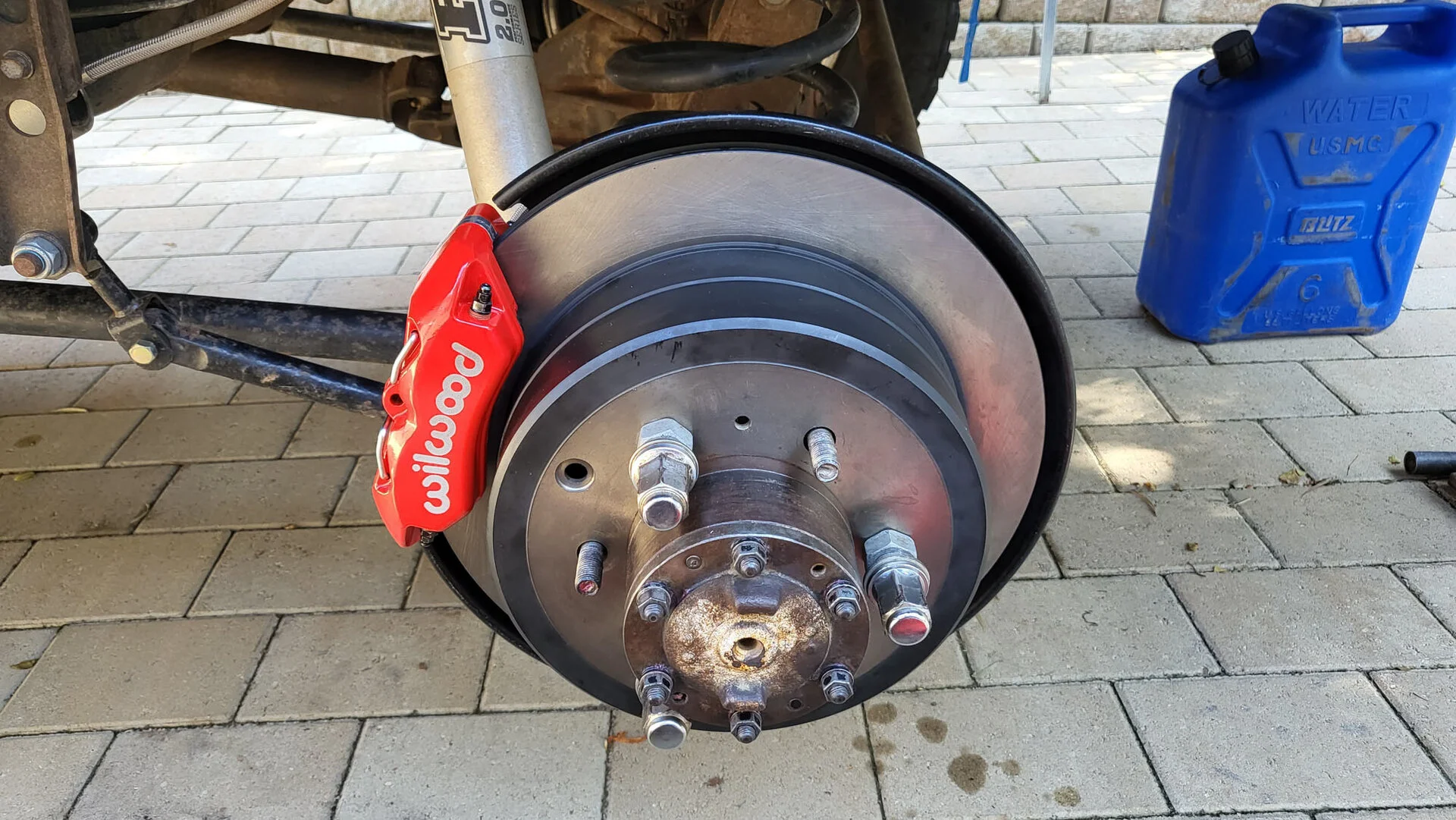

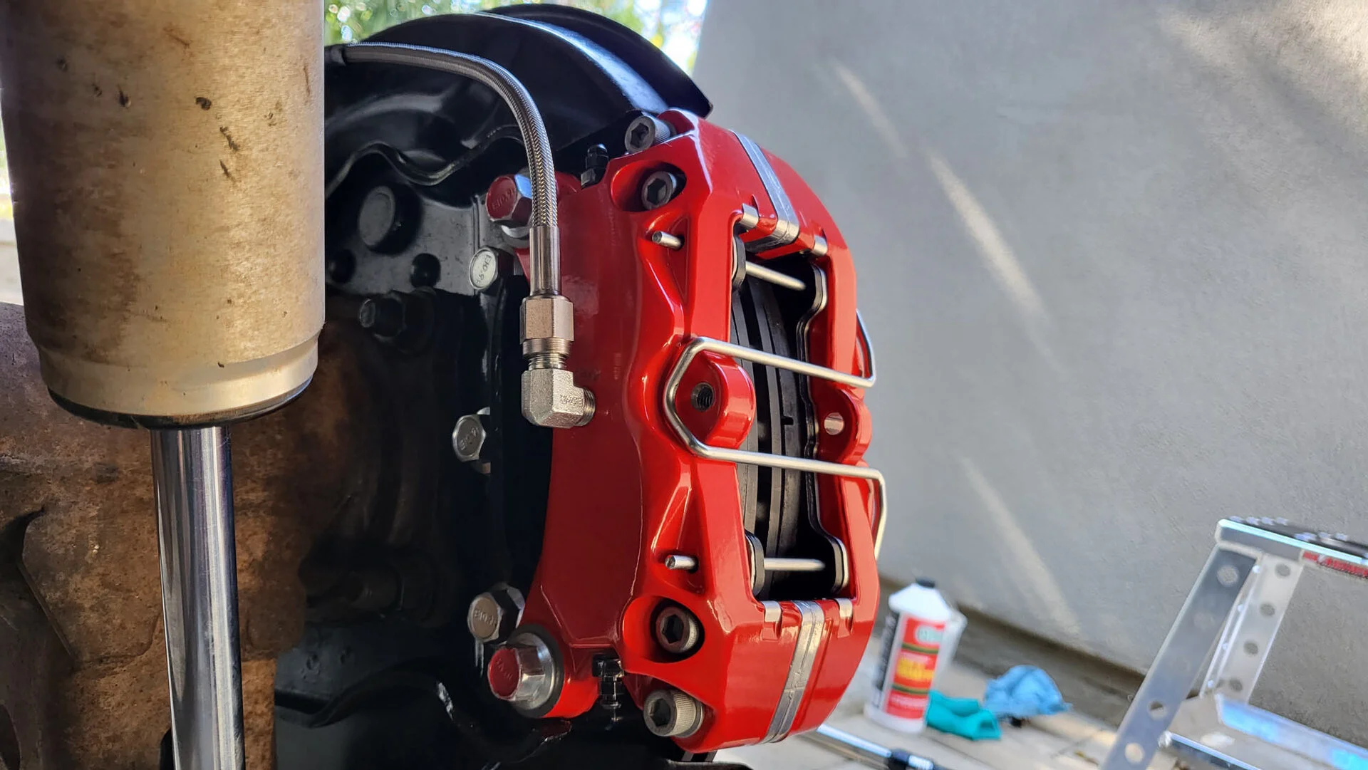

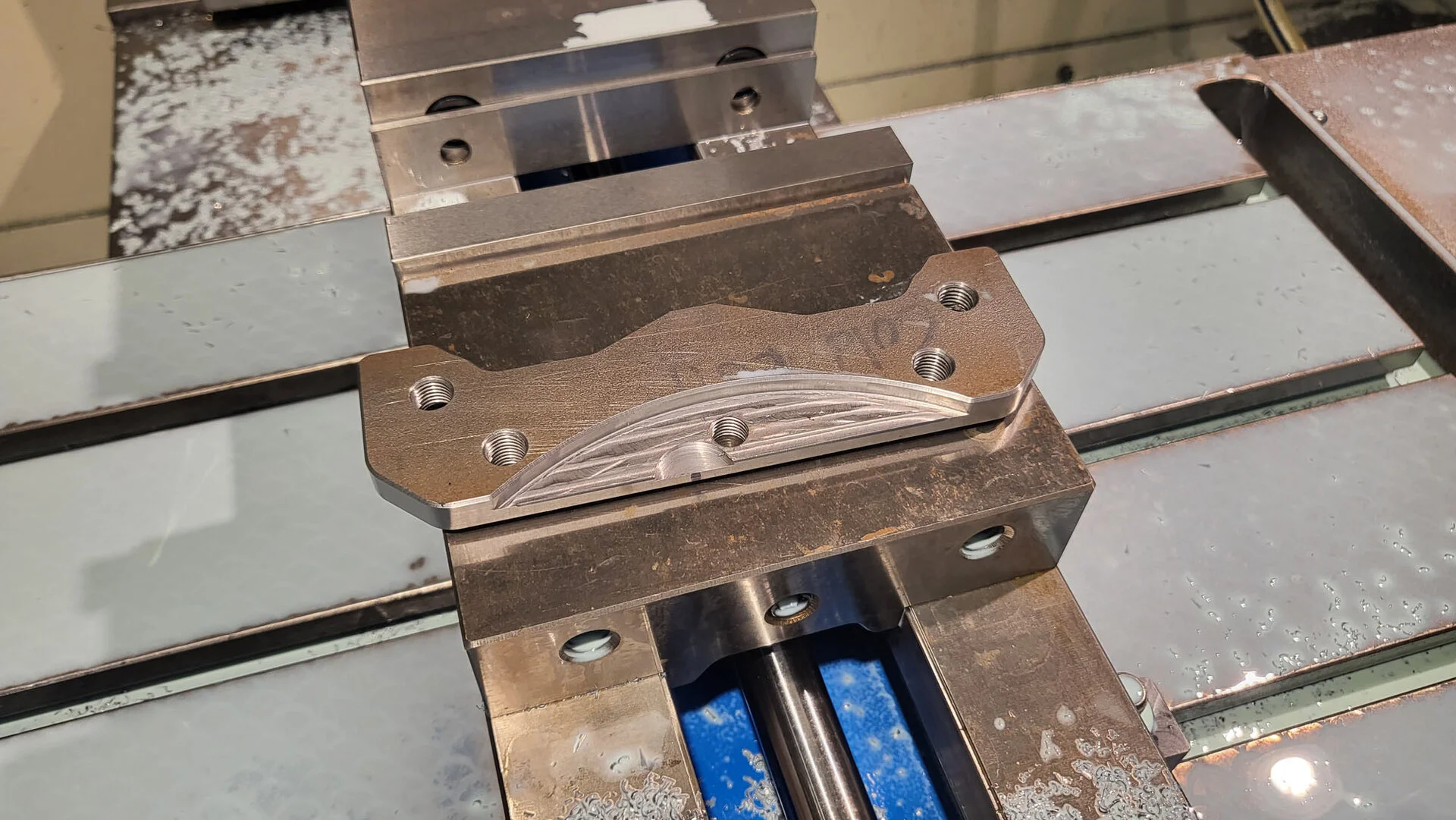

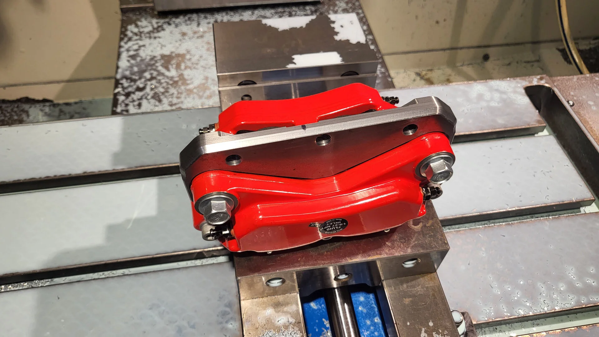

I replaced the single piston rear caliper with a 4-piston Wilwood.

my ABS is removed but it would not affect a functioning system (except provide provide better braking performance).

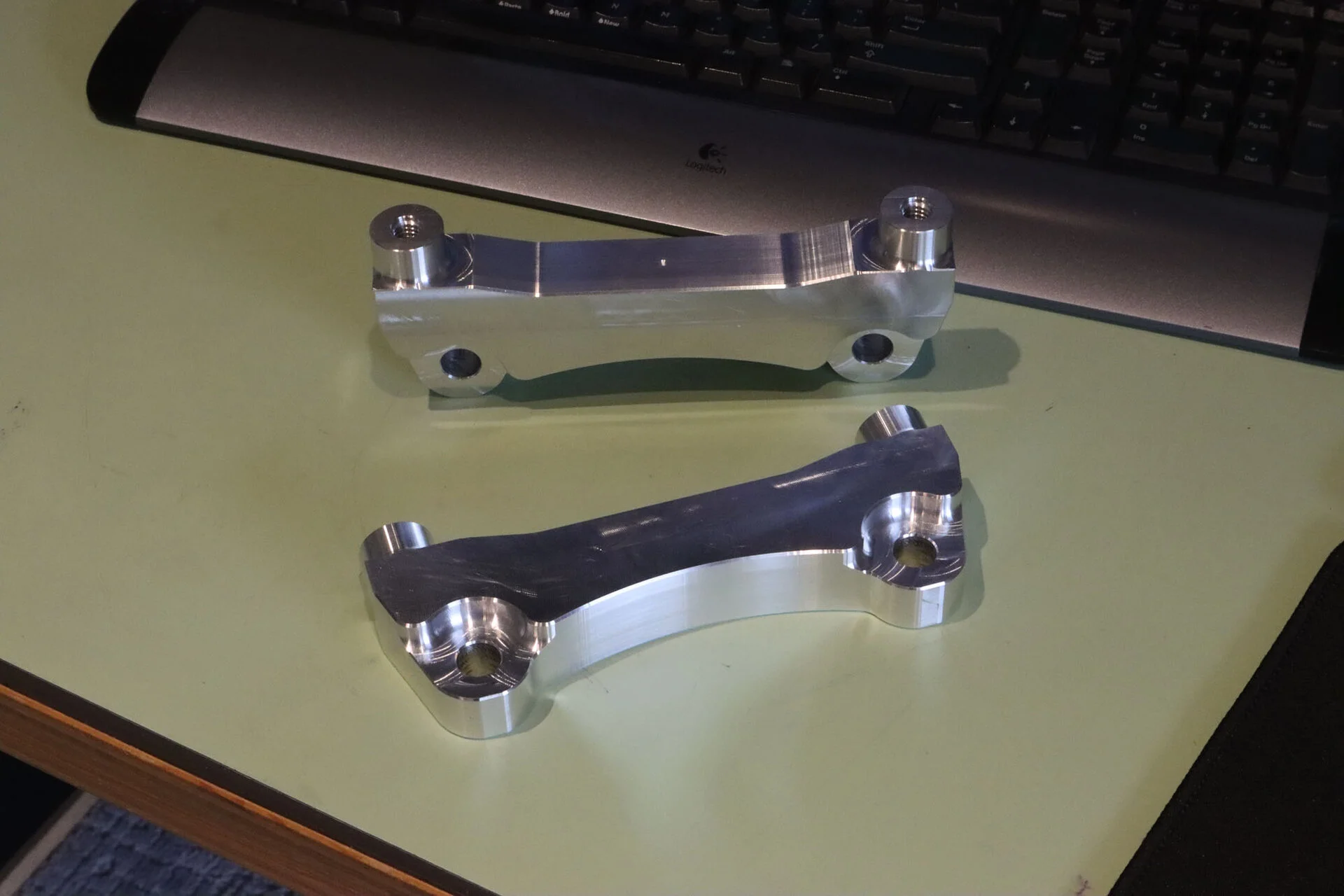

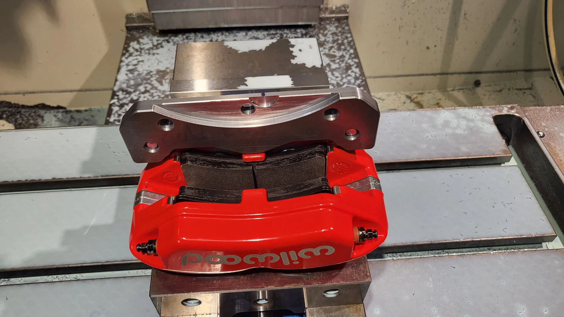

Cool! would you mind showing how your bracket matches up with the factory caliper mounts @1FZj80 ?
dunno? I could make a few but they would have to be sold by a business (for obvious liability reasons). do you think there is any demand?

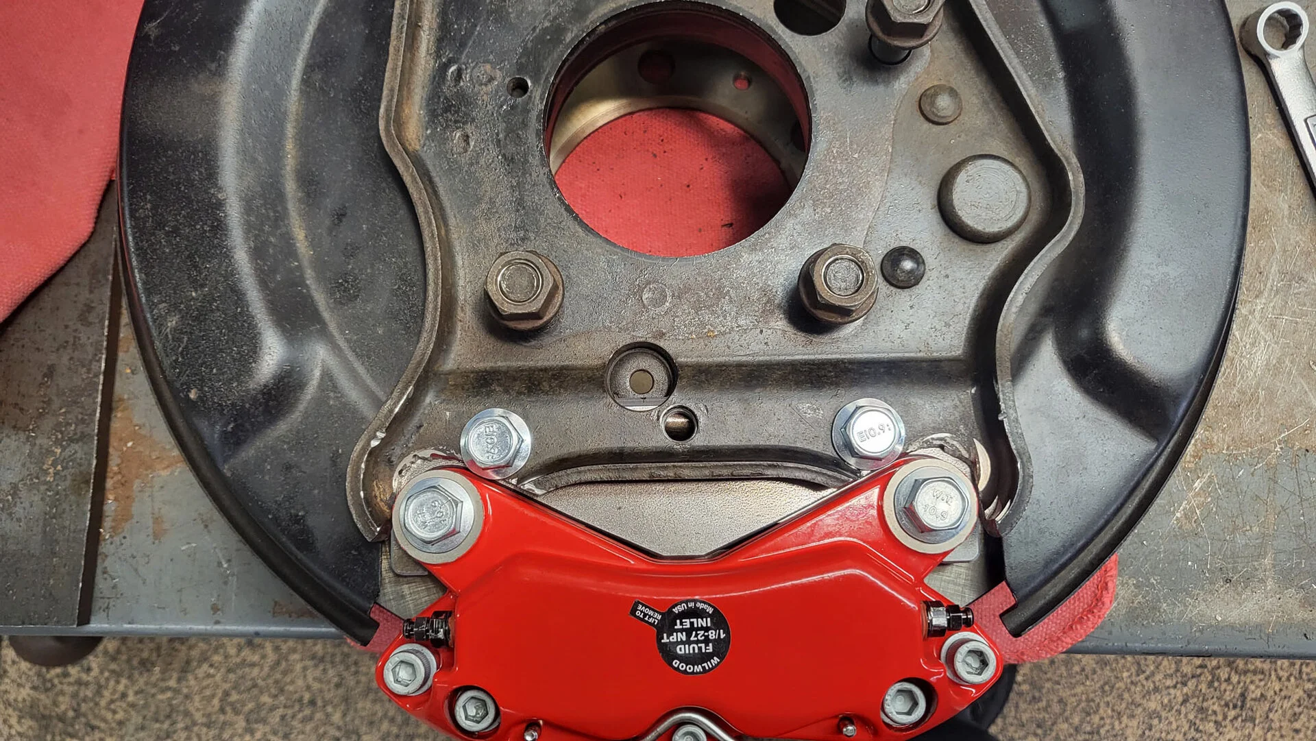

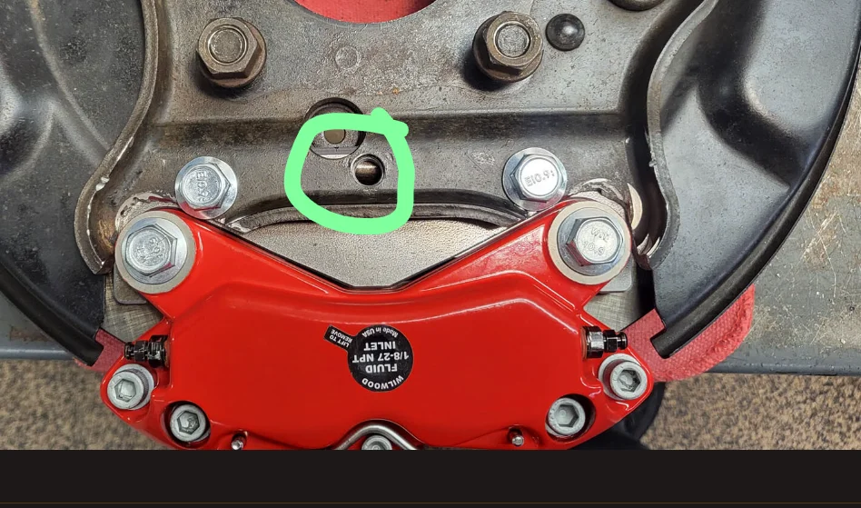

I see you added a 3rd thread to the new plate. Any reason you didn't bolt that also?

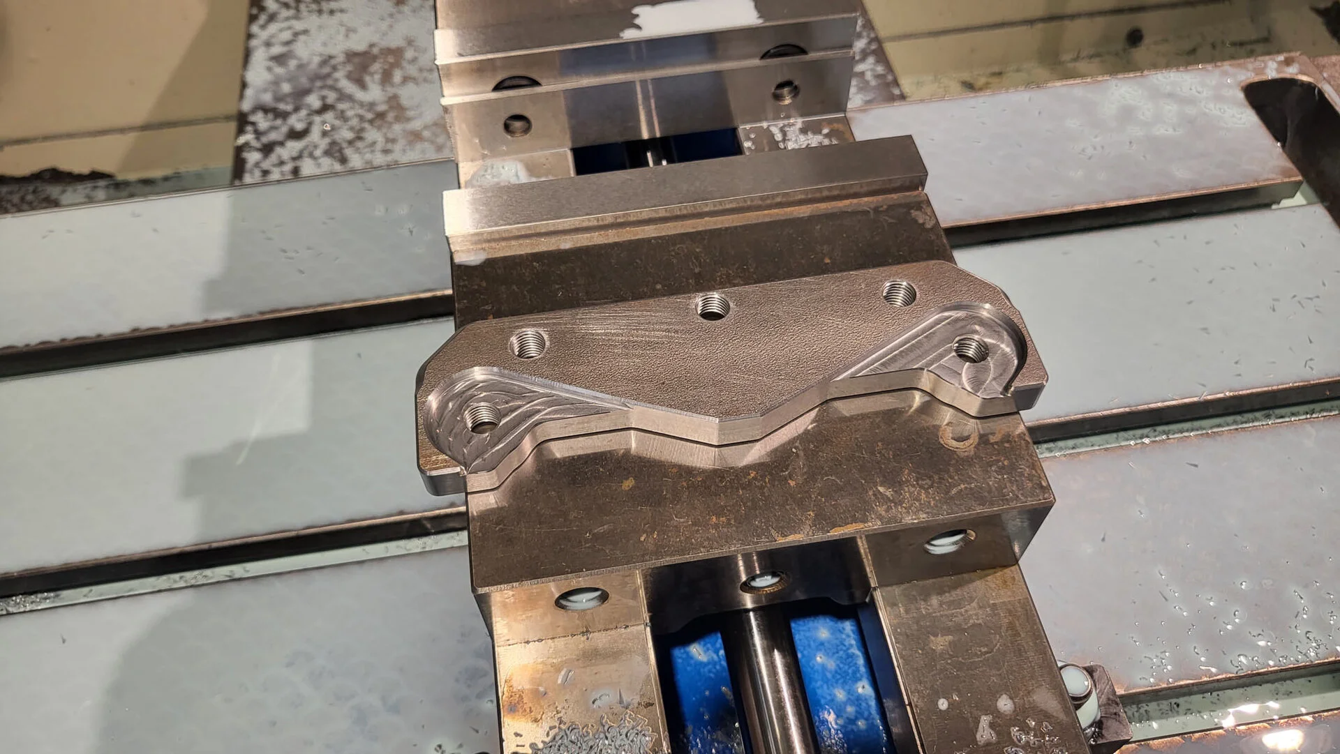

Any chance you want to share your drawing of the plate so I could have someone local make it?

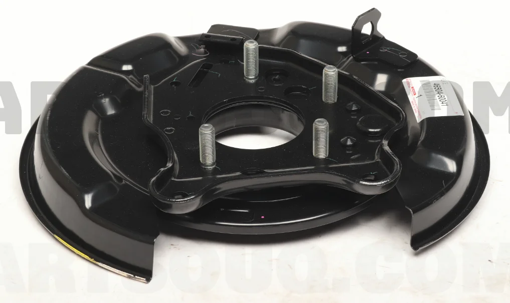

this is OEM, pre cut:
yeah, I agree on cutting up the backplate, but there is no other good option and the benefit of a 4-piston caliper was worth it for me. I generally don't permanently alter the original design so that my mod can be removed and it is possible to go back to the stock setup, but that is not really possible here.
All 3 bolts are used. I just didn't have all of them installed when doing my r&d and when taking that photo.
I might be willing to share the dwg...??? Or, I could make a few but don't know how to distribute without any liability? I suspect there are only a few forum members that would be interested in doing this.
The alternative to cutting the tabs on the backplate is to separate the three pieces of the backplate (back plate piece, dust shield and front sheet metal) by drilling out the rivets and machining a completely new backplate and reassembling the whole thing. I just didn't think this was worth the time and effort. Although it would be nice to have a fully machined back plate vs. the stamped steel piece used in the oem design.
Cutting the plate will turn many away but I agree on keeping it simple in this case. You could probably just pull the rotor and modify it on the axle even. The way you reinforced it was a good idea and looks solid to me. A full plate would be ideal but I'm liking it more seeing the additional bolt securing the bracket.
