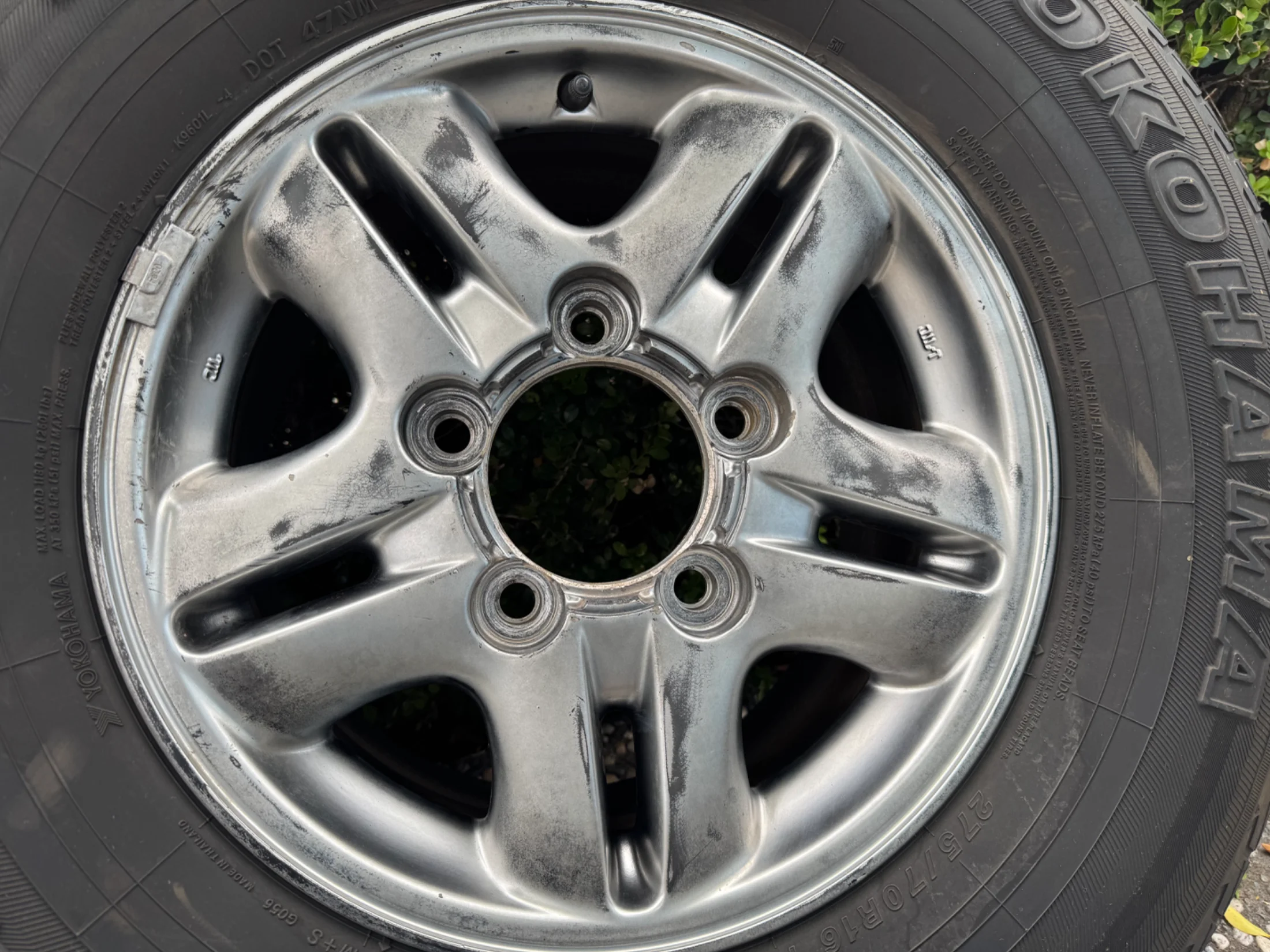

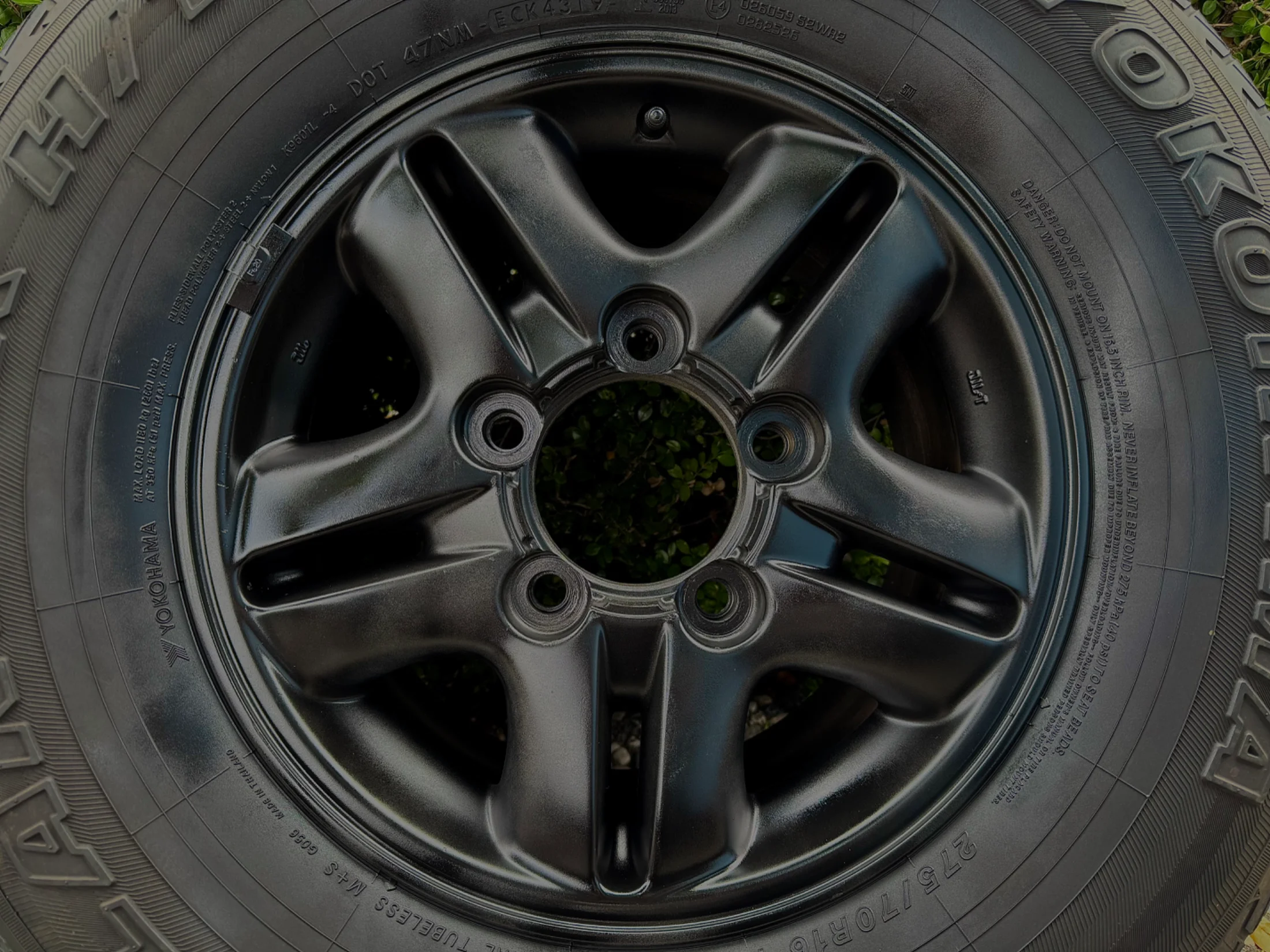

Just do a dirty paint job (Clean, sand some, sand some more, and finish off with Dupli.Color Wheel Gloss Black paint) on the 4 OEM wheels I got yesterday and ready for mounting.
before after pics:

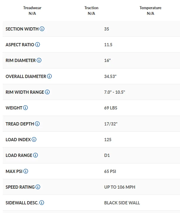

you'd probably have to go to a 35x11.5R16 ... a straight imperial/metric conversion puts 11.5" right under a 295, but not sure how that correlates to actual width. specs for the 35x11.5R16 Nitto Recon Grappler (only tire discount tire is showing they carry in that size):
