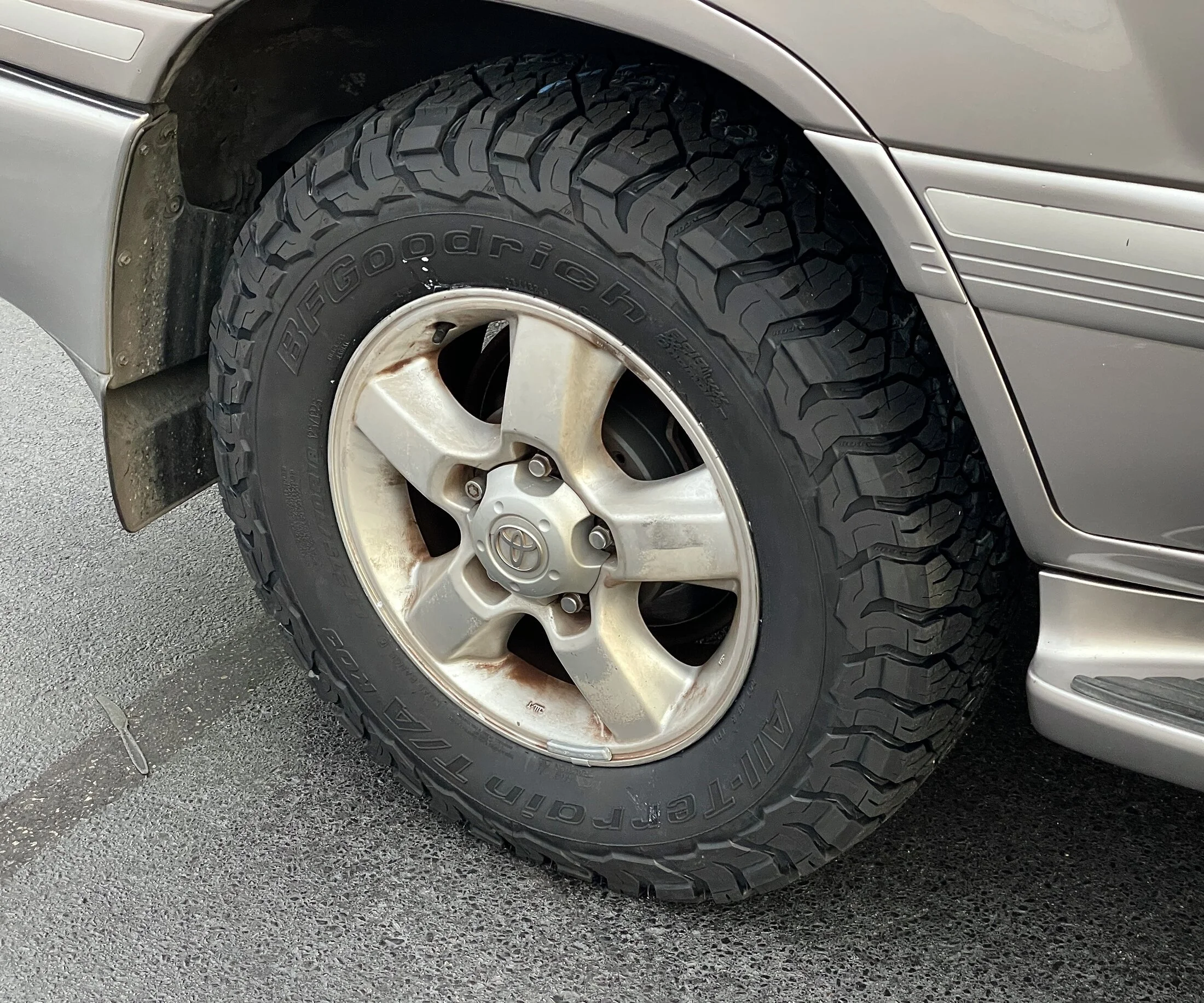

I have these on my '99 LX with an OME 2" lift. My guess is that they'd rub quite a bit on stock suspension.
LT285 /65 R18 125S E1 RWL​

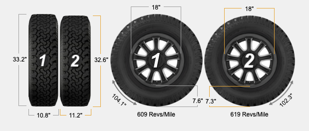

They're .6" taller than the ubiquitous 275/70/18s that everyone runs with no issues. My guess is they'd be fine. The spare in the stock location may be tough though. I wonder if you could store it there deflated and carry a compressor.

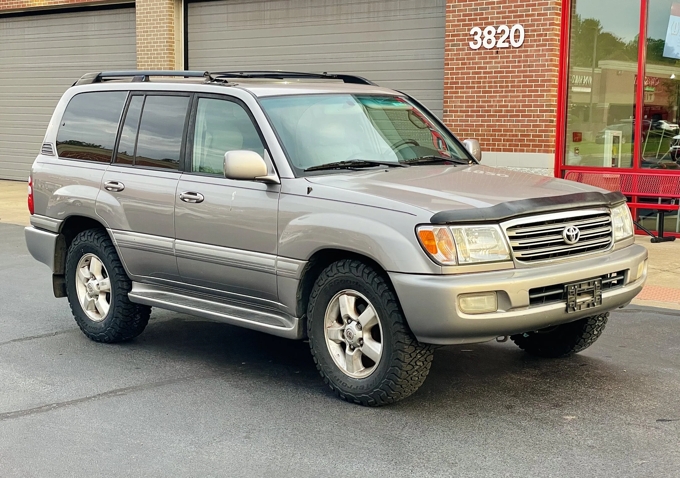

My son just put these 275/70 R18's (common here) with no rub and I'm amazed at how smooth these ride for an LT tire – these are quieter than the 265/70 R18 Nokian Outpost nATs that I just got last November.

You've got that backwards- 275/70's are .6" taller than 285/65's.
