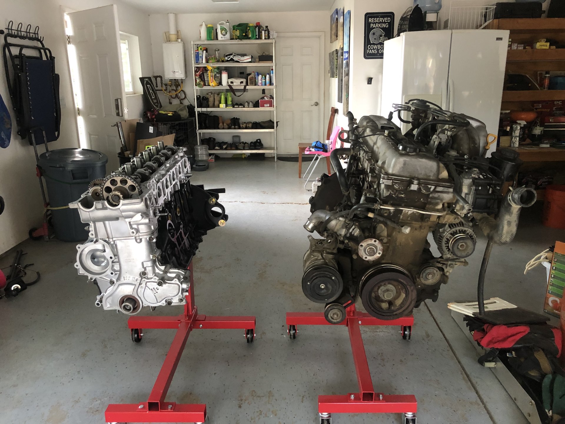

Thanks for asking. I figured out what the noise was after a lot of screwing around. Though it sounded like it was coming from inside the timing cover it was not. I knew it was near by so I pulled the motor and tore into it and long story short, the oil pump parts were not replaced or even inspected. The knocking was coming from there. There was lots of scoring and issues with everything including the case so I spent a small fortune replacing all the parts. Tried to only use OEM so like I said…a small fortune. I’ve had some health issues more recently so only recently have I got back to it but I’m finally close to my 500 mile break-in after 1.5 years. I hope that these types of problems are behind me. So far so good. I have contemplated a small claims case against them and though I know that I should for the sake of the next guy, I probably won’t.
