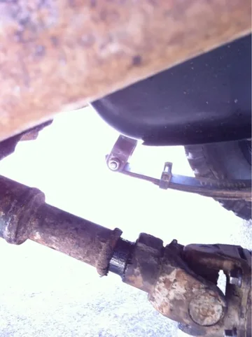

Hey bro. Georg had just flexed it out for me so we could measure for shocks and the front d-shaft and extended brake line looked good. :D
Mine looks previously extended though, but maybe not.... Here it is parked in the street.
After having done mine, if I had to change it now that its on, I think I would probably drill out the rivets on the rear hanger and move it forward. I say that due to wheel placement within the wheel well. Due to reversing the spring orientation (SR) in combination with moving the front hanger back farther than the original holes it was designed for, my front end is a little too far back in the wheel well. I think I mentioned the fix I plan in a previous post.

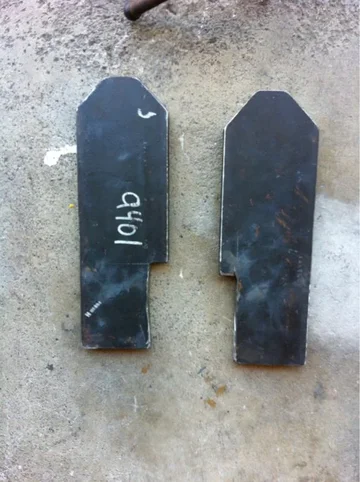

Also, I started in the front bumper. :)
12" (one was already 12 and one was 13)
Dual purpose, just didn't get around to drilling yet... I'm basically copying what's already worked for you ;) (except I cheated and only cut down the area I needed to fit inside the frame...
Gotcha.. What size is that strap material?
J
3/4"x4"x12", 4" long section cutdown/narrowed to 3.25" so it will slide inside frame channel.
Yeah, i couldn't do the outside because of the shackle reversal: it's moved back a couple inches so there is an uneven surface.

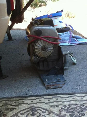

Up camping still so I haven't done anything in the bumper. And first order of business when I get backups to clean out my garage so I can weld out of the wind!! I did pick this up in Reno for her though!! :clap:
