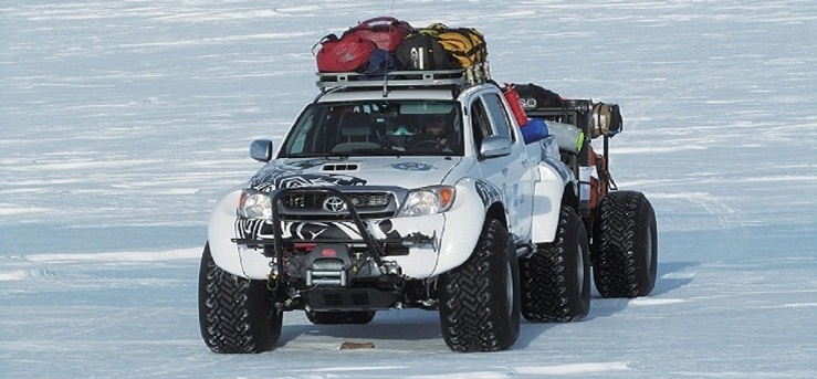

COMEUP winches are also used on all the trucks that Arctic Trucks builds for polar expeditions. Pretty sure those guys aren't going to gamble on a winch that wouldn't work when they needed it.
