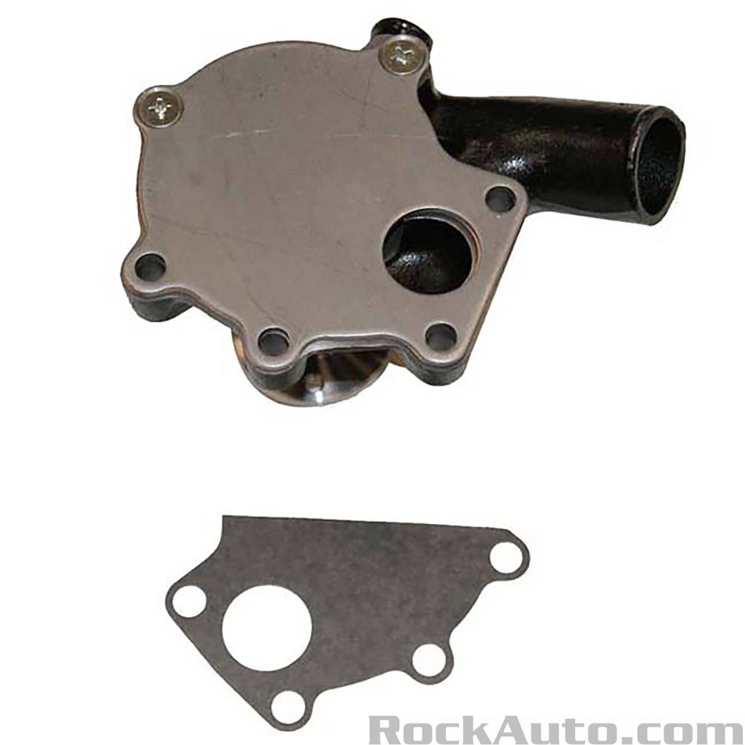

If you do get a GMB pump and wouldn’t mind, would you take & post a pic of the outlet hole on the back side? I never got an answer in “THIS” thread, so I still don’t know if it’s normal or if I got an odd ball. Perhaps it’s due to country of origin. I have no idea.
GMB Image from ROCK AUTO right now
To add to this it's not just about brand or if the pump is made in Japan but who you buy from may determine how the part was treated/stored before you purchased it. I got this fine pump from Rock Auto at a good price and it came with an extra gasket for some reason, when I opened it up to put sealant on the gasket I was disappointed to find this.
Ended up having to sand off the corrosion on the plate and use the "extra" gasket before I was comfortable that it would not leak.
thats not normal cheap jobber but hope it works for a long time

Hey Matt, I just noticed that I missed responding to your second batch of excellent photos. Apparently, the casting & back plate alignment I pointed out seems to be normal. Even though it is normal, it did not sit well with me, so I took a die grinder to it and removed that portion of the casting and smoothed it out. When put just the backing plate up to the block, I could see the opening in the water jacket was larger than the hole in the backing plate. So, I even relieved a little of the backing plate hole edge to provide a smooth transition into the block.
Did it help? I don’t know because at the same time I installed my freshly rebuilt head which cured my vacuum issues and it’s running much better. It is cooling better, but I have no idea if my pump mod plays a part in it. If I ever replace the pump, I will do the mod again. I really wish I took some good before & after pics because it did come out looking good. Maybe a waste of time but who knows without some accurate testing.
