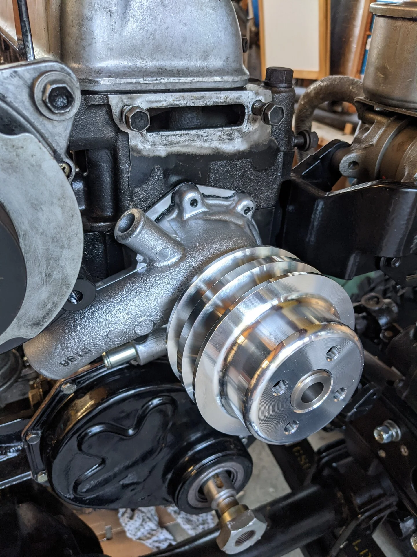

I have a 67 FJ40 with a 78 2F engine. The radiator is in the stock location. A long water pump with the tall double pulley and the plastic fan is too long, the fan hits the radiator.
Can I use a short water pump, a short double-groove pulley, and a plastic fan? I don't care about a fan clutch.
Thanks
Yes you can, I went this route as well but was unable to find a reasonably priced OEM pulley. I found this nice billet aftermarket one for about $80 online. Here's a link to that portion of my build
