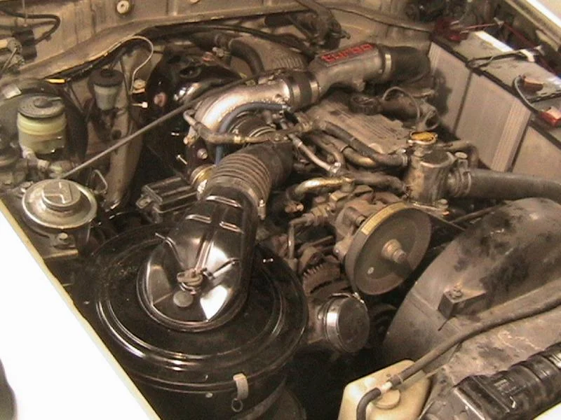

Here is a picture of a Toyota 13B-T turbo (CT-26) that was put on my 3BII (Thanks Wayne :)). This is a pretty good setup and to the non-cruiser enthusist it looks stock. We have the stock thermostat housing, intake runner, heat sheilds, and intake hose all from the original 13B-T. plus the fabricated adapter plate (3BII has different exhaust manifold). This worked very well and with the turbo mapped to the 3BII turbo lag was not that noticable, however when wheeling at Moab and places with a lot of technical obsticles the turbo is really not used much, with 35" tires 4.11 gear in low range with the H55F the engine is using a lot of low end torque, and the turbo does not even spin up at those low RPMS. Awesome on the top end and hiways :)

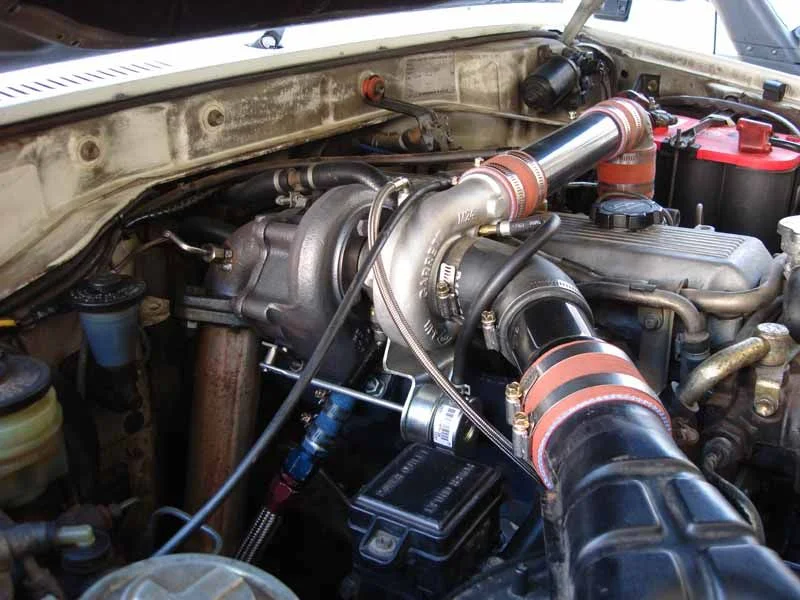

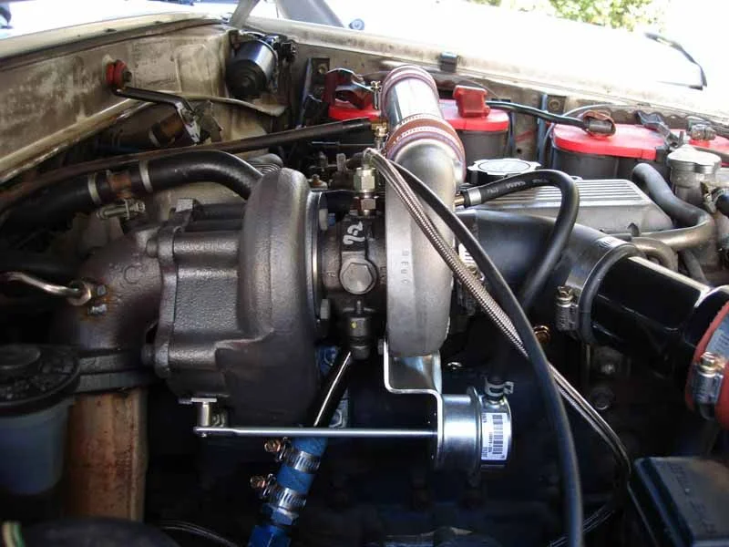

Here is a picture of an AXT turbo (first one I did back in 99') on a 3B in a BJ42. I took an overhead shot if it because the turbo gets hidden by the plumbing and intake hosing. The second picture is a clear shot on what I hate most about this turbo and that is the compression flange setup to route the exhaust they give you a mandral bent pipe however you will need to modify it especially on a 40 series (I am pretty sure this kit was originally for a 70 series). The price on the AXT is also one of the highest, I bought it from a dealer in the us and it was around 4k USD. the price has come down abit but it is still over 3k for the kit, that is a lot compared to Turbo-glide at 2600 AUS. You can also tell from the pictures that this using the water as well as the oil so additional plumbing. I would say this turbo is better suited for the 3B overall than the Toyota CT-26.

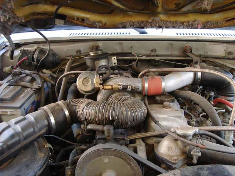

Here are a few shots of an AXT turbo on a 70 series (I did this one in 2002. You will notice how the inlet hose will rip after a while (and it is a very weird metric size) and you must also relocate the PS resevoir to make room for that damn exhaust pipe again :crybaby:.
