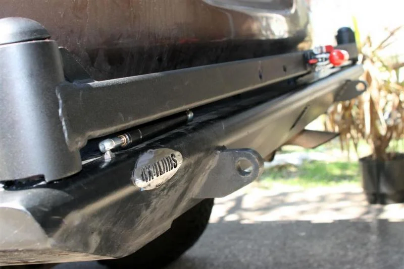

I have been running the spindles from Luke (4x4Labs) for a couple of years now. They are beefy and feature a nice built in stop.

for the price and the simplicity the IPOR spindle is hard to beat. I have 2 on my tire carrier/jerry can holder (35" tire and 2x5gal blitz cans) and have no issues. My buddy has a 36" SS TSL on his tire carrier w/ and IPOR hinge and has no issues as well.

If you go with a 4x4Labs make sure you order the spindle with the housing trimmed for the stops. He sells tow types AFAIK. One made for the production bumpers and a DIY spindle with the lower spindle shaft Un trimmed and the reliefs not cut into the spindle shell for the stops.
