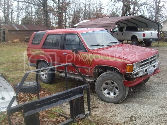

It is the 4cyl, 5 speed, it has the altimeter on the dash(as does the parts rig 10 minutes from me). The parts rig also has the front end parts I need, a recently "gone through" 5 speed, and an engine knock.
The red one has 337k miles and needs a tune up. He said it lacks power. I don't remember my 85 being a real powerful truck anyway. It also has a lean you can see if you look at the other pictures I didn't post.
And:
Needs some work. After looking at those three pictures and hearing that it needs some TLC.....without following the picture address, what do you think it is worth?
Nice running boards. :p
Looking at the front I'd say the metal behind the grill has been dented in some on the passenger side. The fender inner may also have been disturbed. Check the alignment and check for frame twist too. A small amount of twist can be adjusted for in the front suspension. A larger amount would require twisting it back on a frame rack.
Well I'm going to pick it up this Sunday. Needs a gasket between the exhaust pipe and manifold, a gas cap, and probably some plugs and wires. I think it will be as good as new after that.
