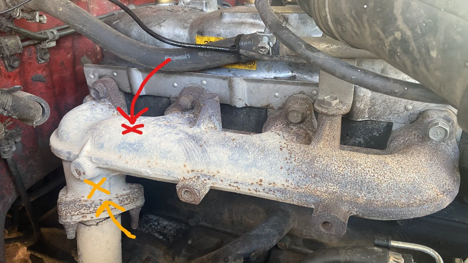

Hey there, I recently got an Issopro EV2 EGT gauge for Christmas and was wondering where the best place to put it would be for accuracy and response time? The 2 places I'm deciding against I have marked in red and orange as you can see. So which would be better, or is there another better place? I'm tempted to do red because it will be easier than trying to fit in between the flange. If anyone has any knowledge or experience with EGT probes in certain locations, I'll be glad to hear! Thank you.
Orange would give the most 'accurate' reading as it would include the last cylinder...
Are you planning on taking off the manifold to drill and tap? If so, I would suggest the longer side of the drop flange facing the back might be easier to get to and drill and tap...

Great! Thanks for the info. I was trying to not have to take the manifold off to get the probe on so I guess I'll have to see just how difficult it is to get it on the forward-facing part. As for the turbo... I would absolutely kill for one, just need to save up some funds to get a decent kit from Gerg or Diesel42. I've estimated at around June I'll have enough funds to go ahead and get a turbo.
EGT will hardly ever move on a NA diesel. Frankly, it is a why bother unless you are planning on turbo charging your 3B. I did turbo charge my 3B over 11 years ago and it is still my workhorse.
It may not move much at sea level, but when you climb to 7000 feet and lose 30% of the oxygen, then you are essentially overfueling and can create an undesirable AFR which can push a NA diesel above 1200F. Don't ask how I know!
There's no point monitoring EGT on a NA diesel. It will smoke like a steam train before you even get remotely hot readings.
Better to fit an AFR gauge.
