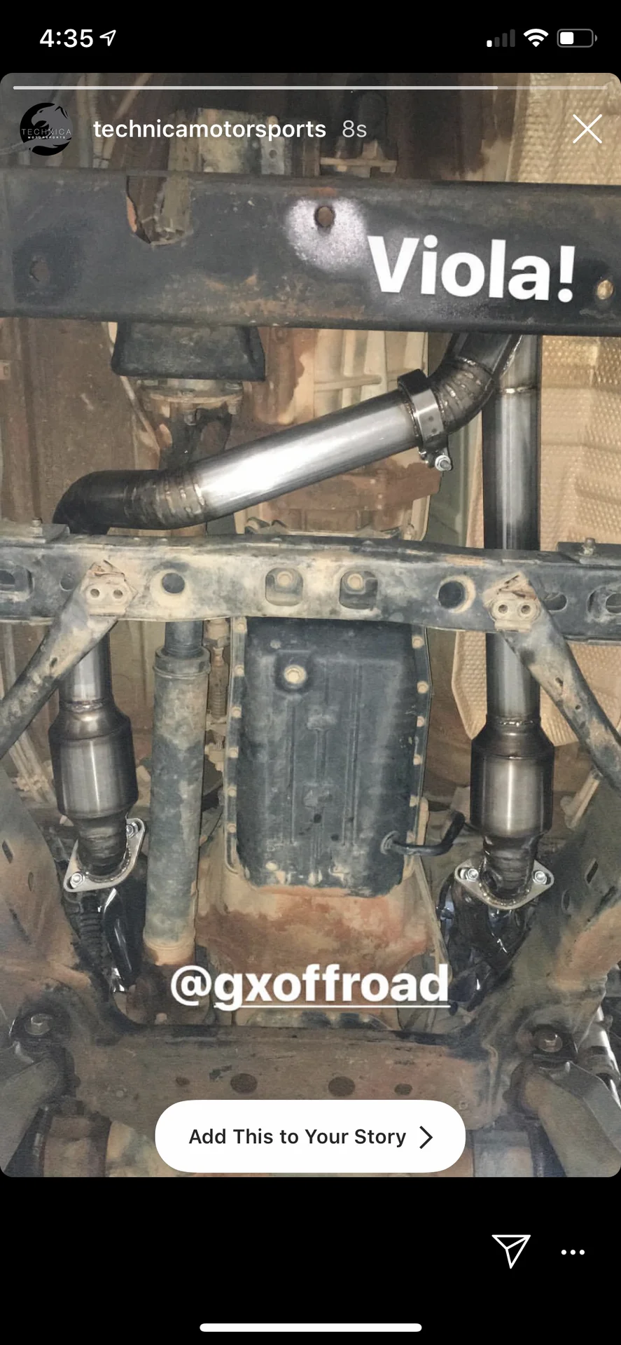

LT to HO Gesi with O2s. Works like a peach.
That setup is probably similar (albeit better flowing :)) than LT headers and the OEM Y-pipe. OEM Toyota cats are supposed to be really good, so maintaining the D/S cats would seem to be similar from a smell perspective to an aftermarket/custom Y pipe with aftermarket cats.
@GXO if im understanding your setup right…it’s LT DT headers and then aftermarket cats (the GESI high output ones). So you still have cats and O2 sensors?

Mine goes LT down to flange, then new flange with first O2 shortly after, GESi HO cat, secondary O2. 2.5" pre to 3" post cat. I use 2 90 defoulers downstream and OEM O2s in up and down stream. I sometimes get low codes on long highway runs but never city or wheeling. I just run an OBDII with OBD Fusion and clear them if they do come up while driving. The 03 mapping is WAY more easy to tolerate change. Same with 04. vvti makes the engine a snob.
