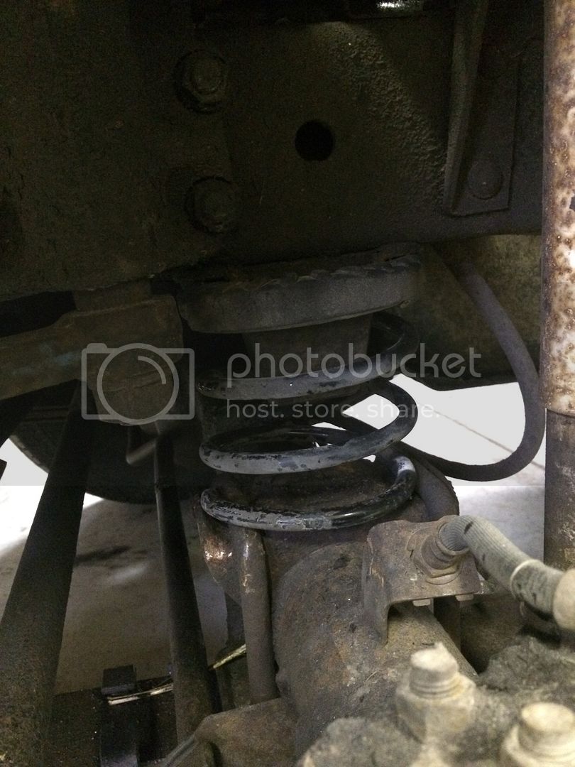

Before... (as purchased with ARB bumper on 371k mile springs) Unbearable ride!
And $10 later! :)
I can't justify OME right now and needed to run the truck around a while to make sure my engine repairs have done the trick and the truck will keep running. The end of the spring was then tacked onto the U-bolt bracket to hold it.. this has held up for 2k miles of mostly city/hwy use and some light dirt roading. Actually rides pretty nice.
If you must know they are rear springs from a late model Kia Rio.. I took about a wrap and a half off and heated up the lower wrap to distemper it so it sat flat against the u-bolt bracket. One spring was laying beside the car and the other one came out with one bolt, 20 feet from the gate of the yard.. And they fit like they grew there! We'll see how long this lasts.
