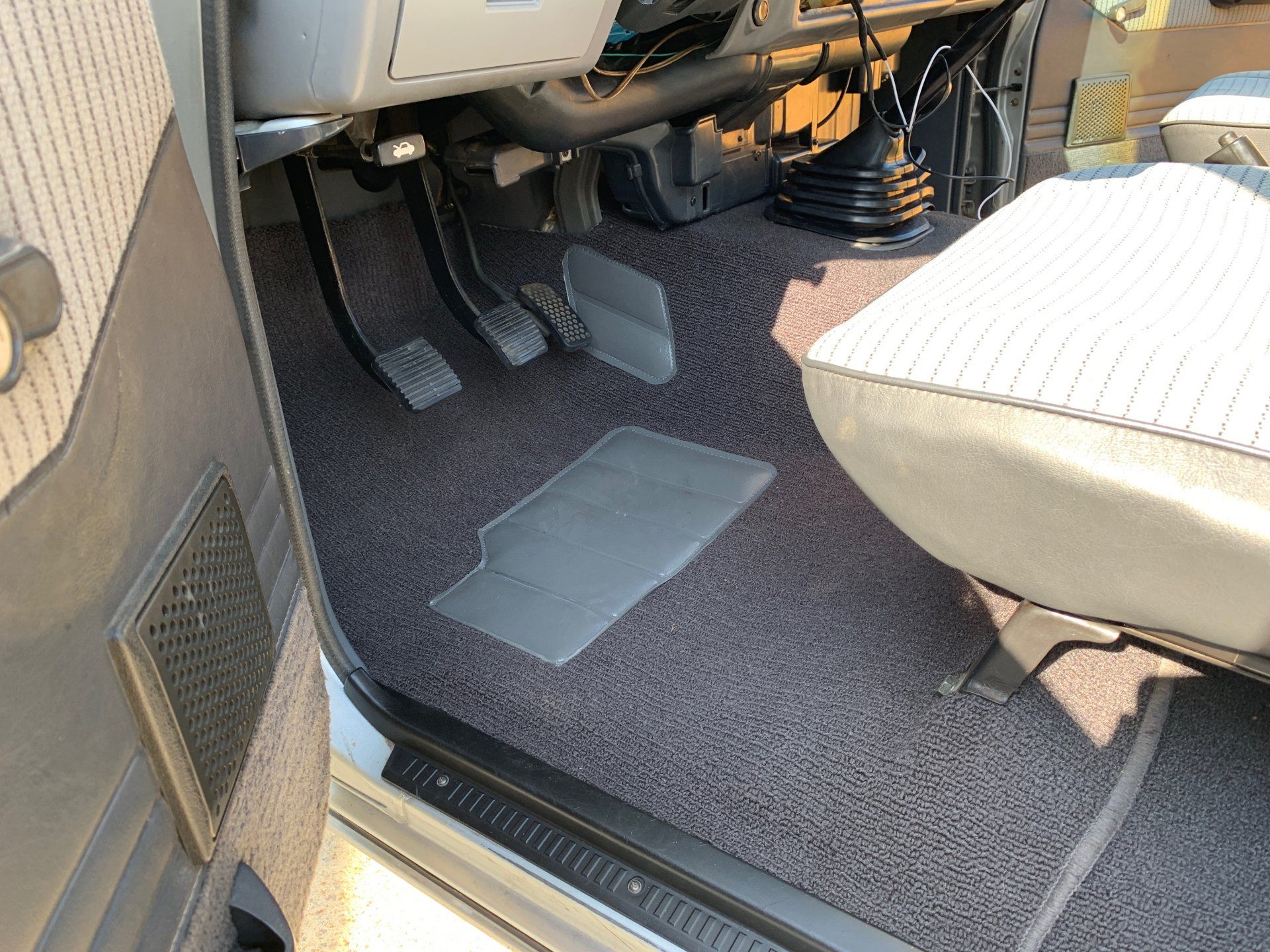

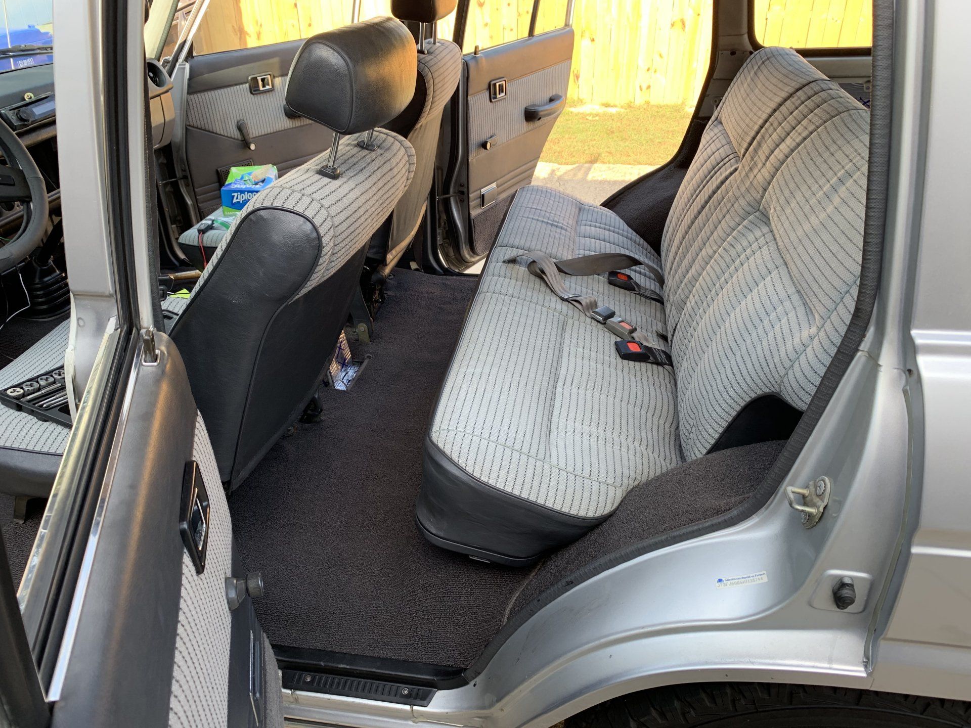

I used the set/kit? from OC auto carpets...just the standard nylon. Looks good and fitment seemed right on. It's been a a little over a year and it's holding up fine even with kids and dogs and the messes they bring.

wow looks like exactly what I'm looking for. Did you have any trouble installing yourself or did you take it to an upholstery shop. Also in the last pic, are you missing your center console or is there a gap in the carpet spacing?

@BillyBlackburn I installed it myself. Not too bad of a job....definitely not worth taking to an upholstery shop. There are no holes cut for the shifters, rear heater, center console, or seat mounting bolts. You just have to double and triple check before cutting. You can use the old carpet as a template, but it's best to cut the new holes undersized for the initial fit and then trim up as you go.
I put mine in after doing some other work; installing sound deadener and wiring in some USB ports. That's why my console was out. There are more detailed descriptions/pics in the "Chloe" thread link in my signature block.
