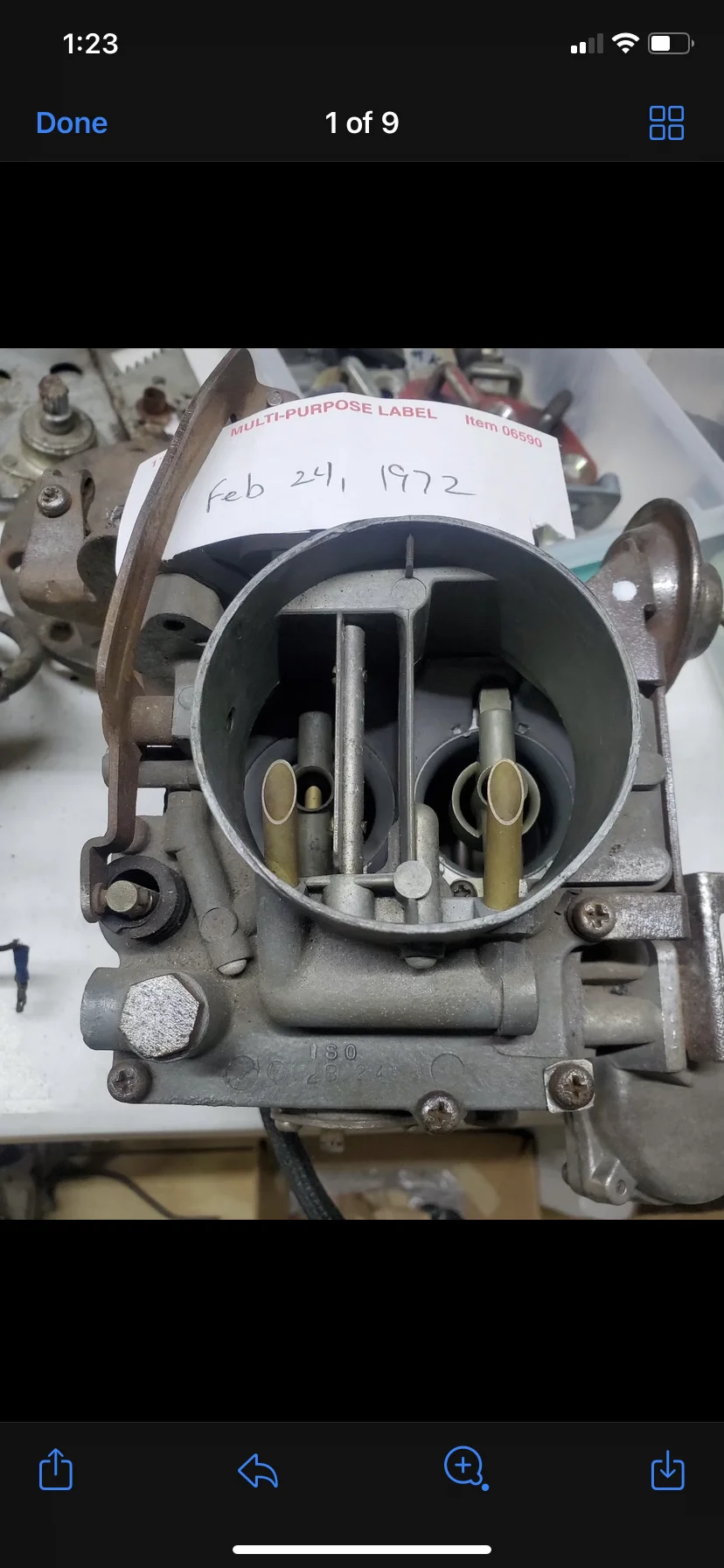

update: I have found a carb from a friend mine. He has it marked as built in February of 1972. It look to be very good shape. If I order a rebuild kit, would this work? I know that would fit my F engine. Am I missing anything?
It looks like a later year carb from 75+. Almost sure that's a vaccum actuated carb from the looks of it. I'm not certain if the base will mount up directly to the intake manifold of a 1F.
: rolleyes:
F engine carburetors do not have vacuum secondaries. There is definitely a vacuum secondary diaphragm in your picture. But it looks like a 1F air horn.
Composite carb. :meh:
Yes. Don’t put a maybe/sometimes vac secondary carb on a motor that wasn’t even designed for one. I have put many a 1F mechanical secondary carburetor on a 2F engine over the last 30 years. But I have never put a 2F vacuum secondary onto an F engine. Ever.
Do a thread search for ‘paper clip test’ and you will begin to know how many disappointed vac secondary carb owners there are out there.
