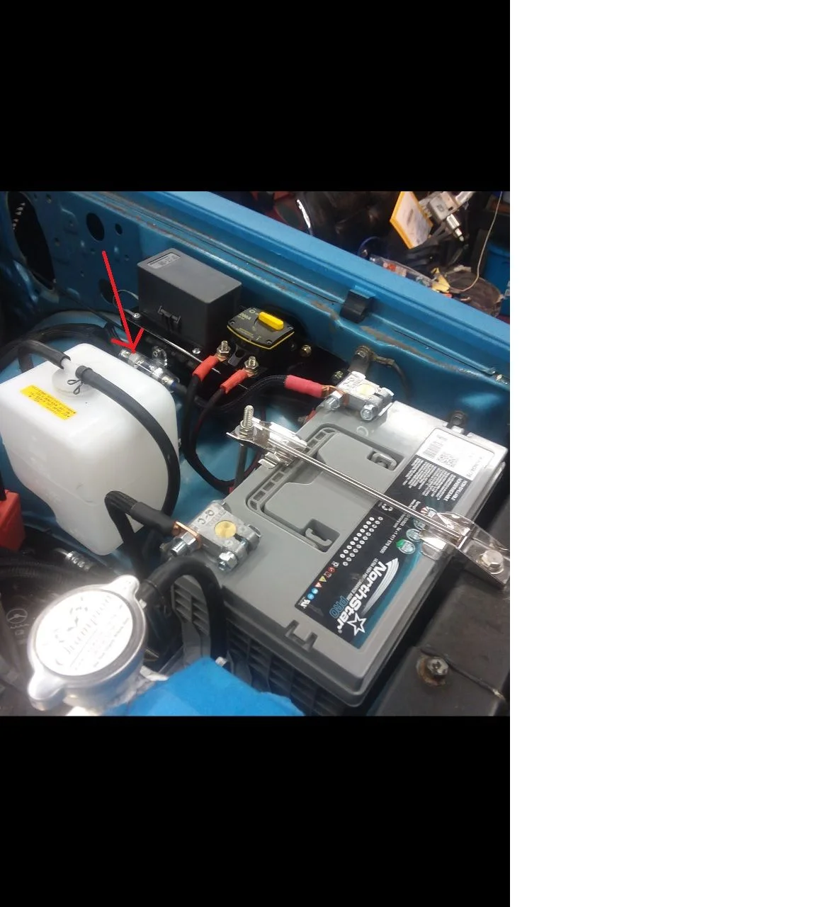

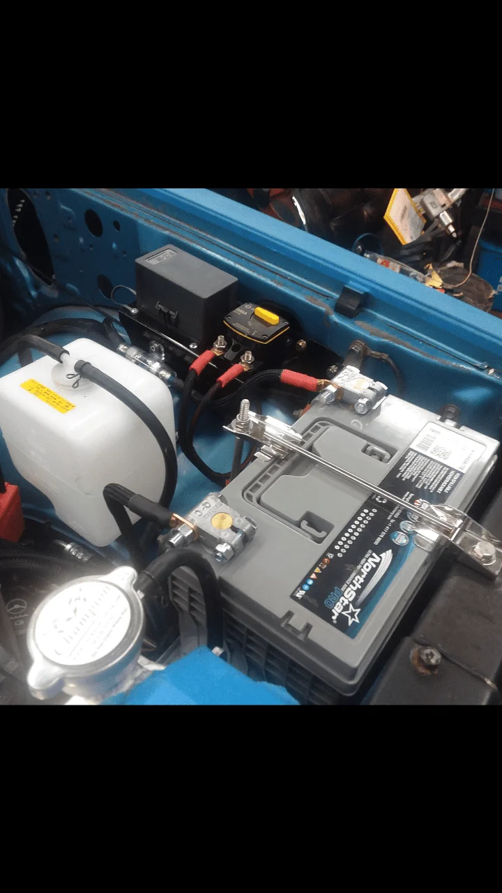

I’ve had good luck with interstate brand batteries. Also I have a interstate store nearby so it makes it easy. Any battery of the correct rating and size/layout should be fine. Unless the label was taped on with scotch tape you bought off the back of some guys truck at a gas station.
Northstar, Odyssey and Interstate are all great batteries. Believe it was either Deka or Odyssey that used to build the old Sears Die Hard Platinum back in the day. Mine still seems to be going strong after 7yrs but she is starting to have a harder time cranking on those cold mornings. Don't know if the battery is just getting weak or if my starter is, have a feeling it is the battery. Since a good friend owns the local Interstate distribution here I will purchase from them if it dies before I sell BeBe.
