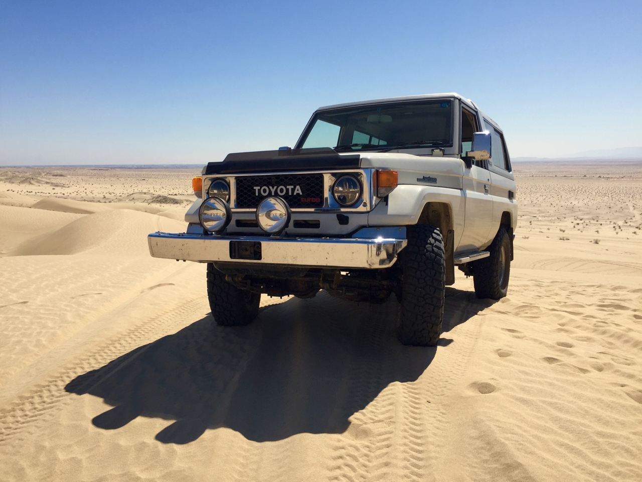

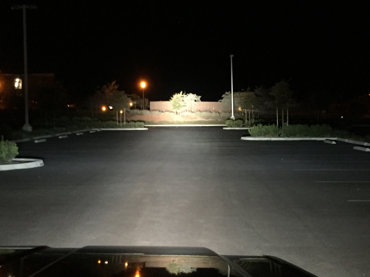

I have the Fyrlyt Nemesis 9000 lights and like them a lot. They put out an amazing amount of light in both spot and wide configurations (which you can change in seconds). I have tried and still use various other types of lights including some spendy LED bars, but the Fyrlyts beat them all easily.
Am running them on my BJ74 which is 24V so the wiring is pretty straight forward and the price is lower. I used the factory fog/driving light switch and wiring to trigger relays I added for each light, following the instructions from Fyrlyt. One note is that these things pull a lot of amps, so watch your alternator output and other draws on the electrical system and get the wiring right to avoid issues.
Mounted easily to the front porch
A random night shot...in spot mode
